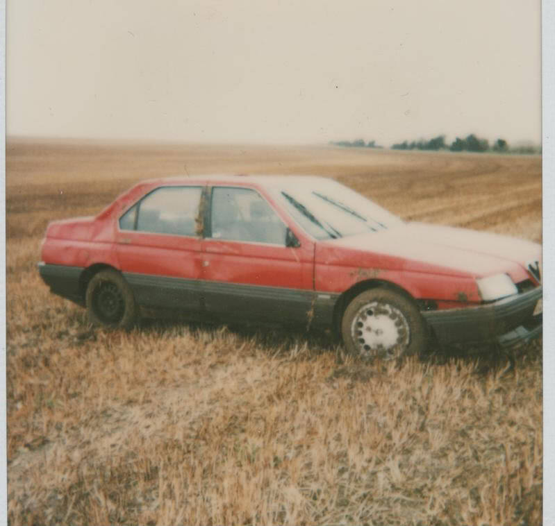

Fortunately another Alfa 164 poped up in the Autotrader classifieds and I was back in a 3ltr Italian barge,  this one seemed quite tired but I kept it for about a year eventually it developed one issue too many and sold it on.

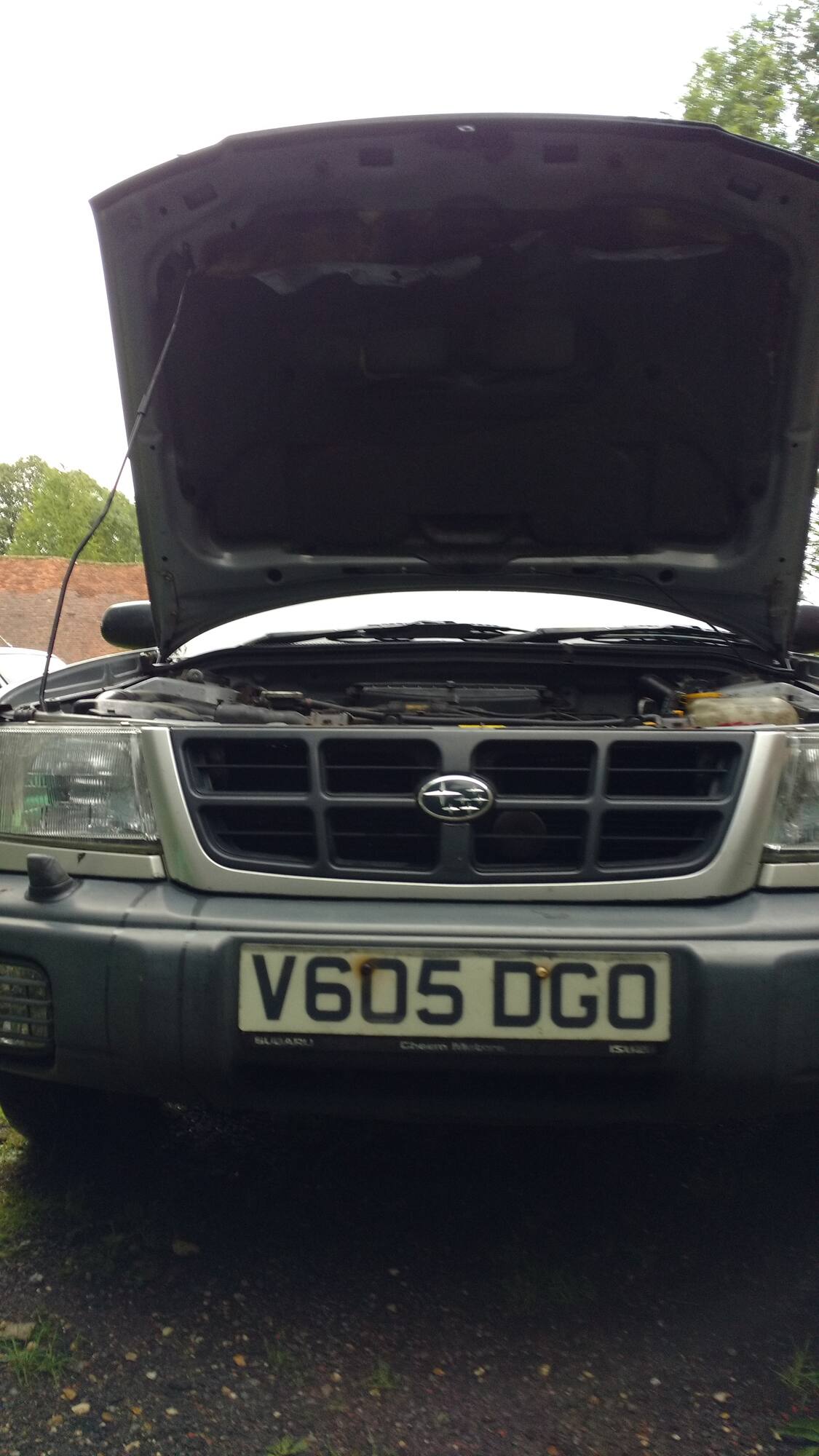

We are nearly up to the present day... In 2018 my better half, got fed up with her Forester mainly because the angle of the clutch pedal really did a number on her leg/ankle. Not wanting to lose access to such a useful motor, I bought it off her. Which saved me running the MX5 in winter making my eye balls a lot happier.
The Forester is a boggo 1998 2 ltr manual but it does have such niceties as heated seats and a cup holder which pops out of the dashboard! Actually another unusual feature it has is that although it lacks serious ground clearance it has a low range box,

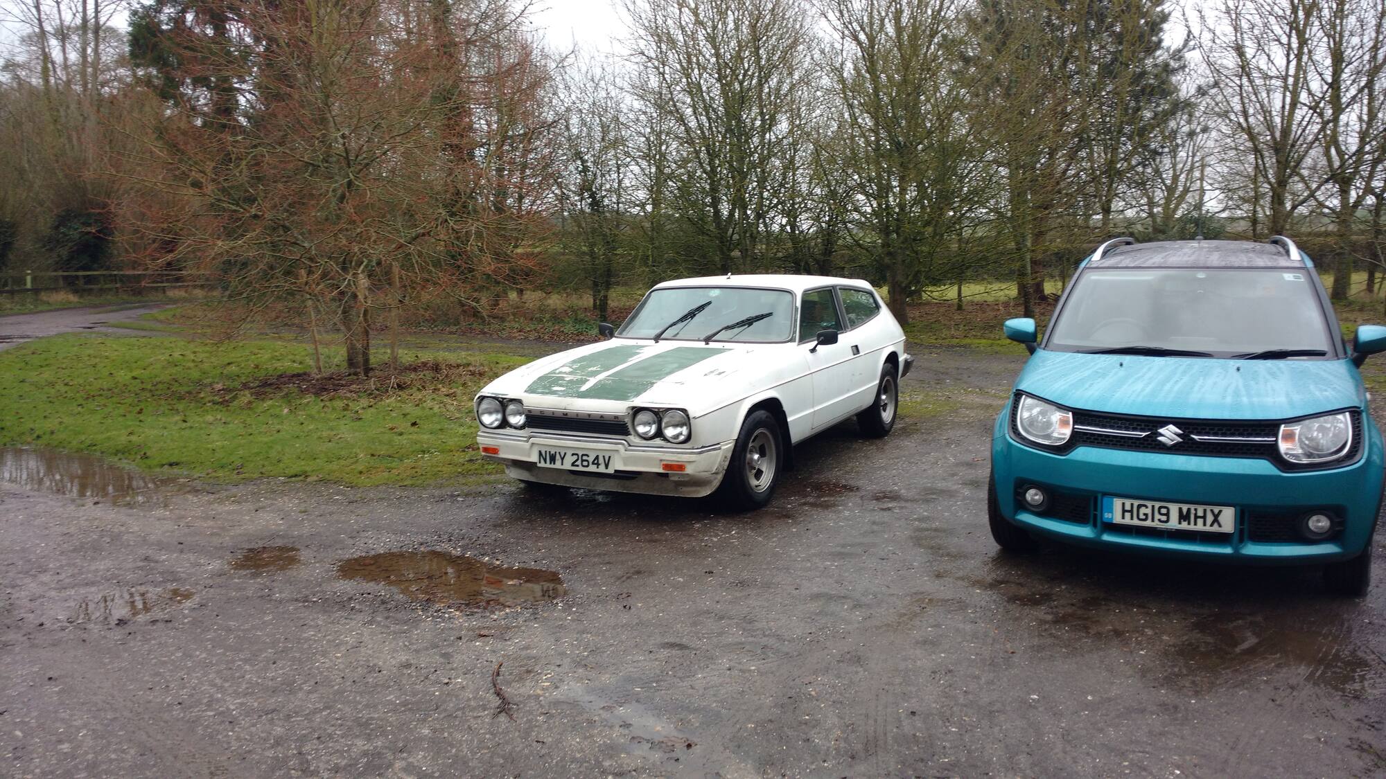

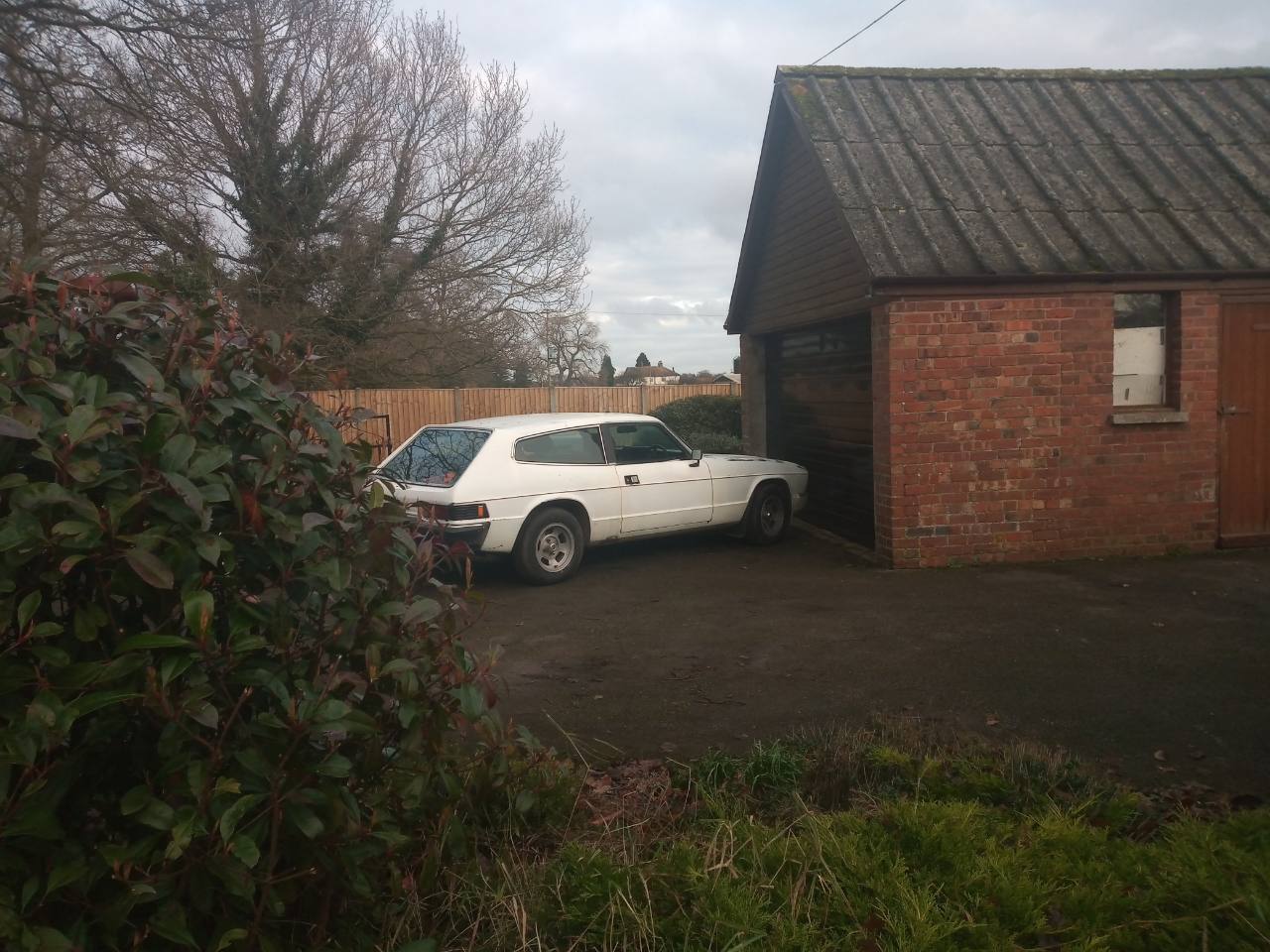

Most recently of all not a new car but going back to the Scimitar which was bought about 5 -6 years ago has finally hit the road, mind you briefly, getting it to run correctly and working through its issues is rather time consuming.

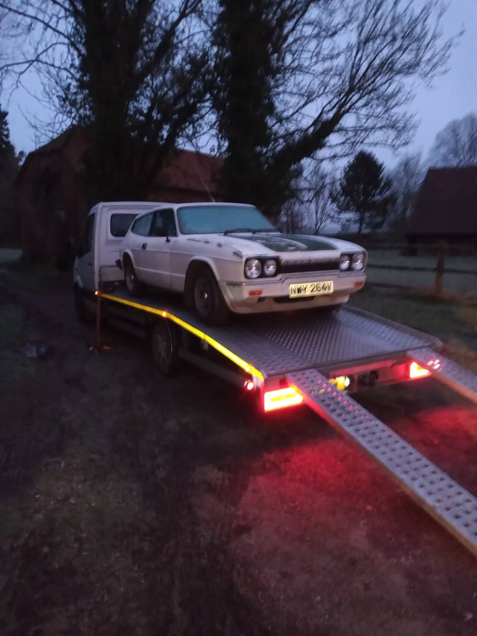

I thought I would try and do a potted history of my Scimitar Project, I purchased the car in 2013 as a nearly complete vehicle, body was attached to chassis, drive train was in place, doors off, coolant system apart, seats loose. It didn't look to complicated. I thought I would have it together and on the road in a few months!

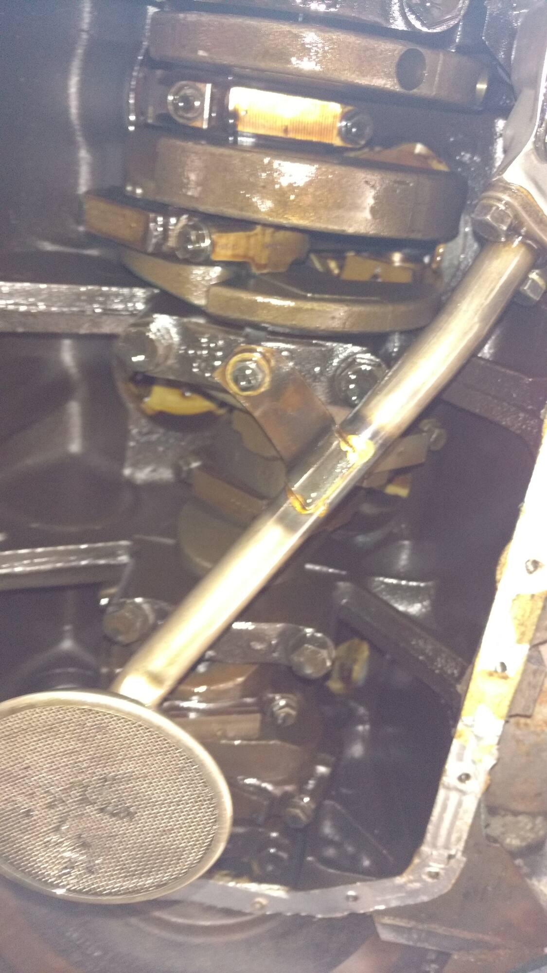

This morning I tackled the first part of the job to remove the stuck dizzy on the Scimitar.
I spent quite a while looking at the underneath of the car this morning, thought I would share!
Once I had unbolted and removed the oil pump I could then tap out the distributor using a rod I had cobbled together and a large hammer to motivate things..
It came out fairly easily, looks a tad manky..
Just a case of cleaning everything up and re fitting, then finally re setting the timing properly, hopefully get that done tomorrow if the new sump gasket arrives.

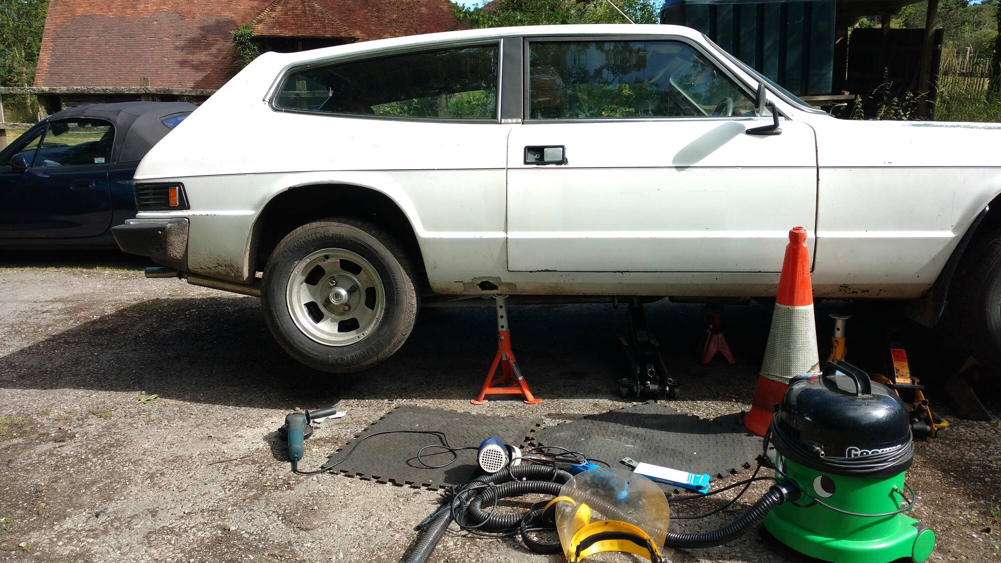

Bit of a Scim up date. The distributor cleaned up and was re fitted, timing now set reasonably well. After a bit more running I decided to get the car back in the air to check for a check and a prod.

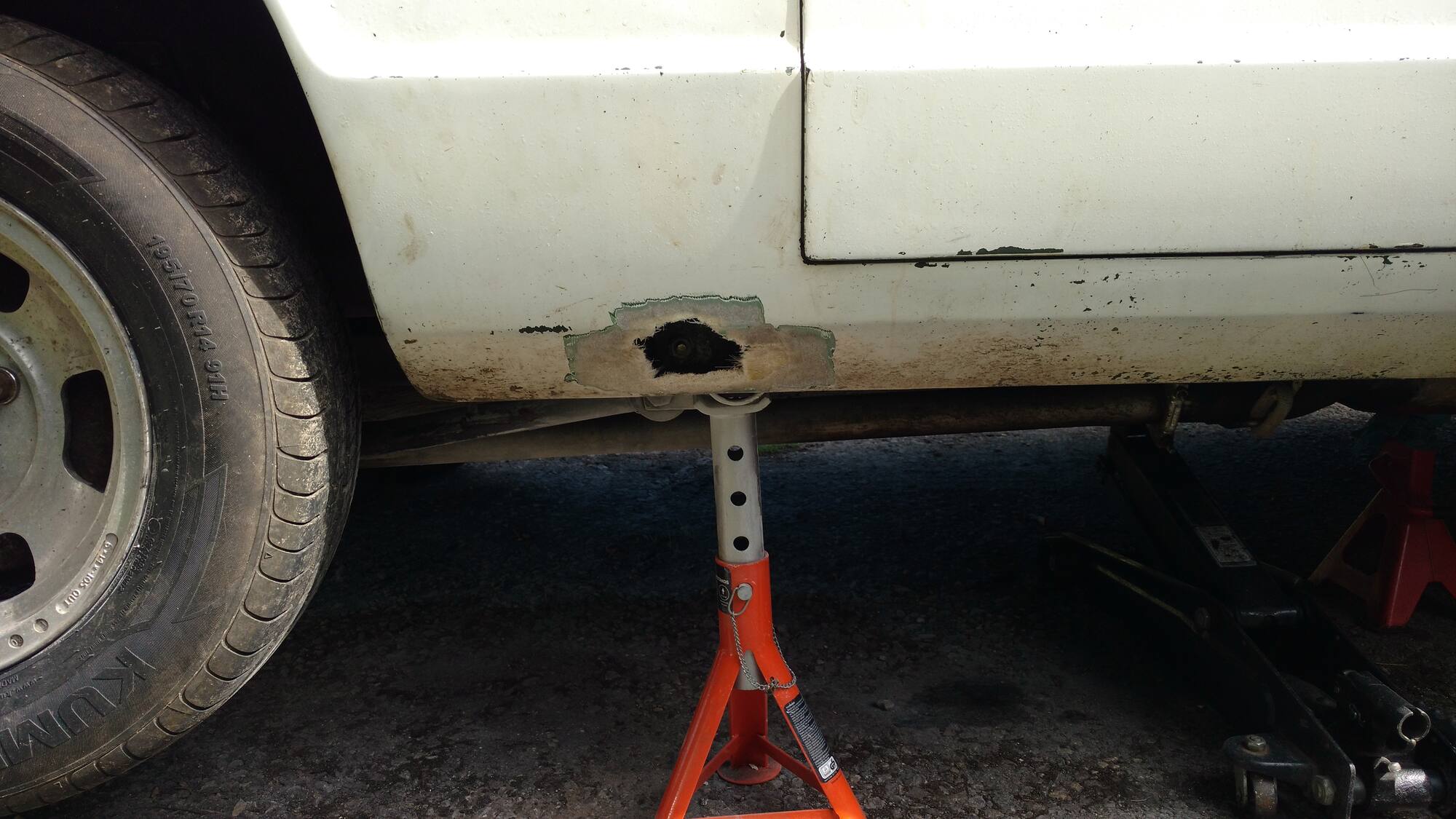

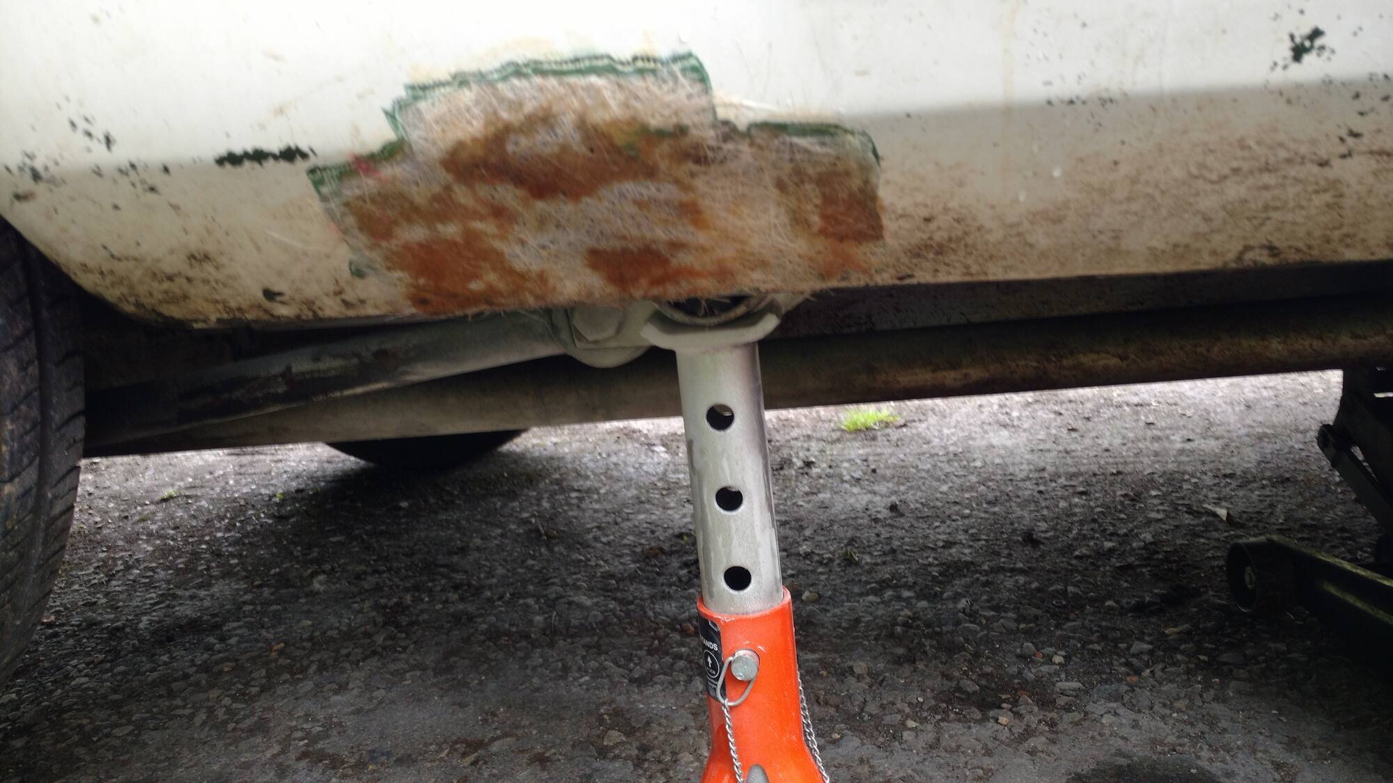

Slight disaster I lifted the rear by jacking on the diff, I didn't appreciate how oily the diff had become ....... Crunch!
The car fell off the jack and landed on one of the axle stands which helpfully demonstrated how breakable fiberglass can be.....
Well bollocks! I didn't really want additional speed holes in the sill. So thats another job to do, I don't really enjoy glass fiber repairing.
Anyway the main reason I was getting the car off the ground was to check the  oil level in the diff, sort out an oil leak on the sump and try and find were the drivers side manifold is blowing. Well predictably the diff's oil level was low and its clearly leaking and its rather loud on the move. Above 60mph its horrible. Looks like an axle rebuild will be on the cards in the near future, oh joy!

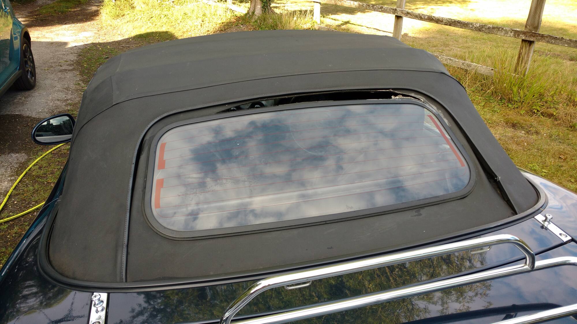

Thanks for the welcome, does your MX5 have the optional rain holes in the roof like mine does?!
Haha!! If it does, they’ve been well hidden. I did buy a hard top not long after picking it up just to be on the safe side though

Decided to repair the damage I had caused.
Firstly clean the area..
Then attempt to repair with structural  tracing paper!
Had an attack of common sense and realised that tracing paper probably wont survive  speeds of over 10 mph
So bit the bullet and dug out the smelly glass fibre kit. This is only a first layer, not the easiest thing to do as gravity is not on your side. I had to pin it in place with some cardboard wrapped in cling film.
This was both taped in place and jammed against the car with a large box. Later today I will probably do a bit more weather permitting.

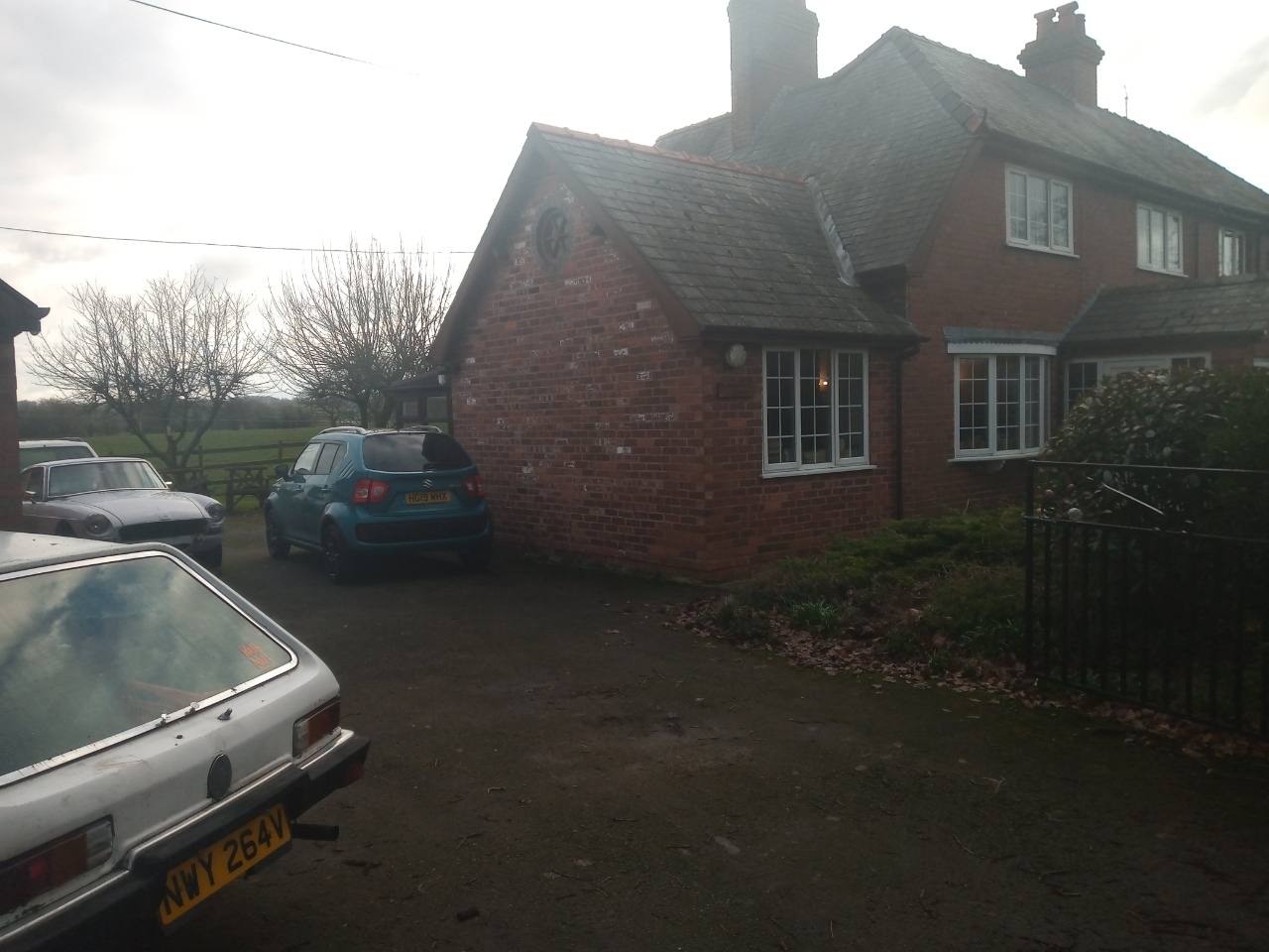

Nah not creepy at all really !The house is a mill house, its attached to a derelict water mill. The mill building was built in the early 1800s and is a replacement for an earlier mill. The house was  an add on built later in about 1850, so its a classic or possibly veteran building!
I will pop some pictures up later when I have got my lap top charged up.
A little house porn, here's a side view with some rotary  washing line action ...
The mill was converted to run on a steam engine in the early 1900s and went from flour production to grinding animal feed, Eventually going out of use in the Fifties. Behold the might chimney of diss-use...
The house and mill are grade 2 listed, so it has single glazed sash windows that are properly drafty, no two internal doors are the same size. The up stairs floor is a little wonky particularly noticeable on the landing.
It comes with free range mice, we have a cat but she is no match for their cunning. We like to tell the locals its haunted to keep them away!
We only rent the place,  I doubt the Landlord will ever sell it but in the next few months it may be back on the rental market as my better half has landed herself a rather decent new job in the Warrington area so we are currently house hunting, trying to find places with space for  6 cars and a small motorbike is proving tricky. We have lived here since 2011 I will miss it!

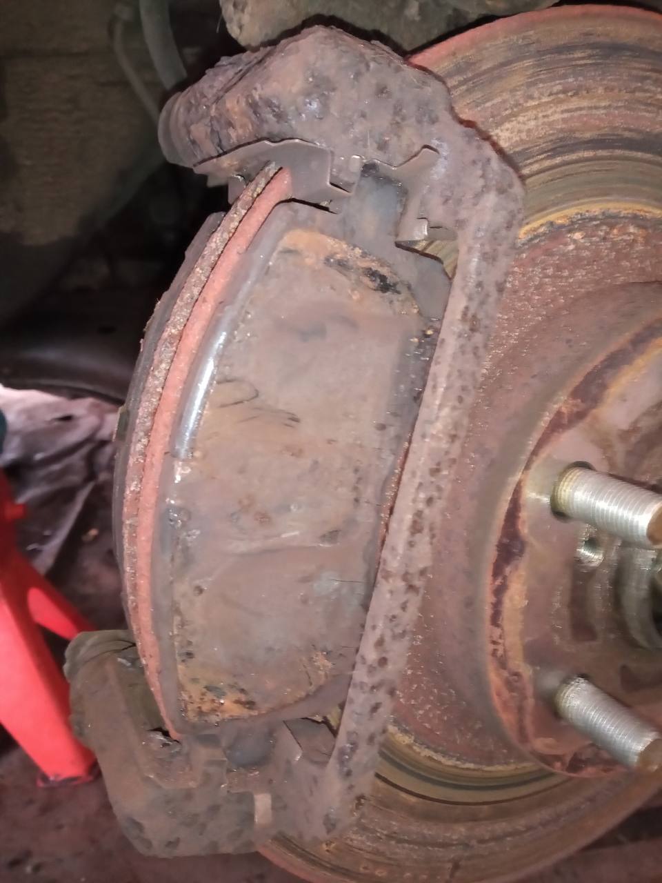

It was all a bit quiet on the car front as I am trying t prepare the vehicles for a pending house move (Mortgage approved, solicitors dragging heels etc etc) . Then my most reliable motor started to act up. The Subaru developed a weird judder on the way into work one morning. Turns out the judder was a front brake seizing up.
On investigation firstly I found this manky mess...
That disc has an added sheen of rust for being sat for a few days but its grooved to buggery. I then checked the sliders and the caliper, found the caliper pistons were seizing up. So I bit the bullet and bought a shiney new caliper as well as discs and pads, oh my poor wallet!
Well it does look a damn site better, anyway a quick bleed with my reverse bleeder (one of my better purchases, my better half strongly approves because she hates pumping the brakes for me! )  and then a road test, all seems well.

After Xmas I arranged to collect a hire van to pick up what was left of our belongings and then I got a message from Ceri who was supposed to be re arranging the car collections, turns out he had to Isolate as his wife tested positive!  Fortunately I managed to arrange collections in time through Shiply, as I was supposed to be out of the house by the end of December.
Scimitar on the move!
I went to collect what I was told would be a Merc sprinter, when I got there it had transformed into a Ford Traaaaaaaansit-aghhh (TM Smiff and Sniff). This pleased me as I hadn't driven a tranny van in ages. It really drove nicely and even had parking sensor, rather handy on a XLWB van.
Even with it being about the largest Tranny van it still took 4 runs to clear all our stuff. This was exhausting, made even tougher by some interesting snowy weather and  on one trip were I moved an engine into the back of the van (the engine I didn't get around to re fitting to the MG) the bloody engine hoist started to fail. I had to drag the engine out at the other end...
