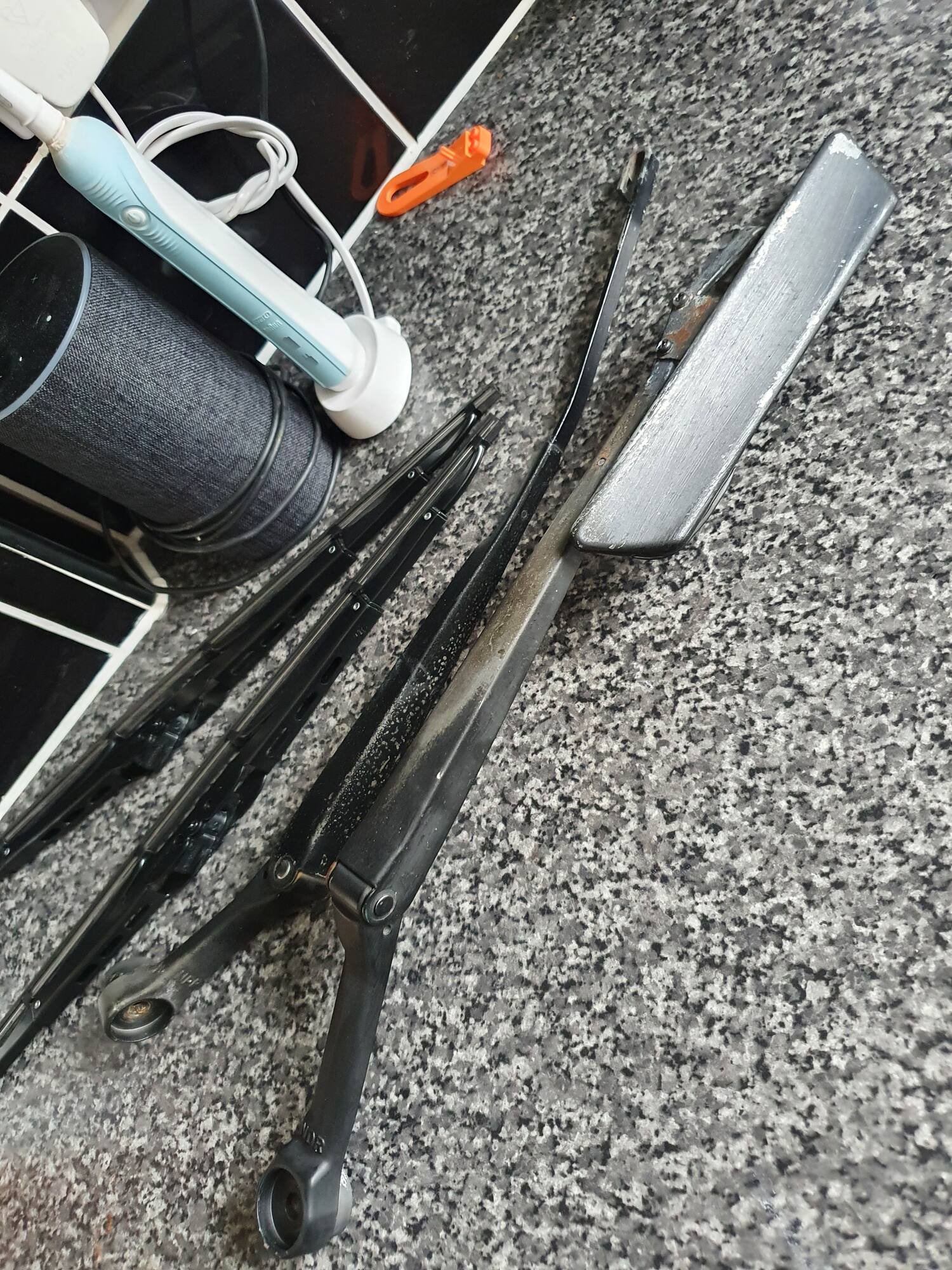

I know, I'll hang them on the washing line to paint them. Where my daughter definitely won't kick a football and knock one of them into the grass 30 fucking seconds after painting it.
Just go in the house now please.
You just couldn't write a book on my life. No one would believe you.
if they're irredeemably fucked, theres two lying in my 'not any use but too good to chuck away' parts pile you can have ?
It's okay. I'll just rub them down and start again.
