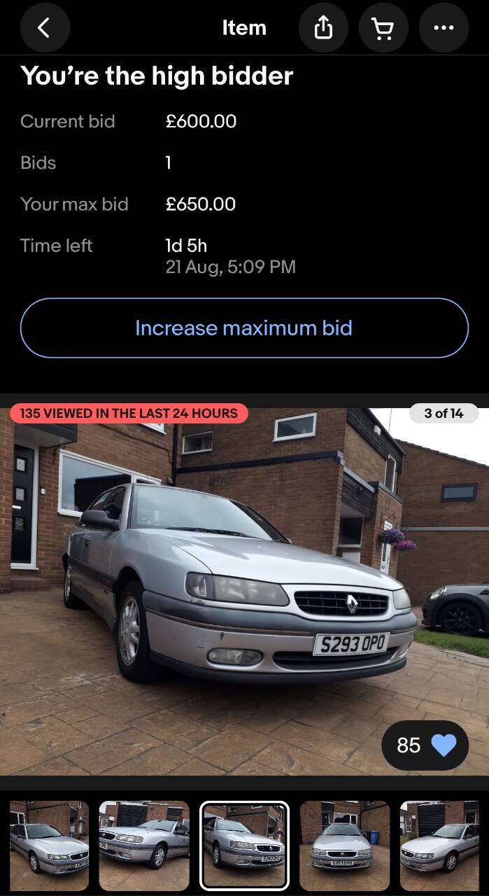

Highest (and only) bidder on this so far. Would certainly use it as a daily until the MOT is up, then I can do a switcheroo for the manual seats, and probably put ones from a Laguna back in.
Where there’s a will, there’s a way.IMG_0658.jpeg.b095a790277974a79546e92349387f5c.jpeg
You're looking a bit outbid now.
Expand
I know. Won’t go too high I don’t think. If it was someone here who’s doing it…
…you’re a prick.
I am not, I am looking at diesel ones within easy reach of where I am for taking home with me.

I’ll probably have to get my dad to collect it next Tuesday, but I’d probably take it to Radwood on the 7th.
Wish Radwood wasn't so far south this year, otherwise I'd consider coming. Would be great to see a Safrane there.
I do wonder how well supported Radwood will be in Chatham but if the XM or Panda is running (possible) and not sold (probable) I might go and find out
Nice! Hopefully you can use one to trouble shoot the other and get both going!
Then keep both? 😂
