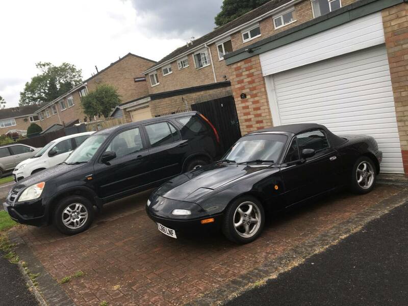

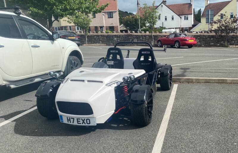

Saw this and thought of you...
Was parked up outside my work! (My 5 in the background)
I nipped off to Tesco and came out and the owner was just parking it up. It was awesome to look at, makes me think I should’ve done this to that white one! It was awesome!

excellent ! nothing impractical about these cars at all, you can do your weekly daily shop at tescos in it :)
this one is a great looking build, it featured as the cover photo on the fb group after the owner got pulled over by the feds before he'd had it in for an IVA

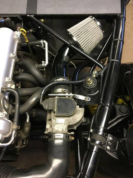

not much progress recently but I managed to squeeze a couple of hours in this evening
job 1, sort out a bit of annoying wiring - that yellow one (radiator fans) needs tucked away safe and the horn needed relocated
hmm, that'll do

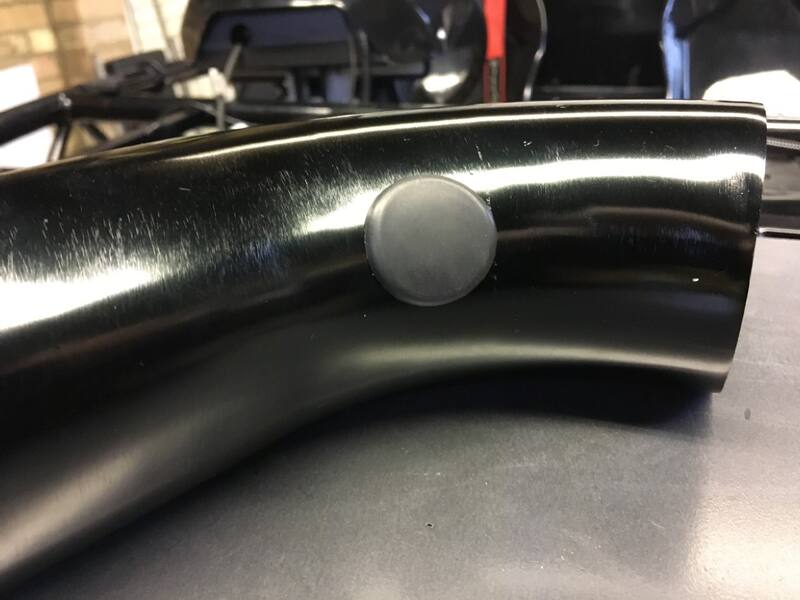

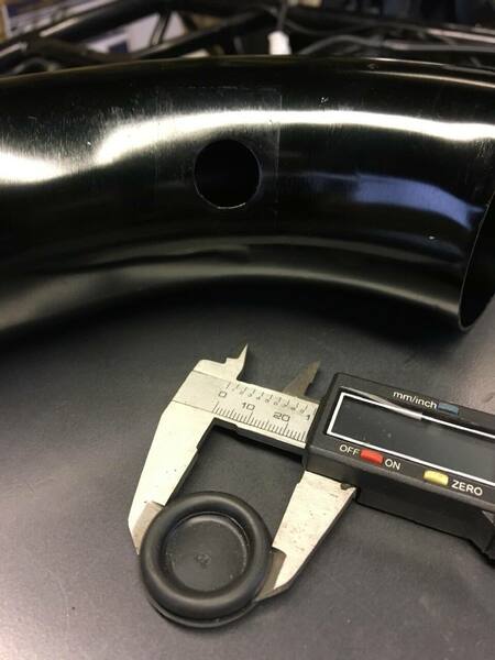

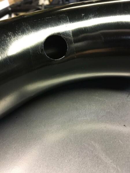

there's a hole in the air intake that needs a 16mm grommet but I have no such grommet (and am too tight to buy one) :(
but I do have a 26mm
and a cone drill :)
sorted :)

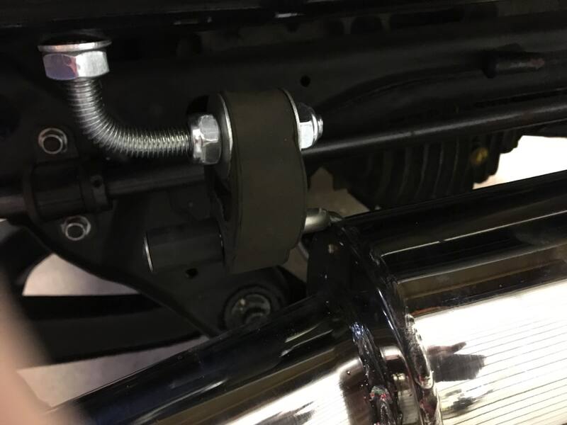

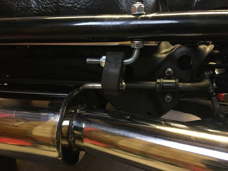

@stuboy pointed out the exhaust rubbers might rub back and forth and potentially saw their way through those home made 'brackets'
simple problems, simple solutions :)

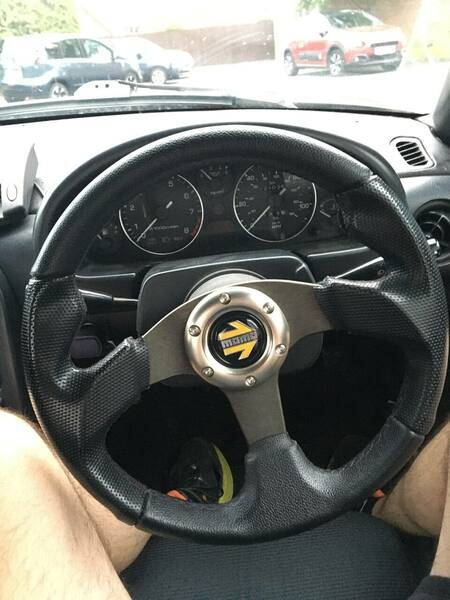

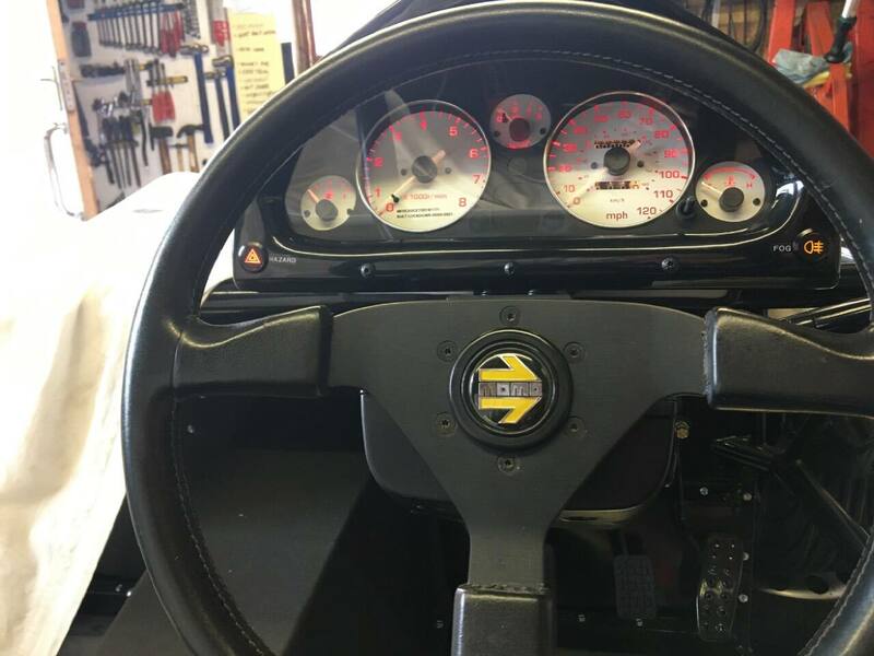

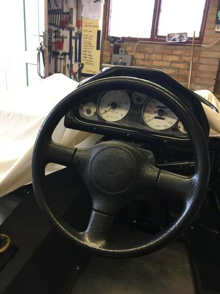

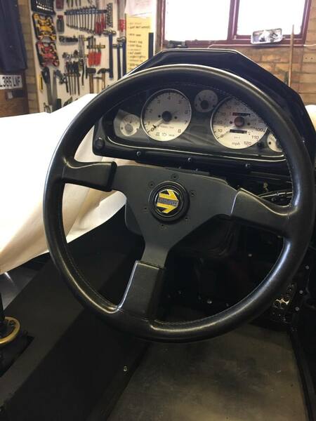

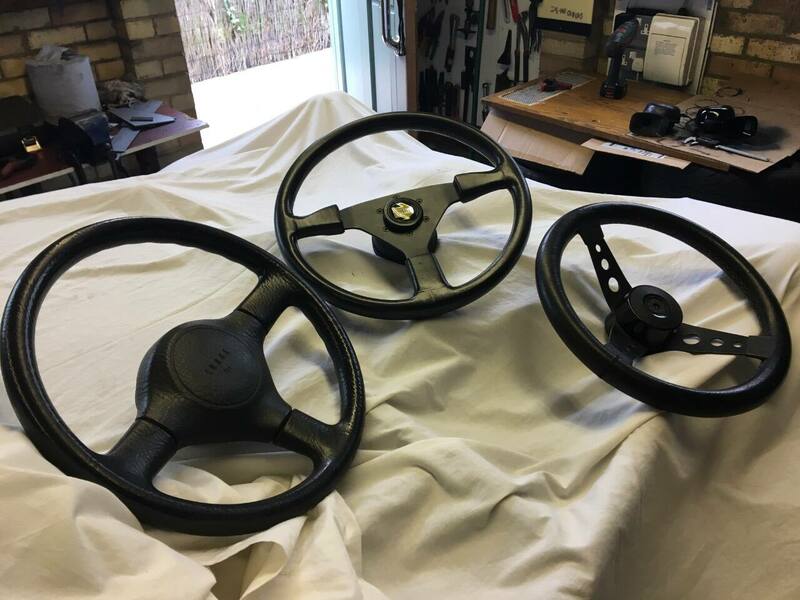

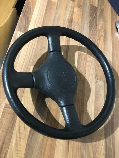

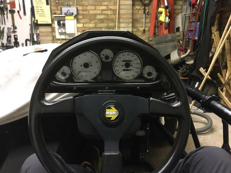

Steering wheels : quite important, and especially choosing the right one to please the man from the ministry
this is what I want to fit
but this has hard edges, will not pass :(
this is what I currently have fitted
same problem, will not pass :(
so tonight, I went to collect this ‘thing’ from a really nice bloke down in teeside
no hard edges, happy iva man :)
but look at the size of the thing - it’s bigger than me dinner ffs !
will be fitted for one day only then consigned to the darkest reaches of the garage for evermore :)
(still not booked the test, before anyone @Tickman asks)
I’m off work for a few days now so will get stuck back into this - the to do list is prepped - standby for action
What's with the hard edge thing?
I have both those top wheels. I hate the top one just not the aesthetic I like and I don't like all the groves. The standard Eunos Momo is a gem. Could you not fit an Eunos pad over it to cover the edges?
Link to comment
Share on other sites
Absolutely, but I don’t have one and the last one (just the horn pad, not the whole wheel) I saw on eBay went for £40 ! The eunos wheel was a fiver and a pack of beers so will do just nicely for the test
Link to comment
I test fitted the eunos one
then stuck the momo back on quick sharp - so much nicer (looks bigger in the pic somehow)

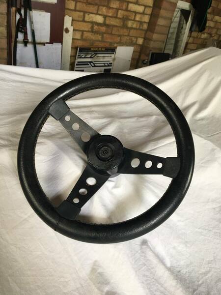

the one I really want to fit is on the right of this pic
which belonged to my grandad, he had it fitted to his old Datsun Cherry which he adored. He always said that if won the pools, he would buy a Morgan for me and him to blast around the country roads in :) I think he would love the Exocet, especially as I have used a good few of his old tools while building it.
the boss has a different spline pattern so I’ll need to work out a plan but I think it would be a fitting tribute.
Link to comment

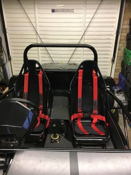

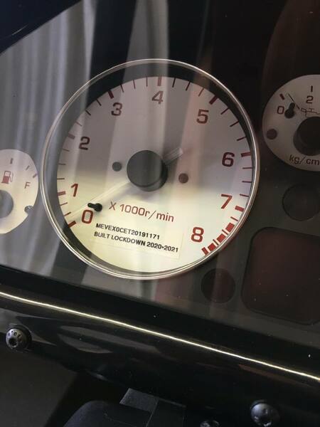

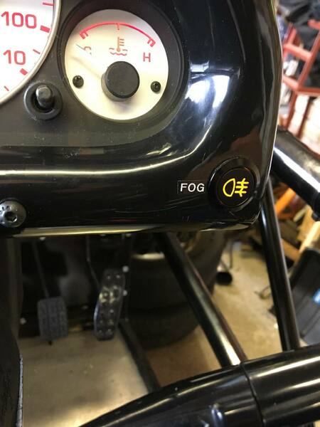

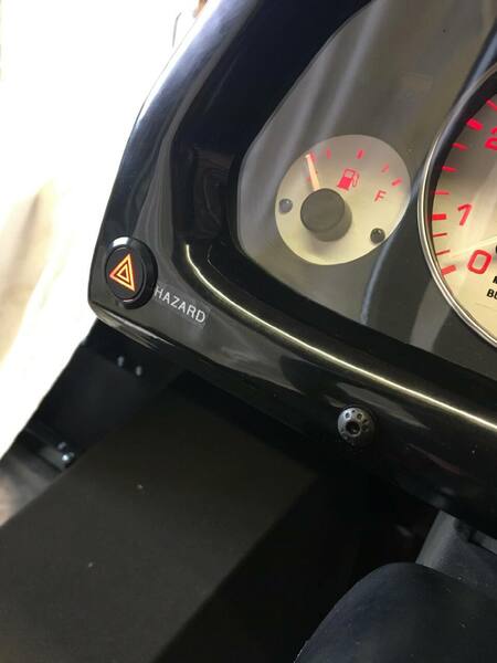

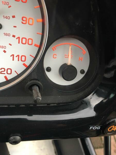

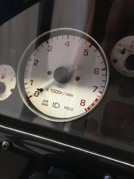

something that has been bothering me for a while is this
the donor car never had airbags, the pop up lights are no longer a feature and my gearbox does most definitely not have a hold feature
time to break out the dymo
but what to put ?
that'll do for now (top line is the chassis number)
and while I had it handy
I think we can call the instrument panel done

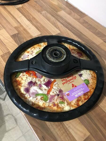

37 minutes ago, dome said:
Hope you don't get the two mixed up or your tea will taste funny.
thankfully I cooked dinner before opening the beers ! pizza was tasty, steering wheel probably a bit chewy :(

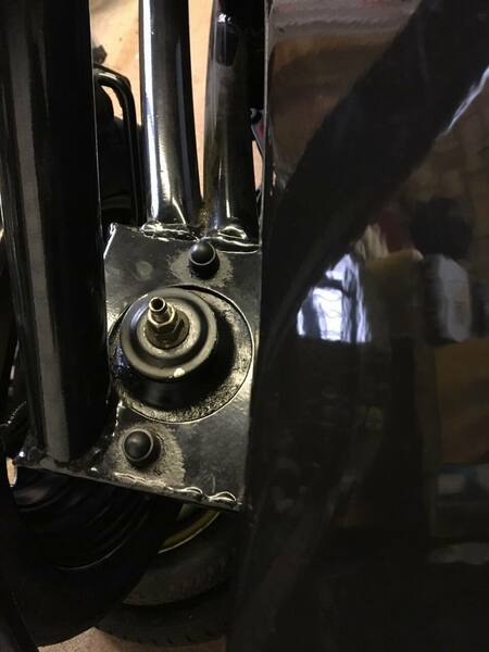

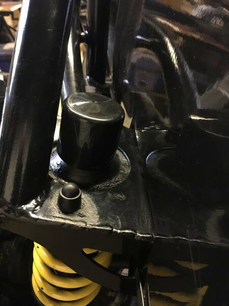

my 'nut covers' (not to be confused with 'budgie smugglers') arrived
look at these lethal top mount bolts - you could have a small childs eye out
hmm, much safer, £20 well spent, I don't think :(

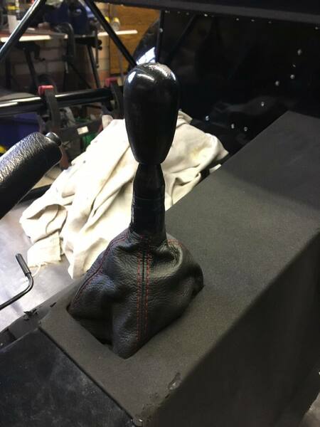

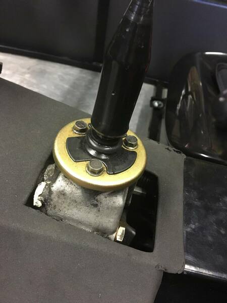

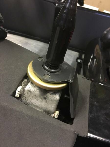

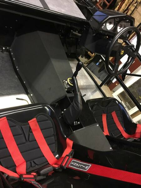

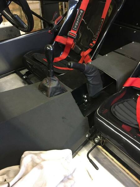

other things that need covering

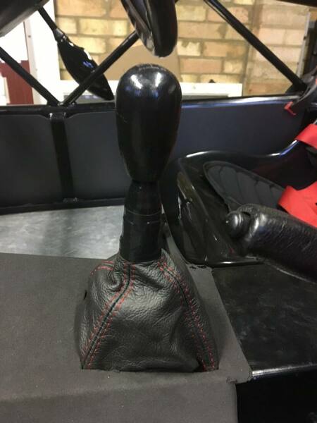

I've been looking for a while for a gear gator but not yet found anything suitable
then I noticed the leather* one that came off the donor car, with the frame removed it might just do the trick
not bad but there's a bit of a gap at the back of the stick
time for a bit of blue peter style creativity
that should help bridge the gap
I'd call that a success, at last until something else comes along

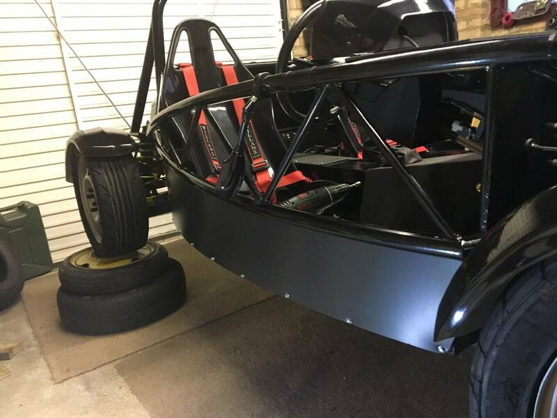

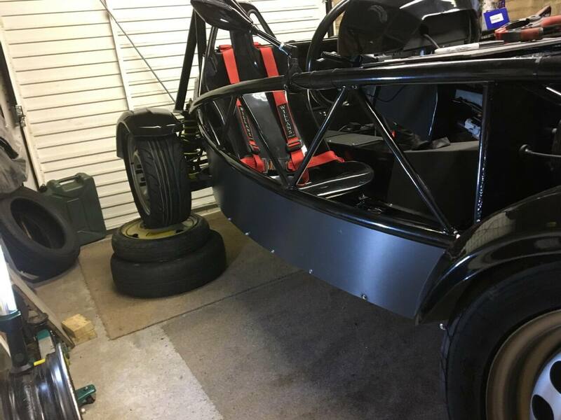

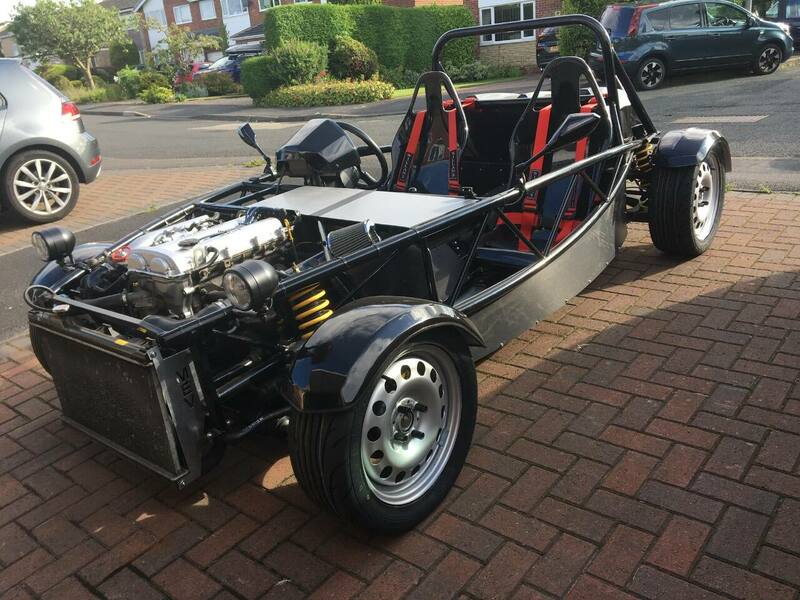

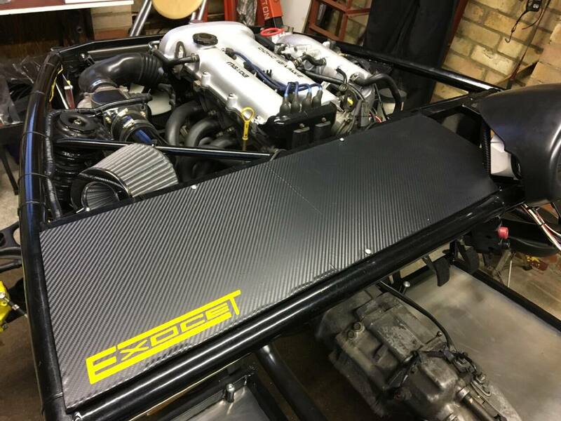

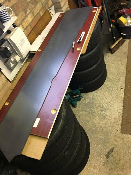

I set up an especially long workbench (an old wardrobe door, very handy) and cut out the drivers side panel
with a bit of tinkering, it was persuaded to fit
held in place with a bead of PU adhesive and neatly spaced screws
looks pretty good
I'm undecided on graphics, possibly a white racing roundel or maybe just "gm" in a fancy font ?
the Exocet stickers aren't the best, I probably won't be using them
 I still need to find a home for those pac men ?

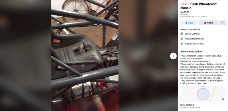

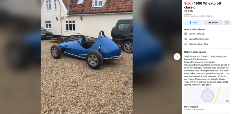

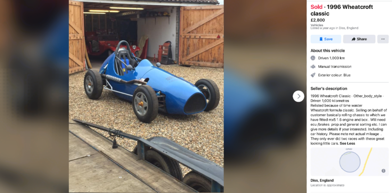

that sure is a bonny looking thing, not cheap but worth it.
1861421251_ScreenShot2021-07-04at11_33_15.thumb.png.5788e976dfd379eb8ae6a0d60bf14864.png
I spotted something similar a while back which looked to be a bit of a bargain for someone
1772583876_ScreenShot2021-07-04at11_23_13.thumb.png.8d4b5b943e8fc96eba592fb6930f0636.png
961706734_ScreenShot2021-07-04at11_23_59.thumb.png.1ba294c576288548e5698851cbbba059.png
interesting location for the gear stick :)
108071765_ScreenShot2021-07-04at11_23_35.thumb.png.1ac2e26b2c8a5fa028c5631e0484fef2.png

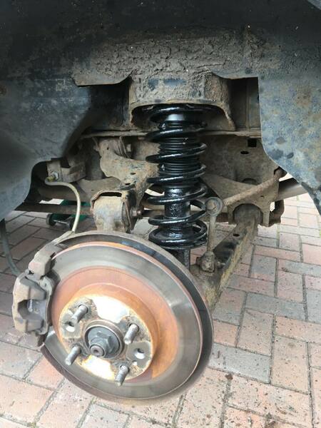

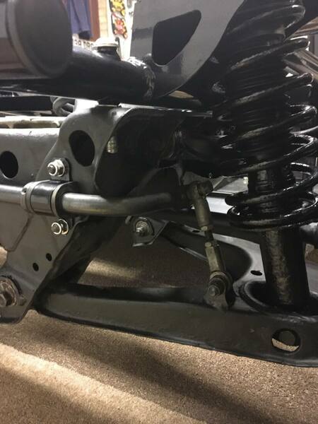

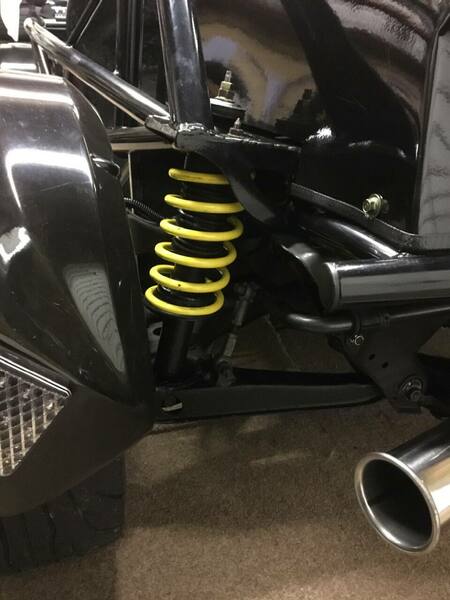

when I was planning to sell the mx5, I replaced the lowered suspension with standard stuff
the sporty stuff got cleaned up and fitted on the Exo
but it was too low, I re-replaced them with standard height mk2 suspension
which left me tripping over the sporty stuff - only one thing to do with that then
mmm, nice and low again :)
drives great, can't wait to get it out on track next week

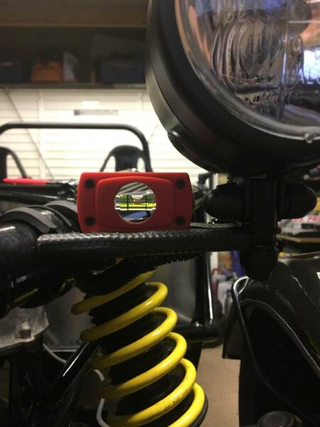

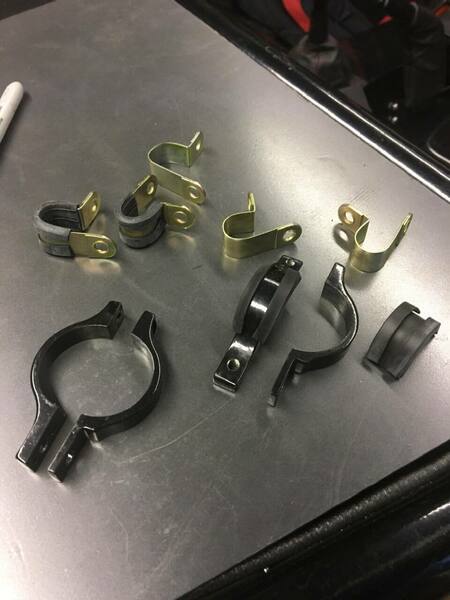

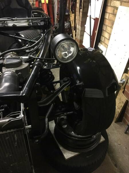

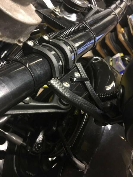

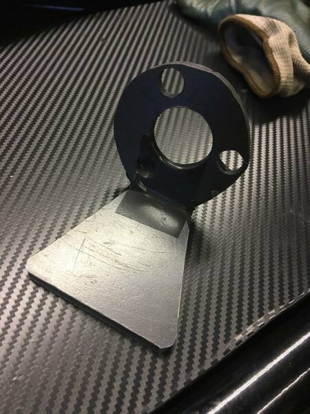

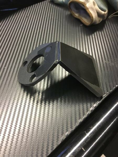

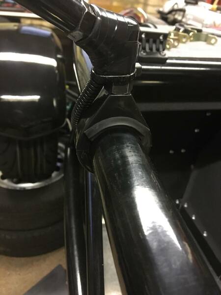

the brackets I used to fit the headlights and mirrors needed to be a tighter fit - I tried various bits and pieces to pack out the gap but settled on nicking the rubber bit off some spare P clips
mirrors are rock solid
headlights too
it's all about the details now :)

The problem with using spare wheels to support the car while I work on it
is what the hell am I supposed to do with them all now ?
anyone looking for a set of 15" steelies ?  I might be able to help :)

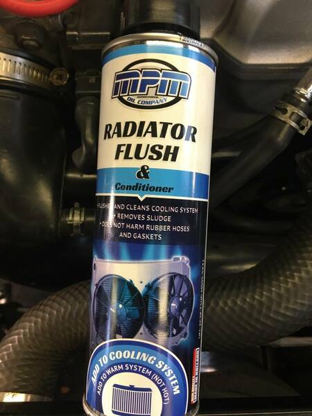

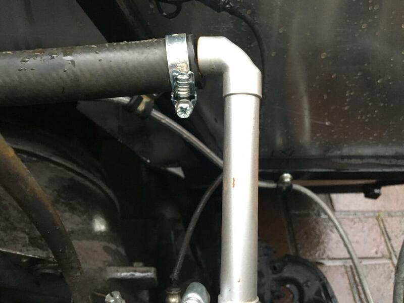

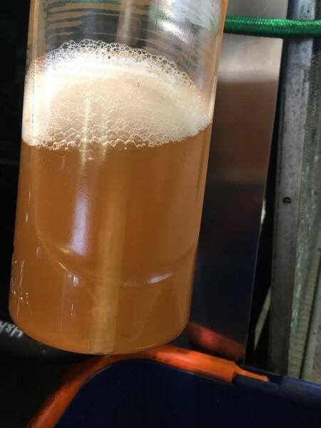

Tonight's fun and games are brought to you courtesy of MPM Radiator Flush and Conditioner !
when I fitted the engine, I filled it with plain water - over the course of several running cycles, the plain water has metamorphisised into something that looks an awful lot like an expensive pint I had in a trendy bar that I wasn't sure should look like that (tasted fine so I went along with it, still alive :) )
system drained and refilled with water
Gentlemen, start your engines
hmm, soda streamy
a quick check of the radiator cap revealed it was on its last legs so I nicked the good one of the mx5
added the flush
Temperature was achieved
i had a couple of cheeky runs up and down the street and then all hell broke loose
I wasnt quick enough with the camera but that heater bypass hose had totally blown off and was pishing steam all over the place, just as well I was outside in full view of the neighbours :(
the jubilee was a wee bit loose so I nipped it up, refilled and started again.
Several buckets of poundland iron bru have been extracted and it's starting to run clean. I'll order up a new rad cap, give it a few more rinses and eventually put some coolant in there :)

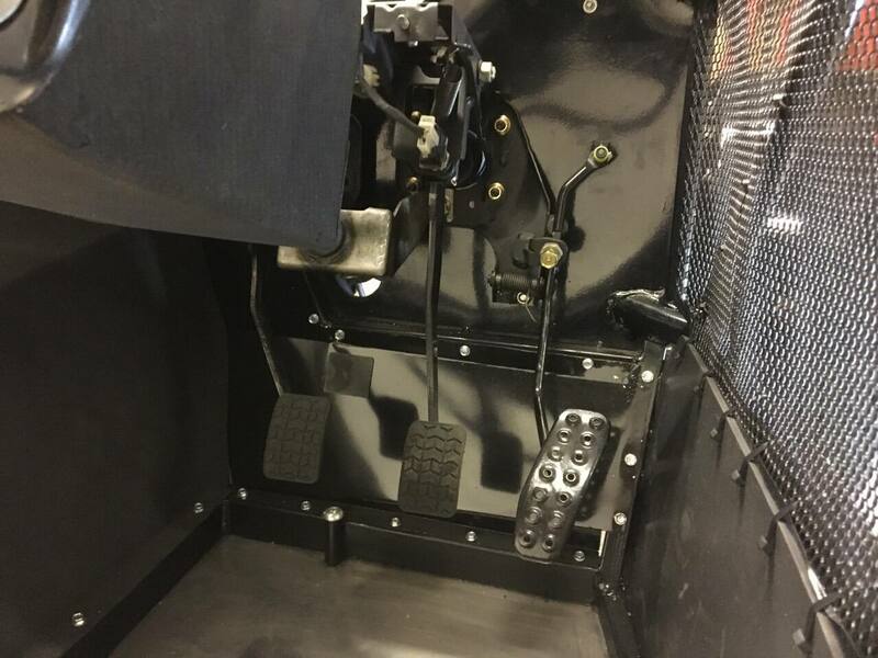

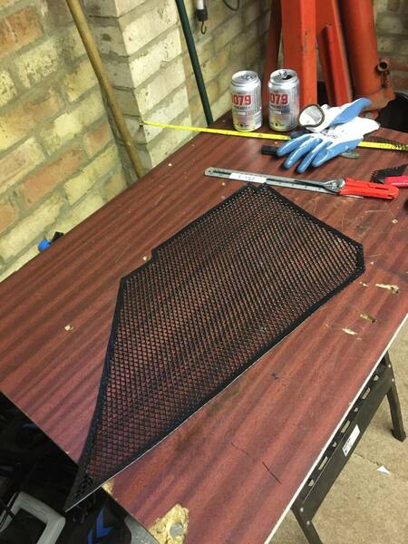

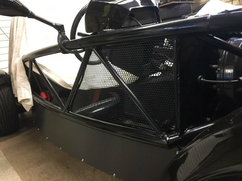

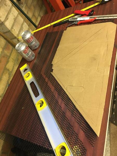

Blue Peter time again
A template was made
transferred to mesh and the edges taped
which fits neatly in here
to protect any hapless pedestrians from contacting my lethal looking pedals !
I would imagine if a pedestrian was that close, they would have more to worry about than getting tangled in the pedals
looks fairly neat
there is no need to do the other side but I think it would look odd if I didn’t. I’ll need to order more mesh off that ebay

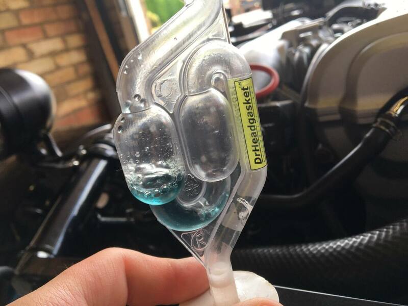

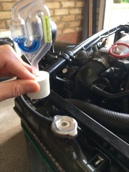

with all of that bubbling in the expansion tank, I thought I’d better double check this engine
An omghgf kit was purchased off that ebay
the bung was too big so I cannibalised the duff radiator cap and drilled a geet big hole in it
let the sniffing commence
five minutes later, dark blue has turned to a slightly lighter blue (but definitely not yellow)
no omghgf here then, thank goodness
just to test the liquid, I stuck a funnel over the exhaust and fed it some fumes
that’ll be yellow now then.
I’ve got a genuine mazda radiator cap ordered, aftermarket ones are notoriously rubbish, so will finally stick some proper coolant in next week :)
