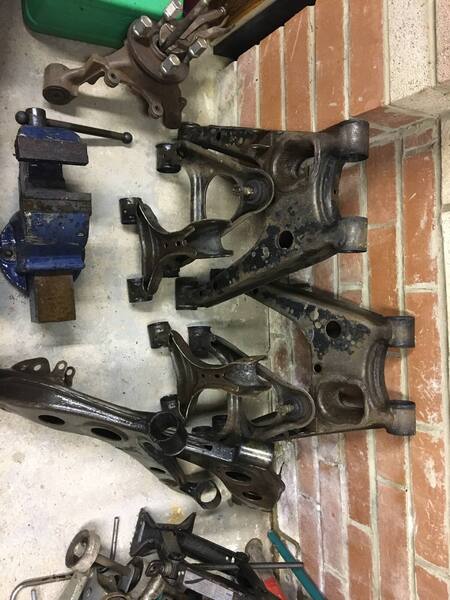

back in the garage, I tidied up the parts I did yesterday

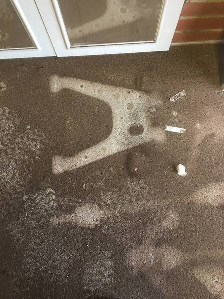

that floor might need a sweep
yep, definitely needs a sweep
ready for action
a couple of hours later I'd finished all the little bits and I was ready to tackle the big one :(
the difficulty here is getting in all the nooks and crannies, should be fine once painted
glad I had the mask on, it was spotless inside (grubby fingerprints excepted)
think I might have a shower before I go shopping for me mam

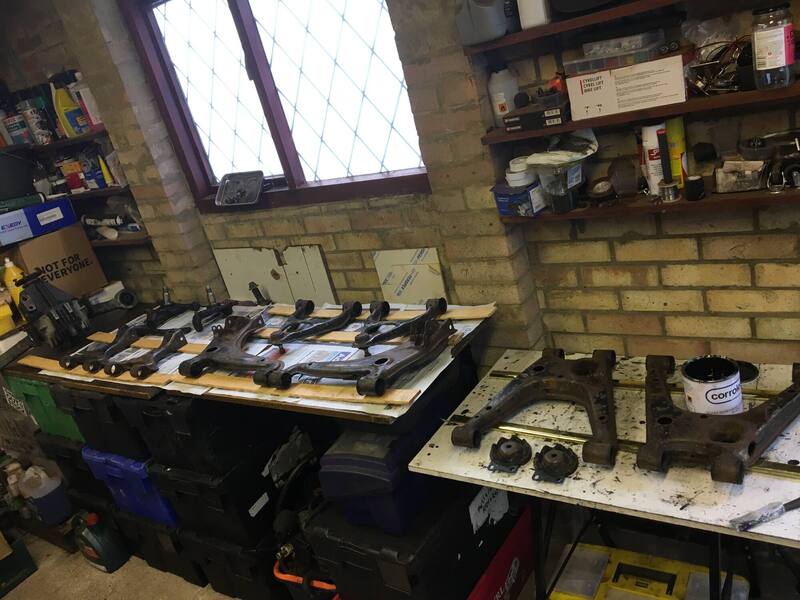

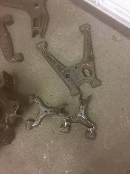

so that's both subframes, eight wishbones, four uprights, a pair of diff mounts and a brace bar all ready for paint.
what a horrible job, sand blast and powder coat next time, for sure.
That's why I used bilthamber stuff that you leave it to soak in .
Looking good though .

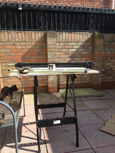

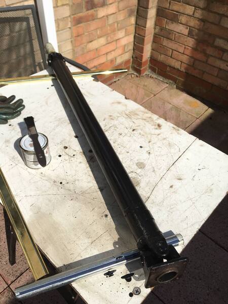

so I got my shaft out and gave it a jolly good clean
looks ok but as I had a can of engine paint handy
then I sat in the sun and literally watched paint drying :)

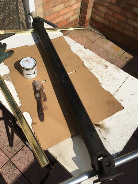

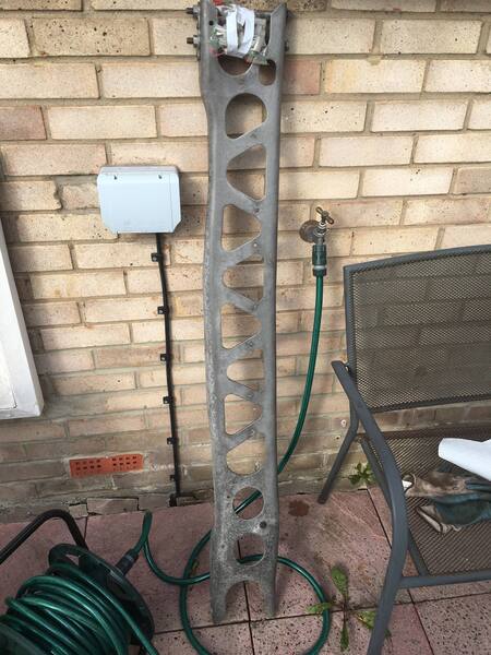

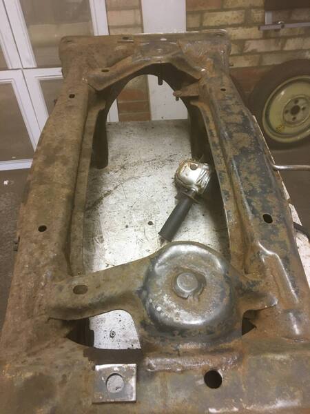

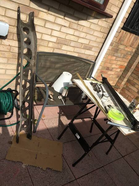

the power plant frame (the manky aluminium truss leaning against the wall) was in dire need of a scrub - the evil looking green stuff in the bowl was piss poor at shifting the gunk so a wee drop of petrol was needed
big improvement
I might give it a quick coat of wheel silver but it won't be seen under the car anyway :)

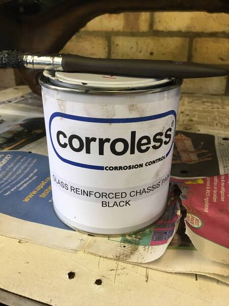

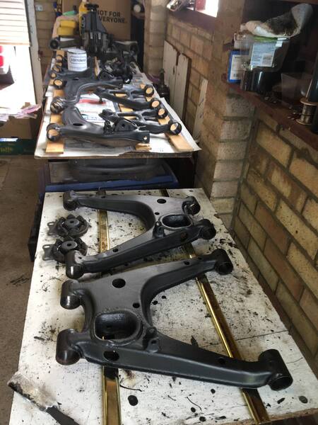

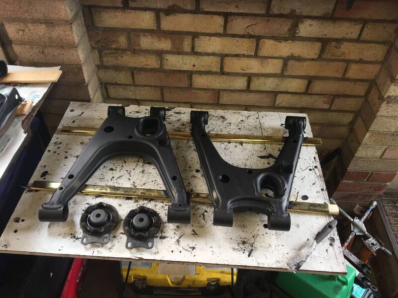

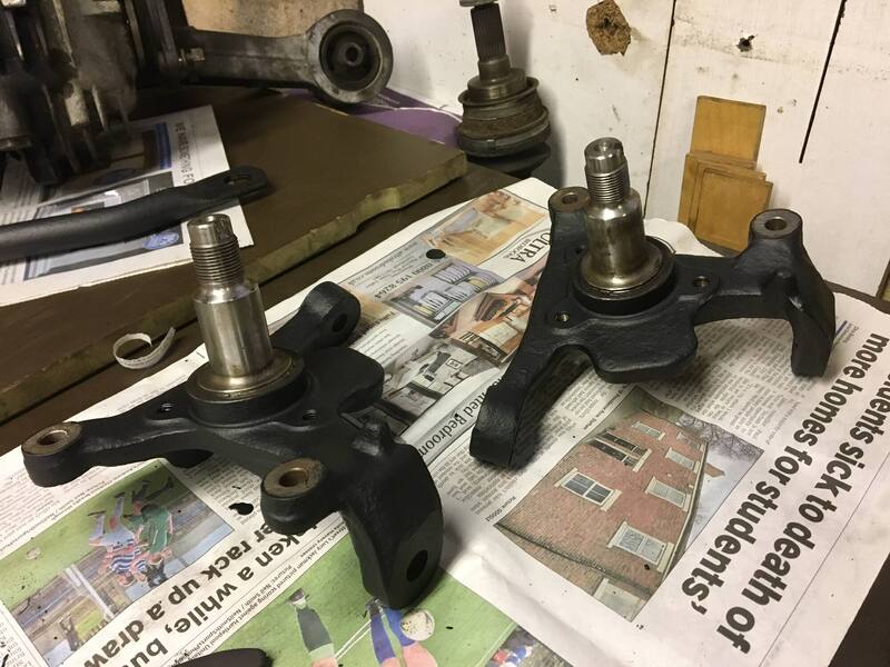

Moogs mega paint arrived today so I wasted no time and got stuck in
something easy to kick off, the front hub carriers - first coat on and they are looking pretty good

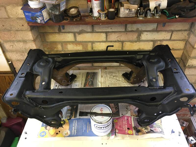

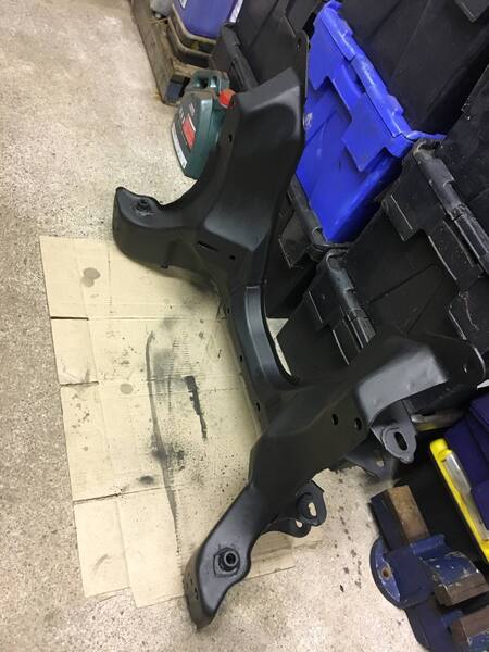

the front subframe turned out well too
the rear subframe was always going to be a challenge as it's an awkward shape and was a bit of a rusty mess
first coat on and it's not too bad
I'll need to buy a rattle can of this stuff to get into all those tricky corners
even with both garage doors open, the fumes were pretty strong - must be good stuff then :)

Does that paint supposedly kill rust or just hide it ?

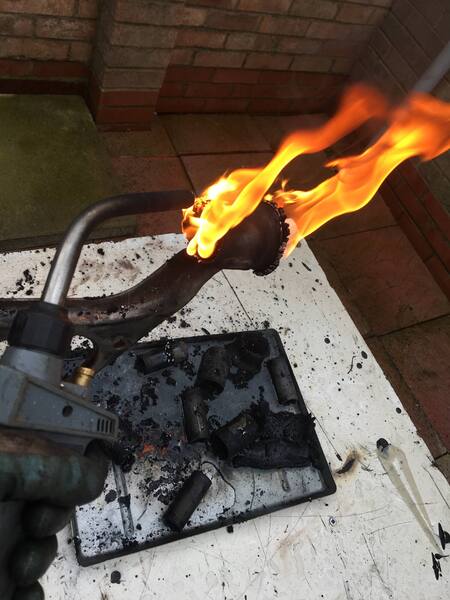

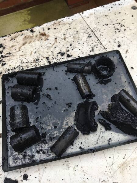

the weather was suitably crap enough today that the neighbours weren't hanging out laundry, gardening or barbecuing which finally meant it was time to get busy with @paulplom s blowtorch
yay, fun with fire !
casualties
survivors
another thoroughly unpleasant job ticked off the list

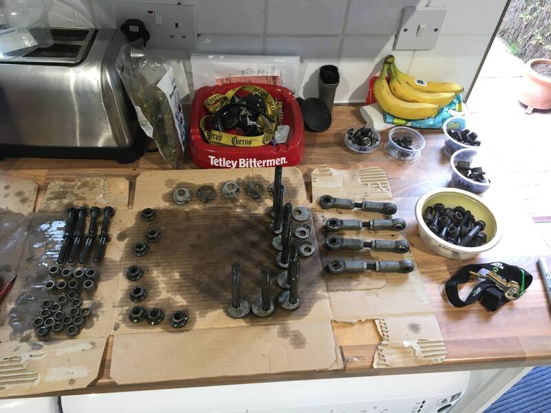

following from yesterdays bush removal session, I thought it about time I cleaned my nuts :)
these have been soaking in vinegar for a week, I rinsed them off and gave them a light coat of wd40 to keep the rust at bay
check out me fancy arb droplinks

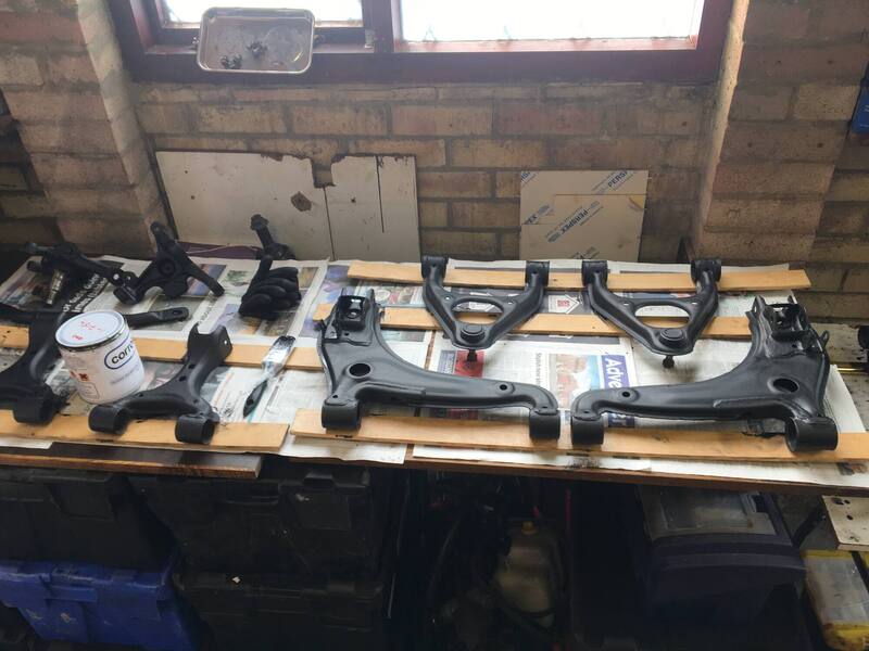

then it was time to set up for a marathon painting session
first coat on
i'll flip them over and get the other side after dinner, it's pretty quick drying this paint.

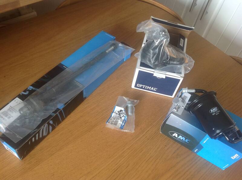

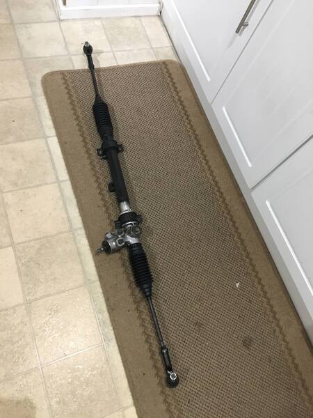

more parts have been arriving so I spent yesterday finishing off that steering rack
reluctant to spend £41.52 EACH ! on genuine Mazda gaiters, I opted for a universal set which fitted nicely once trimmed to suit.
rebuilding the rack turned out to be a mistake as its a bit of an awkward shape to store - it can live on the kitchen floor for now :)
Take the plinth off under the units and put it under there.
No tripping over it when you're pissed.

What's the paint like once it's opened, does it go off quick in the tin, or is it good for use in the future? I was impressed with the results of por 15 but coming back to it a couple of weeks later it would be solid, either that or the lid would be seized on!

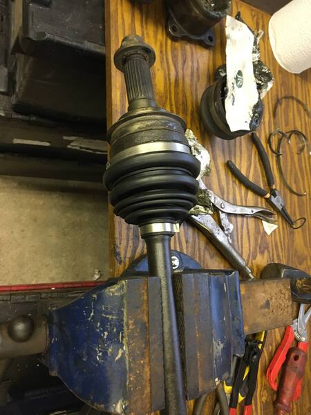

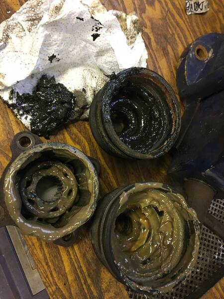

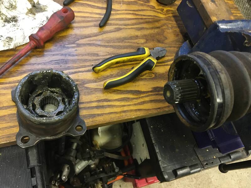

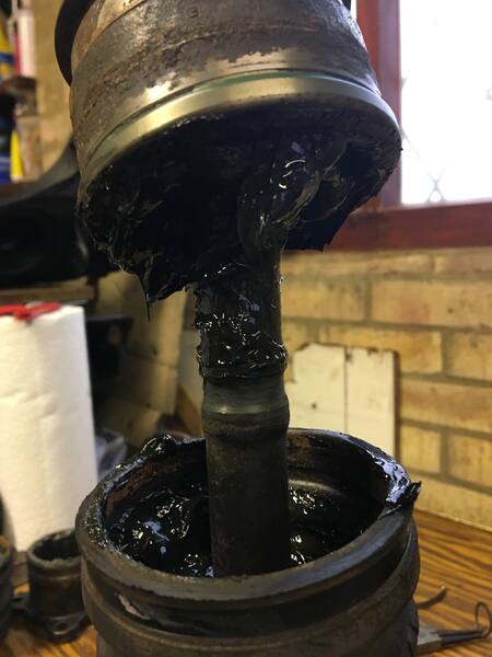

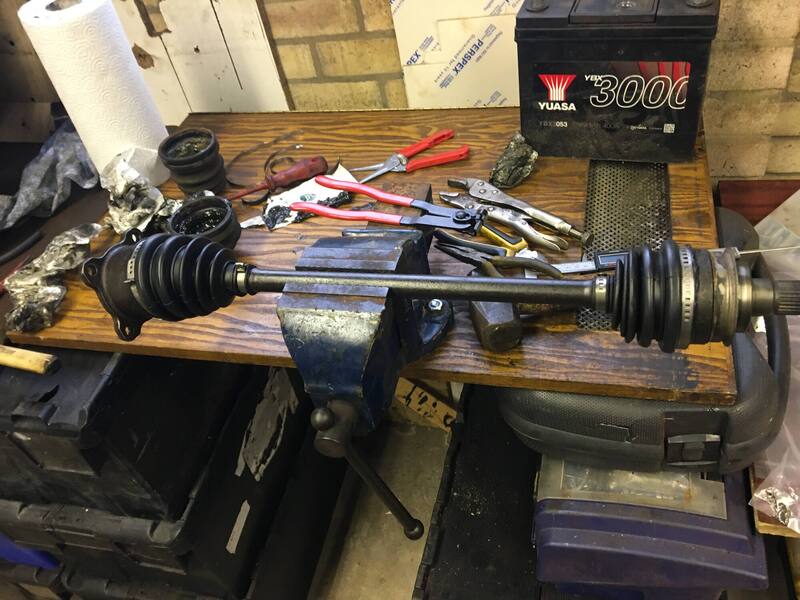

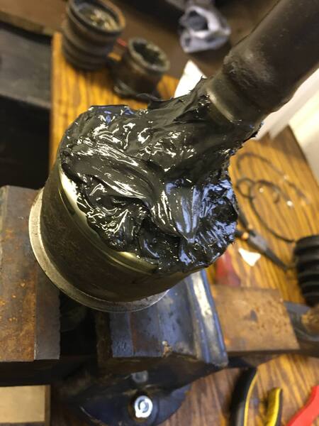

I've not done CV joints before so watched a couple of youtubes to see what was in store - looked simple enough, how on earth did this take three hours ? and the mess ? christ on a bike, what a horrible job, it will be new driveshafts next time
the actual joints seem to be ok, it's just the boots that need replacing
snip, snip
I finally got round to fixing the vice onto the worktop, car battery is there to counterbalance as the worktop is temporary

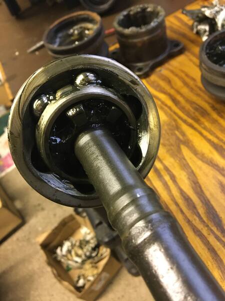

starting with the inner joint
a quick tap and the end cap is removed, revealing some pretty manky old grease
clean it off and the circlip can be removed
replace the end cap or this will happen and those "bastarding greasy malteaser bastards" will drop out and roll away under the car
bearings recovered, cleaned and replaced, end cap on and the inner joint can be removed

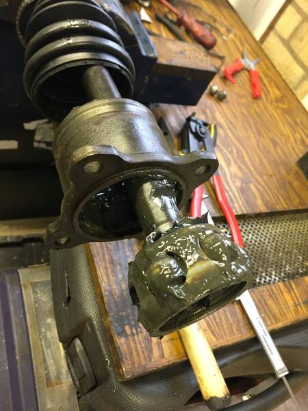

moving on to the outer joint, the bands were snipped off and the cover removed
looks like the aftermath of a weekend in Dublin :(
old grease cleaned out, plenty of new grease stuffed in and new boots can be fitted
a wee bit heavy handed here, I took some of this out
with a new boot fitted it was time for the Olympic level swearing to come in to play
what an absolute pig f*cker of a job these metal clips are to fit - thankfully I had the stereo on fairly loud as the naughty words were flying fast and furiously
there are a couple of pics missing as everything was covered in grease by now
finally all back together
what an utter sod of a job, and I'm only half way there. the drivers side is further complicated by the shaft being permanently trapped in the hub
but by now, my technique and language were well practiced and, as quick as a flash, we have
good as new(ish)

As for the paint, it probably will set in the tin as my used paint brushes are scrap the next day - my usual trick of wrapping them in cling film and sticking them in the fridge was futile.
I bought a 500ml tin which has done two coats on all of the wishbones and one coat on the subframes, I've another tin on order for those subframes and a rattle can for the hard to reach bits, there's various other bits (steering column, pedals and brackets etc) needing painted so I'll get my use out of it.
