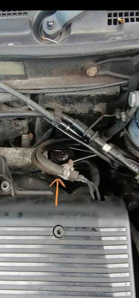

So, remember when I thought I needed a new heater control valve?
I was starting to take things apart to get to it, and as I removed these two pipes, I noticed one had split. And I mean almost snapped. The water was actually running down this pipe and dripping onto the HCV, and probably has been for some time!
Cut the end off, reattached and voila! No leak. I'll replace the pipe anyway, but relieved it was an easy fix. Also found out the boot lock is the same on both cars, so nicked the Fenlander one for now.
