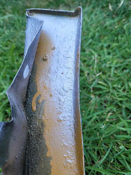

All dried and cured so I took the tape off and gave it a proper clean ready to admire
It's almost perfect, you can hardly tell anything
But the bit that was rotting out is protected and covered
So it might last the winter until I need to remember to replace it!

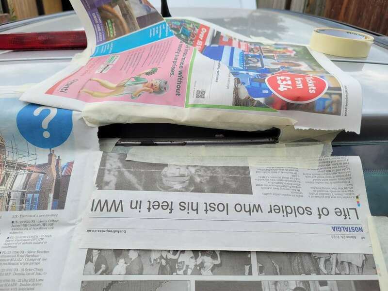

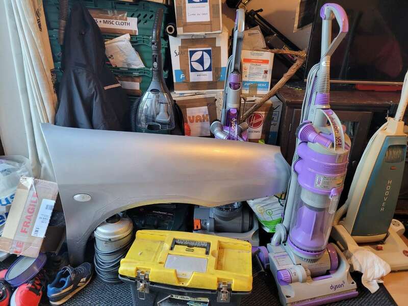

Was up early this morning before the rain hit, and the krust had done well! The last thing I hit yesterday was this bit here, a point of the inner frame that's always scabby and shitty on zx's/xsaras from screenwash spillages! I cut the entire section out and fabricated a new piece*

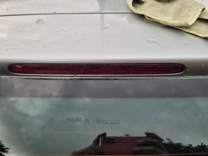

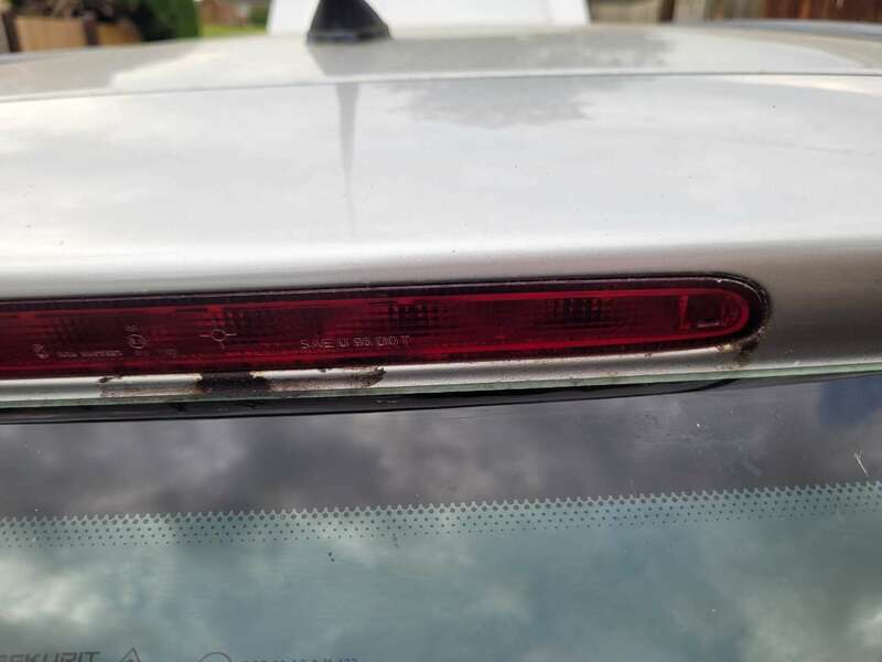

Perfect! I then removed the high brake light and masked off another annoyance I had, since the spray paint is a 74% match it seemed silly not to
I'd krusted it yesterday as well and did wipe it down with a rag before spraying 👍

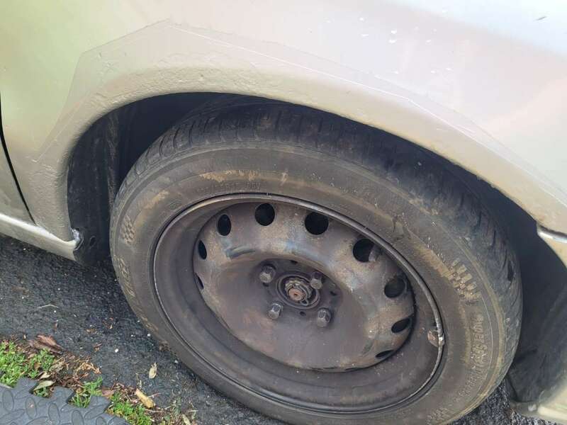

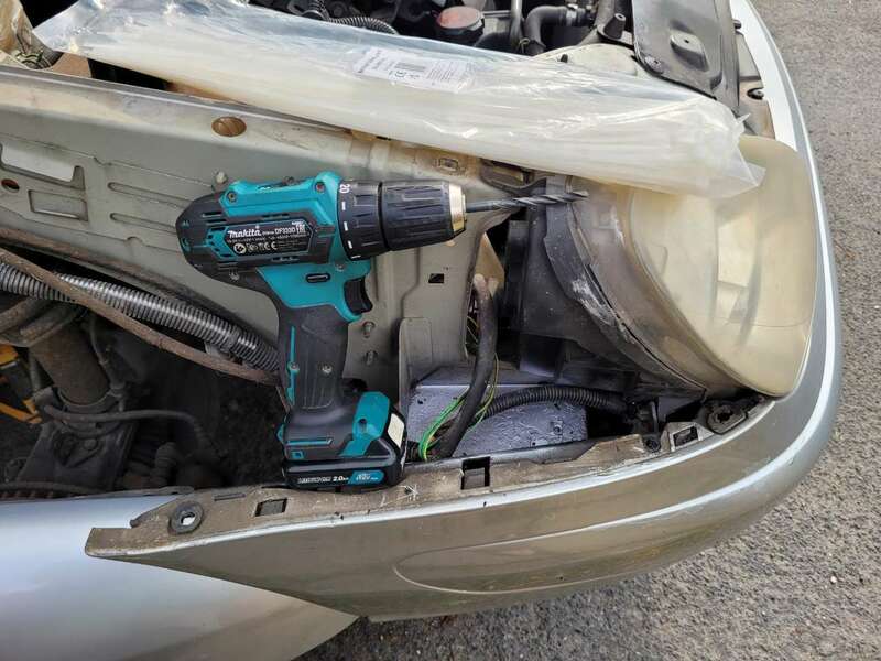

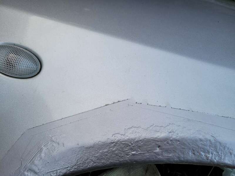

That drying I went back to the wing, the sky growing darker and with 7 cable ties only got it fitted
Probably should have taken the time to drill some bolt holes too but I tried not to butcher it too much (2 little holes) for when I'm back here hopefully fitting a better wing with its bracket!
It then fucked it down with rain as I was fitting the arch liner. Did that, got the tools in, dried off then remembered the paint, luckily it dried (was only a light waft) before it started
Good enough, again I just didn't want a shitty little hole forming without me realising
I also did a small touch up. What problem could possibly be caused by a perfectly square piece of paint?
Got to chuck the wheel back on in a bit, it's stopped raining now but I've cleaned up a bit so will do that later

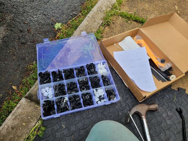

There we go, back together and I got fancy and got the box of fixing out! They were shit for the rear interior plastics, let's see if their better for the arch liner! Was nice to bin the 2 really shit ones and replace the 2 missing ones and put the others in the place they were supposed to go, the entire lot is alot firmer than it was before I started!
Put the wheel back on and you'd never know it was sketchy as fuck...

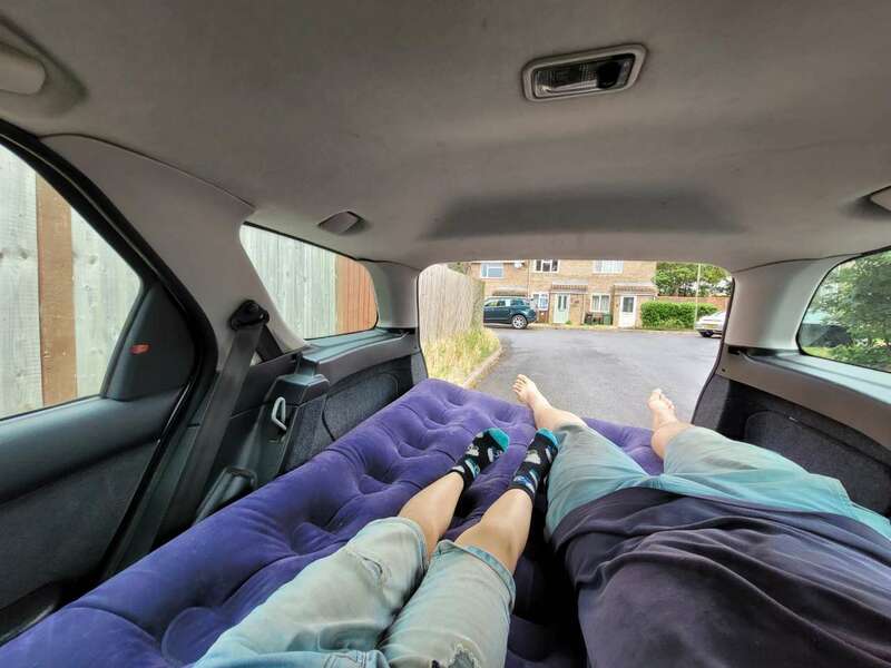

I then turned my attention to the future, and got the back vacuumed out and worked out that if I unbolt the seat base the backs lie flat, then a bit of wood bridges a gap, add an airbed and
That'll do! Wanted to experiment more but there's now some children, not all mine using it as a den, so I got the airbed out and left it for now! Not sure if I even need to put the seat bases in, probably should incase I NEED to go somewhere with the kids

Great work! Next time you’re spraying a section like the arch on the wing, rather than masking off with the tape flat against the panel use wider masking tape and curl it back on to itself like you’re trying to make a tube. This will mean you’ll get a softer edge when you paint.
Noted, thanks! If I ever find myself needing to do it again I'll try it! (or I'll have a go on that one day, for now it'll get so filthy driving to sf it's fine 👌

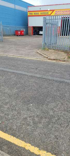

Phoned the number and offered to go to the Aylesbury branch if that would be quicker, and 20 minutes later had an appointment for 12pm tomorrow. Fine, I can do that.
5 minutes ago the Aylesbury branch phoned me, their bloody compressors broken, and if its not fixed early tomorrow they can't fit my tyres... I asked about would I be able to have it done my a mobile again and almost have my prior slot back and bunk off another day in the office and am awaiting a call back.
Its never easy is it! I can't even offer to have them done at the office as that'll be from a different hub branch which I know will confuse things even more.
Friday... My ultimate deadline is Friday at 10am 🤞🤞
  • Sad 2
Phone call returned. The mobile van is off the road properly, the guy hit a drain cover and ripped bits off... Fine.
What's going to happen apparently, is I'm turning up at 12. They'll either have the compressor sorted, or they'll take my wheels over to the Halfords autocentre and do it there and come back!
Seems reasonable, as long as I come home with new bloody tyres I don't care. We'll see, and I'll have mcdonald's for lunch

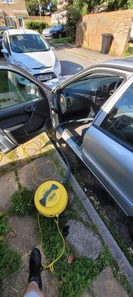

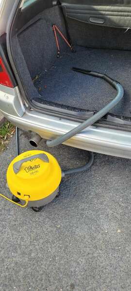

The sun was out when I got home from work at 4.30 so I parked on the road and got a vacuum out!
The white fiesta has been there 3 weeks with a flat front passenger tyre...

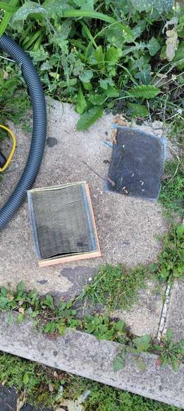

I also vacuumed the engine bay as it was full of hay (followed a hay trailer 9 miles home the other day) and leaves, and peeled the last layer of my air filter off. Been good valu that bosch one, might splurge on another in 6 months time.
Shite cleaned out of the air box too which was good.

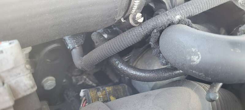

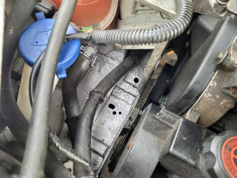

From that angle though I did note these oily pipes. Are they vacuum lines or breather hoses? Is it remedied by removing them one at a time and firing some brake cleaner though? Or TADTS?

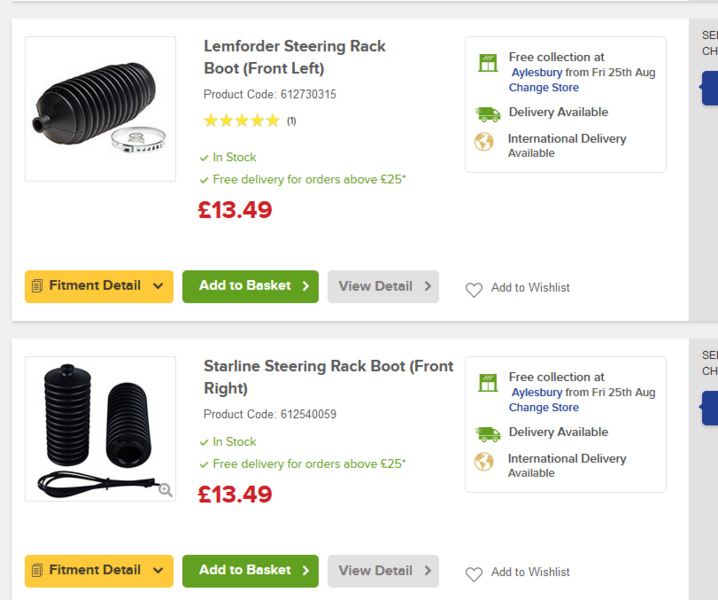

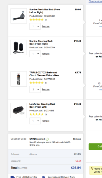

Currently having a total brain fart over which one I need... I think its the top one? (is it left/right as im looking at the front of the car? IE Left/Drivers?
But overall yes, thanks I agree of all the things a 22 year old french car could fail on I'll take a gaitor that I've been near before (did inner tie rods on both lagunas and had to remove and refit these so it's not too scary. Have a plan on fitting it too once I order the correct one... 😂
It's normally taken from where left/right would be if you're sitting in the driver's seat in my experience - as in to match left indicator and right indicator. I would take 'right' in those listings to mean offside.
I'd agree - from my long-distant parts desk monkey days, 'left' and 'right' are based on a driver's view.
I used to use 'offside' and 'nearside' but that just seemed to confuse people even more, so I tended to stick to 'drivers side' and 'passenger side' when trying to work out what a customer wanted.
Which all worked fine, until the lad with a VW Passat B3 estate rocked up wanting a front wishbone... local plate but, as it later turned out, left-hand drive...
Fab, the right one looks easier as its just cable ties too!
I was wondering what the difference was, but I bet the pass side has a longer/split driveshaft, and I should thank my lucky stars I don't have to do that side (yet).
In classic bank holiday weekend one shot no plan B parts bingo, I shall order a RH one 👍
Or is the smart thing to just bloody buy both and return the one I don't use...
Seeing as it's a bank holiday, the answer is: c) buy both and during the job realise neither fit 😅
Ha, regardless I'm buying both and a track rod end just in case...
Doing so gets me over £40, where a £5 voucher comes in
Assuming I can return one gaitor and not use the TRE the gaitor and 2 tins of handy brake cleaner will cost £14.26... And brake cleaner is always handy to have!
TBH I'm a little fuzzy on how a steering rack gaiter can be handed anyway; aren't most concentric?
