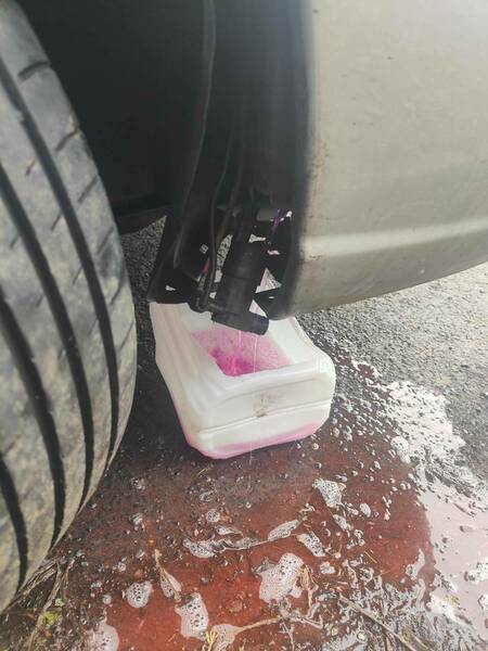

I have screenwash again!
It died on the way to work Monday, so I ordered a new pump, which came yesterday.
Nice and quiet at work/I've done so many hours these past couple of weeks for no extra pay I could have all next week off and still come out on top so don't feel bad.
Only the finest quality parts here!
Peeling back the arch liner and cutting 1 cable tie gave me the access I needed, so I pulled the old pump and saved the fresh screenwash I'd filled it with the prior Saturday...
Fitted the new pump, sloshed a bit back in filtering it through a microfiber cloth as I went as there was some dirt that came out and... It leaked!
Out it all came again, I tried again and it still dripped. Ffs never mind does it work? No.
Got the multimeter out and there was no juice at the wires
Turns out it was the fuses, I was just looking at the wrong one (because the diagram in the manual bears zero relation to the fuse box I have.) Borrowed a 10a from somewhere else and 12v was restored.
Back out with the new pump, and I fitted it back in with the old rubber seal and it's not leaking anymore, and the washer jets are a shit load more powerful now! The old pump was knackered, between leak 1 and after the multimeter shot above I refitted the OG one assuming the new pump was just shite quality, changed the fuse from something else and it fired it once and blew the fuse again. Old seal and new pump sorted it
Also noticed the last proper fixing for the undertray had gone awol and it was flapping in the breeze like so many golf's and insignias I see on the m40, so I deployed more cable ties. There are now zero proper fixings holding it on, and it's probably stronger for it!
Need to go into town at lunchtime and get more fuses (no idea what I robbed a fuse from and I don't care for now) and it should be good to go again! I'm also dripping wet after laying in mud and screenwash to fit the pump and sort the undertray.
Almost 174k on the original pump, and I've had it empty and frozen many times so I'll forgive it. Hopefully this new one lasts at least a year

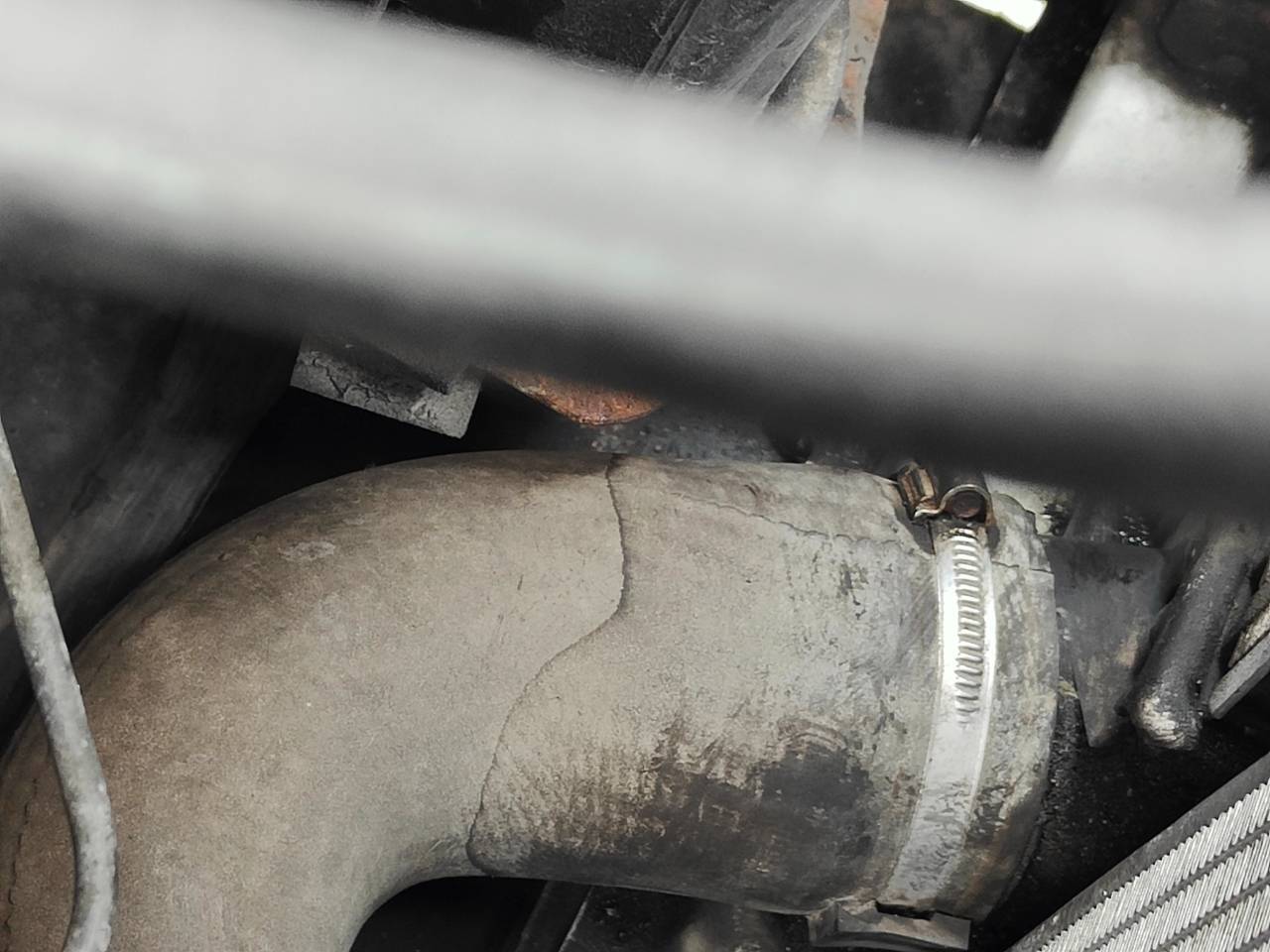

I'd bought a tin of brake clean during the week, and went outside to have a look at some rubber pipes. It's been mostly fine but did loose the turbo twice during a 400 mile trip I did last Saturday... Again on and off the throttle (changing up a gear in reality but I think it's coming off and on the throttle that's doing it) fixes it and that's that!
Cleaned off the weeping from the bottom intercooler hose and my eyes are sure they see a straight line running from the edge of the hose and up a bit. Not the circular line of the last layer of hose, it's not really clear on the photo. Gave it all a good squeeze and nothing was immediately apparent.

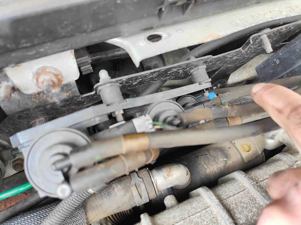

Next was this hose coming off the back of the engine and running down the side of the block. I've read about this on a few forum threads.
It's rock hard at the top, then goes very soft and squishy as it passes past the cambelt covers and goes to whatever metal thing I felt it clamp to. Engine was stone cold.
Didnt fancy removing pipes right now, they all feel 'old' and am sure will fuck up as I remove them and not seat properly when I refit. Going to see how much new hoses are and maybe treat it to them as a mild parts cannon guess.
I did notice the bracket that holds all the vacuum things in place only had 1 nut...
I'm lacking any suitable nuts to use (what size would this use? Wouldn't hurt to get an assorted sized set as I've found this alot as I work on it 😂). In leiu of anything proper some cable ties snugged it down well enough

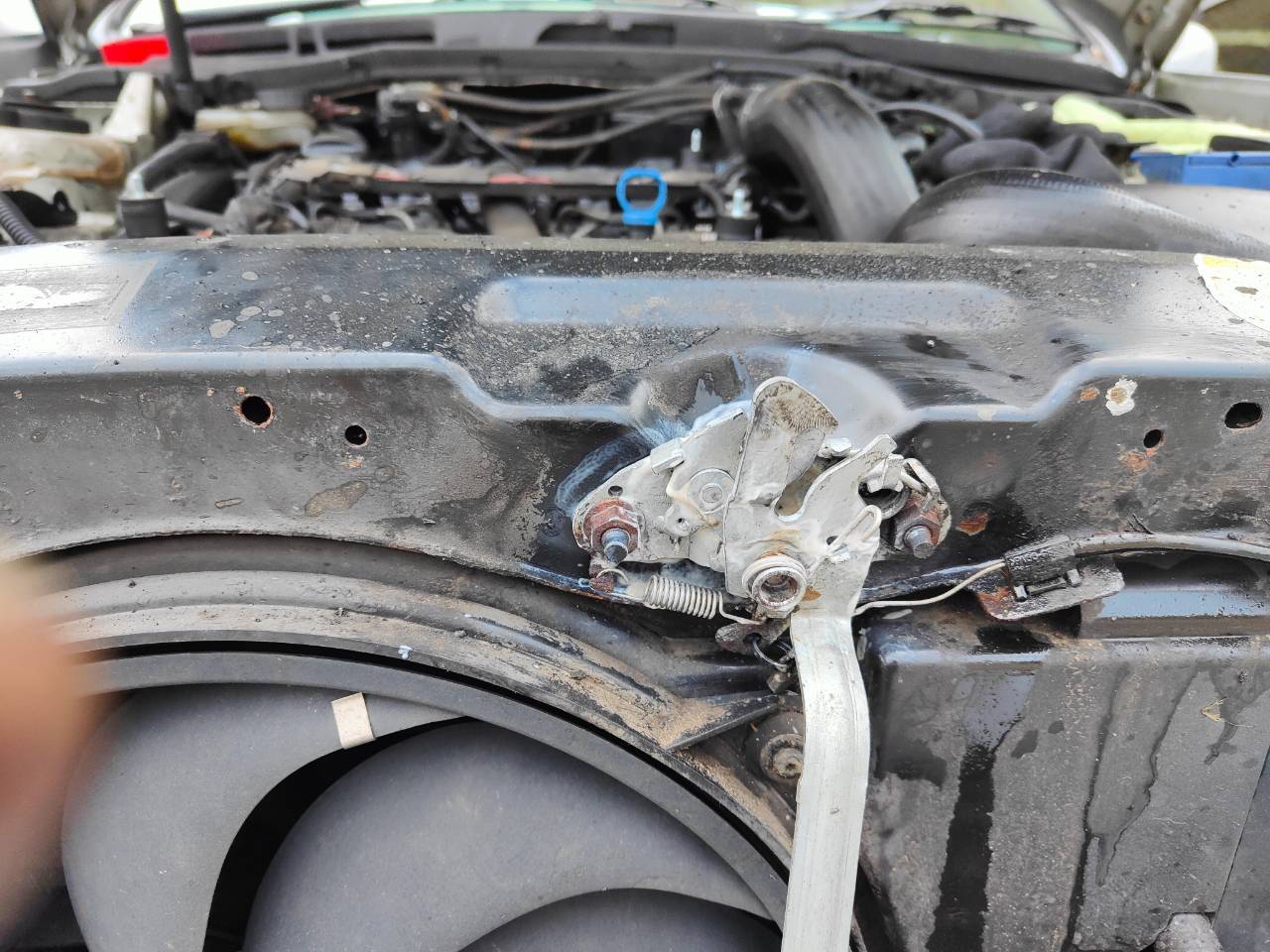

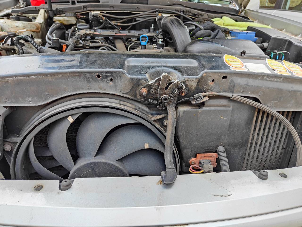

Still at nill-nill on the day I remembered another annoyance, the bonnet latch. It's always been mushy and a bit meh to open, but more alarmingly recently it's been a sod to latch shut. As I was working on the above I fired some brake clean at it, and 5minutes later it had shit itself
Noting the trim piece covering it only had 2 fixings left and I've got a whole box of those I took it off and found a disgusting lump of shite
Bonnet cable looks happy m8

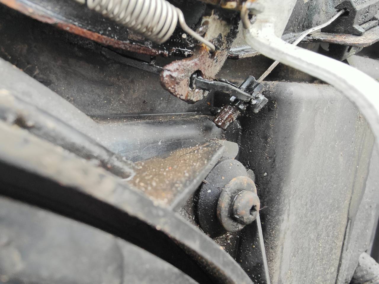

I cleaned it off and flushed so much grit out with some small brushes I have
(and scrubbed the bit you push to open the bonnet so I don't get filthy fingers topping off screenwash 👌)
This revealed a structural cable tie
I've no idea what the end of the cable is supposed to look like but I assume part of it is snapped?
Whatever, the cable tie that was there was working fine so I simply replaced it with a new one with just a bit less slack built into it's placement
Then a good coating of lithium spray grease on the latch
Bonnet has never worked so well 😂 Closes with the lightest of drops with a nice quiet thunk from the latch. Pulling the lever inside the car the bonnet now pops up a tiny bit whereas before it didn't and you just got used to sliding your fingers under the gap onto the lever.

2 hours ago, beko1987 said:
That to me looks like a coolant hose going into an EGR cooler?
The corrugated pipe roughly 1cm down and to the right of your finger in that photo should be EGR related which tells me that's a coolant hose
Ah! Maybe, I'm going in blind here! Need to read up on the engine and see what pipes go where, might find a Haynes that covers it and the year.
Someone on the fb group agrees with me that it's probably some pipe sucking itself flat somewhere waiting to split though. Was hoping it might be that one, it's not too tricky to access 😂
They could be on the right lines, if a vac pipe has got saturated with oil residue it could be doing that, check the vac lines going to turbo waste gate, EGR etc. could be a bit tricky and messy because it's all buried away on the DW10
A bit of oil residue is typical around boost pipes, yes it's a leak but it's not going to cause a complete lack of boost.
