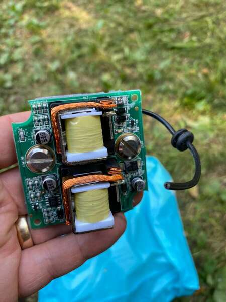

around halfway through my fridge battery stopped charging as this
had become totally insensitive and unfeeling. Inside was complicated
so I binned it in favour of a standard relay triggered off the charge light. Cold drinks and a less like warm sausage was achieved again.

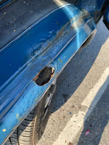

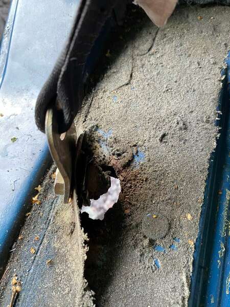

Time for a wash, but the jet washer dislodged a little chunk of paint, and then a little bit more:
hmmm, looks a touch rusty underneath, and a bit of filler/fibreglass, which wasn’t me. I’ll just give it a quick brush over and put some rust killer on:
Not sure rust converter works on air. Let’s just check round the back:
Oh ffs.

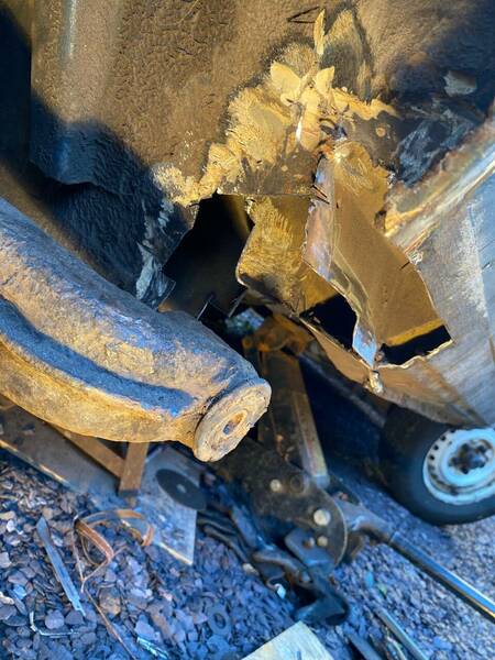

my trailing arm appears to be held on by a few scraps of rust and some strings of underseal.
Luckily I can buy a new mount all neatly fabbed up in 4mm steel, so just need to do a bit of cutting, welding and swearing and it’ll be like new.
Probably best leave it in the jack for now!

Hmmm, one is not like the other:
still searching for that elusive solid bit that I can weld some new bits to:

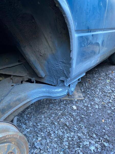

Two long days of cutting, welding and setting fire to things (mainly underseal, the sleeve of my overalls and my angle grinder that self combusted) I have done it:
and better still it actually works:
despite knowing that there is a shed load of new steel in there replacing the rusty scraps and it being so much stronger I always get the fear when I first lower it down.
It needs a touch of filler and the seam line reinstating on the side, but I have plans to paint it this summer so it’ll do for now. Wing is also crusty throughout, especially the return lip so more to be done in that as well.
