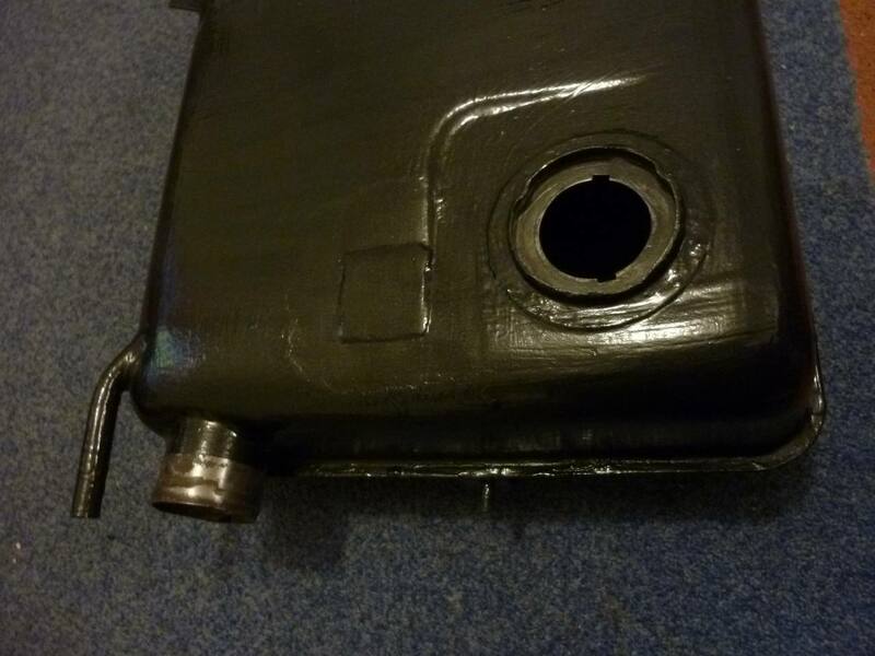

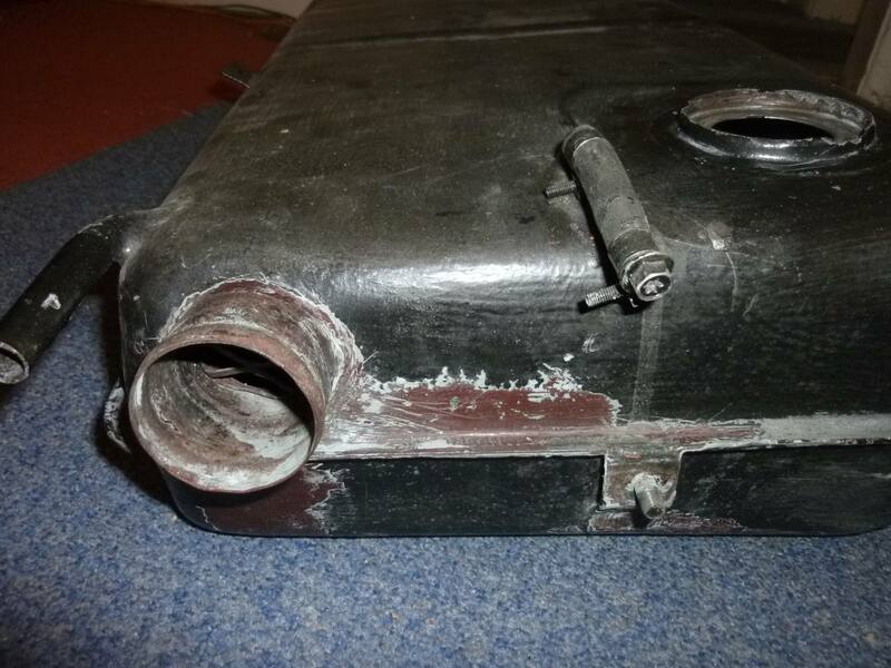

bobdisk Posted December 25, 2020 Posted December 25, 2020 One of these might do suitable number plates; https://www.tippersvintageplates.co.uk/ http://www.tipper-signs.co.uk/Contact Us.html Tiddles the Kitten has fuel tank problems. The steady-ing lug on the long edge has been cut off for some reason, (see pic) this allows the tank to swivel like a hammock on its end mounts! Dangerous !! But the remainder of the lug is still there, so I must find someone who will weld a new lug back on. The rest of it is ok, except that a new filler pipe is needed. The whole tank has been painted, including the filler input. So the petrol melted the paint there, and it started leaking first time I filled up. Also need a new gauge sender, the fuel pick up connection is mounted on it. This pipe connection is broken. https://www.reliantpartsworld.co.uk/reliant-robin-rialto-850cc-fuel-tank-made-in-uk-26637 Too expensive when I only need a repair! Its a peculiar arrangement. A cars fuel tank usually has straps holding it to a flat surface, or is fixed by its edge joints. Perhaps something like this, held in the boot by straps. https://www.amazon.co.uk/Marine-Fuel-Static-Portable-Outboard/dp/B083M5VRF4/ref=sr_1_34?_encoding=UTF8&c=ts&dchild=1&keywords=Boat+Fuel+Tanks&qid=1608888531&refinements=p_36%3A389116011&rnid=389114011&s=sports&sr=1-34&ts_id=469892031
doug Posted December 25, 2020 Author Posted December 25, 2020 My radiator never turned up. They said that they posted a replacement and it never turned up either. I left messaged on their answering machine and they never replied,same with emails. Eventually I had to request a refund via paypal which to be fair was returned right away. Its just when you dont get replies from contacts it gets a bit worrying. I eventually got one from another supplier within 3 days of ordering. My petrol tank was the same as yours. Mine had rusted off. But there was enough of the tang left on the tank to drill a hole through it and bolt a strap on. Also the fuel pickup pipe on the sender unit had also rusted off same as yours. I drilled it out and soldered a bit of copper brake pipe in its place.

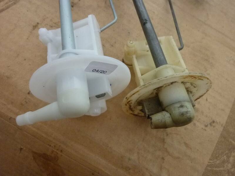

bobdisk Posted December 25, 2020 Posted December 25, 2020 5 hours ago, doug said: My petrol tank was the same as yours. Mine had rusted off. But there was enough of the tang left on the tank to drill a hole through it and bolt a strap on. Also the fuel pickup pipe on the sender unit had also rusted off same as yours. I drilled it out and soldered a bit of copper brake pipe in its place. The gauge sender is all plastic, including the fuel pick up, on my, and the new one. The tank's lug is definitely cut off, leaving a bit on there, and another new one welded on the opposite side. There is also the remains of a pick up soldered to the top, but rusted inside. I will take that off and solder a blank over the cleaned up hole. (Pics to come) The tank must have been modified for something else, the recovered for the Kitten. Trouble is, I cant use the car until this is sorted, that why I contemplate a marine tank inside. https://www.reliantpartsworld.co.uk/reliant-robin-rialto-fuel-tank-sender-unit
bobdisk Posted December 26, 2020 Posted December 26, 2020 Pic 1 , The lug, cut off. Pic 2, Where petrol leaked out at the filler, and the odd pick up. Pic 3, Broken pick up on gauge sender. Pic 4, The odd lug, welded on the wrong side (for Reliant) and the odd pick up. tooSavvy, LightBulbFun, rainagain and 1 other 4

bobdisk Posted December 27, 2020 Posted December 27, 2020 Thats what I intend to do ! And take that extra pick up off, clean up the rust around it (visible inside with a mirror) , and put a patch over the hole. (solder or braze) LightBulbFun, tooSavvy and bunglebus 3
bobdisk Posted January 25, 2021 Posted January 25, 2021 Its done, and ready to fit, if the weather is not too cold! rainagain, uk_senator, Dan302 and 4 others 7

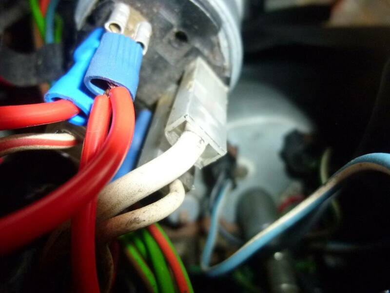

bobdisk Posted April 18, 2021 Posted April 18, 2021 First Journey ! Spring Kitten is for a photo competition at work. Theme is "spring" !! The wiring on the ignition switch is an example of what I found throughout the car. Wrong size crimps for the wire. Not properly crimped, most just pulled out. Looks like they were done with a pair of pliers instead of a crimp tool. Looks like theres been a burn as well. Dan302, RayMK, doug and 4 others 6 1

LightBulbFun Posted April 18, 2021 Posted April 18, 2021 1 hour ago, bobdisk said: First Journey ! Spring Kitten is for a photo competition at work. Theme is "spring" !! The wiring on the ignition switch is an example of what I found throughout the car. Wrong size crimps for the wire. Not properly crimped, most just pulled out. Looks like they were done with a pair of pliers instead of a crimp tool. Looks like theres been a burn as well. very cool to see you got her back on the road if all the electrical wiring is that bad, then perhaps you might want to invest in one of these avoid RSI! LOL

bobdisk Posted April 18, 2021 Posted April 18, 2021 Had this tool for ages! The crimps in the bags on the left are heat shrink, crimp on then heat the sleeve. Box are bullets, and other bag are bits I have picked up at work. Seen that motorised tool before, too expensive, even work would not consider it! LightBulbFun 1
