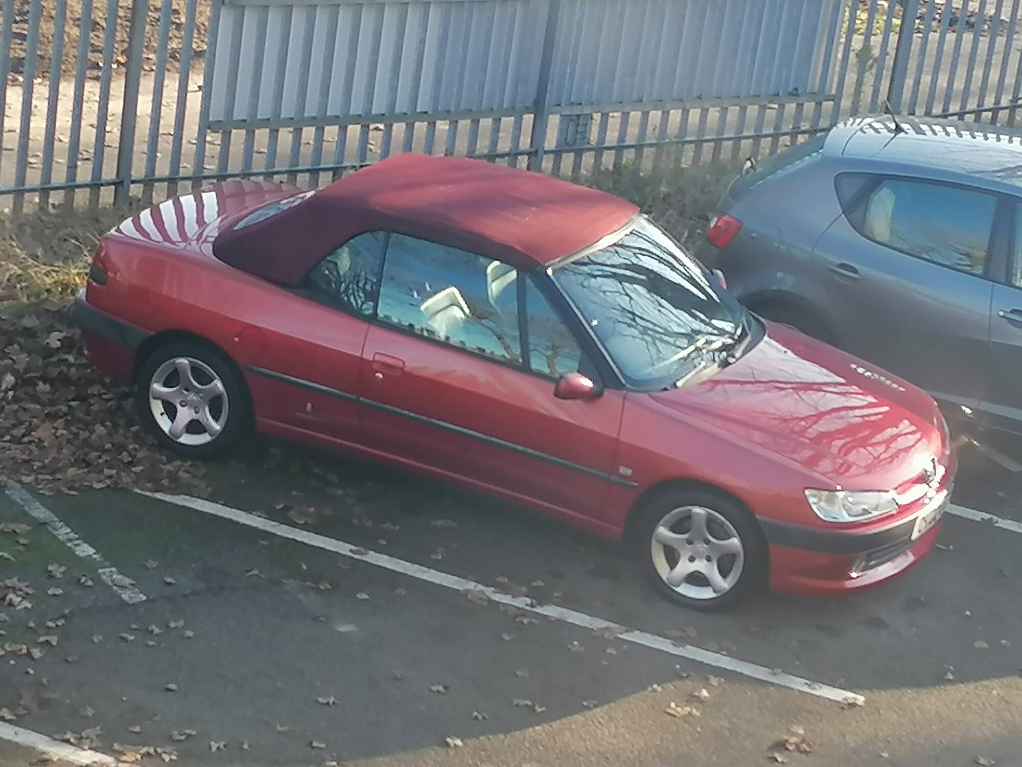

The colour coordinated hood was an extra cost option. Looks very smart. ? The side trims are actually hard plastic with a painted coating which fades over time. Back to black doesn't work on them because of that. A quick mask, key up with scotchpad and a dusting of satin black will return them to as new. ☺️

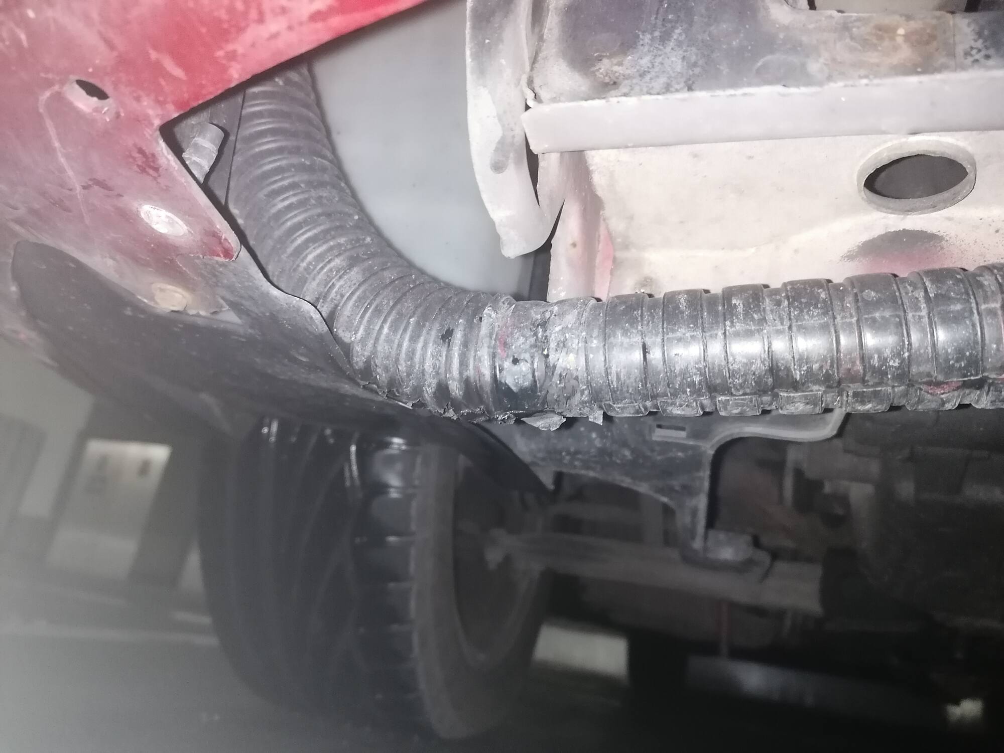

Hope I haven't broken anything important. Hit something on the ground on a ramp...
I think that's just a conduit for wires and not a pipe of some sort!

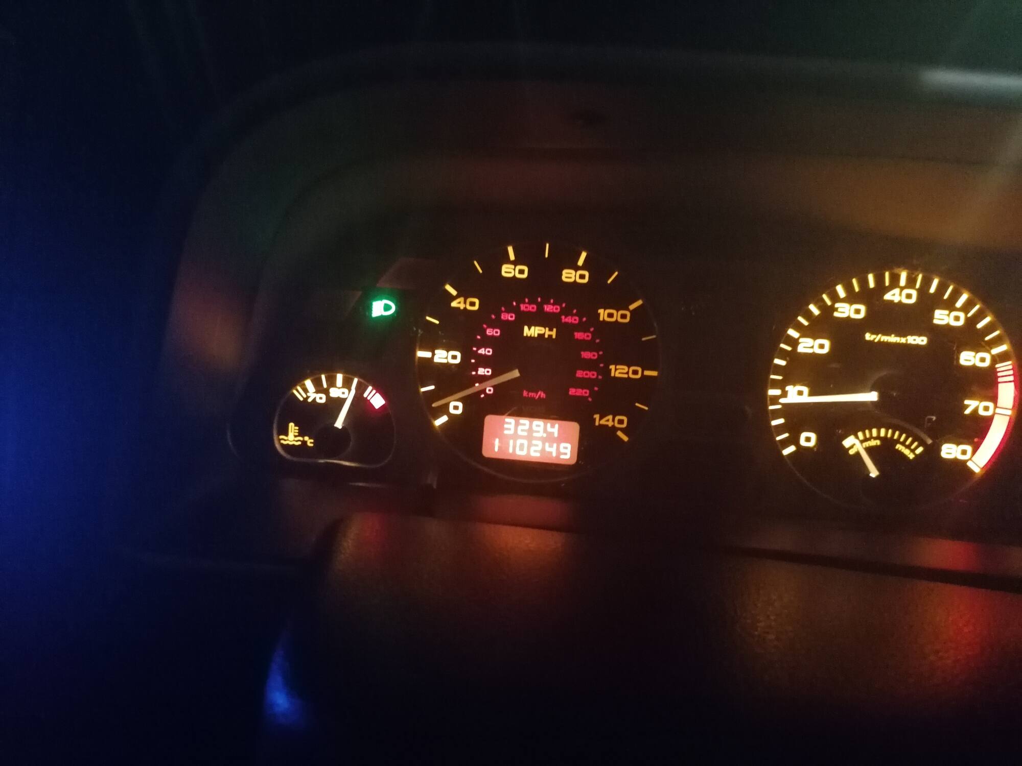

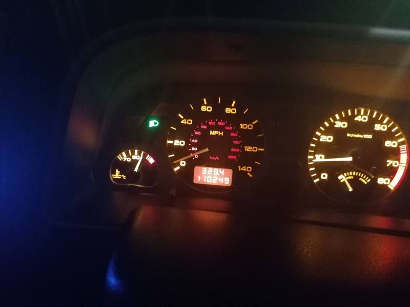

31 minutes ago, TheDoctor said:
Temperature gets scary in traffic...
It did that to me so scary replaced the relay.  It worked for a bit then did it again, I cleaned the contacts for the relay and it was fine.  Time to clean it again!
What relay?
It's easier just to stick a Rizla over the gauge in my experience.
56 minutes ago, TheDoctor said:
What relay?
The one of the left, I think.
Do you think I damaged something when I hit the bottom of the front on the ramp maybe?
Just now, loserone said:
No.
I mean maybe, but not to cause that, I probably just did a shit job
