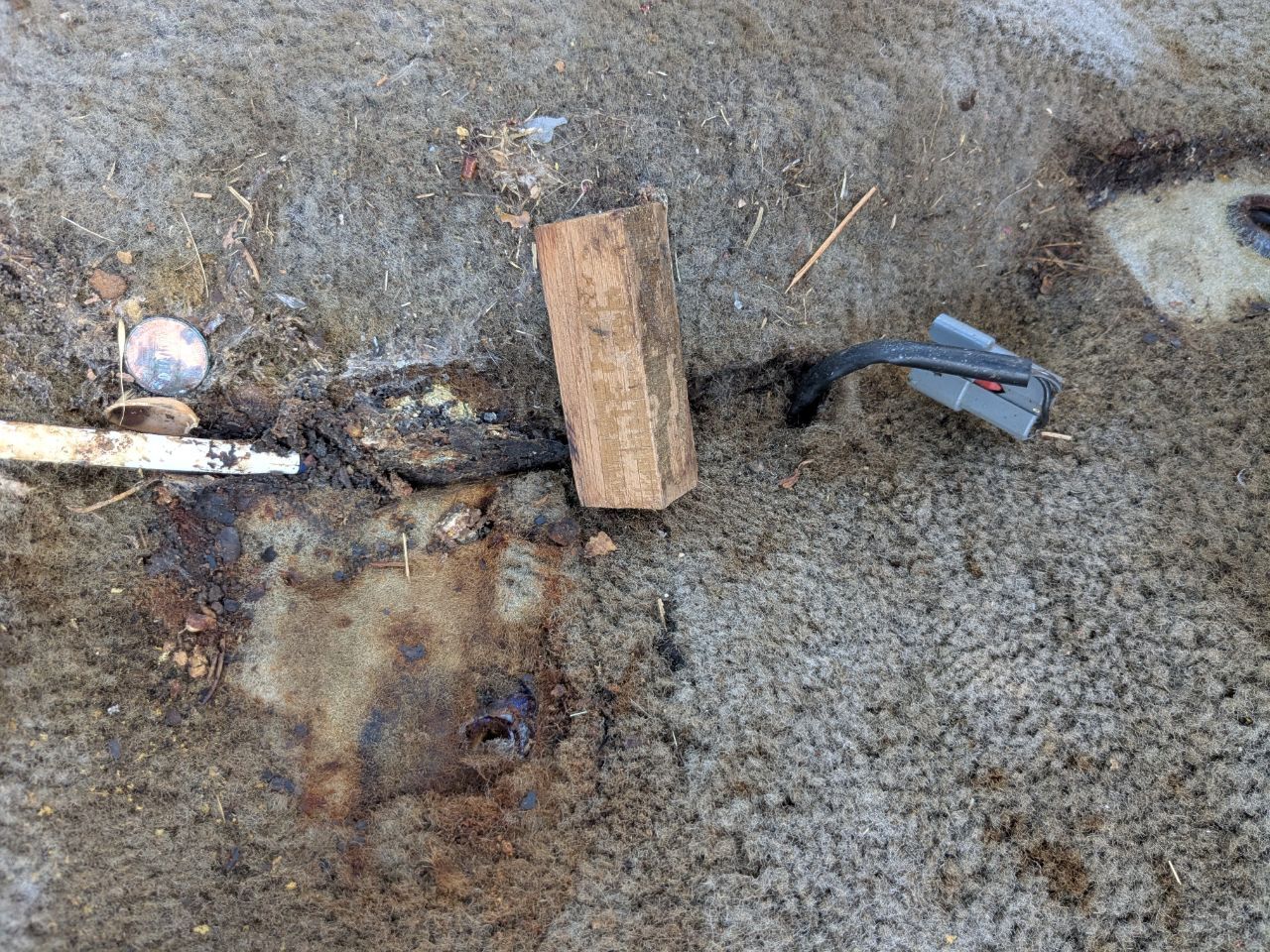

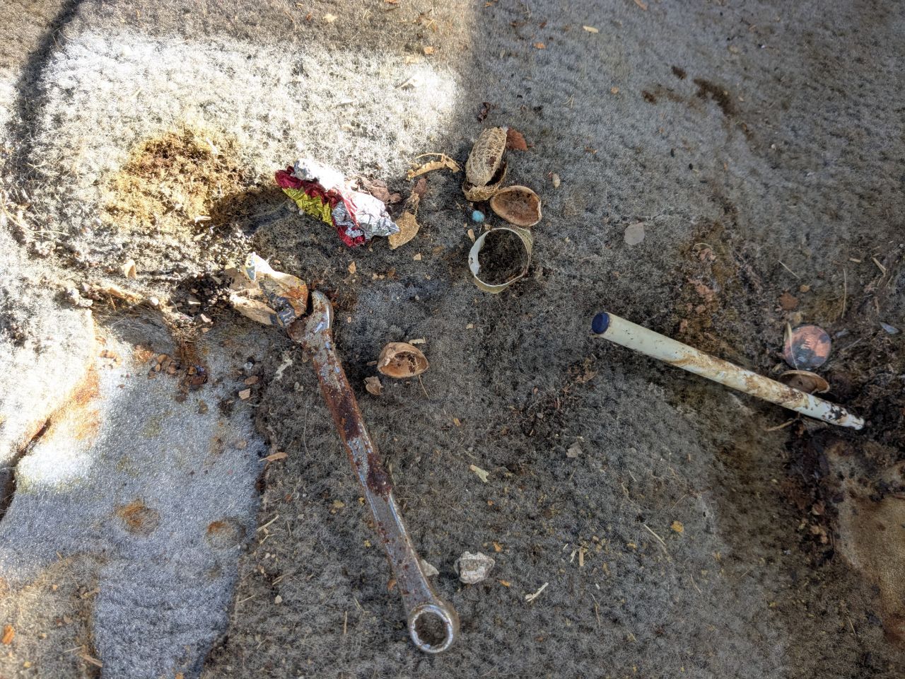

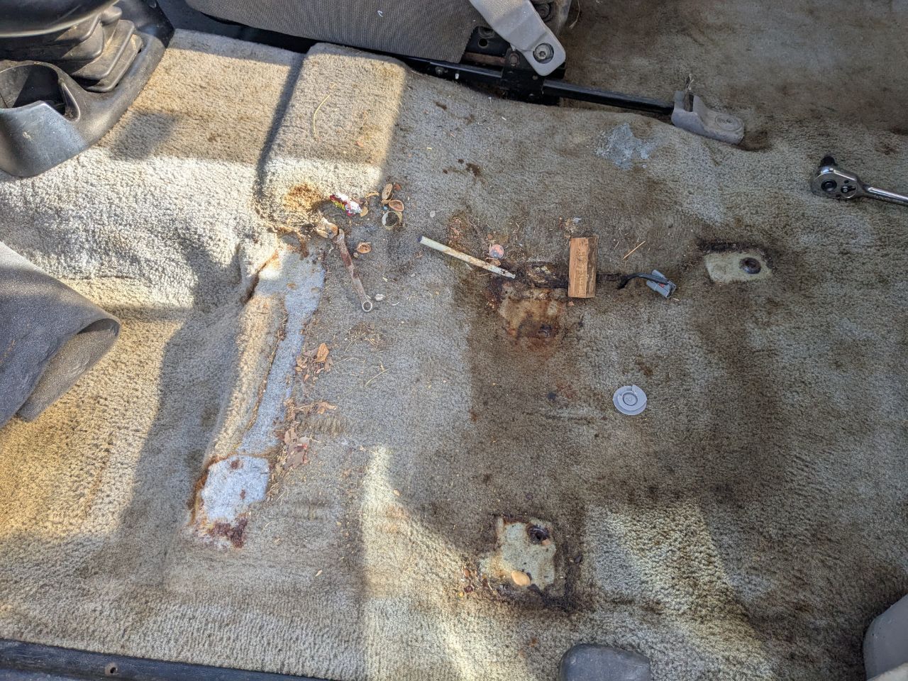

Anyone fancy some embedded treasure?
There were several pennies buried in that black mess. Adhered to the carpet. This is after a few passes with the extractor vac thingy-
That looks a bit better, smells a bit better too! This isn't yet finished however, because I made the mistake of kneeling on that section of carpet the next day and my jeans are now brown from the knees downwards. Bah. The driver's seat was duly installed in the kitchen (a gr9 marital bonding experiment)...

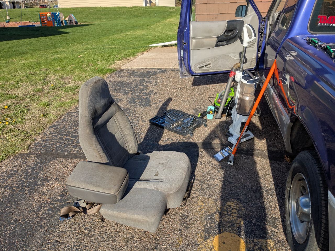

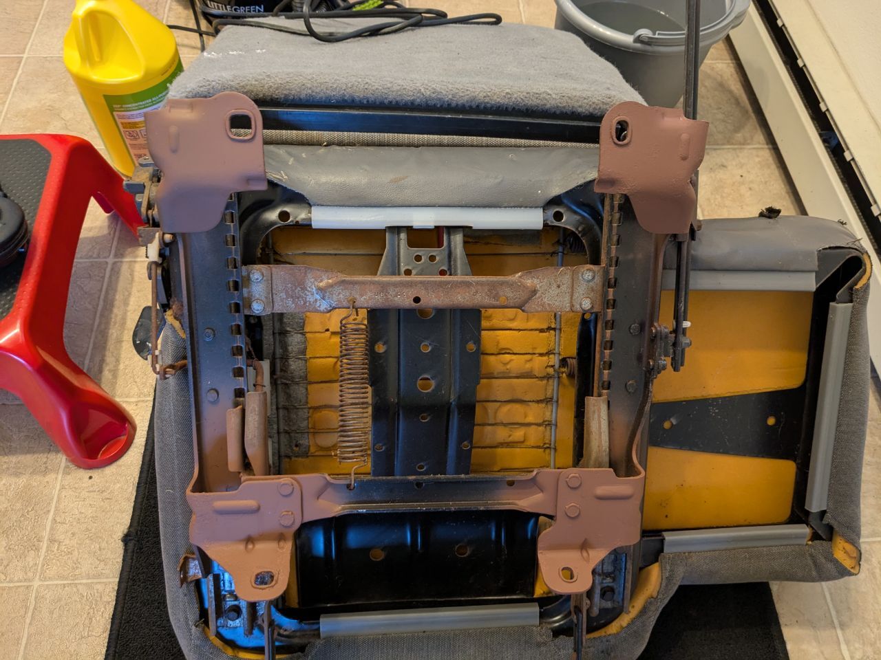

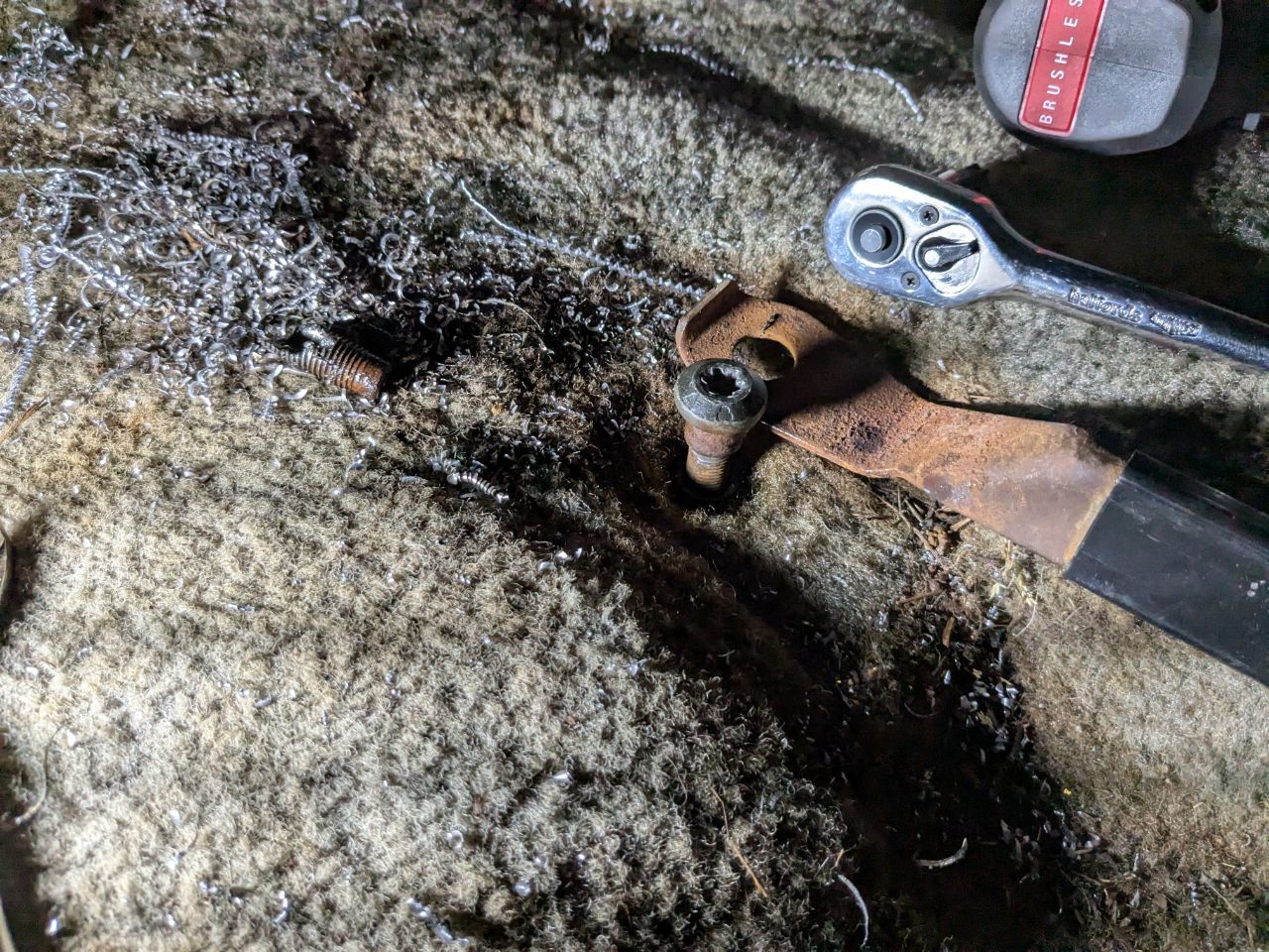

Anyway, onto the next seat, starting with the seatbelt anchor. It went fantastically*
PXL_20250502_014834059_MP.jpg.f3d39e5ca46d5c6687475fb671af0d78.jpgPXL_20250502_014830741.jpg.f0222d169b93f1ea9647d9005dc4db61.jpg
Driver's side bolt threaded in for reference. When undoing the driver's side bolt, I broke one T50 bit getting the bolt broken loose, then I twisted another "impact rated" bit pretty good when getting the bolt the rest of the way out. I then destroyed that bit when I visited the passenger side. I then try another one and promptly snapped it on the first turn. Well shit, I guess it's coming out the hard way then. All in, I ended up having to drill half of it out before the other half would unthread. Of course in doing this, the threads in the body are pretty much ruined. The driver's side bolt threads in okay, but there are no threads left on one whole side of the rivnut thing. This won't do, so it was suggested to me to just drill the nut out to 1/2" ID (the anchor bolts are M12, roughly 0.470" OD) and use a Grade 8 bolt with its own nut and lock washer. Alternatively, I could drill and tap for a 9/16" fine thread bolt. None of the actual seat hardware was as unkind to me but it's all getting replaced. Everything is so rusty.
"Why is everything so rusty?" I wondered. I came to the conclusion there's definitely a leak from somewhere, which would explain the damp carpets and the enhanced Farm Smell™. Fortunately, it rained the following day and I had a feel around. The rear, right below the rear window, was very damp to the touch. I hadn't shampooed that area yet, so I grew suspect of the sliding window. Except, it wasn't the window, because I then decided to check the headlining for giggles, and found it was soaked. Hmm... I guess the third brake light is leaking. It turns out they're notorious for doing this and improved gaskets are a tenner on eBay. I'm not holding my breath, but it would be nice if that was the only problem. The door seals or gutters could also be a problem, but the door jambs were bone dry when I looked. Time will tell I guess.

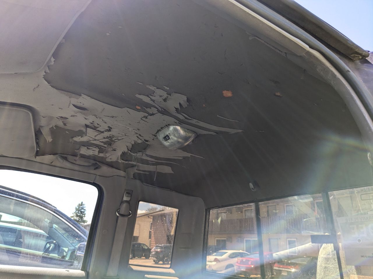

This is what the headlining looked like-
Since it was now also damp and smelly I decided it ought to go. Step 1: get up early and go to scrapyard with husband. Step 2: Shit, I'm an hour late. Rush to scrapyard because they close before noon. Step 3: liberate headlining.
ITS BLOO. This was surprisingly easy, about 30 minutes all in all. It seriously helps to have another pair of hands. We were worried this would fold up in front of us and everything would be in vain, but fortunately, it was pretty stiff and springy (oh matron!). Along with the headlining I copped the visors, "oh shit!" handle and coat hanger. I'll probably be back to scavenge other panels and fixtures because the interior's in very good condition compared to mine; I'm pretty sure a can of silver paint exploded or something inside my truck's cab because there's silver spatter all over the rear glass, the dome light, the carpets and all the trim. It's seriously tempting to try and replace as much as possible with this blue truck's interior. My interior's going to look all patchwork now, but that's all good with me.
I finished today by removing the old headlining. This was also pretty easy to do, aside from it shedding foam into my eyes and lungs every time I moved it. It had clearly been damp before because the topside was rather mouldy and the whole thing was pretty floppy. Made it very easy to frisbee into the bin. Ironically enough, the old headlining will end up buried right next door to the scrapyard its replacement came from. It's a small world.

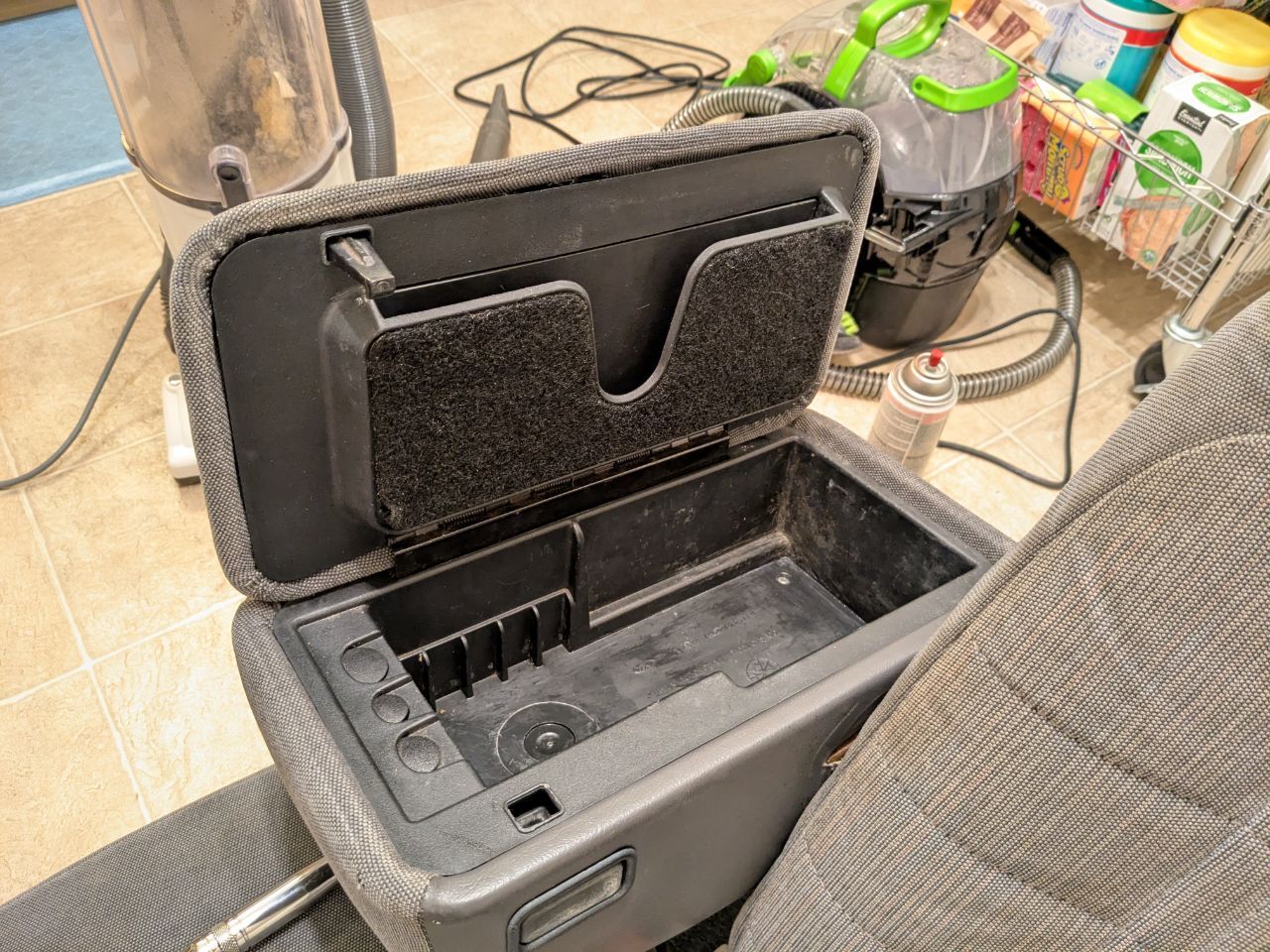

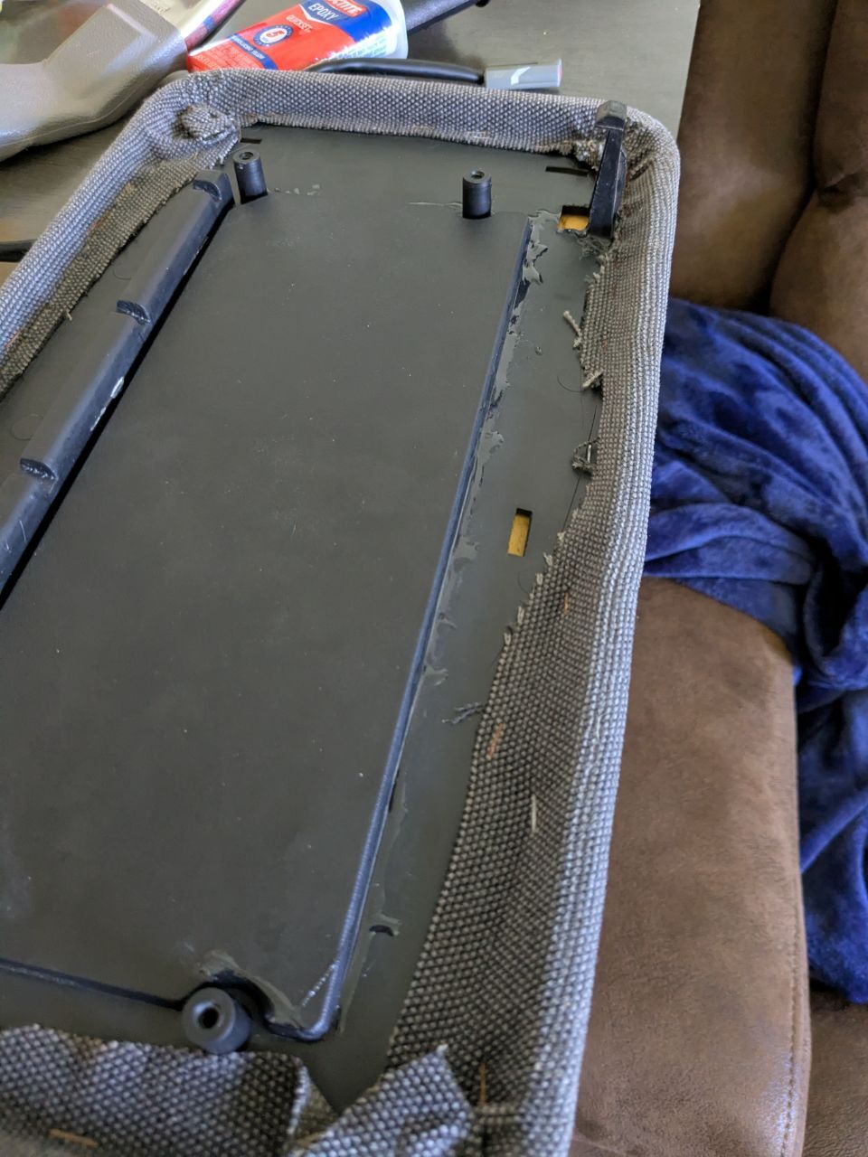

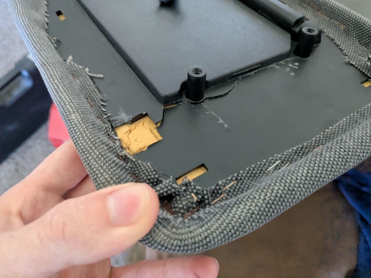

The armrest/centre console bin was rather broken. I have no clue what happened to it in a previous life but it seems someone smashed their fist against it multiple times and broke the plastic pretty badly. Fortunately, everything was still present and I could set to fixing it.
Some epoxy later and it's all back as one again -
This was followed by screwing this map holder thing back on and then attaching it to the bin and seat.
Not too pleased with its wonkiness but I'm told TADTS and that's just a side effect of having a really tiny mounting point to the seat. Looks way better than it did a few days ago! I also stripped and painted the legs, and dismantled and cleaned the filthy seatbelt buckle.

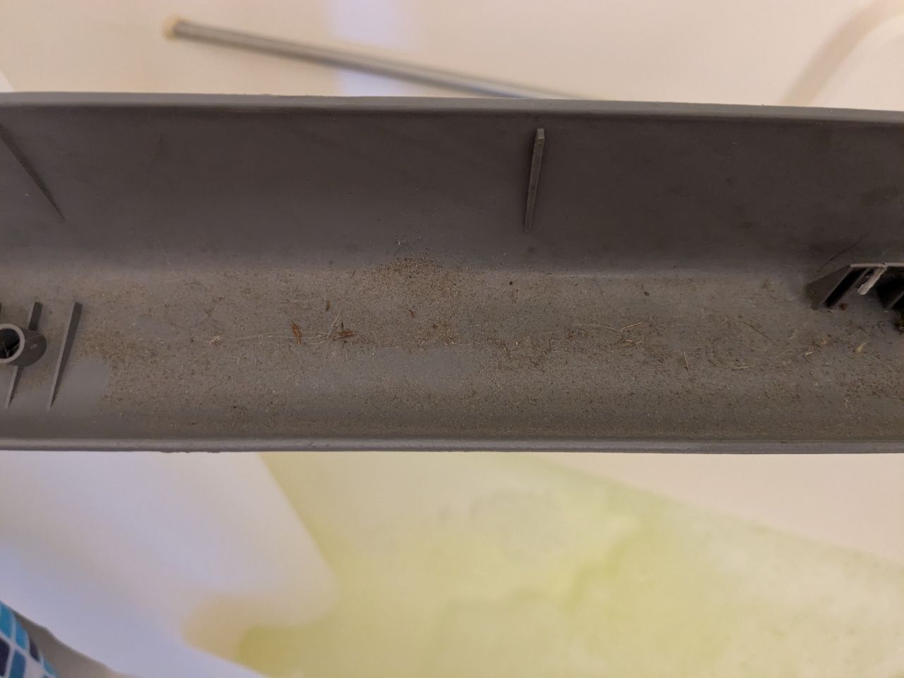

Much nicer. Next job on the list was cleaning the A pillar trims I removed to delete the headlining.
Ew.
EWW! Nasty horrible filth. On the inside of the trim. I still don't know how that's possible.

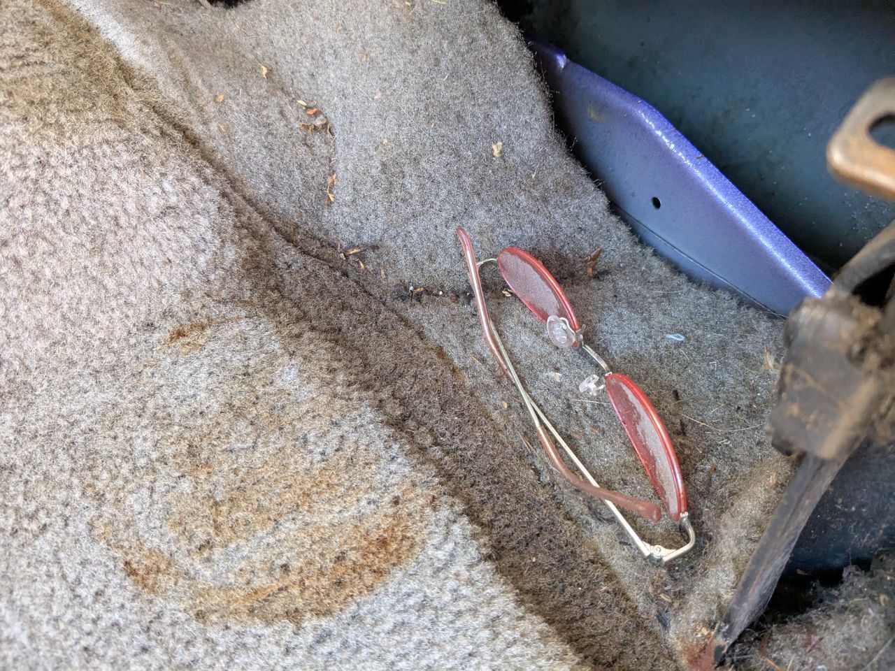

While pulling my tools out I made the mistake of bumping a trim panel, and a wrapper from a long dead sweet brand fell out

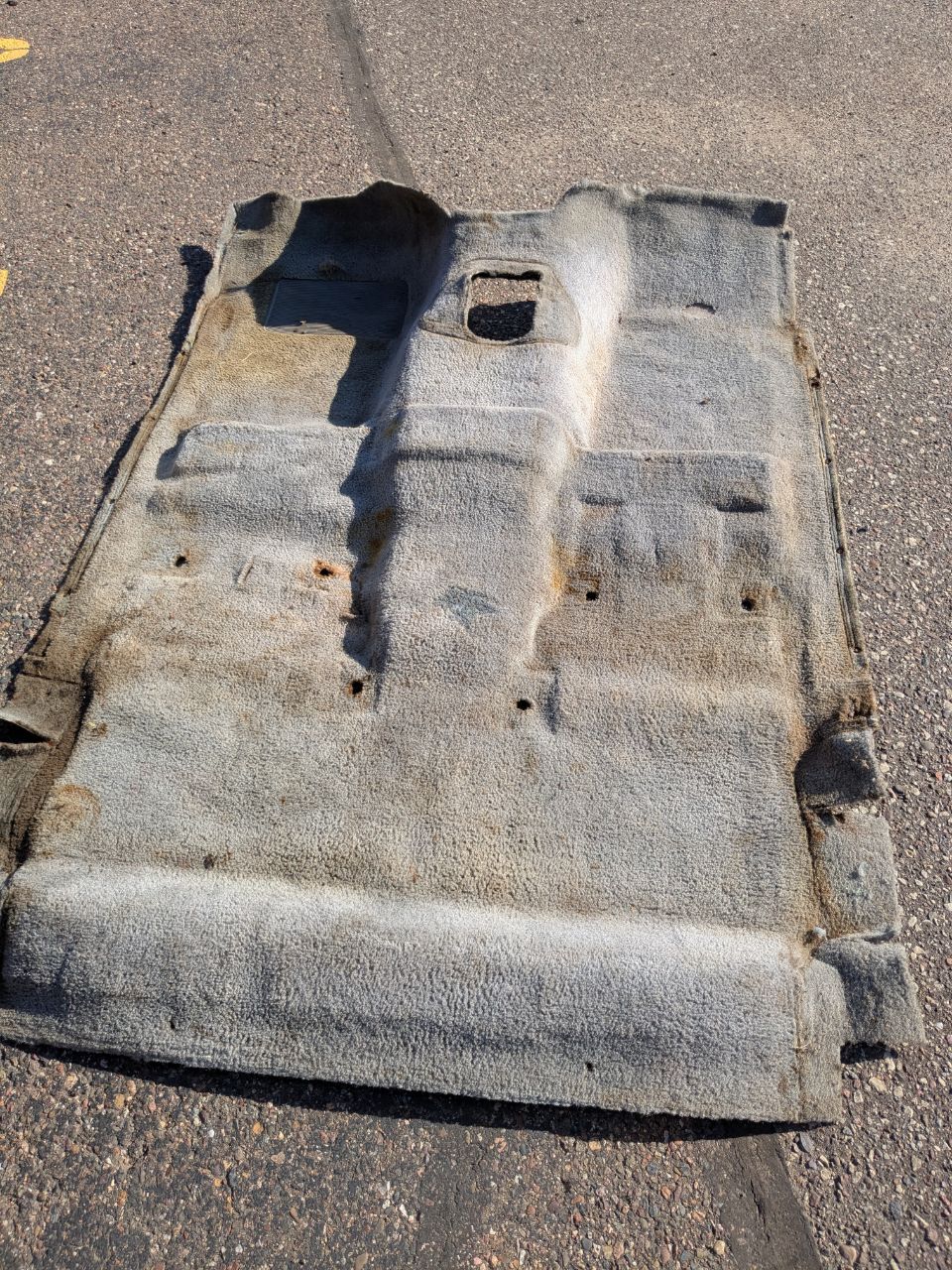

Curiosity got the better or me and I pulled more stuff apar- oh fuck no this carpet's going in the bin
There was a mouse nest in here^

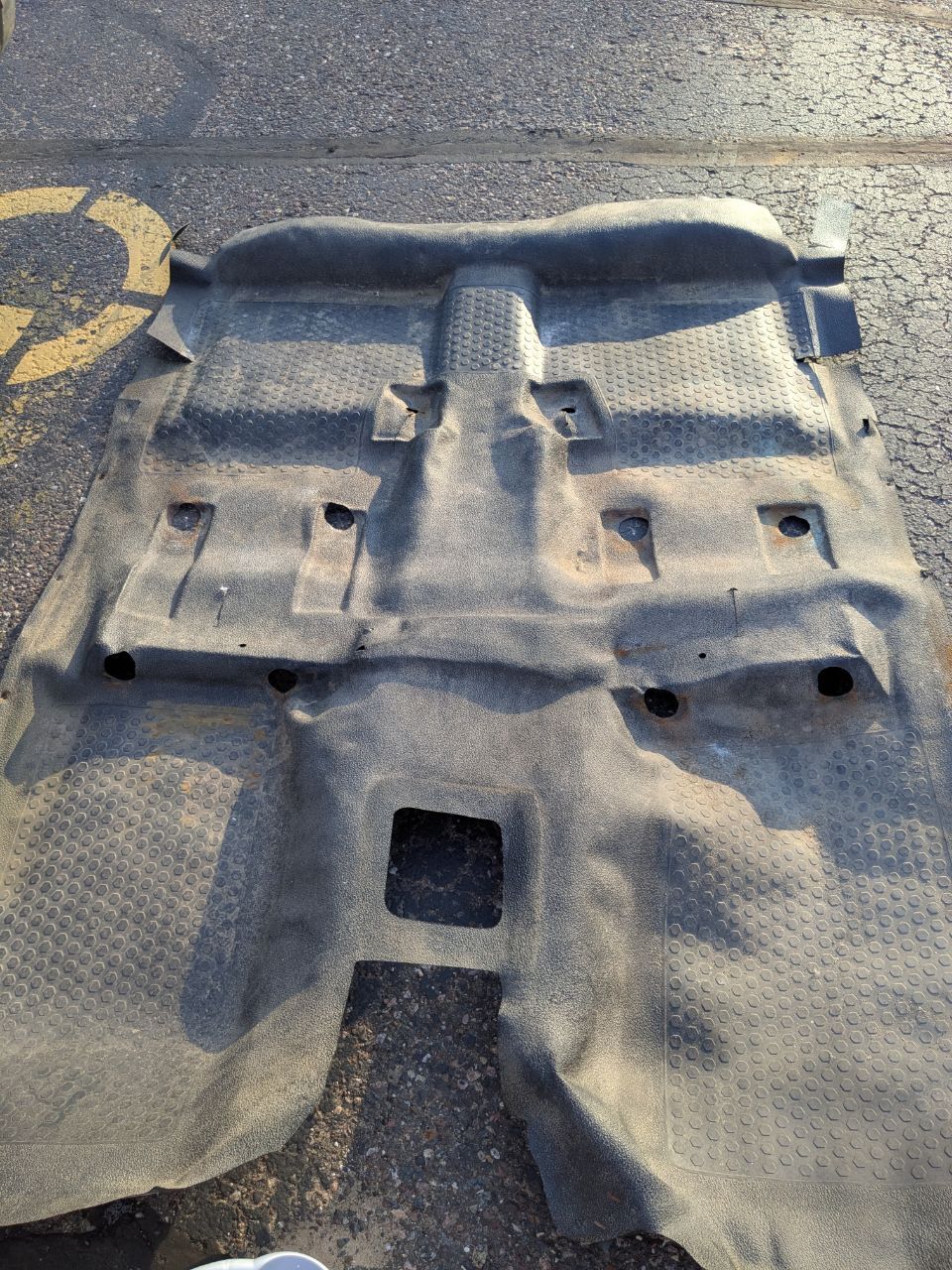

I'm now halfway through trying to get this horrible thing out of the cab, trying not to vomit (the smell is god awful)

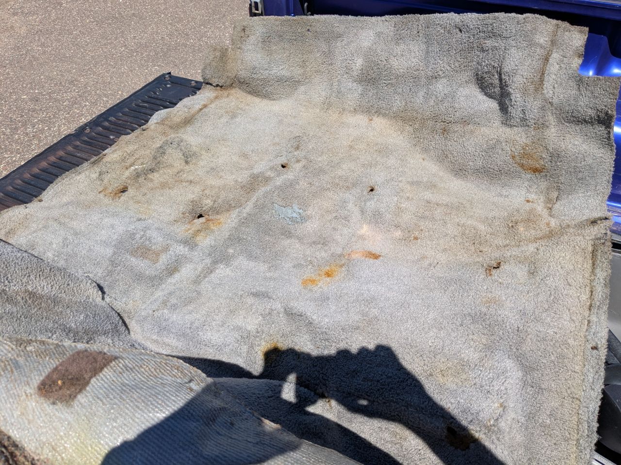

Update:
This is so heavy with stagnant water, all the underlay is ruined. The smell is still awful, not helped by the 26° weather.
Looks like it would jetwash just fine?
  • Agree 4
I'm going to try that this evening and we'll see how well it works. If it cleans the smell and the filth out, I've saved $200 (cost of new carpet) which will be nice. Maybe my initial reaction was a bit over the top but I don't know, finding the rubbish was one thing but the mouse debris and nest material wasn't a pleasant find.
18 hours ago, Fumbler said:
Update:This is so heavy with stagnant water, all the underlay is ruined. The smell is still awful, not helped by the 26° weather.

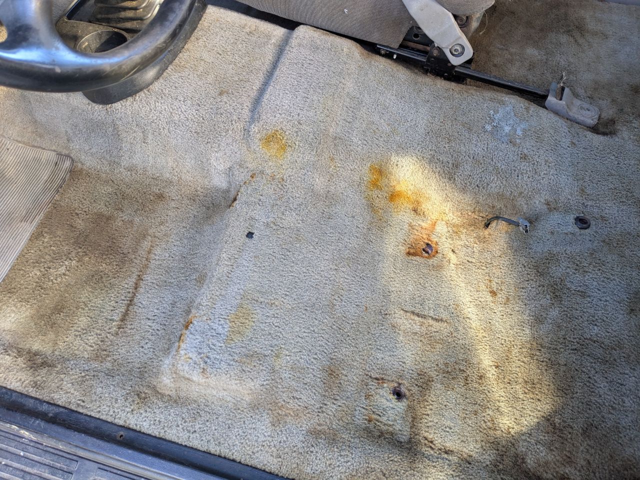

I removed the stinking, filthy and wet carpets from my (low miles, 7 year old) Ford van as soon as I got it home.
They went in the trash. Plain steel floors are the best deal in a van / truck.
12 years on and I still don't miss Ford floor coverings.

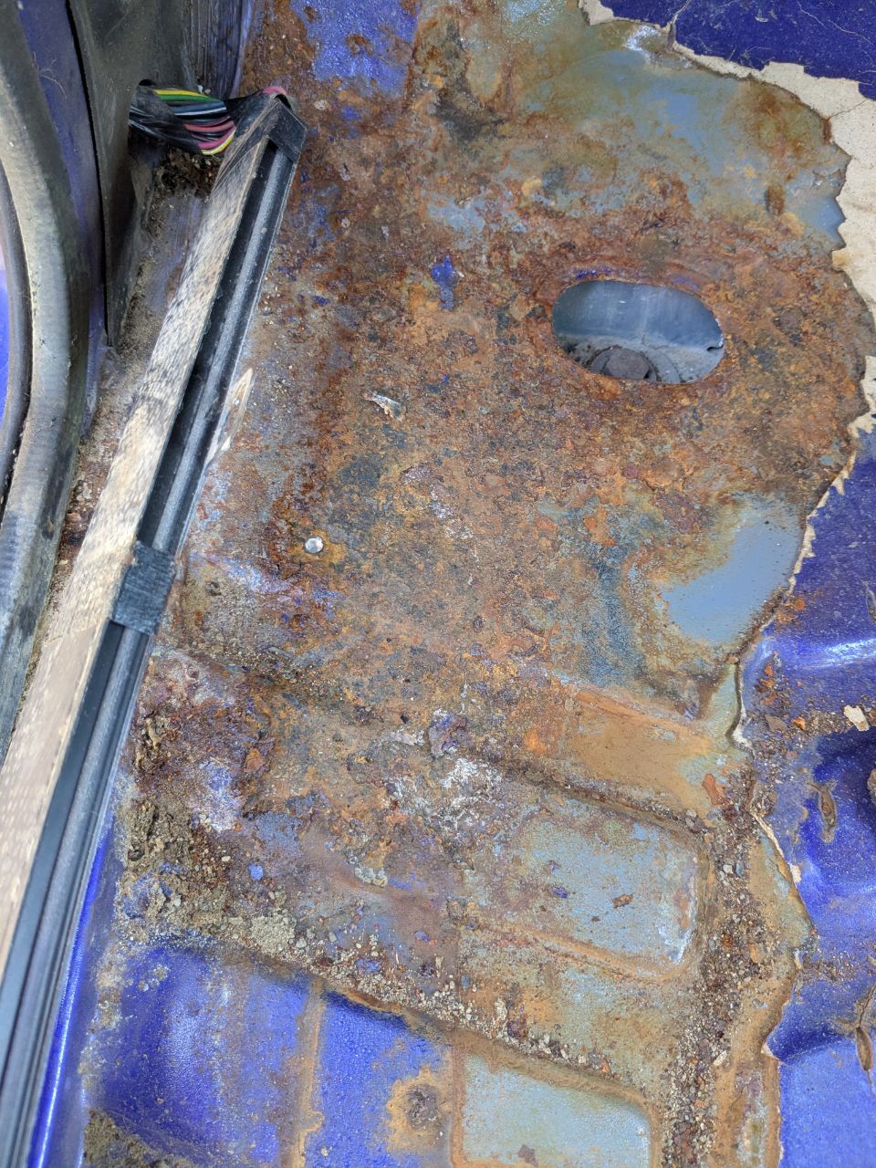

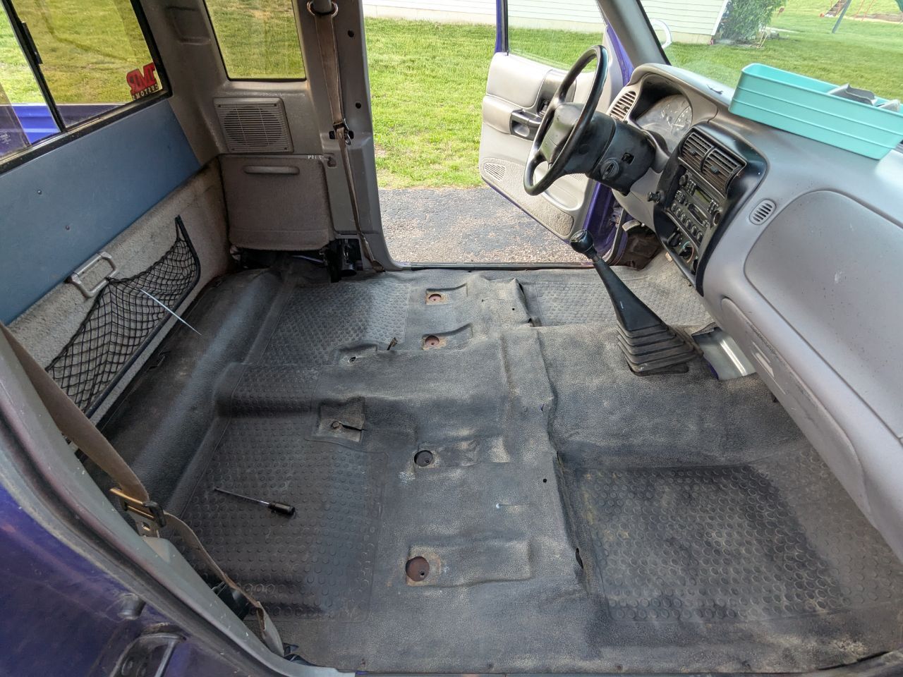

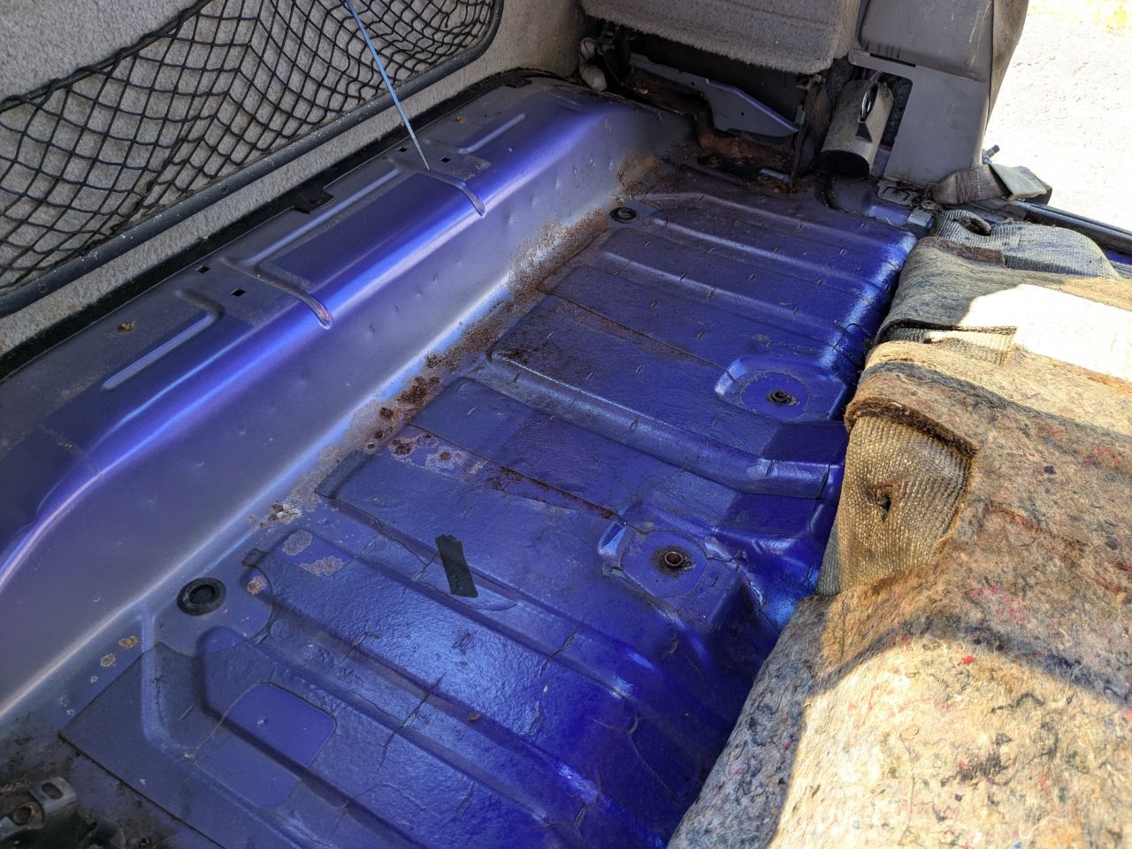

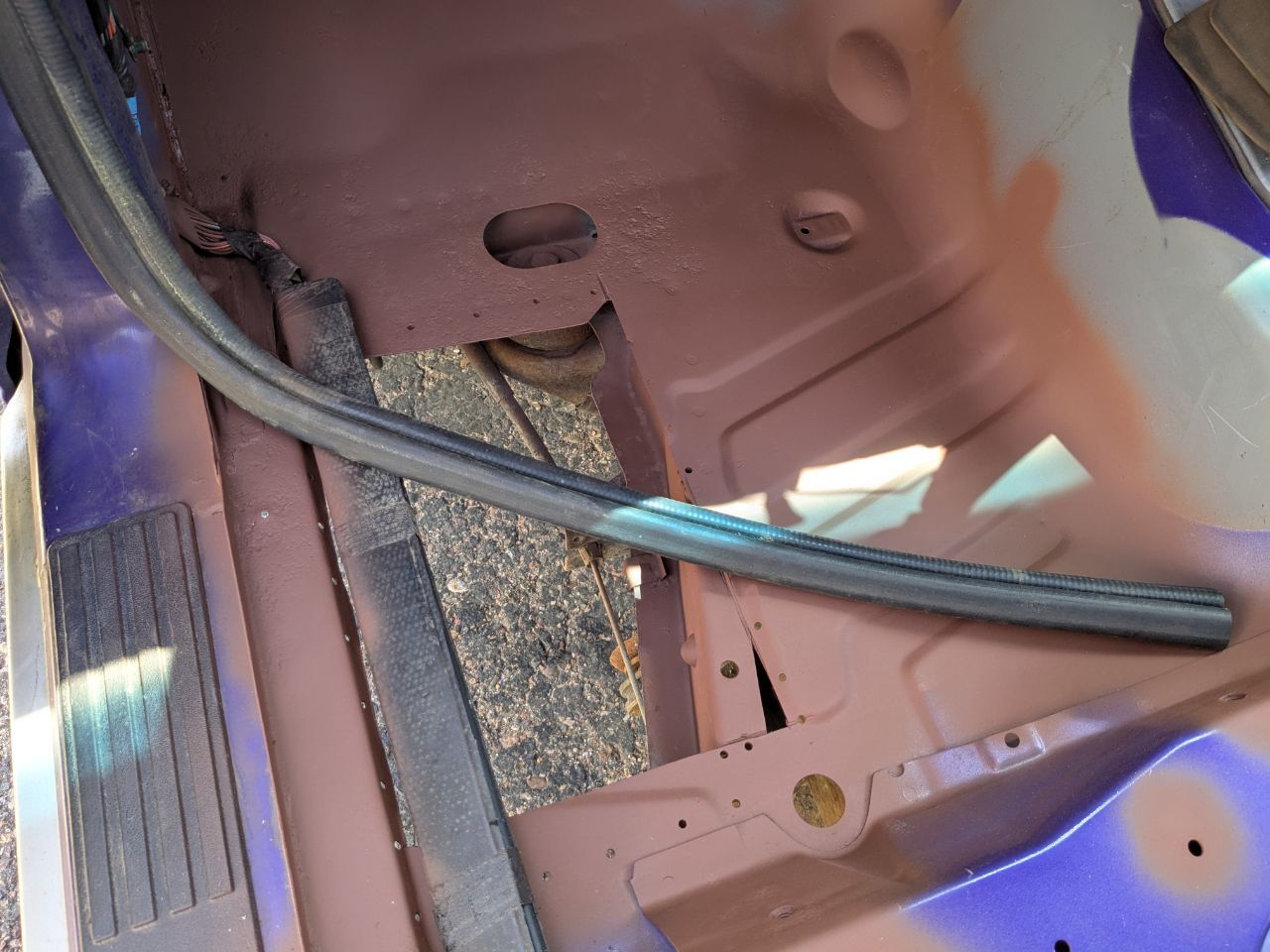

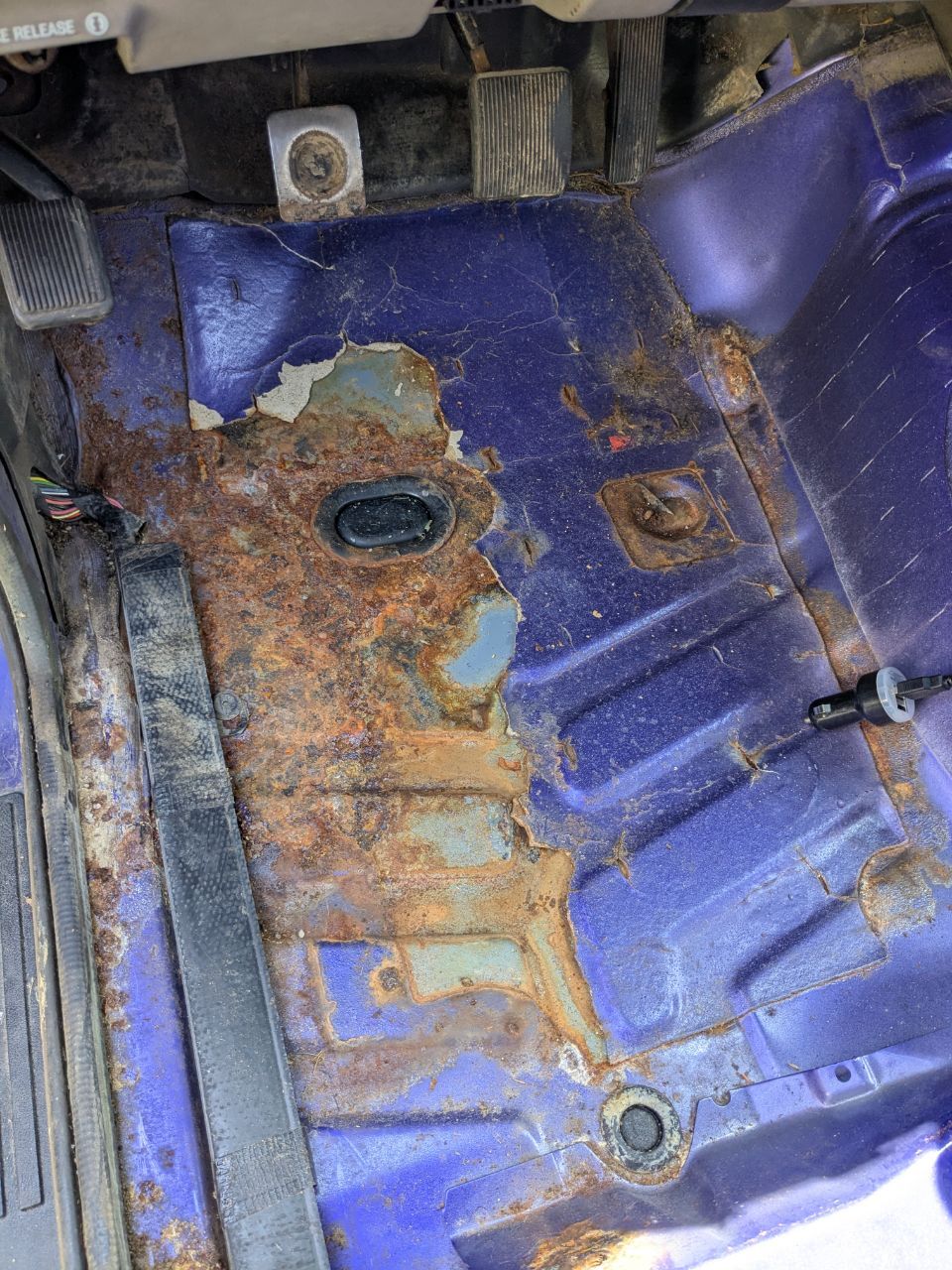

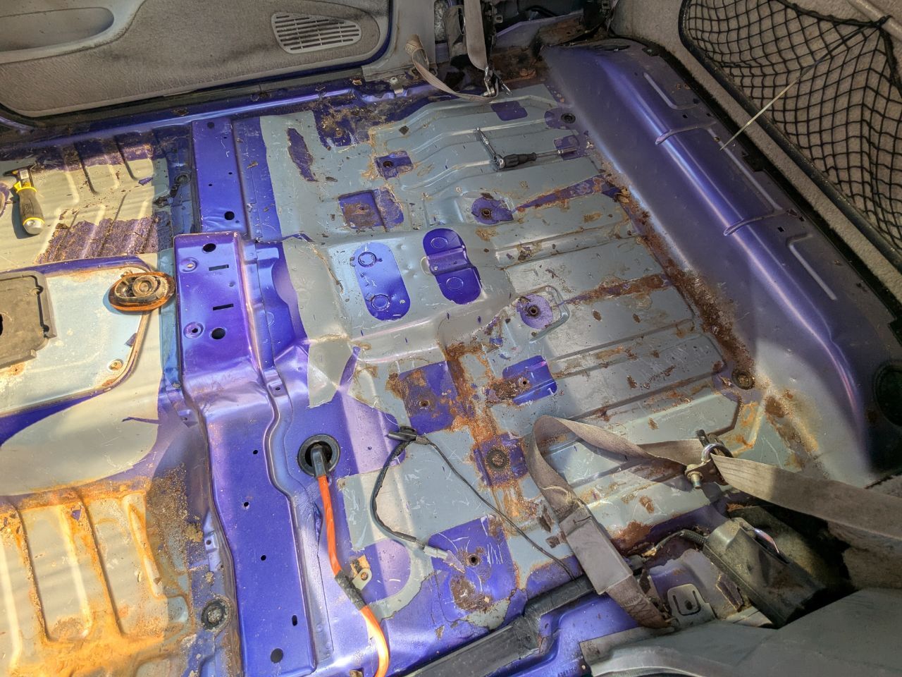

Here's the worst of the floor
Plan here is to peel up the rest of the old soundproofing on this side, take a wire wheel to it and see where it leaves us. It certainly isn't staying this way, that's for sure.

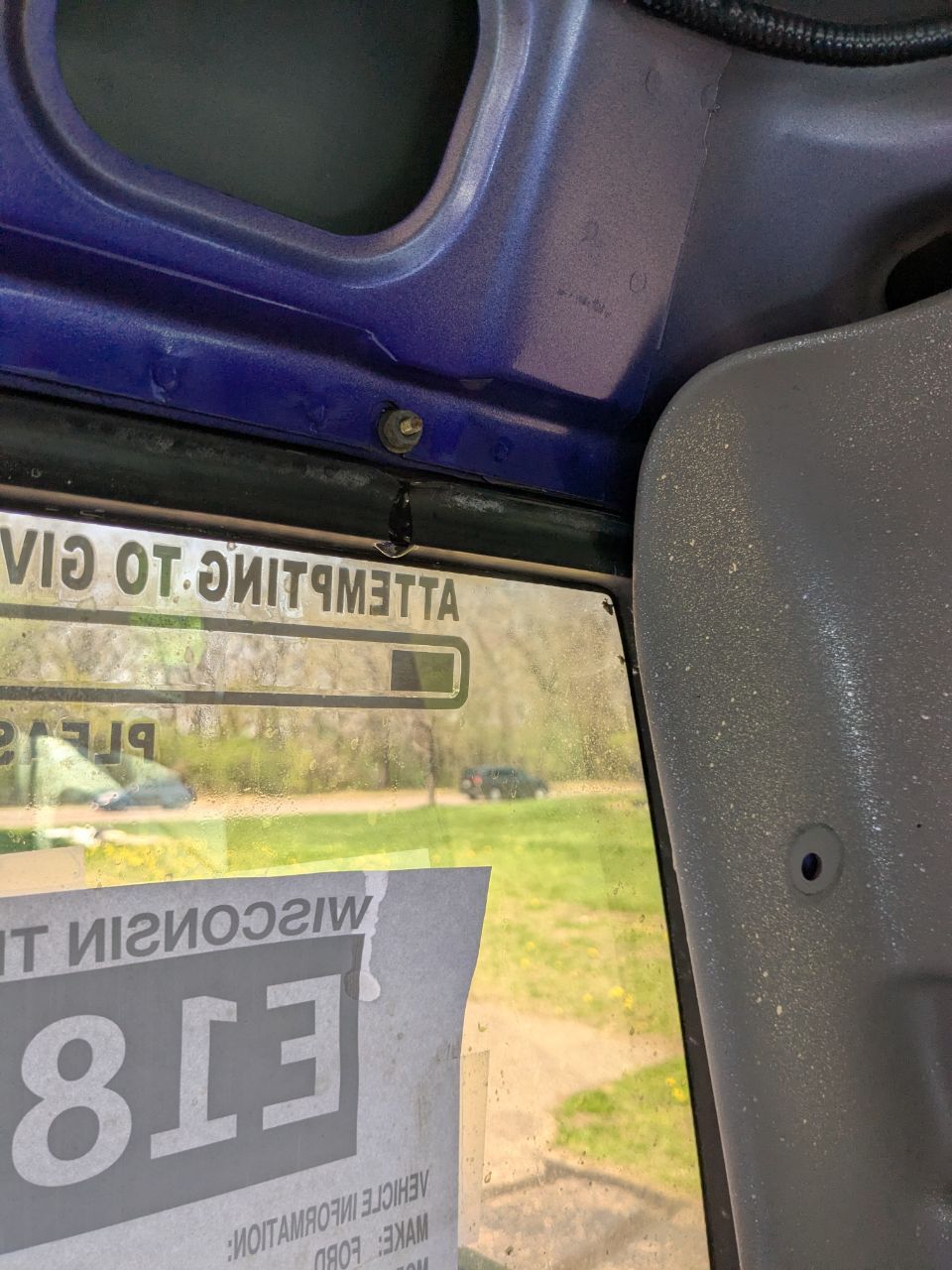

I then threw a bucket of water all over the cab to see where it's leaking and I took some crap photos
The third brake light is completely watertight, the rear window seal isn't.

That carpet is absolutely rancid! I’m surprised it didn’t get up and drag itself out of the truck tbh!🤮
A bloody good power wash and dry should sort it out though.
The floors actually don’t bad considering its age, mileage and the fact it’s been leaking for however long. Are floor patch panels available for these?

Agreed, but if you think the topside looks bad, here's underneath!
Yuk! We're going to attempt power washing this in an hour or two.
Agreed again. The structural condition of the truck is what basically sold me on it. I did some tapping with a hammer to see if I could make any more holes.
I still find it slightly ironic wet carpets is what caused the floor to rust through instead of road salt. Quite a lot of the soundproofing peeled up in my hands revealing water underneath.
As for replacement floor sections, I'm sure they're available, however that's well beyond my abilities unfortunately. I had to leave my bubble gum machine, visor, brushes etc. behind when I moved. If I'm looking at the truck's floor correctly, this isn't a structural area. The section around the cab mount appears sound and the sill cavities are as well. Seeing as floors (and metal in general) are optional in this state, rivets and adhesive may be deployed...

That is absolutely vile! The underlay felt stuff looks like it’s just full of whatever mank that is. I suppose you’ve got nothing to lose power washing it. It might be ok after, but if not it was worth a try.
If that little bit is all the rust you’ve got you should be fine. Rust converter to slow it down then cover it over with something solid and it’ll be fine.
You could do a ViceGrip special and rivet a license plate over it!
It’s a good truck though, you can even still see body colour on your underside photo. Apart from that tiny bit of the floor nothing has rusted or bubbled at all.

I'm going to continue exploring the cab with the hammer and then the wire wheel. I'm not looking forward to that part, but that should tell me what's good and what isn't. Fingers crossed that's the worst part of the floor. Funnily enough, my brother said to use a license plate patch as well! I don't have any spare plates about, but I do have some metal which should work.
While looking underneath it did occur to me how these trucks definitely weren't built to last a lot of time. There are pockets and voids absolutely everywhere, the body grounds are attached with press-on clips and nothing else, the only coating underneath is that weird greeny-grey primer the bodies are dunked in at the factory. Anyway, I'm off to the jetwash now. Wish me luck.

The underlay has got to go, it got soaked while washing the carpet and immediately as we folded it back into its transport box, it started dirtying everything with horrible brown water. Meanwhile, all the stains are still present, albeit a bit lighter, and brown water still comes from the driver's footwell portion. The pressure washer was so strong it started bleaching an area of carpet (seen in the middle of the last photo). Once it's dry again the underlay will be ripped off and we'll try cleaning it again.
Floor looks pretty good for having wet carpet on it. I was watching a youtuber in Virginia tear up the carpet on an old 2.2 Charger he'd dragged out of some hole somewhere - the floor pan peeled up with the carpet like cardboard!
Jetwash only does so much, and certainly doesn't get rid of mouse smell. General dirt yes but that, no.
Bin it off until you get the thing watertight anyway. Carpet is nice, but that's bathroom carpet. Just no.

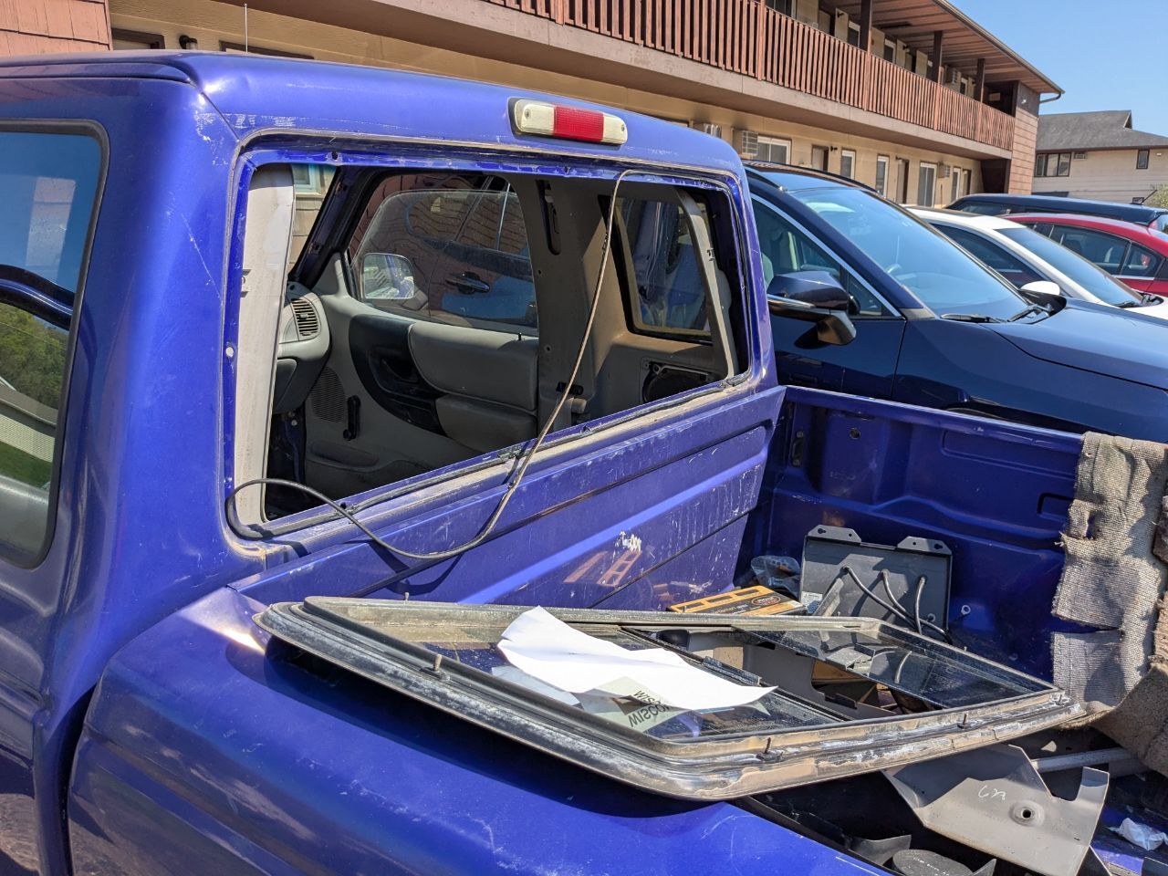

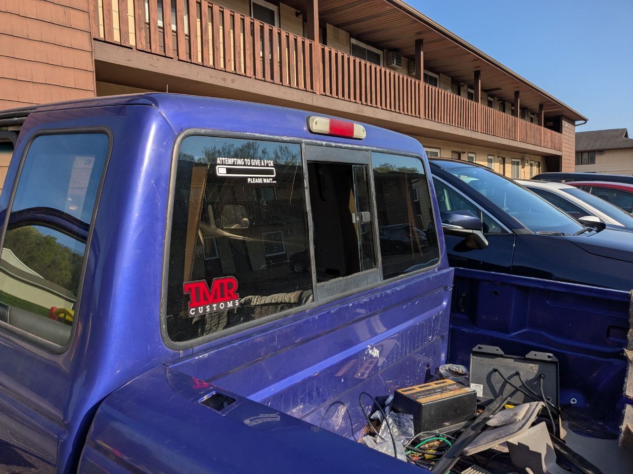

I actually fixed something on the truck today. Presenting:
How to re-seal a Ranger rear window in 5 easy steps: a guide nobody asked for.
Step 1: undo the 8 nuts clamping the window frame to the truck. Push out with light pressure on either end. Have someone to help lower it into the bed.
Step 2: take the window into the kitchen because it's too bloody hot outside. Optional step: place the window on a bathmat that you definitely* don't still use as a bathmat
Step 3: take the butyl ribbon and place it on the hot vehicle to soften it up. While this is happening, use white spirit to clean the window aperture and the frame.
Step 4: apply the butyl ribbon to the window frame and reinstall in the truck, ensuring there's no gap between the weather stripping and the body.
Step 5: throw water at the window and cross your fingers.
Aside from the general hotness, this was a surprisingly simple job to do. So far there's been zero drips inside.

It's fantastic. The other two rear windows are the same bolt-in style as well. Almost the entire interior is like this as well which has made taking it to bits (seatbelt receivers aside) rather easy. I hope reassembly is just as forgiving.
If the pile of the carpet is thick enough then that's a prime candidate for a drill brush and wet vac. Finding a better used carpet might be the quicker option though. Good chance to add some additional sound insulation to the floor as well!
I think it's bin time for the carpet I'm afraid. I really don't have the space or the resources to try other things on it. This decision was helped by finding a factory vinyl floor liner at the scrapyard yesterday which I'm likely going to go and grab. It'll work for the time being at least. Extra insulation is in the pipeline once the floor is patched up.
Worth a shot with the old carpet. Little to lose really.
Vinyl floor liner is good in vans and trucks though. Very practical if you get it grubby inside and can just sweep or wash it out.
If that old carpet hadn’t come up excellent I’d have binned it too. Oil & grease type dirt is one thing I don’t mind but grime, filth and ‘people dirt’ is something I can not stand. It’s absolutely revolting.

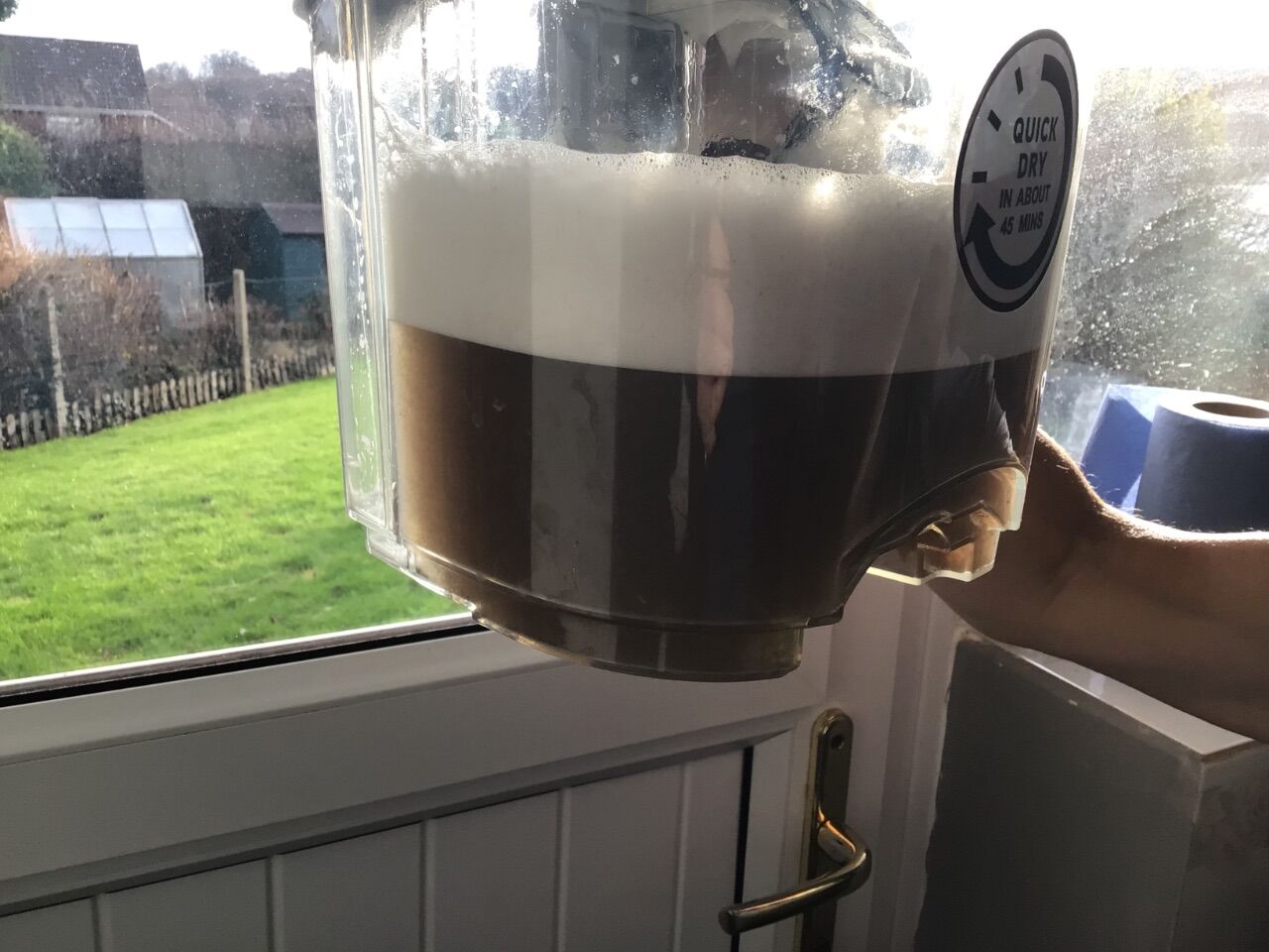

This is what we had to wet vac out of our living room carpet after moving into this house late last year.

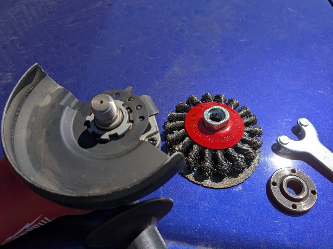

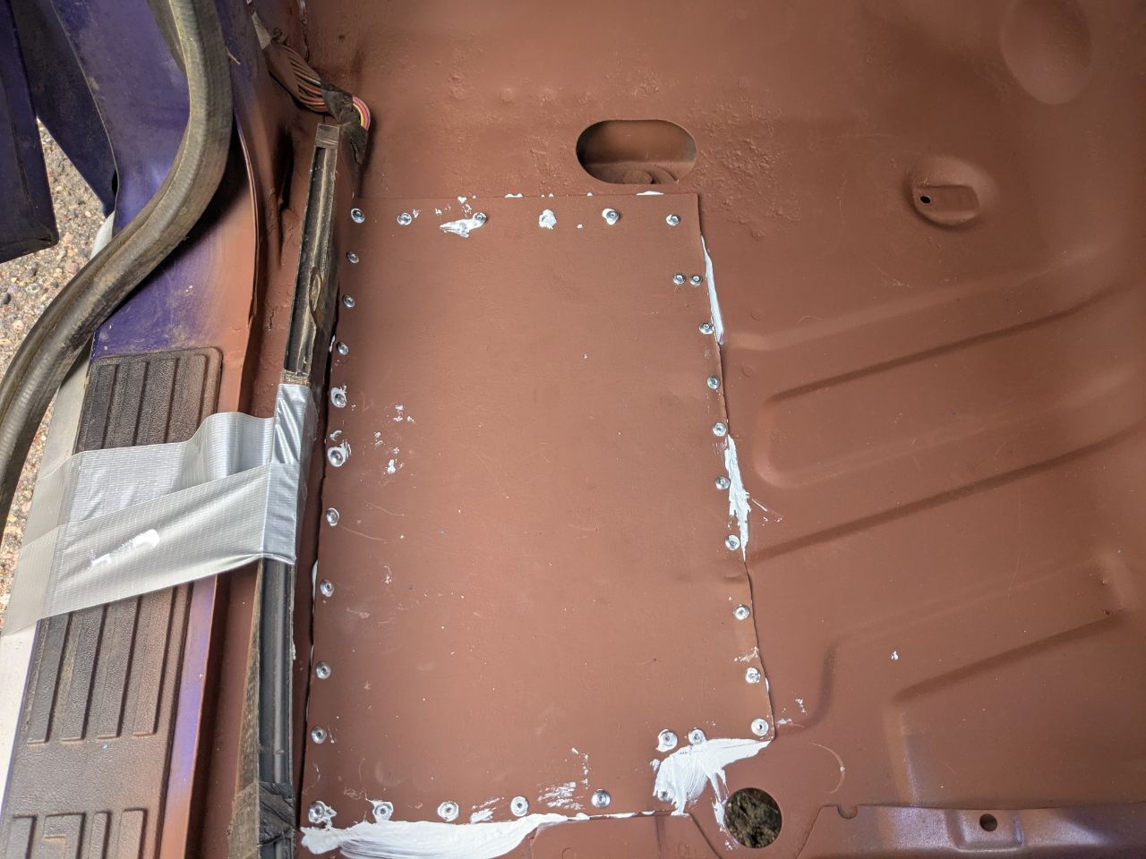

The next logical step was to take a wire wheel to everything, except I encountered a slight snag-
It turns out that, despite all 4-ish inch angle grinders being able to use the same disks no matter where you are in the world, American grinders use a larger UNC thread on the shafts. So I had to throw the wire wheel I brought from home away and go to the hardware store to buy another one. So, the next day I was able to attack most of the floor before pissing the neighbours off.

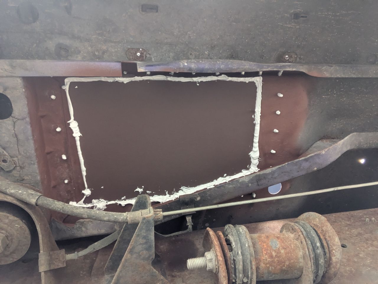

Somehow, by some miracle, this is the worst part of the floor. This leads us to a few days later-
...Where I've cut a section out, pissed the neighbours off some more, and primed absolutely everything to make way for a patch. And yes, I'm not welding metal in, instead I'm using rivets and seam sealer as glue. Trust me, this is 10000% better than most people's efforts around here. They'd lay a piece of plywood down and put the carpet back over.
PXL_20250515_000353285.jpg.b84fabb12ab2b797f3b2bc46ad89f873.jpgPXL_20250515_001247597.jpg.3b9f42becb8914701f9382ef4437af2a.jpg
This was when I had just finished riveting the patch panel down. I then went over the seams on the top and bottom with more sealer.

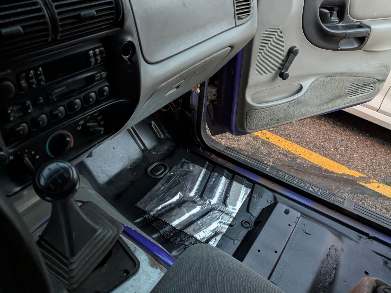

Anyway, back to the inside. Immediately after doing the front plate, I then sprayed bedliner over the floor and let it cure for a couple of days. The next step was installing some soundproofing pads. I went with stuff from Resonix and I bought 10 square feet of it, which wasn't enough but I digress. I was just going to hop on Amazon and buy some Kilmat stuff or Dynamat for $notmuch, but I instead bought Resonix because it turns out several reviews found the rest didn't do that much at all, hence the cheapness.
The material gets shipped in 1" squares. It's basically a giant butyl pad with a real aloominum metal face on one side, and adhesive on the other. Application really is as simple as peeling the backing, carefully applying the soundproofing and making sure it's well stuck using their complimentary roller. The results on the roof were fantastic and anything which hits it is now reduced to a muffled thud as opposed to a metallic clang.
4 squares were then placed on the floor, one in each footwell basically. The final two squares were then glued to the body panels behind the jump seats in the rear. Is this enough soundproofing on the floor? Definitely not. Next year I'll buy a new carpet and install more.

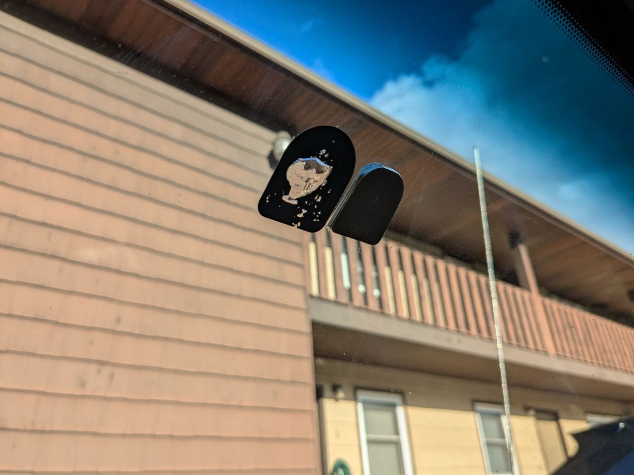

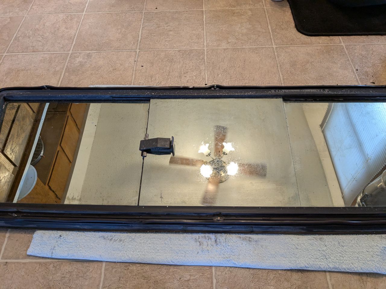

After this was done I then re-installed the rear view mirror. The original location had a chunk of glass ripped out so I glued the button just to the right and slid the mirror over.

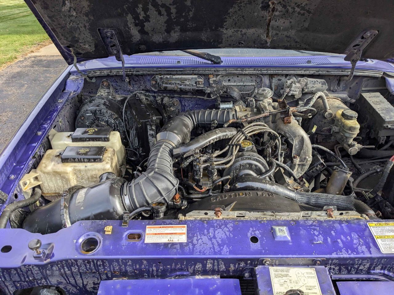

Oh dear, it looks like I've been neglecting this thread (and the forum) again. Soz. In spite of this I have been doing a fair amount of work on the truck (including exhaust and driveshaft, see News 24 thread on my rear axle debacle) and yesterday it thanked me by blowing the engine up. I would post video clips of my discoveries but I've been too lazy to upload them to youtube. Put basically, imagine you've just removed the #4 cylinder spark plug, cranked the engine over and witnessed a ton of water spray out. Yup, that was me a few hours ago!
So how did I figure all of this out?  Okay, let's back up a bit... actually, a week ago. For some context, my new job involves a lot of driving around my area of the state and I managed to put 2000 miles on the truck within a week. Every time I parked up and turned the engine off, I would hear this gugling sound coming from the heater area. I figured this was coolant bubbling and burping into the overflow and didn't really put much thought into it. my reasoning behind this was everything else was otherwise normal (no smoke billowing out of the exhaust, oil looked fine, heater was blowing nice and hot, engine temperature remained steady), so I just carried on driving. Fast forward to yesterday, which was the first properly cold (-1C all day) day of the season, and I decided to go out on a drive. Red flag 1: I stopped at the gas station and when I started the truck up again, there was a cloud of white smoke which cleared shortly after. Meh, it's cold outside. I guess that's what it does when it's below freezing. Boy, I wish the engine would warm up so I could get some heat in here. I carried on driving. Red flag 2: The engine wouldn't heat up and the heater wasn't blowing hot at all. However, if I joined the freeway and drove at 60+, everything returned to normal. BUT, as soon as I would exit the freeway and stop at a junction or light, the heater would then blow stone cold and the coolant temp needle would go straight down to the cold mark as well. The engine would begin loping and misfiring and huge white clouds would blow out of the exhaust. Hmm, this isn't right. I decided this was the result of the engine overcooling in some way and I ordered a thermostat.

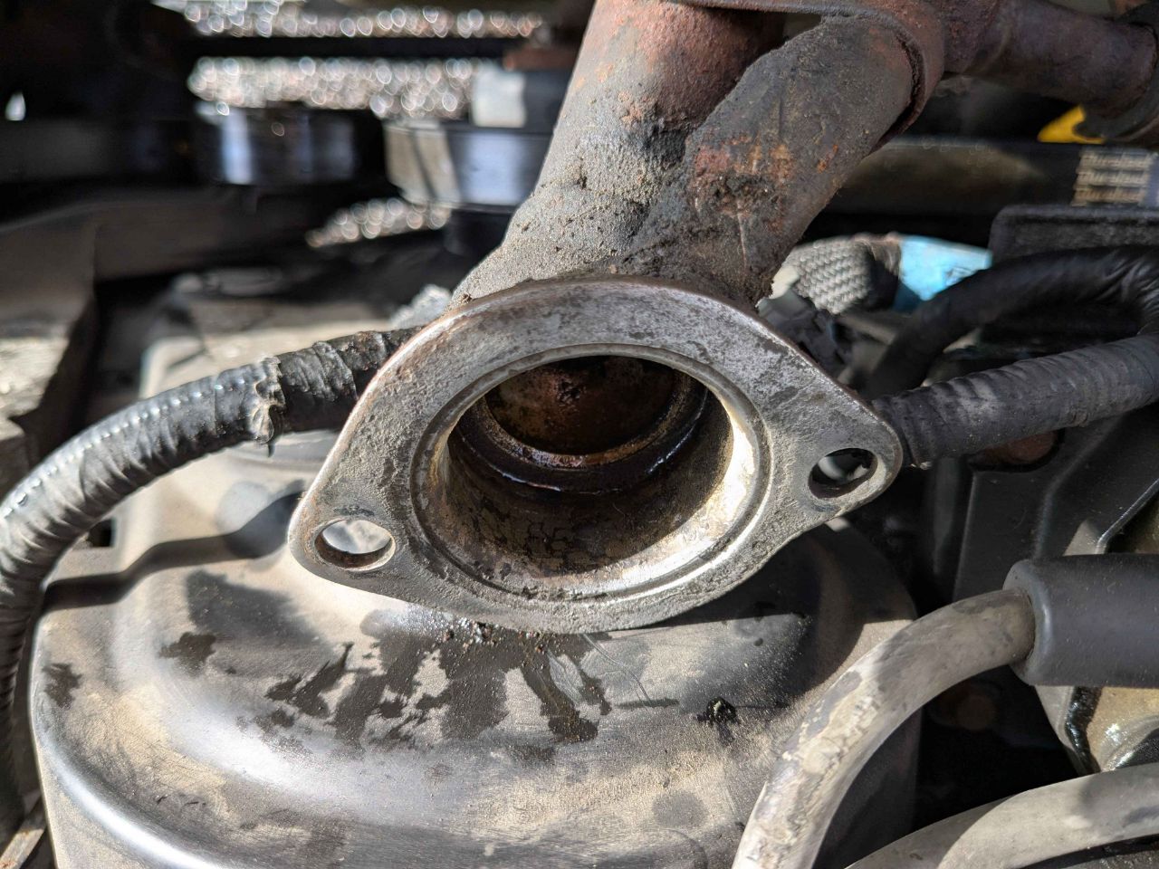

This morning, I collected the thermostat and set to replacing it. The drive to and from the parts store was less than a minute, so the engine was still stone cold. Because of this, I decided to remove the radiator cap. Red flag 3: a giant coolant geyser erupts as if the engine was boiling over, soaking me with tepid coolant and firing the cap deep in the engine bay.
"Well that's odd", I thought, so I showered all the manky crap off of me, changed into some new clothes and set to replacing the thermostat. It was a bit of a pig to do because of how greasy and cramped that area of the engine was (the thermostat neck is on the front of the engine behind the fan), but after a few hours I had everything reassembled and I began filling the radiator with plain water, just in case anything started leaking. Here are some pictures mid-replacement:
PXL_20251111_185825074.jpg.143e5d1b5ac99f4627a848a768d9058a.jpgPXL_20251111_191235808.jpg.a956c21120c42ebe437ad73e746aea25.jpg
This wasn't the first thermostat the engine's had either. I had to clean off gallons of RTV to reach this (rather punky) finish. Annoyingly, the last guy to do the job also overtightened TF out of the housing so it was no longer flat. Bah.
I then ran the engine. Red flag 4: Lots of bubbles and it wouldn't maintain temperature, just like yesterday. Bollocks. All that effort for nothing. In addition, the engine started shaking like crazy and the CEL was flashing indicating a definite misfire somewhere. I'm an idiot and had no code scanner so I revved the engine up, the CEL stopped flashing and the engine smoothed out. "Huh, that's interesting", I thought, so I shut the engine off. After all, it only got barely warm after running for 10 minutes. As soon as I shut it off, that distinct gurgling sound came back again. For shits and giggles, I decided to crank the engine over again. Red flag 5: It really, reeeeally struggled, almost as if one cylinder was hydrolocking, and then it jumped to life. "This is getting worrysome!", I surmised, so I immediately turned the engine back off again. I then started hearing the sound of water pouring onto the ground. Figuring I left a hose loose or something, I started looking around the engine bay, only to find lots of water pouring out of the exhaust. WTAF?
So I then begin pulling out spark plugs. I started with Cylinder 3, since it was the easiest to get at, and promptly destroyed the (new in March) HT lead trying to remove it. I took the plug out, it smelled of burned fuel, and put it back in the engine. Okay, what about Cylinder 2? No HT lead destruction this time and the plug looked and smelled fine. Then I undid Cylinder 4. Uh oh, it smells of coolant. I crank over the engine...
Bollocksfuckbags bastarding OMGHGF. Compression is leaking into the coolant jacket, and when the engine is shut off, pressurised coolant leaks back into the cylinder. It pretty much explains every symptom I was experiencing. I recorded this happening and from the driver's seat I could see water spraying out as the engine turned over.
RIP Ranger engine. Mileage of death: 220273 miles. It probably had way more on it considering the speedometer was broken when I bought it.
So, where does that leave me? I could dive in and replace the head gasket, however I have since learned these engines like to crack cylinder heads as opposed to blow head gaskets. It is also a horrible job to do. The engine also leaks oil from the front and rear main seals, rocker cover and elsewhere. Basically, everywhere. Head gasket replacements on these are a lot of work, and if the head or block is indeed cracked, I'm doomed anyway. This leaves one other option left:
