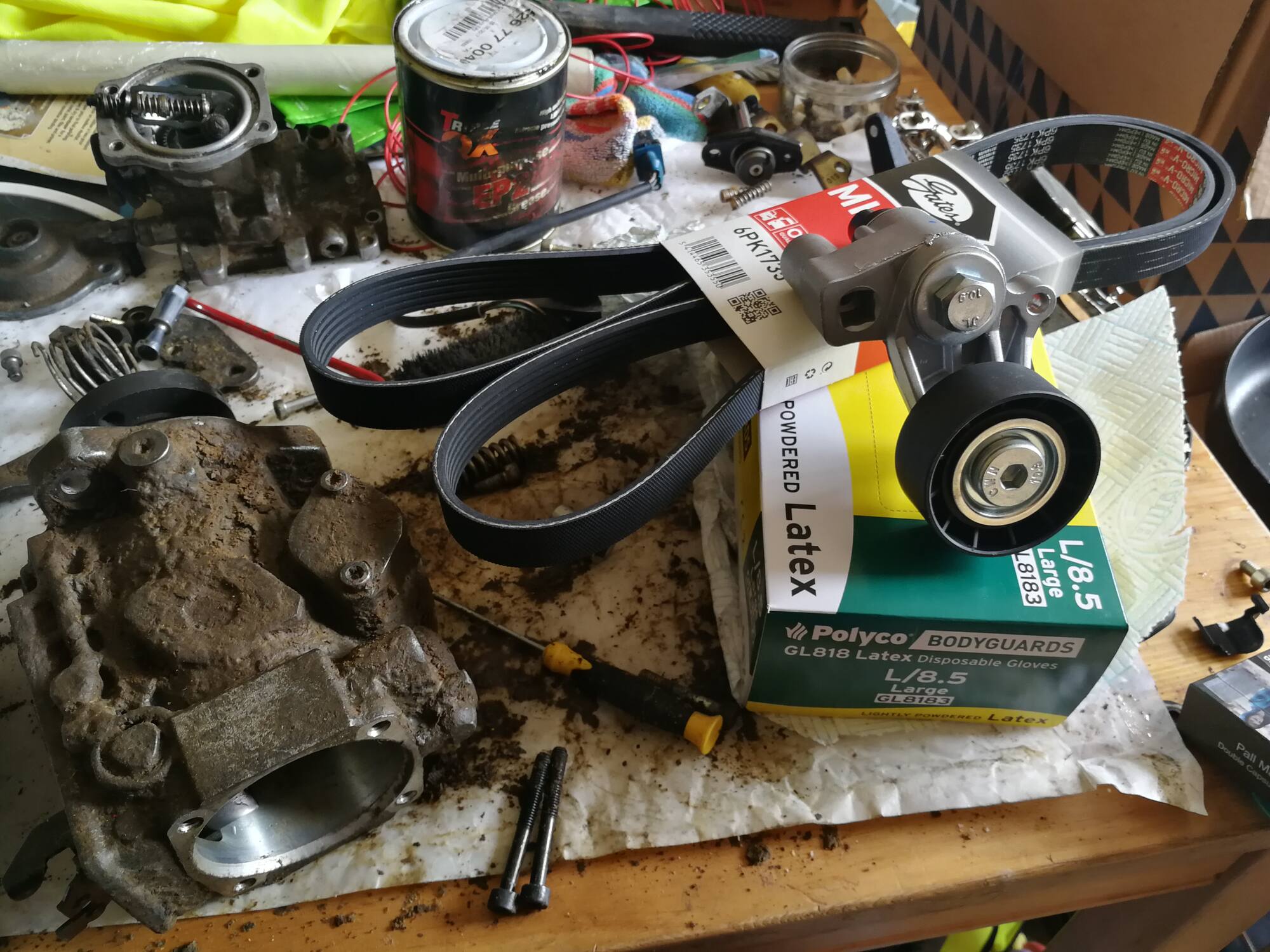

Right I have gone and spent a bit too much money on bits (oops).
It's staying....... However been as I was bored there was an 11mm Bosch pump we had knocking around so converted the AS3 9mm that is standard on the xantia.
Having a coffee and then putting it back together again with new belt and tensioner IMG_20190706_141041.thumb.jpg.6ecdb7a5240e6ae8fc72d66ae81446c3.jpg
After day 2 of issues.......
Belt rectified, tensioner sorted. We made a boo boo with the pump head mod by getting the cam plate internally 180degrees out!
I was always told that you can't modify or tune the AS3 ve pumps because advance controls ect. This is the second I have managed to do.
Ok sure, to get it started involved towing it with an expensive mercedes (what could possibly have gone wrong there?) And realising that the fuel needed to be turned up.... Lots.
But it runs and the niggles with belts are done with!
It's now faster than the white one ever was and I haven't even started to tune it yet as I just set it so that the engine would run.
