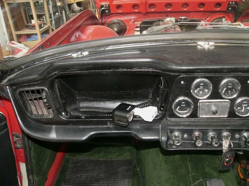

Today was blasted-hot under the polytunnel, but at least I did do this . . .
^ dual cigarette charger socket wired in, to take the TomTom, and a dual USB charging adapter (for the phone). Fortunately, the TR's glove box is surprisingly deep, and I hope sufficiently tall an aperture to take the 7" TomTom (spec's tell you screen size and resolution but I couldn't find its overall dimensions).  I had the cable / cigarette lighters charger from years ago ..when I toured on a BMW motorcycle, so I've now wired that to fused-switched-live. The TomTom has now been dispatched so hopefully I'll get it on Monday or Tuesday.
As I say not a lot to report, but still a busy time and again one step closer to having the car ready for touring.
