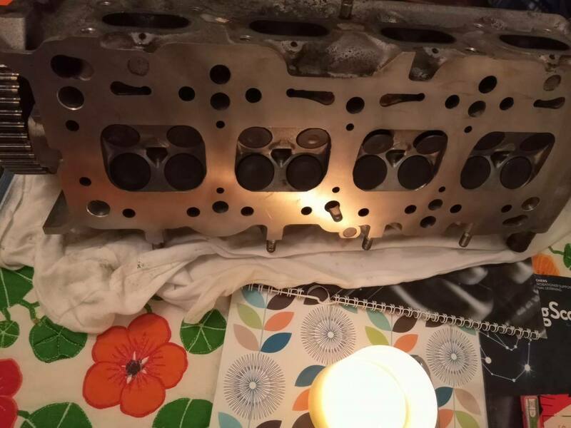

On returning from work on Sunday, I turned my attentions to the 323.  The head came off in double-quick time this time, and I have just dropped it off at the machine shop in town for 'the works'.  Saturday then will be the day to tackle the piston rings and cleaning up the block for reassembly.  Hopefully, with a new set of rings and the head done she will go for another 30 years!
I have asked for a skim and pressure test, valves lapped and tappets reset, and he has said it will be £150.  I'm supplying the stem seals, seems a  good price to me?  They are a very busy and well-regarded place around here.

Wee Mazda's head has been pressure tested, lightly skimmed, the valves lapped in and tappets reset.  £130, which seems very reasonable.  Large, but very friendly place in Elgin, a guy that I have used many times before for work gear.
The only obstacle now is the weather, horizontal sleety snow at the moment so not too hopeful!  Plan is to do the rings, clean the block face up while they're out, and 'simply refit'!
Should be good for another few years of 'zoom-zooming' after that.

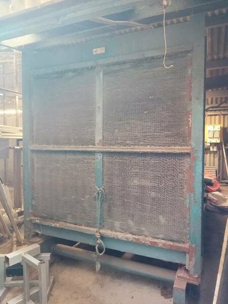

My work project this week.  It's a Dorman V12 28 litre, twin turbo diesel, used to power our standby generator at work.  When I was Engineer, I used to run it up once or twice a month, but my move over to the dark side ( the office), plus an increasingly silted up radiator has left it dormant for 2 or 3 years now.  It makes a lot of noise, and the reek!  Lovely.
A firm in Inverness has been tasked with the rad re-core...
(It's a couple of metres square, and too big to lift out the door, so still thinking about that!).  But I know she runs well for a half-hour or so, before the safety temp cut-out objects, so I hope to start her this week anyway.
I think our Engineers are a wee bit nervous, but they're charging the batteries and blowing out the air filters regardless.  These old things are all over the world apparently, patiently waiting in skyscraper basements to keep the lights on when Vlad turns off the tap.  Ran like a top when 'parked', I will attempt to video the big fire-up and link here for posterity.
Cool, huh?!  We'll probably never use her in anger, as the power is usually back on before there's been time to complete the rather nerve-wracking switch-over process.  But, I'm to make us more 'resilient' to these things, so that's enough of an excuse to play with engines for me!

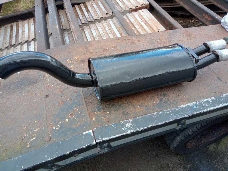

On our return, as it was such a Spring-like day I decided to replace the Audi Coupe's backbox.  The eBay seller was true to their word, it is in great nick and a perfect fit.
The old one looked like it had been dragged up from the bottom...
Expert level chemical metal application here...
The 'new' one is great, but I gave it a quick brush and paint anyway...
I was £60 for this, which I am pretty chuffed with.  It sounds pretty farty still, as the centre resonator is holed.  They never get better by themselves do they?!

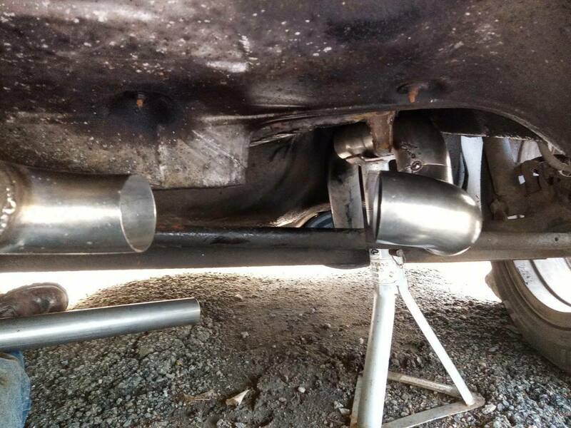

Yep, after procrastinating and bodging the old one up, I finally decided to have a go myself.  eBay, well a Walsall-based exhaust firm thereon, provided the above stainless goodies for just under a hundred quid delivered  (I'd already bought a good used backbox, and the cat section was already stainless).
First up, elevation...
This worked really well, although my back is still in tatters after a day crawling under there.  Here's what came out...

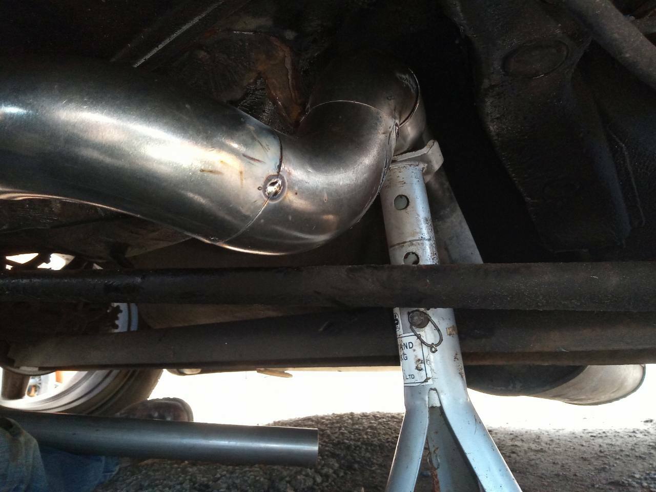

There was a extra length of pipe between the cat and the resonator for some reason, the joiners just blew out the whole time, weird.  I had already decided to do away with the centre box (which cost a fortune, in Germany, in mild steel), so started at the front...
That's the cat section welded to an offcut that came with the car (this is why I can't understand them cutting it short and letting an extra bit in?).  I had borrowed some 2mm stainless rods from work, and my little arc welder has been great just recently, allowing fairly neat work on this thin steel.  Don't get me wrong, mig would've been easier, but this is ok.
The wee 90 degree on the end is the start of the 'resonator delete' pipework.
Trial fit.
Car's clean as a whistle underneath still, very happy with my oily brew and Audi's galvanising job.
Found it easier not to measure out, just took the bits under and marked them where they needed to join the next one.  Cut and tacked up on the bench, and then back under for a look.
This wee section up and over the rear beam to the back box was easily made up with the 90 degree pieces, very satisfying...
It joins to the backbox with a swaged coupling, which allows a bit of tweaking too.  That just left a short gap across the car...
I cut a straight length, but there was too much angle, I thought I might have gotten away with it, but no.  Cut my tacks and welded in a short spacer piece...
Success.  All that was needed at this point was to mark out for the hangers (just cut them off the old exhaust and stuck 'em on this one), and weld it all up...
Still need a slightly longer rubber donut for the middle, so will head to Halfords tomorrow, but it's nice and solid anyway.  Quite chuffed all in all, sorted for the test without too much spendz, and sounds nice too!  Will change the oil tomorrow, and maybe the brake pads.

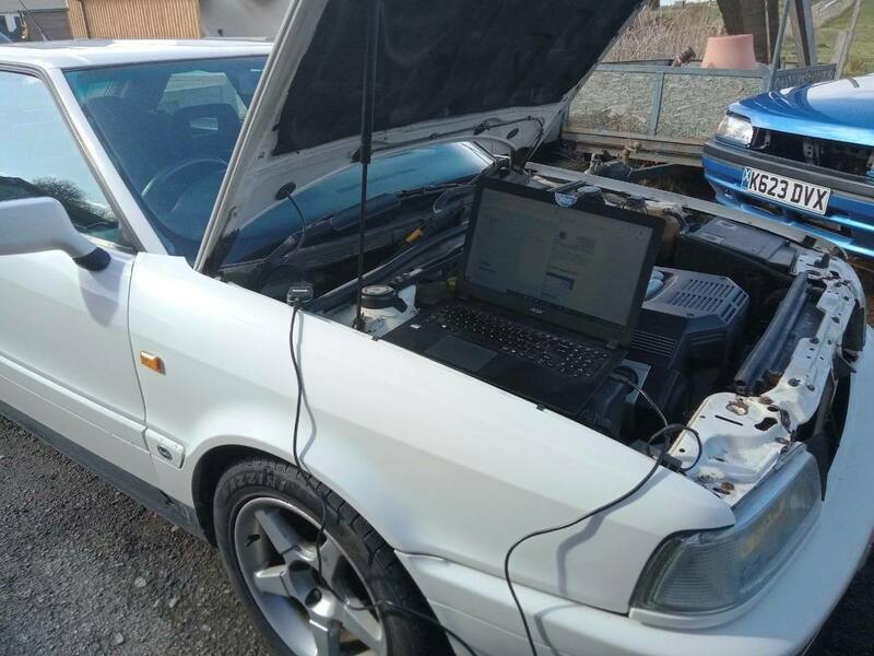

Well, one step forward, two steps back!
Audi...
Still failed on emissions, although the reconnected intake air temp sensor did bring the CO2 readings right down (they were just in and no more before).  Lambda readings unaffected, ie still shite.
I have been reading up (VCDS showed no fault codes, helpfully), and the fuel pressure regulator valve is a common failure point apparently.  They get sticky, and allow the rail pressure to rise, so the injectors get more than they need.  Anyway, easy to change and cheap, so one ordered.
I pulled the lambda probes (one each side of the V, but none after the cat), they looked pretty clean, and the resistance was the same through both.  I blasted them with electro clean anyway, and they did come up a bit cleaner tbf.  Car started differently once all back together, revved up and held it for a few seconds before coming down again.  Lambda fault codes were then present, which went away on reset, and haven't come back.  Car running perfectly, and smells less fuelly maybe?  Lambdas ordered anyway.  My mechanic is due to ring when he has the front tyres in, so he'll check emissions again then, we'll get there.
