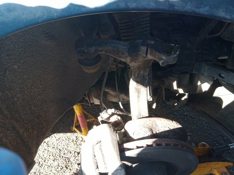

Been doing little bits at a time after work, as it's now still light and warm enough when I get home.
First step was the jacking/supporting.  Again, the truck bed height is ideal for this sort of rust prevention work.
Wheel arch liners out next, tbh was expecting some grot on the old girl, she's covered 210,000 miles in her 28 years, but...
... apparently Audi 80's don't really do that sort of thing!  Very clean under the road dirt, if I kept scrubbing I could just have her body coloured under there, which would be a first for me!  Still deciding, but will probably coat it all for protection.
Nicely built old car, no real water traps or exposed seams, shows what they could achieve if they wanted to...  The discs have rusted with sitting over winter, but they're working fine without dragging so I think they'll come good with more miles.
Next, we removed the centre and rear boxes, they are solid, but not great looking.  I have cleaned them up with the wire wheel, and will look for new, but they'll go back on for the test this time I think.  I've a week off after next week, during which I'd like to get this and the 323 road legal, so time is of the essence...
Bandaged up a wee pinhole towards the rear.  I've some high temp paint in the shed, considering some vactan and black topcoat on it, show a bit of willing for the mot man?  Wouldn't expect it to last forever, but couldn't hurt.

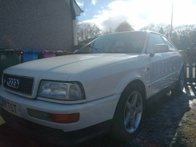

Slightly better weather today (freezing but only snowed for a bit in the morning), so washing was achieved...  not looking bad for an old'un!
Needs a respray to be perfect, but being white hides a lot of the lack of shine.  Really need to find (or get made?) the missing two wheel centres, and get the wheels refurbed.  Anyway, that's it until Thursday morning, when I am planning a cobweb-clearing out, two -hour long drive to my mot man, who is about twenty minutes away...

Passed without advisories!
The old stager didn't let me down...
208,000 miles now, I'll try and polish some shine into the paint and see about a nice exhaust, she's earned it!
