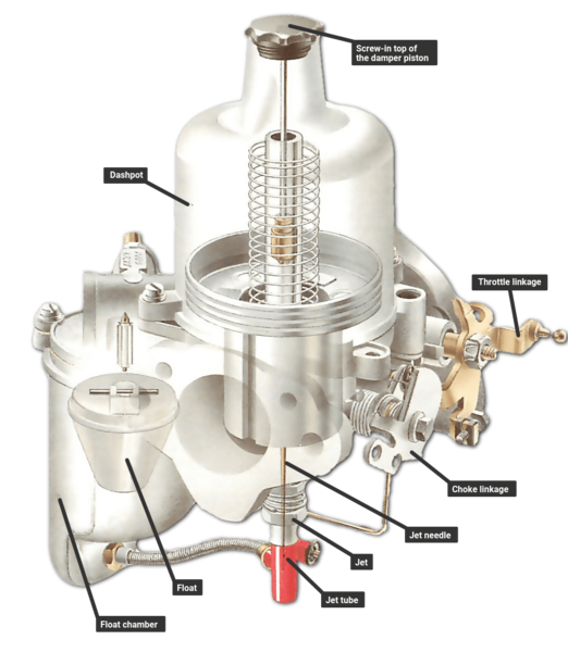

A bogging and spluttering issue, goes well but let of the throttle to approach a round about and when you stop or slow down and try to pull away its bogging down and spluttering untill it clears its throat.  Maybe over fueling? Im not sure but ill have a nosey through and find out.
The tyres are really really old and mismatched. Flatspotted and the ROSAVA has buldged the sidewalls. 4 new boots will be fitted Asap.
The first thing I'd look at is to see if the choke is closing properly. Either the choke cable or the linkage on the carbs can stick. When you pull the choke cable it pulls the jets downwards. When you put it back the jets should sit hard up against the bottom of the carb. If you reach under and push the jet upwards there should be no movement at all. If there is it hasn't returned properly. The jet is the red plastic thing at the bottom of the carb. Unless you have waxstat jets of course which just opens up a whole new level of pointless complexity. I added an extra return spring to mine.
checking-and-cleaning-an-su-carburettor.thumb.png.30c2b7db0648c6a61a344395364b1380.png
After that it would be the usual things. Check the points and condenser. You can't really check the condenser, you just put another one on. Spark plugs. Obviously check the gaps, but also being twin carb, if two are blacker than the other two, your carbs are out of balance. Also check the oil in the dashpots. There seem to be lots of arguments about what oil to use but I just use 20/50.
You could use the most sophisticated tools available to try and balance the carbs but two weeks later you'd have to do it again. That's just the way SU's are. You can live with a little imbalance, it's just when they get way out you need to sort them.
That's enough to start with isn't it?
+1 for dashpot oil to prevent piston flutter. Other things to check are that both carb. pistons go up and down freely and cleanly and in synch, with each other when the throttle is opened. Also, check that the needles are of equal (and correct) sizes and are centred properly in the jets...
IIRC the books say 20/50 for dashpot oil.  Could be wear on needles or jets but I'd check fuel delivery & ignition first.

Spluttering - does it have the silly wax jets on the carb? Also poppet valves on the butterfly valve? Both are problematic especially as they age.
Tbh if the carb is probably worth a rebuild if it hasn't been done in a while/if ever. Kits are available from SU/Burlen and are excellent quality. SUs are a piece of cake to rebuild and I find it quite enjoyable! Gives a chance to make it E10 compliant.

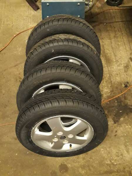

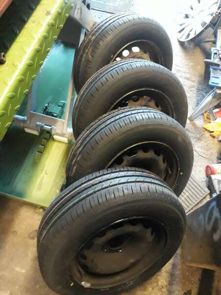

When i picked up the changer and balancer, i bought myself a bag of 100 tyre valves, i thought they would last me a lifetime but i was wrong. Im approaching half way through!  Counting them up id say ive done 46 tyre swaps and balance since i got the two machines.
Last week id done Rikens on father rews ignis
Toyo nanos on a work van
And today see the shitfire get some matching toyo boots all round and a car dealer spec wheel refurb.

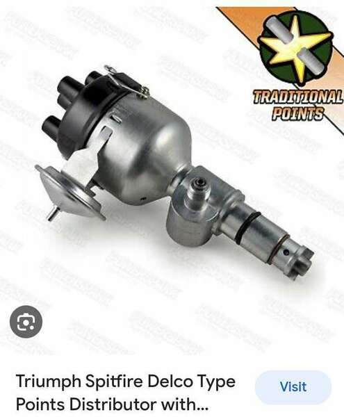

Teach away.  This car isnt really anything im used to, im a have a go tinkerer at best and This kind of old tech is is something im interested to learn about.
Im not fully convinced the ignition system is all that, Its been gone through and theres a few points and condesors in the boot to show this has been an ongoing issue,  Ive picked up some more via work but intermotor is the only option available to me.
They always say running issues with old British cars its invariably on the igntion side, not the carb side.
Intermotor condensers and rotor arms are shit. Throw them straight in the bin. Their points are acceptable.
This what you need:
https://www.moss-europe.co.uk/condenser-lead-25d-high-quality-gsc111hq.html
Lead will be wrong, just unsolder the fly lead, chop the ones off the existing and solder it on.
Also get a genuine distributor doctor rotor arm. Are you on a Lucas 45d?
https://www.moss-europe.co.uk/rotor-arm-45d4-high-quality-gra2114hq.html
Replacing the condenser and rotor arm with genuine Distributor Doctor won't neccessarily fix your problem. But if you're on Intermotor condenser+rotor parts then they are a suspect and only a matter of time before they will leave you stranded.

Not the lucas, seems to the the delco unit with the shallow cap like below.
