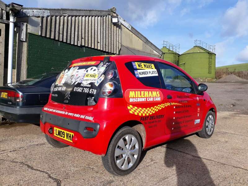

Its our delivery Citroen c1. Only on 33k miles but being povo spec with no C/L its door locks have already been replaced with some ebay shit. The boot one is original , however it was a bit iffy when we got it 6 or so months ago. Opening an average of maybe 30 times a day 6 days a week its given up.  With the standard water ingress issues filling the boot up its time to fix it.
Having been here before i repeated the same process id done on the Pug. Which is still doing grand service by the way.
Anyway, Bumper off reveals the grime and the gaskets on the vents are pretty shagged.
Lock out. I stripped it down and filed the edges from the tumblers(?). I filed away any damage in the casting and will a blast out and some lube it works fine.
So much shite behind here!
Rinsed, soaked with a bit of APC then scrubbed with a brush. Rinsed again and all grommets/bungs were removed. I then dried it with a cloth and an air line to get in the nooks.
Some cheapy polyurethane sealant dooted around the place and around anything that goes through the bodywork. Vents get a big thick bead around them off the car then clipped in place. As we are not fused about looks everything was smeared with a finger and has now been left to dry.
Rear highlevel recieved the same as id done before. Light out, scrape off degraded  sponge seal then light back in and mask off a neat area and run poly sealant around it.
The car is in the workshop drying and ill be collecting it later today.
