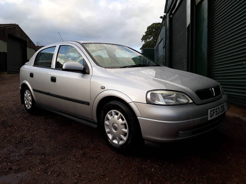

8 hours ago, sierraman said:
How did you get such a good finish with silver. It always looks terrible when I spray it.
That photo really flatters it. It's pretty shite in person!
I’m so glad you’re making a good car out of this where I failed to have a working car for most of the time I had it. Broken spring and dead battery maybe a sign the curse is still going, Hope that’s the last of it.
Re the handling, I think magazine journos call it safe understeer, not sure I agree
I get a good car vibe from it, something about old motors that just plod along. They have a certain charm and faults are just the norm really.
The battery was old and we must sell 20+ springs a week for Vauxhalls at work. So a busted coil wasn't much of a surprise.
I love the fact I can go scrap yard rummaging again too!
Handling wise I think the 175/80/14 balloon tyres combined with some worn in suspension doesnt help ? but it's comfy.

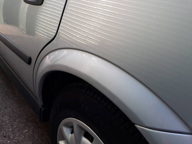

As we had a nice day yesterday with the sun blazing I decide to smarten up the front corner of the bumper. With the heat and wind the basecoat dried a bit to quick from the Can and most was blown away. so on the corner it's a bit tiger stripey it was done relatively quickly so it's a good enough repair for now. The clear ran but I nibbed this out tonight and whipped over with some 2000 grit and a blob of compound.

Will do the other side and the other wheel arch when I can get it in the workshop as the yard is a bit windy/dusty/buggy for painting.
Handily the filler, primer and laquer were all free samples to test from work so the only thing I needed to buy was a can of basecoat.

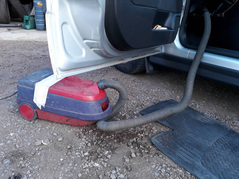

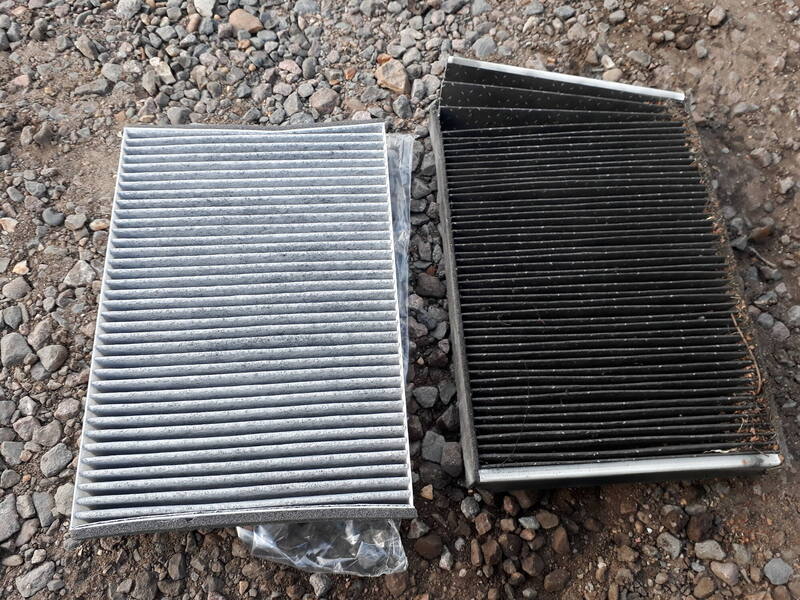

Decide to Wang a new cabin filter in as it's often overlooked.  Had a GM part number on it so possibly many moons old unless it's had dealer services.
It was in dia need of a change. Charcoal filter filter fitted because swanky.  The housing was a bit clagged so some hot turbo vac action was needed ( I can hear beko rubbing his thighs from here )

Looks really tidy! Theres a YouTube channel (torque steer iirc) where the lad did a series of videos detailing his dad's filthy 270000 mile Eco4.

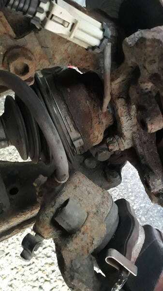

After singing it's praises yesterday and giving it a clean out after a tip run this morning the ecto4 returned the favour by seizing the passengers front caliper whilst whipping down the a5 to Milton Keynes . That distinctive smell of cooked brake pad and the plume of smoke from the passengers wheel when I came off the slip road.  Deja vu as the Carlton I use to have did the same thing on the same bit of road!
Limped to the car park and left It too cool off. Hub cap had gone really soft and was untouchable. I'd previously noticed some sqeaks from the brakes after a longer journey so this hasn't come as much of a surprise, I was going to strip them down for a clean and grease up tomorow night!
Once cool it drove home fine. Will strip it down, Wang some new pads in and Change the brake fluid.  Check if the wheel bearing has been boiled to death and give the caliper a once over or swap for a spare that a mate gave me for free .
All Vauxhalls are . . . .
Stripped the brake down that had a stuck pad and as expected it was a build up of shite around the pad ends on the carrier. Cleaned and filed smoother I shoved the old discs and pads back on, not ideal but I couldn't tell on the way to the workshop if the disc had warped.
Upon stripping down the sliders pin cane undone concerningly easily. The video shows why. Seems the thread in the casting is not more. Balls.  Time for some bodging to get home
In the past I may have been known to helicoil a caliper slider pin into a carrier with no long term ill effects.  M9 from memory - ebayed it from the states.  I don't know if it got cleared out in the house move though.  Not sure why I didn't just buy a caliper carrier.
Fantastic rattle canning BTW, what is your tactic on blending into the original paint?  I've tried feathering in the primer, then the colour with a little overlap and then the clear coat with a bigger overlap still.  Looks awful until I wet n dry and polish then it's as good as the colour match.  I'd be very happy if i'd done that arch though - looks flawless in the photo.
I think A helicoil is the best option for now.
On these the carrier is part of the strut and hub mount, it's all one piece. A good and bad designs I suppose.
Exactly the same process, any rattle can clear always seems to dry to a dull finish and needs a buff after a few days cure time.
I always try to paint to the nearest edge to hide the blend, luckily with he Astra there's alot of edges to paint to. With the only blend being between the reg plate and bonnet.
In person I think it's a fairly obvious repair but to most people it needs pointing out and goes unnoticed. I'll do a more in depth write up when I do the other side but it sounds like you are already doing it as I would.
I've heard of people using cutting compound on the basecoat to blend in a repair but ive never tried it myself.
