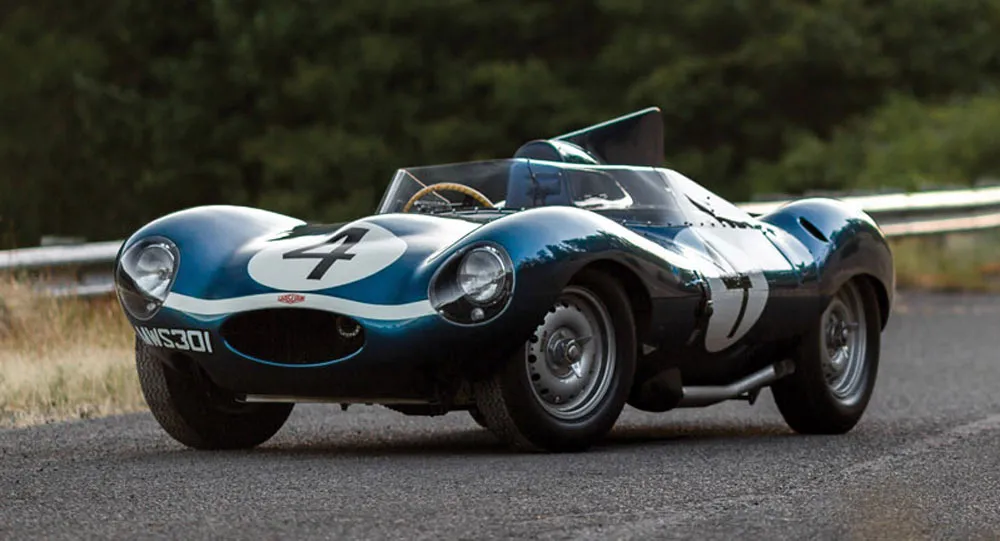

While waiting for the speedo to arrive I have got the old hairdryer out and removed the bonnet stripes.
Looks a bit naked now but it's part of the long term plan for once the mechanical are up to scratch, the inspiration being:
jaguar-d-type-xkd-501-raced-by-ecurie-ec
