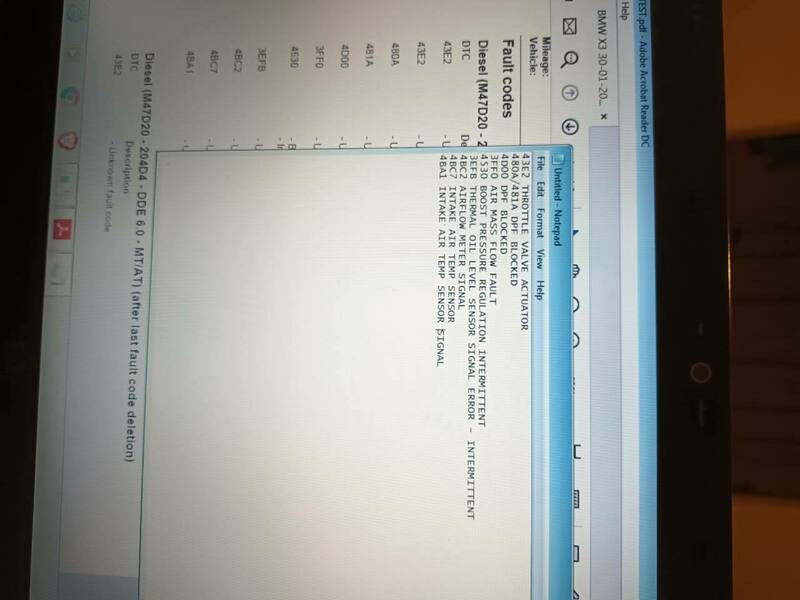

The X3 has had almost 1k more miles under its belt and its not all rosy.
Haven't had the tyres changed yet because I'm waiting to see if anything anything else is going to go wrong.
so yeah not great.

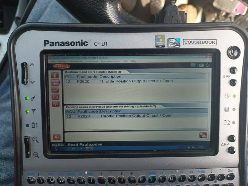

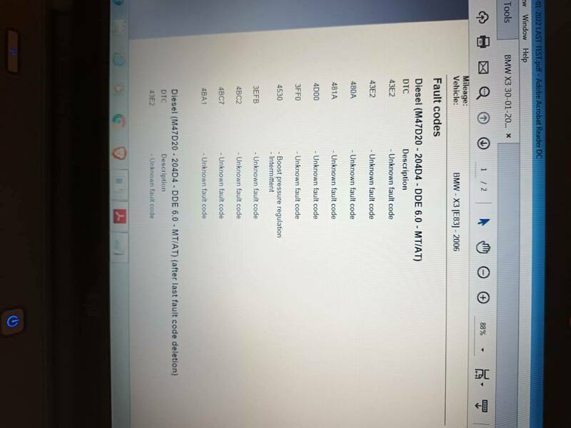

Block dpf made sense in that the temp gauge rarely gets anywhere near halfway which means the car won't initiate a regeneration unless the engine temp is above 75°C.
I cleared all codes and did a throttle body recalibration which has restored some of the performance but air mass, egr and dpf codes have popped back up.

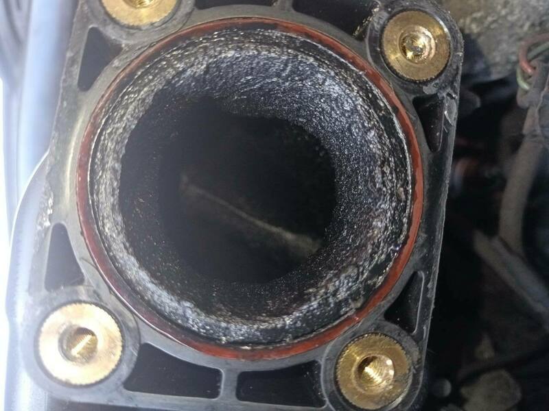

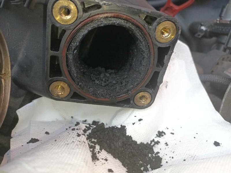

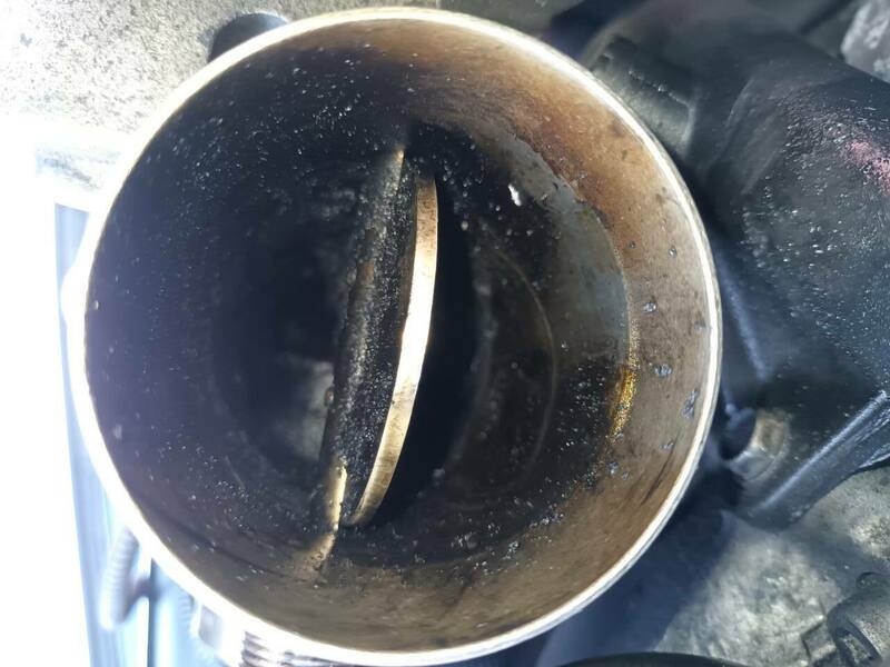

Spirited on by good weather today I though it would be a good opportunity to have a look at the egr valve as I was pretty sure it would be gunked  up.
The top two bolts were easy but the bottom right had to be done by touch as it was impossible to see. Someone had obviously been here before as the bottom left bolt was missing!
On the face of it didn't look too bad. I forgot to take a pics of the valve end but the inlet manifold should give you a fair indication. Of what it looked like
REALLY NASTY. It was a good 4mm thick all round.
spent a good 20mins gradually scraping out what I could reach being careful to not leave any loose debris inside.

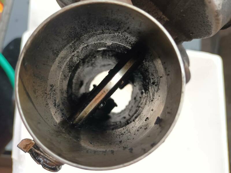

I've current got the valve soaking in Mr Muscle oven cleaner as brake cleaner didn't really make a dent. The valve was totally seized with carbon.
In other news the Roadmaster is peforming daily duties without fault so I treated it to a bath

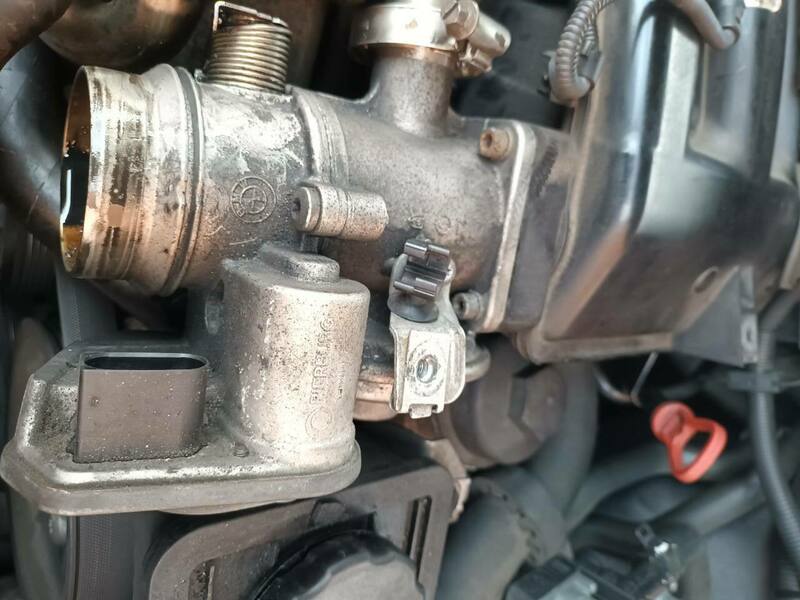

After its overnight soak in Mr Muscle the egr and throttle body looked decidedly less shit
20220312_162757.thumb.jpg.549354be3827f1441bdd1210ab52518f.jpg20220313_115600.thumb.jpg.95b4ddb50763add1d191a31ca3bf9300.jpg
Feeling very pleased with myself, I popped it back on the car expecting a restoration of performance and fuel economy to be within easy grasp.
20220313_155226.thumb.jpg.d7e3581ba4baf91bf4e92a9950bb2f67.jpgthat'll be a no then!
Cleaning it out hasn't changed it in the slightest. New throttle bodies are around £250-£300 so I'll travel the used part route first and see what happens.

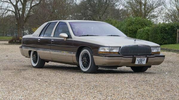

Road masters looking great! How’s the Mercury doing?
It's been hibernating for a year. Needs a new exhaust brakes and a service. All will be done in the next few months

It does like hibernation, ordering the H pipe for it?

Yep I ordered the h pipe from Rock auto which I was assured was the correct one. It arrived and it transpires its for the later 92 onwards 4.6 Crown Vic. Didn't realise until it was too late.
I'm taking it to infinity Exhausts to have a custom made lifetime guarantee h Pipe knocked up.

Bummer. But a stainless will out live the rest of it so it’s a good choice. There’s a few newer crown vics in this country so you might be able to flog it on.
With regards to the roadmaster, i'm struggling to gel with it. It's a nice ride and powerful but something is missing in comparison with the Mercury but I just can't pinpoint what.

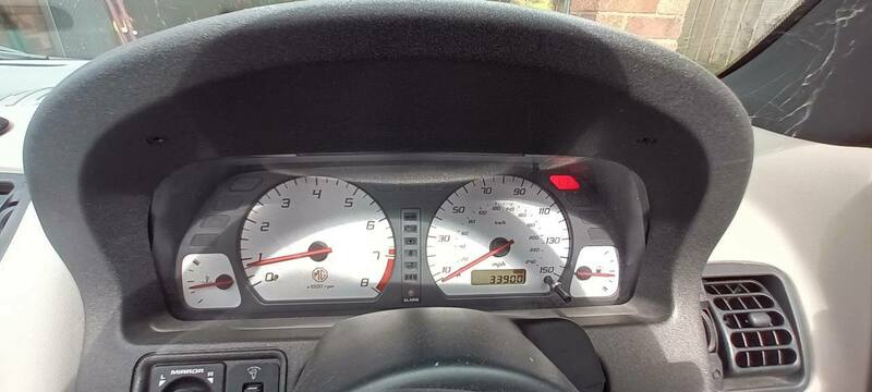

No, it's the 135bhp 18k4f engine but considering the mileage Im not that unhappy.
Giveaway is that VVC redline starts at 7250rpm and TBH whilst the VVC is nice, the higher rpm has it screaming it's head off and gets annoying quite quickly.
I much prefer the TF to the VVC F that I had back in 2013 as the ride is better.

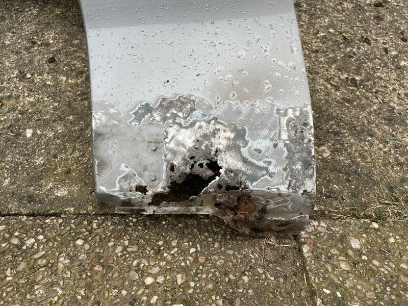

Mercury still waiting her turn. Been trying to get a passenger wing from the states as it currently rotten to fuck. Will have to temp patch it for the most soon but it'll need doing relatively sharpish.
Maybe it’s worth getting it repaired. I’ve currently got the wings off the Carlton for repair as they’re rotten too.
