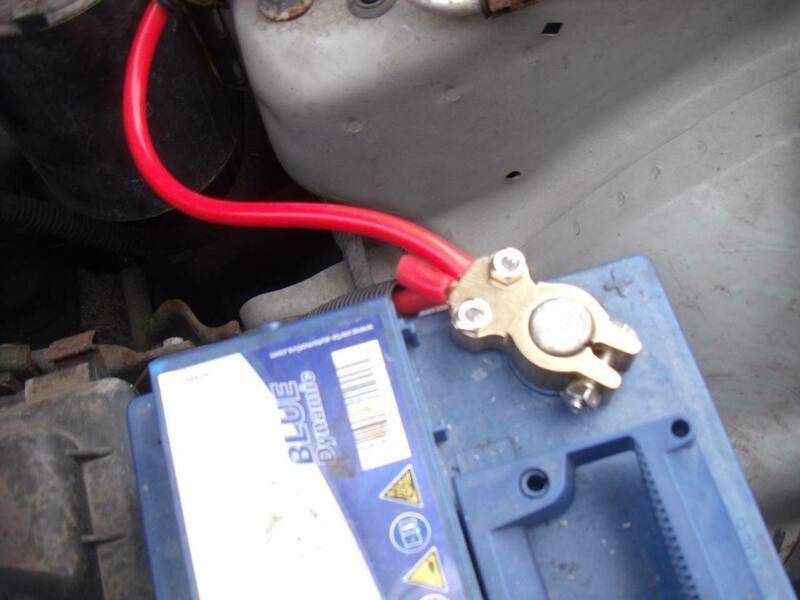

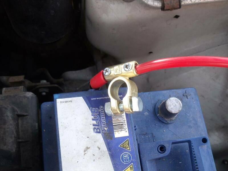

BL Bloke Posted April 8, 2022 Author Posted April 8, 2022 Last Saturday the Saxo, which is the highest mileage, or should that be least low mileage, car on the fleet clocked up another 1000 miles. In other news I decided to sort out the Rover's loose battery clamp. As I mentioned in the previous post even with a shim on the post it won't tighten up enough to grip the post. A quick trip to Halfords and I had a clamp that fitted. Unfortunately after removing the old clamp and trimming back the insulation on the cables it wouldn't reach the post. I have bought a new cable so it does reach now but I'm wondering if I should buy a clamp with a 2 way connector as at the moment it has a cable coming in from each side of the clamp and I'm concerned that it may cause problems if I use it like it is. Any suggestions welcome. Remspoor, theshadow and Burnside 3
BL Bloke Posted May 12, 2022 Author Posted May 12, 2022 A quick update on the Rover's battery troubles. At the end of the last post I had this, which I wasn't happy with. I bought another clamp with a 2 way connector and fitted that which looked more like the original set up. The battery had been charged three weeks earlier and had been in the car disconnected since then but after a few turns of the key the Rover fired up for the first time in over a month and over the next few days just over 100 miles added. Since then it hasn't been used for a week and half so yesterday evening I thought I'd see if it would start. Nope. ☹️ As the battery held charge when it was disconnected I'm assuming that the battery is OK and the problem is elsewhere. The question is, where? theshadow 1
RoverFolkUs Posted May 12, 2022 Posted May 12, 2022 27 minutes ago, BL Bloke said: A quick update on the Rover's battery troubles. At the end of the last post I had this, which I wasn't happy with. I bought another clamp with a 2 way connector and fitted that which looked more like the original set up. The battery had been charged three weeks earlier and had been in the car disconnected since then but after a few turns of the key the Rover fired up for the first time in over a month and over the next few days just over 100 miles added. Since then it hasn't been used for a week and half so yesterday evening I thought I'd see if it would start. Nope. ☹️ As the battery held charge when it was disconnected I'm assuming that the battery is OK and the problem is elsewhere. The question is, where? Likely a parasitic drain, got an amp clamp? You could put a multi meter in series, but that's generally less accurate as not everything "wakes up" It's not possible to fully assess a battery's condition without a load test, you could try popping it to one of those "free battery check" outfits and ask them specifically for the CCA rating (not just their opinion on whether it needs replacing) Also; is the car definitely charging fine? Getting ~14v at idle with lots of things switched on - headlights, wipers, blowers etc? BL Bloke 1
RoverFolkUs Posted May 12, 2022 Posted May 12, 2022 Also - what's the current rating of that new positive cable? Looks a tad wimpy to me for a main battery lead tommytwo 1

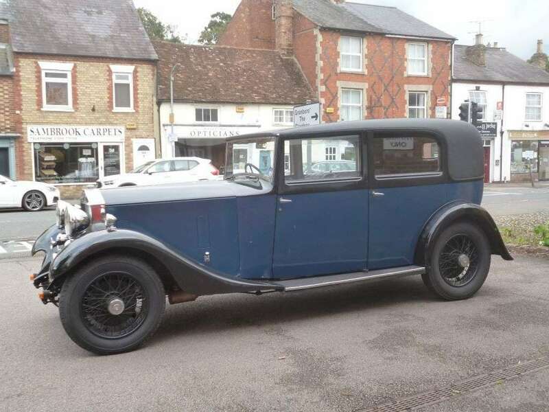

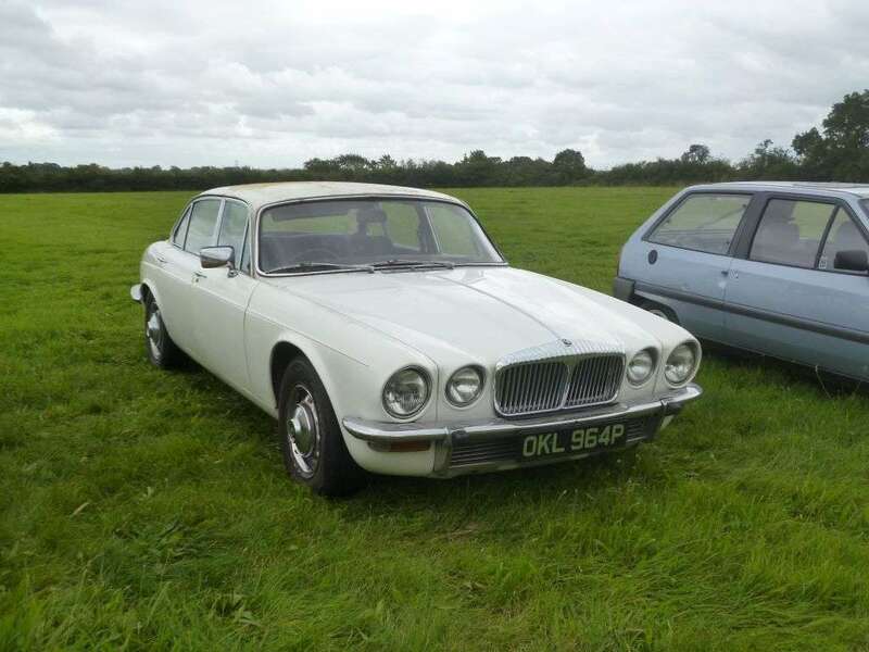

BL Bloke Posted August 22, 2023 Author Posted August 22, 2023 The Rover went in for the mot work last week so it's OK or another year and my wallet is a fair bit lighter. The rear wheel arch looks a lot better than it did in the previous post. The weekend before it was the Fabia's turn to visit the FoD, where it found itself next to @bobdisk's DAF. On the way down it clocked up 37000 miles, not bad for ten and a half years. While I was there I had a brief drive around the field in the Mk2 Daimler and a ride to the chippy in the back of the Rolls Royce. Thanks to @Six-cylinder and @Mrs6C for a great day, it was nice to see the fleet lined up. 🙂 Back to my fleet and the Saxo had a little run out last week. The o/s/f brake sounds like it's rubbing a bit, the front suspension clonks a bit and the heater still doesn't work but apart from that it's OK. Finally I found out which clips I needed to reattach the 205's rear valance so I've ordered some so I can get it sorted out. Floatylight, Dyslexic Viking, Spottedlaurel and 5 others 8

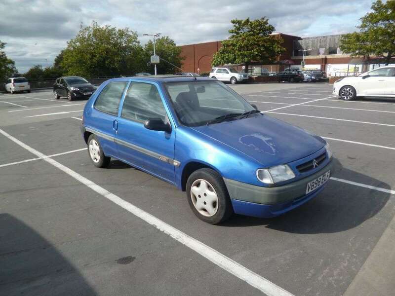

BL Bloke Posted August 23, 2023 Author Posted August 23, 2023 Today marks four years since I went down to that London and came home in a £200 Citroen Saxo. 🙂 To mark the occasion it came out of the garage for the weekly run to Sainsbury's. The front brake sounded better than it did last week so it might have just been sticking a bit due to lack of use as it's only done about 730 miles since April 2022. I really need to get the heater control working again though as it gets a bit* warm this time of year, which means I can't use it as much a I'd like. 🙁 In other news, the clips for the 205's rear valance arrived today. 🙂 Hopefully fitting them won't be too difficult. As I've mentioned before I could really do with reducing the fleet as I never meant to have four cars. The idea was to have the Fabia for my daily and an 'old' car for high day and holidays. I've worked out that if I sell the Rover, one of the smoll Frenchies and give up the tenancy on my garage I'd be around £1700 better off going by this years costs, which will of course be more next year. Burnside 1

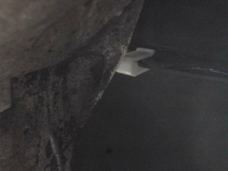

BL Bloke Posted January 14, 2024 Author Posted January 14, 2024 After nearly five months I reckon it's time for an update on the 205. Things haven't been going well. 😟 I made a partially successful attempt to fit the clips on the 205's rear valance. I managed to just about get the outer one to grip the bumper an valance as it's accessible from the rear wheel arch. The inner two seem to be inaccessible unless you get under the car or remove the bumper, neither of which I was comfortable with, so they're still in the bag. While I was around the back end I noticed that the panel on the tailgate had cracked down the one side, which has temporarily been stuck together with parcel tape. This got me thinking that maybe I should move it on and find a good home for it before anything else happens, and then, at the end of November ... the driver's door wouldn't unlock. 🙁 This problem started at Shitefest but I thought it'd sorted itself out. Obviously I was wrong so since then I've been stressing out about how much it'll cost to get it fixed and whether I should get it sorted and then sell it or sell it as is. 😕 Any suggestions welcome. N Dentressangle 1

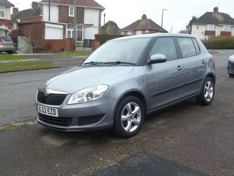

BL Bloke Posted January 22, 2024 Author Posted January 22, 2024 Quick update. The insurance renewal on the Saxo came through a couple of weeks ago £107 more than last year. By going online an increasing the mileage from 3000 to 4000 I've got a quote for £4 more than last year so I've gone with that. The Fabia was 11 years old last week so has got slightly shiteier. 🙂 Lastly, the for sale ad or the 205 is up. RobT 1

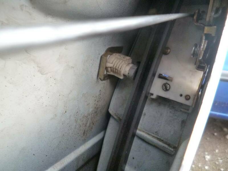

BL Bloke Posted March 3, 2024 Author Posted March 3, 2024 Last Thursday I took the 205 out for a run as I wanted to clock up 3500 miles in it before the MOT ran out on Friday. When I got back home I stripped the fittings and trim panel from the driver's door to have a look at the lock mechanism. While it was off I gave the door pocket a wash to see if I could remove the discolouration on it but without success. Once the panel was off I realised that I didn't really know what I was looking for but it looks like the rod connecting the interior handle to the lock has been moved forward as the handle popped out of its mounting hole when the trim panel was removed. I did take some pics of the inside of the door in case anyone can give me an idea as to how the lock operates. I still keep thinking that I should have sold it as I don't have a good history with cars and lapsed MOTs. 🙁 I'm thinking of updating the for sale thread and seeing if anyone still willing to take it on. In happier news the Saxo has had its first wash since I bought it four and a half years ago and it had lichen growing on it even then. It does look a lot better, even though its battle scars show up more and the peeling lacquer on the roof got blasted off. It's going in or its MOT on Tuesday so hopefully it'll pass. I'll leave you with a shot of the driveway. Remspoor and AnnoyingPentium 2
