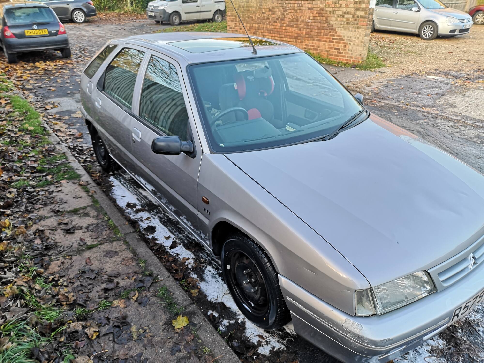

So, this old thing. It's been utterly reliable quite frankly all summer! One of the droplinks came loose leaving Shitefest, and I had to get 2 tyres the other week, but THAT'S IT!
Ticked over 66k a while ago, and it's MOT time soon. So this morning, it was not pissing it down which is fab, so I get out there!
And proceeded to put the brand new, and 300 mile old tyres on the front, the second best two on the rear, and then the worst, which has just started to edge its shoulder in a fine-for-several-thousand-miles-but-get-the-tracking-done kind of way, so it's now the spare!
Whilst I was doing this I noted how filthy it was, I've washed it once, in summer at my dad's with a sponge... It's now November...

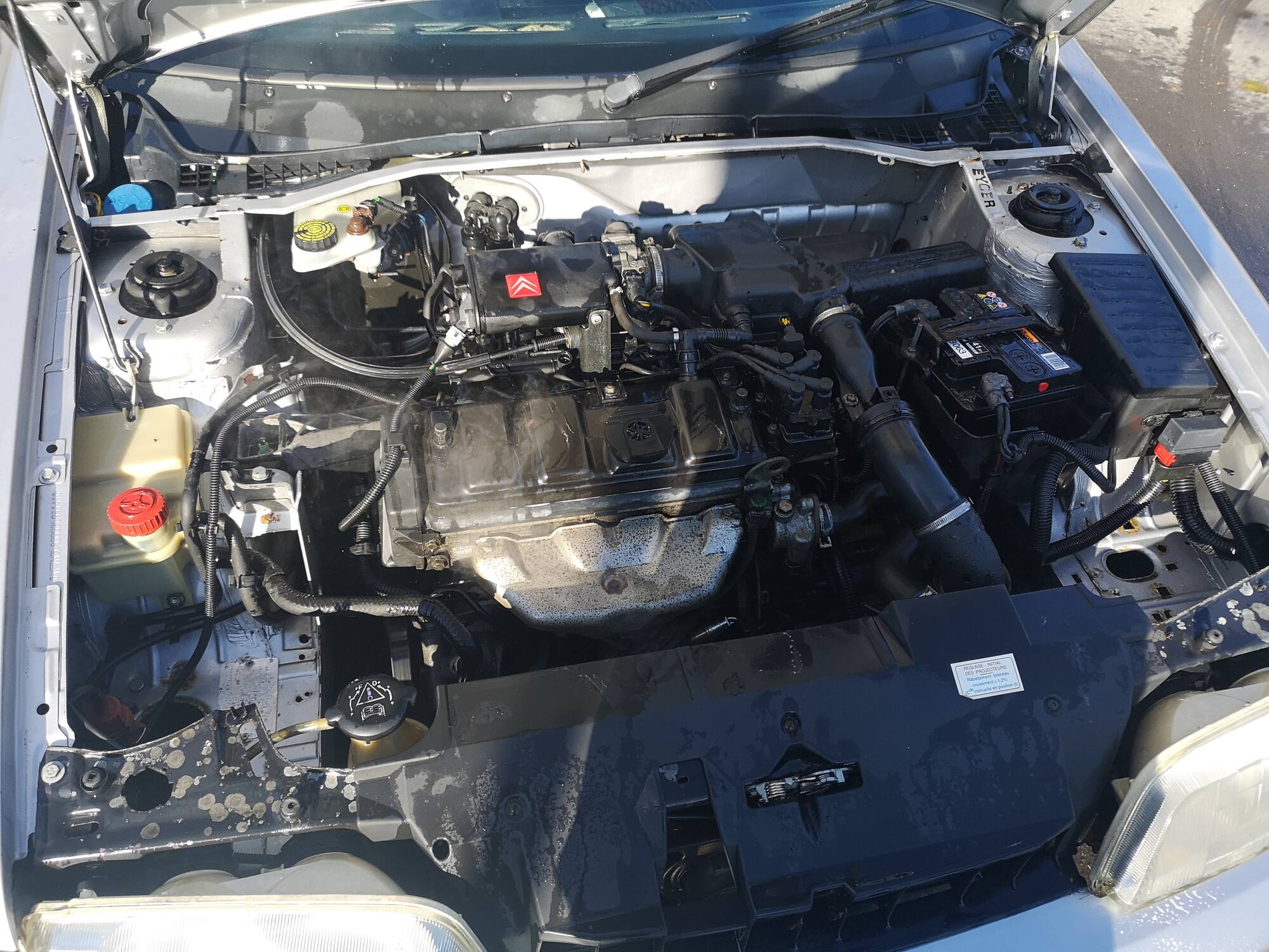

Then I gave it a clean, starting with the engine bay
G101 and brushes were used
Looks way better! It's very clean under all the filth, just a few surface scabs here and there. It also now drains from the scuttle, and bar a panic as I tripped the fuel cut off it fired back up and I let it dry the exhaust off.

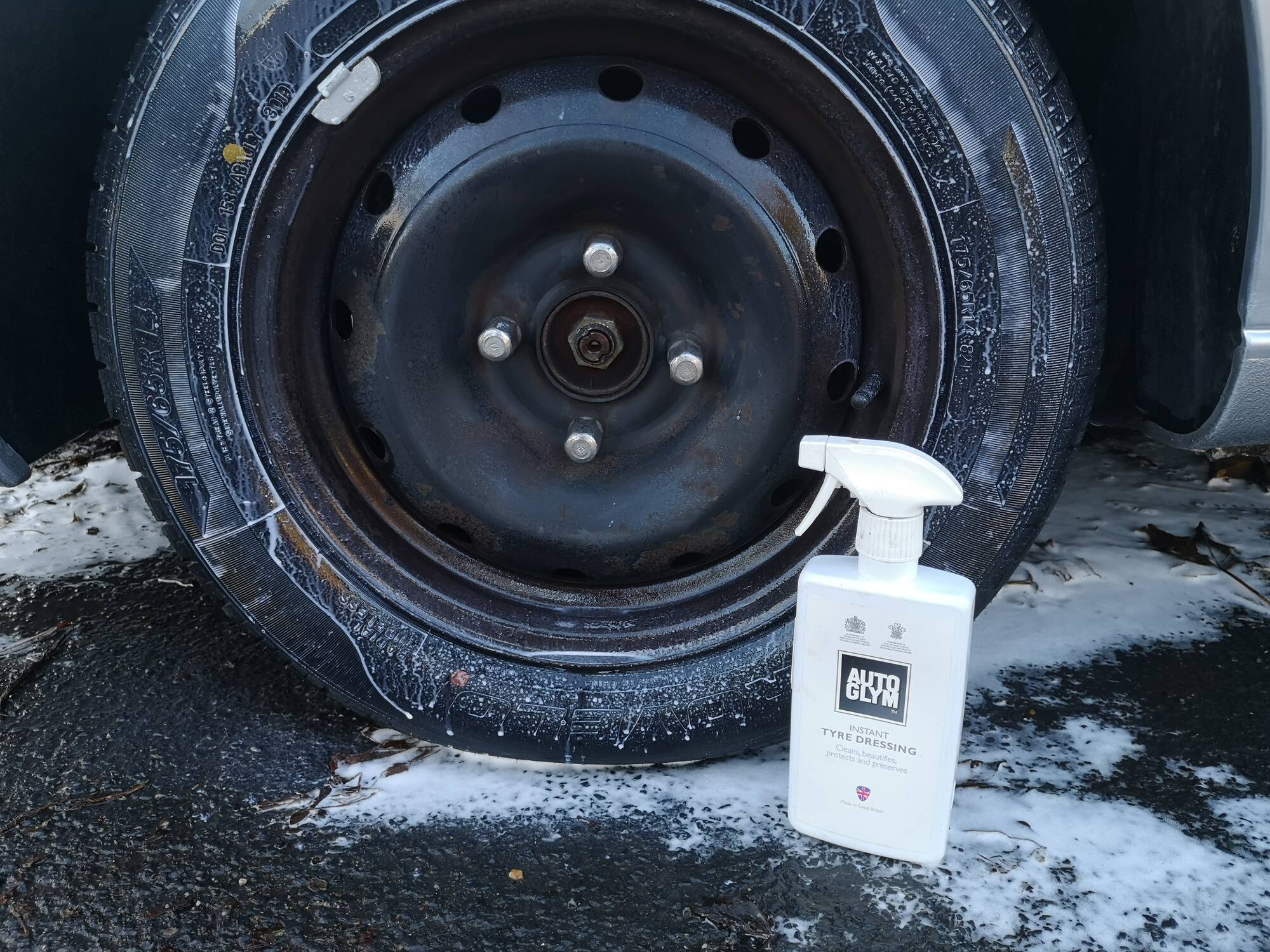

So I went around with some Black Hole and gave it a good light polish
Then applied dressing to the tyres

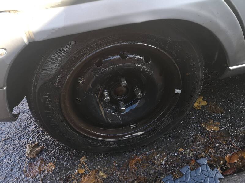

I put the spare wheel away and got the clamp done up just with the lowering thing from the 406 which sort of fitted... And noticed a side light out at the rear
Ah well. I packed up and went to the petrol station to even out the tyres, then to the chip shop, where all my shrapnel got me some cheps
