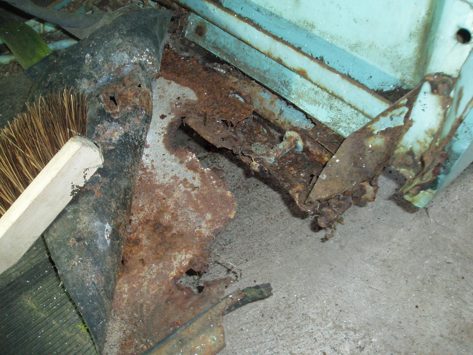

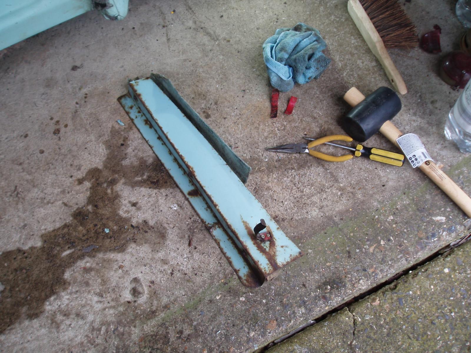

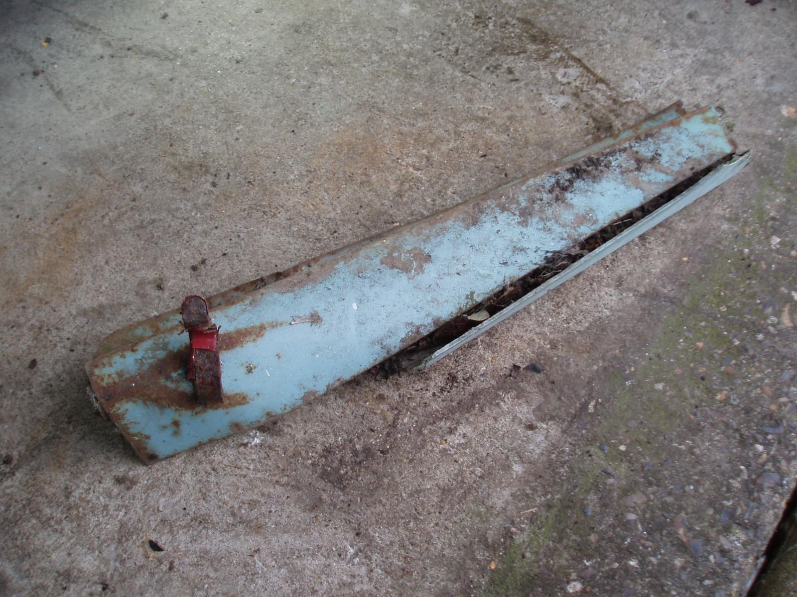

However, I haven't told you about this piece of metal, wood and fibreglass combined.

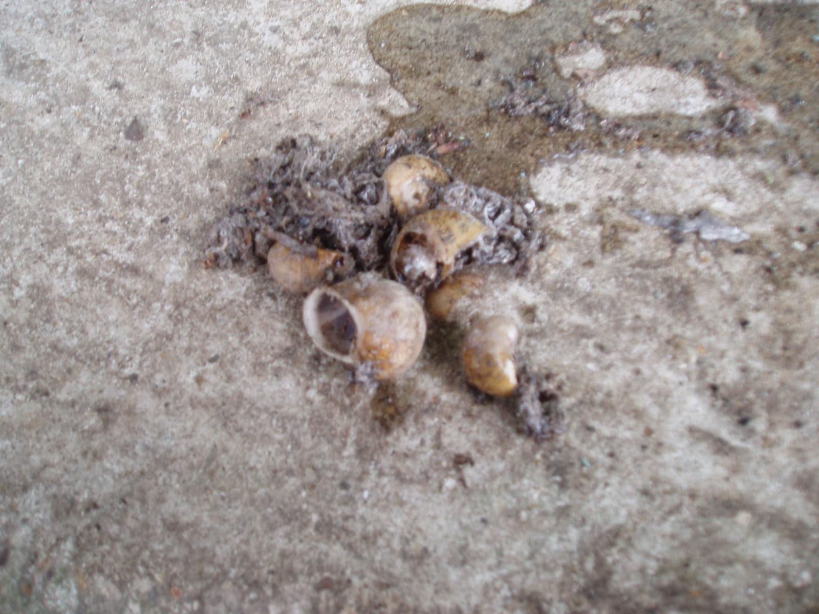

Full of snails.
I cleaned and straightened it out (mainly bending by hand!) as best I could.
Then. I balanced it where it came from.
Yes, it is part of the a-pillar! Bonus.

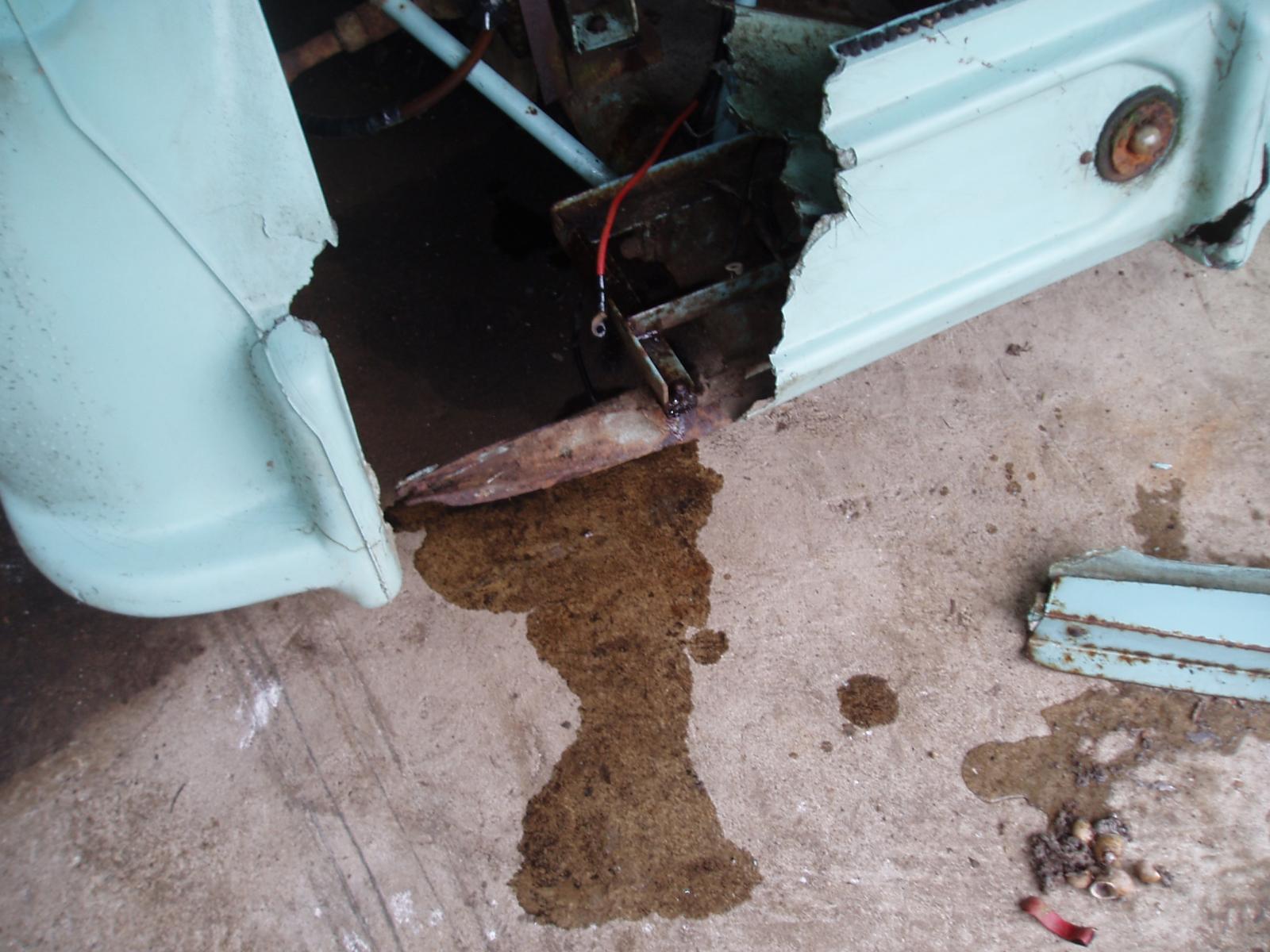

But, then I made the cardinal sin - NEVER lift the rubber mats on 60's British chod. That's structural.

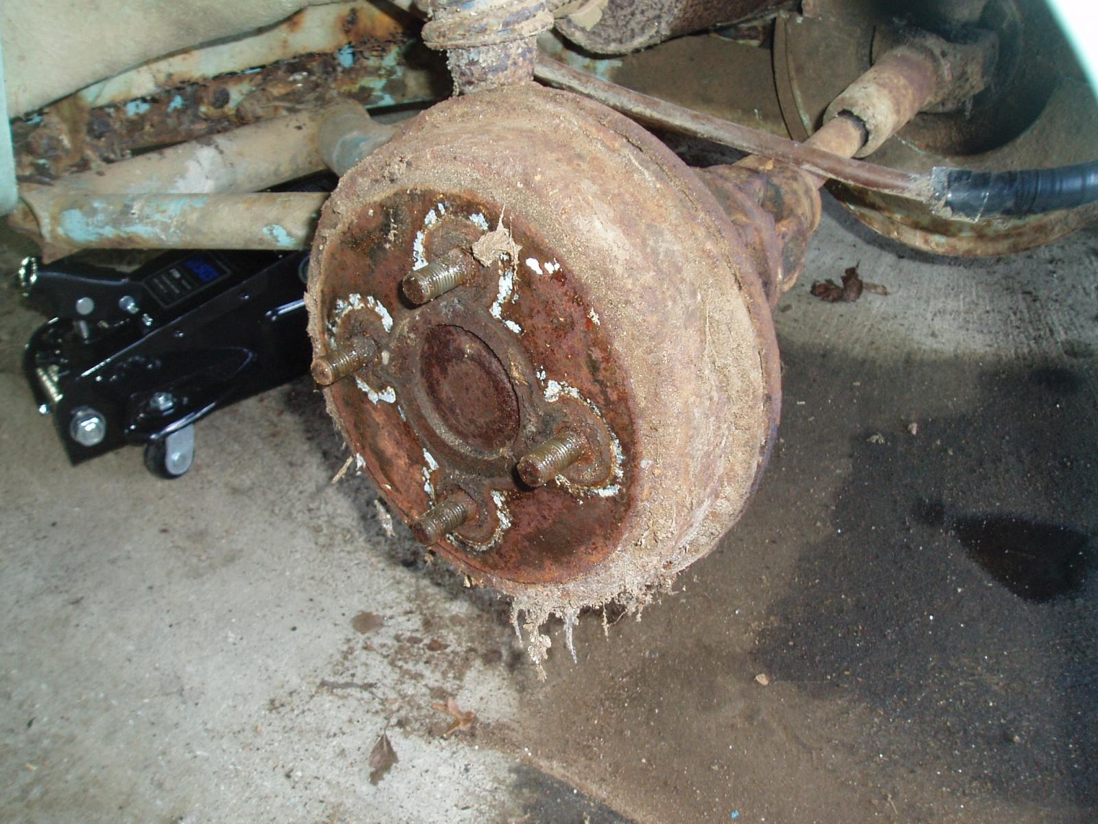

However, I could jack it up on the centre chassis beam - but....no way are my axle stands getting under without tipping the thing over. But, I did get the wheel off for a look and then put it back on again (useful).
(No it doesn't turn).

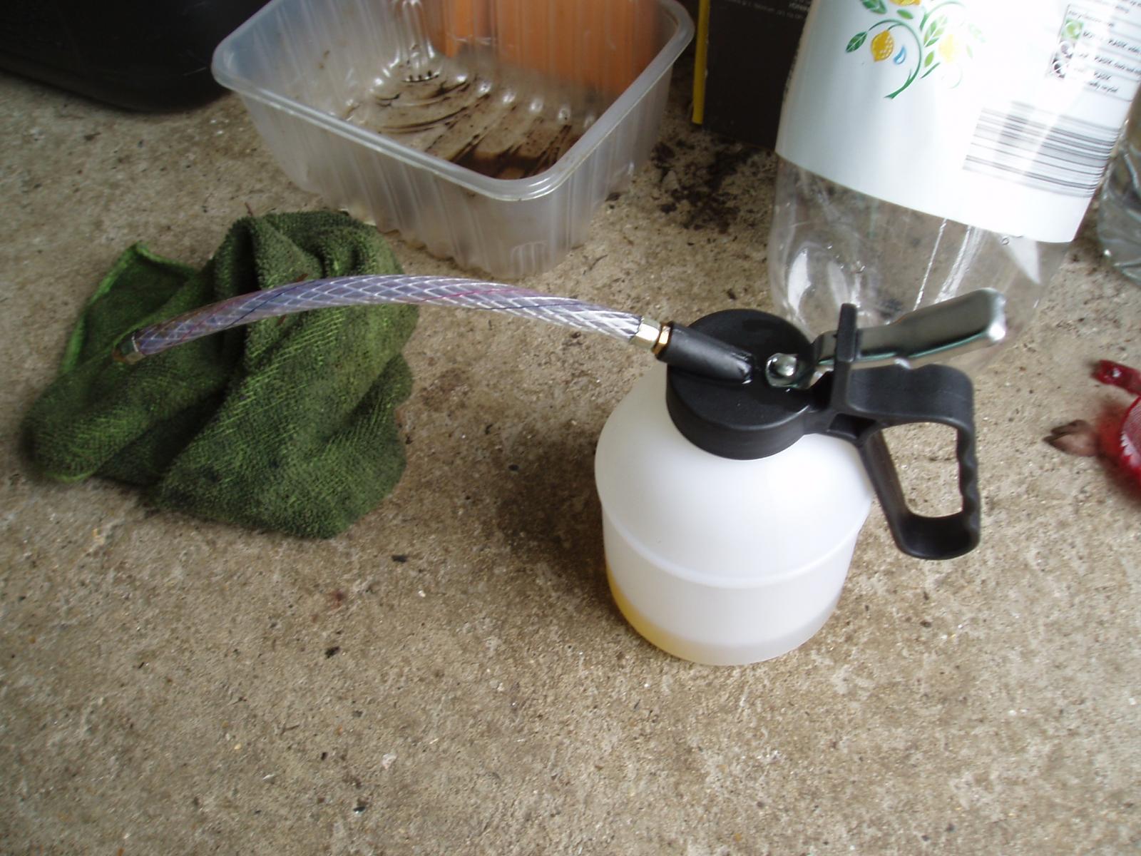

Then I stood and stared into space for 15 minutes. Then I came home (picking up a proper little oil can on the way - next time oil in cylinder :-0)

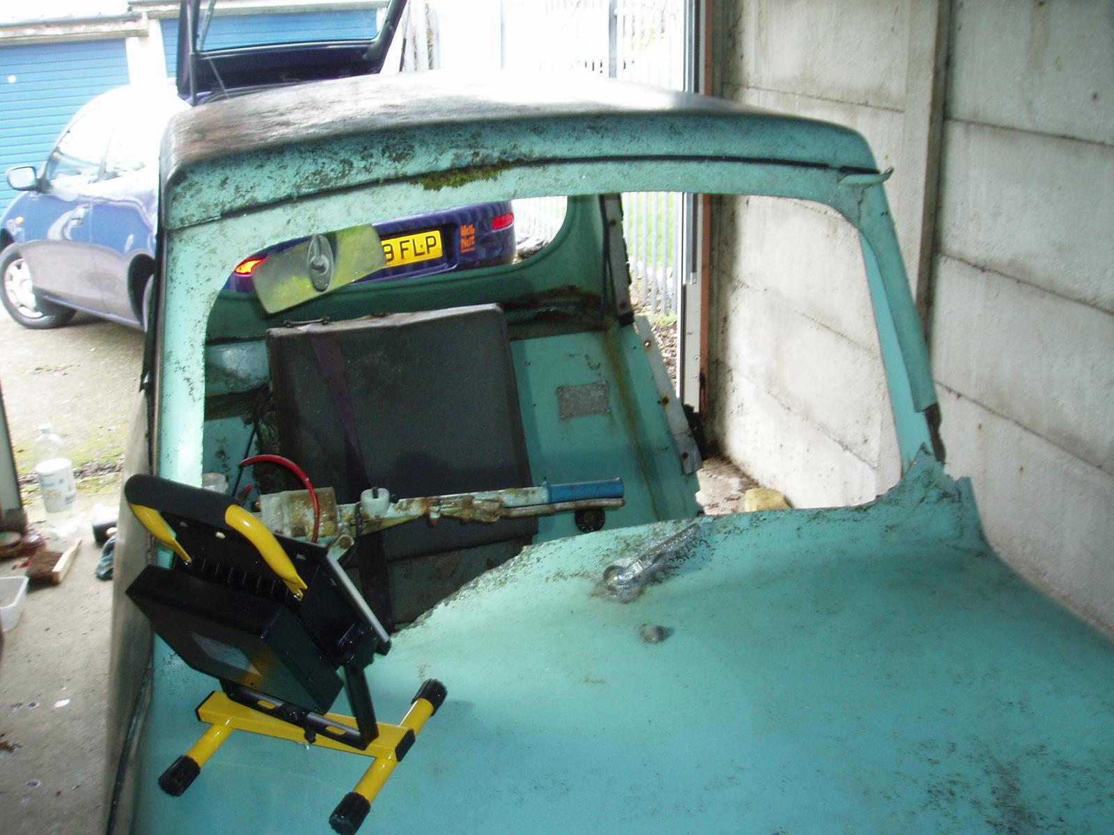

Might be easier to just saw the top off and install this ^
GR9 find on *structural roof **support :)

that A pillar bit should make repairing that section much easier now hopefully :)
easy fix on the pillar
something lighter like diesel or penatrant oil would better down the bore...oil is too thick
Not WD-40, either.
Plus Gas or Duck Oil (or similar).

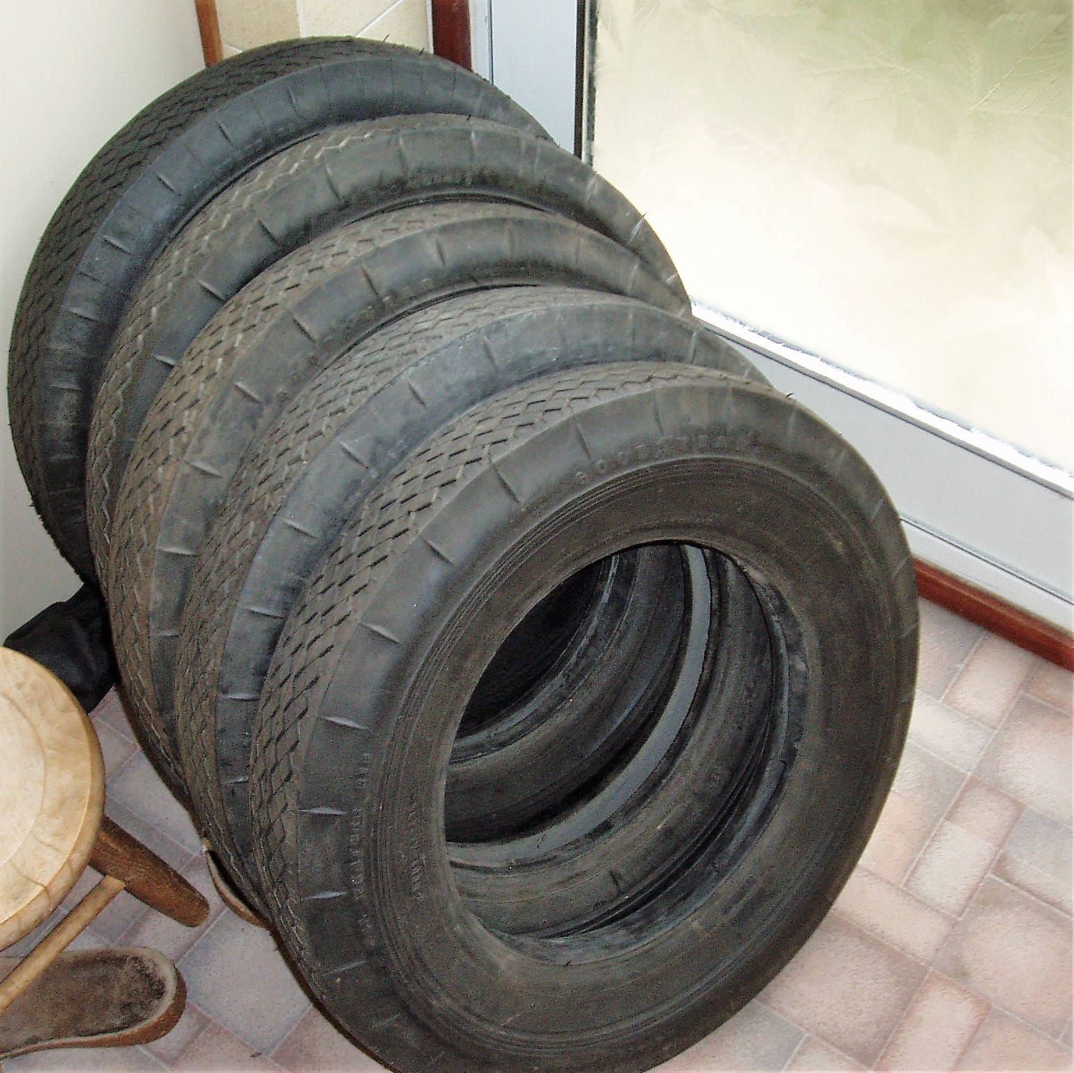

They are 5 new old stock Goodyear 4.40 R12 tyres made in England my good fellow. They also happen to be the exact tyre type currently on the vehicle. Remarkably good condition.

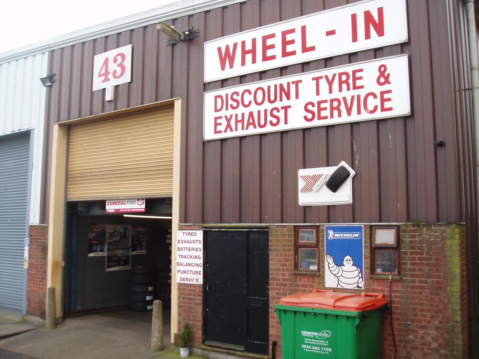

I took a wheel and tyre to my favourite local tyre place, who said 'you need inner tubes matey'. So they are getting them for me for Friday.
I put some diesel in the cylinder this time too...

nice find on the tires :)
are you sure they need inner tubes?, IIRC TWC has the same wheels as your Mk12 and DW got away without tubes, however he is using Michelin X tyres so not sure if that affects anything
I think DW might have some inner tubes kicking around however :) (I know he mentioned he ordered some, then in a later video said he didn't need them, but i dont know if he got them in, or if he just cancelled his order for them)
The tyres are a good find but despite their good condition be ready for poor grip if they are very old.  Tyre places always tell me that my Reliant's crossply tyres need tubes - something to do with the wheel profile.  The Owner's Handbook says 'tubeless 520x13.'  It probably makes little difference either way on a lightweight three wheeler that is not used every day, though many tubeless tyres have a quite coarse inner surface which can scuff through a tube surprisingly quickly on a heavier vehicle.
I hope the diesel and oil down the bore eventually releases the piston.  If it does, go gently so as to avoid breaking the rings, just in case the unit is salvageable.  Good progress so far.  Sod the logic of attacking 'important bits' first.  Sometimes you need to do jobs that CAN be done so that morale is boosted.
The tyres weren't horrendously expensive, and could be re sold I think. I got the five delivered for less than the purchase price of 2 new ones from Longstone tyres.
Agree about grip, but I'll not be driving this car like Zel or Wobbler, realistically it will need to tootle on the back road between Herne Bay and Whitstable, on warm, dry days. What a treat if I get that far.

The guy was insistent about inner tubes despite me having doubts, they're a good tyre place who I essentially trust, so went with it.

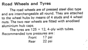

(I just realised, I have no idea what sort of tyre pressures a Mk12 asks for... closest I have is for the Model 70)

not sure what they mean by instruction manual in this case
I know the Model 70 has 2 manuals one that looks like it was given to the user, and just contains basic info
and then another whos front cover iv never seen, which seems to be some sort of service guide/shop manual that goes into great detail about a lot of things

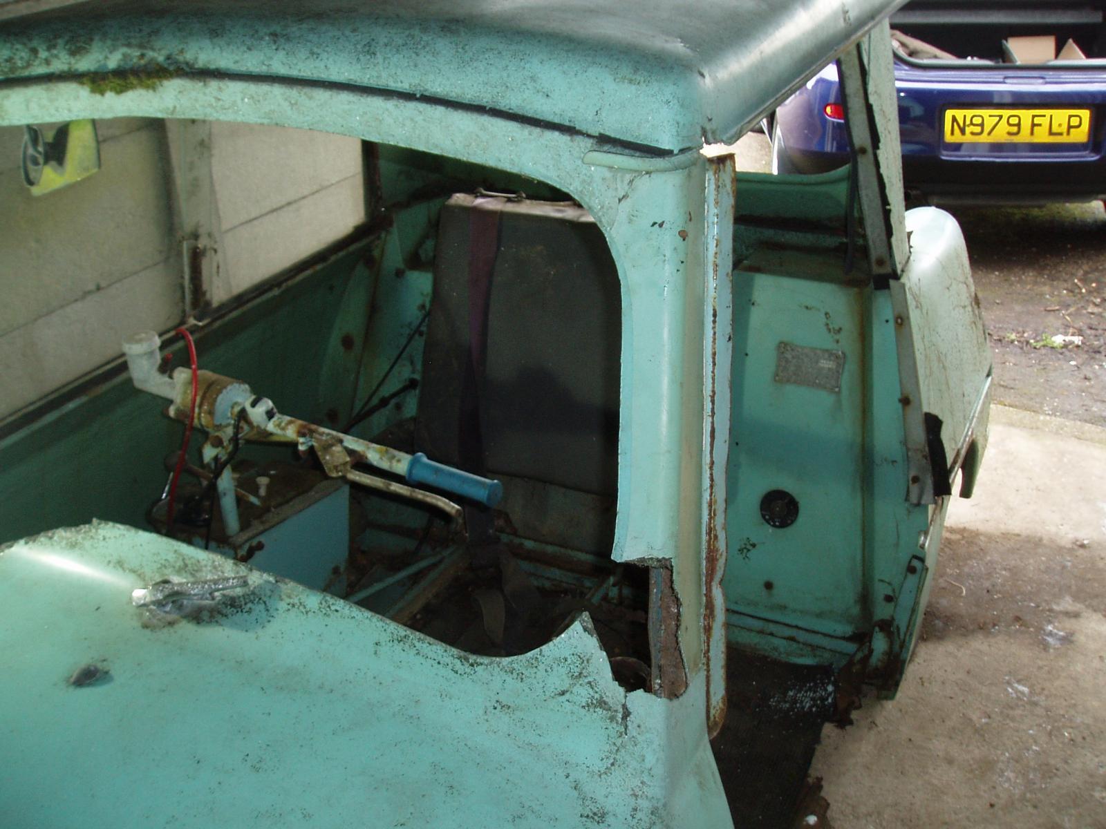

Just catching up on this - massive win on the A-pillar front, that must be a major relief.

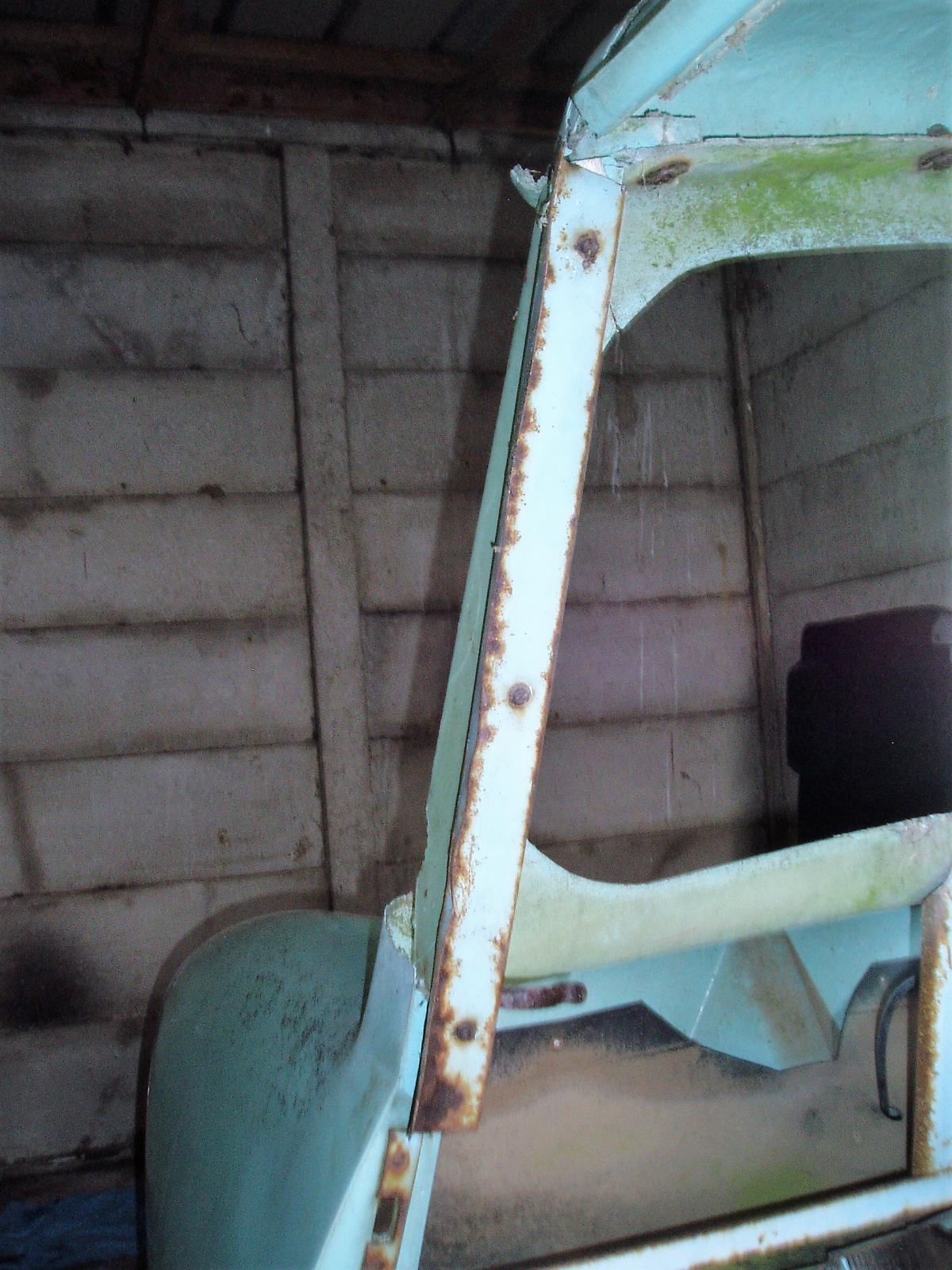

It's only balancing there for now, but does give some structure to build resin and fibreglass around. Getting the angle of the pillar right will be key to ensure the windscreen fits. Of course, the angle also will have an impact on any future door too.
