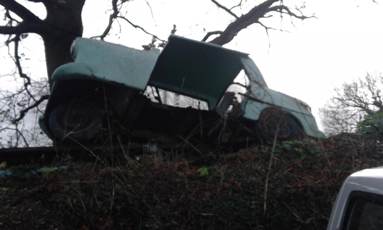

interesting :) I wonder if theres an alphabetical look up table somewhere?
What was it doing in a tree?
stunt double for a harry potter film?  :mrgreen:
trick image...actually more like this...
By the time you've read my book , you'll be fibreglassing the floor and making the first amphibious invacar sailed in Herne Bay ..its posted
