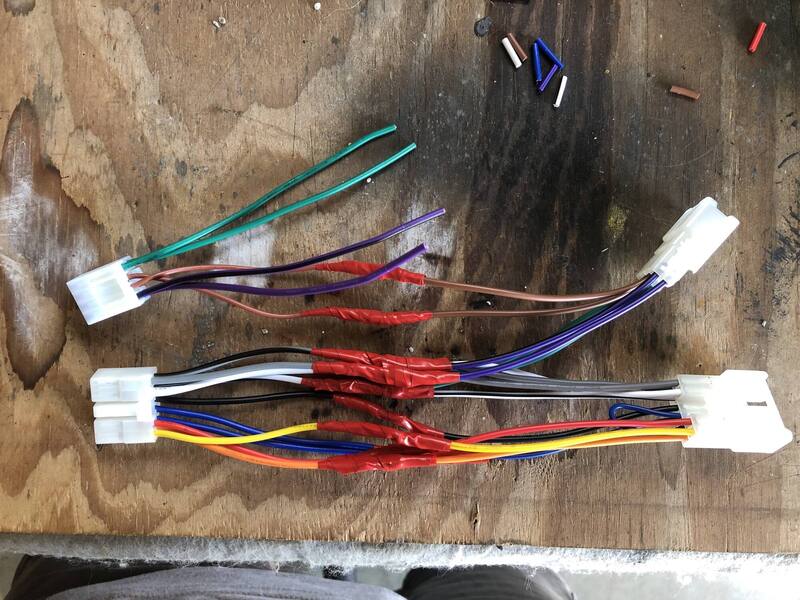

A package has arrived from that there China containing some electrical goodies.
I sense some bodgery in my future.
how can it be classed as bodgery with proper white plastic ends- that's factory that is ?

Electrical bodgery has now taken place.
Note the burn marks due to cack-handed soldering.
Can you guess what it is yet? Answers on a postcard.

some sort of radio loom adapter thing? :)
It’s time to spill the beans, it is a radio loom adapter, but it is for connecting rear speakers to a front speaker only head unit. I have been searching high and low for a Toyota single din cassette stereo that doesn’t require a security code and is compatible with rear speakers, but they are very scarce, so this is the solution I have gone with.
To begin, my favourite* automotive job, dashboard dismantling.
The adapter cable worked a treat and I was able to track down some trim rattles to silence.
The other job was to install some new rear speakers, I’ll spare you the details as it involved some less than ideal methods of fitment utilising a hammer and an engineer’s chisel but the outcome looks smart.
To cut a long story short, they work and they work well (and I hate taking interiors apart).

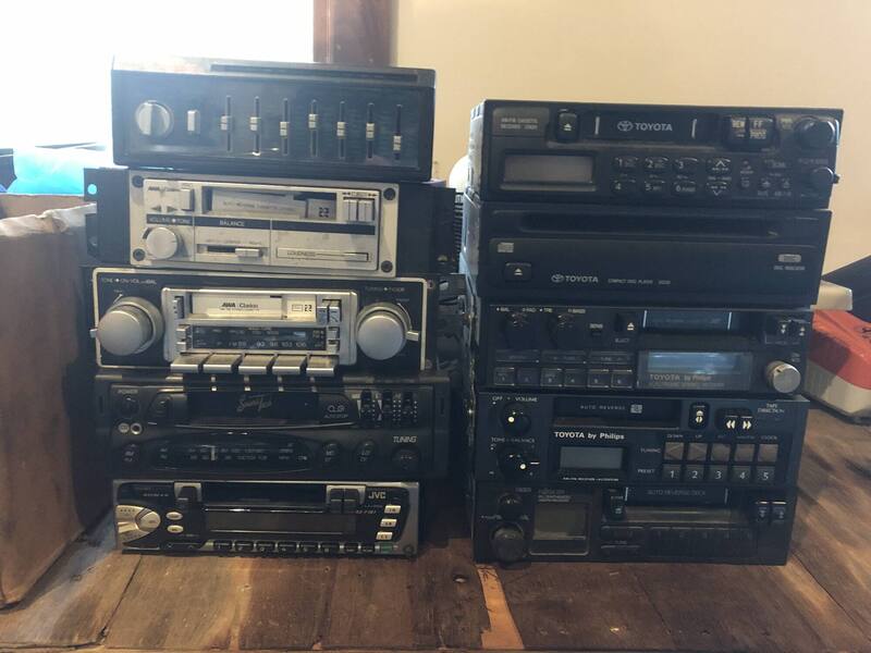

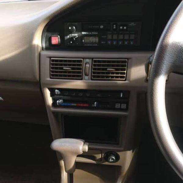

Regular viewers will recall my hunt for the ideal stereo for the Corolla, it resulted in a radio/cassette that needed an adapter lead for the rear speakers.
But, there has been a new development.
Cast your eyes to the top of the right stack, there we have a late 90s radio/cassette with rear speaker capability and the rare optional external CD player.
The only issue is that I now have to find a home for the CD player.

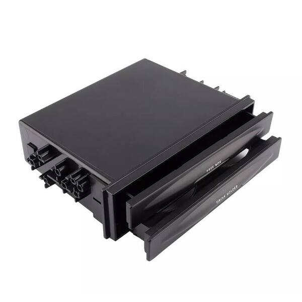

Ideally the radio/cassette would go in the same place and the CD player would go in the double din pocket along with a single din pocket, but the cable is not long enough. Plan B is to put both units in the double din area and a pocket in the old radio position, but this means the controls and display would be difficult to see, including the clock.
I think the best route would be to lengthen the cables, but the lazy option would be far easier. Decisions, decisions. Either way, the remaining din hole will receive one of these cup holder units to add some much needed drinks storage.

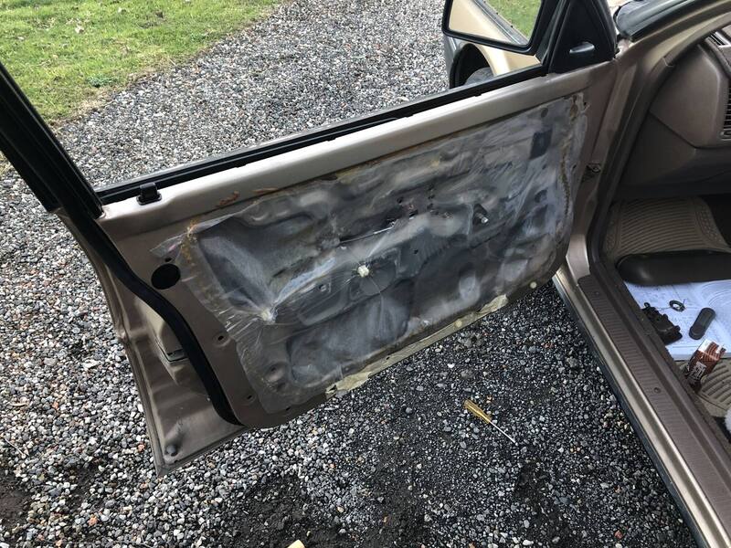

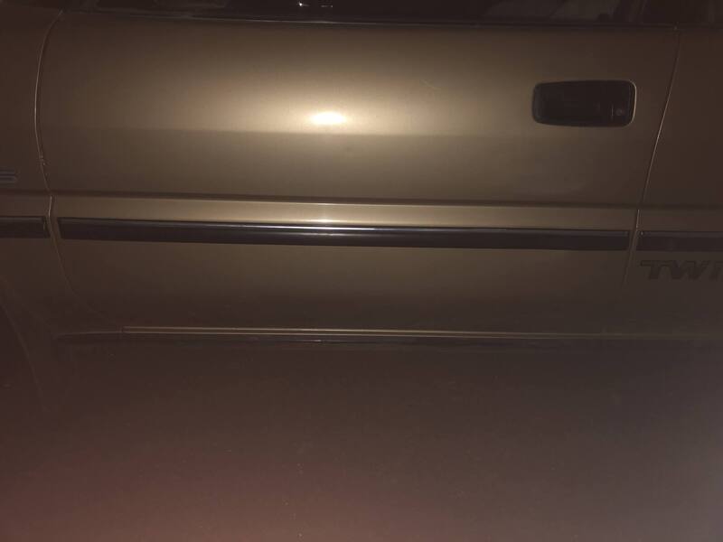

As per my previous post, I’ve been attempting to remove a dent in the passenger door.
After the rubber bump strip fell off (That’s 3 out of 4 doors to have this happen) the existing dent became very obvious. So firstly, the window winder needed to come off, which is quite the fiddle and necessitated the fabrication of a specialty tool.
The winder is held in place with a (very strong) wire clip behind the trim ring that need to be extracted. With this done the armrest and door handle could be removed and the door card unclipped.
This is when the crowbar was introduced. By placing it between the door skin and the big safety girder, that I was pleasantly surprised to find, the dent could be teased out. As you have probably guessed, this was not the neatest solution, but the “imperfections” would be hidden by the bump strip so I continued.

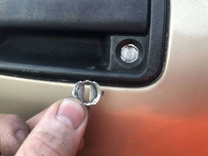

Whilst in the door, I found this little piece of history.
It appears that someone has knocked in the lock and illegally gained access to relive the previous owner of their belongings. The replacement lock is keyed alike so it has been repaired properly.
Back on topic, with the dent improved the door card was put back and the bump strip stuck on, obscuring the worst of my repair. The end result was deemed a success.
(Pardon my appalling photography, it was late in the evening.)
It should be noted that after I mastered the art of removing the window winders I repositioned the rest so they all are at 2 o’clock when the window is full up. Yes, that’s how sad I am.
I find that if the window winders are held by OE clip it's really easy to remove. I've done it with metal ruler. But if it's an item that came with aftermarket window winders it's damn near impossible, I once had to drilled the winder out. This is because original equipment have little prong that sticks out of the door card while the aftermarket item doesn't.
This is the clip in question, the handles are not aftermarket (to the best of my knowledge).
(Stock image from the internet, my handles are brown and made of unobtanium, muck like the rest of the interior trim.)
The tricky bit was getting to the clip as there was no gap between the handle and door card, only a couple millimetres to play with.
