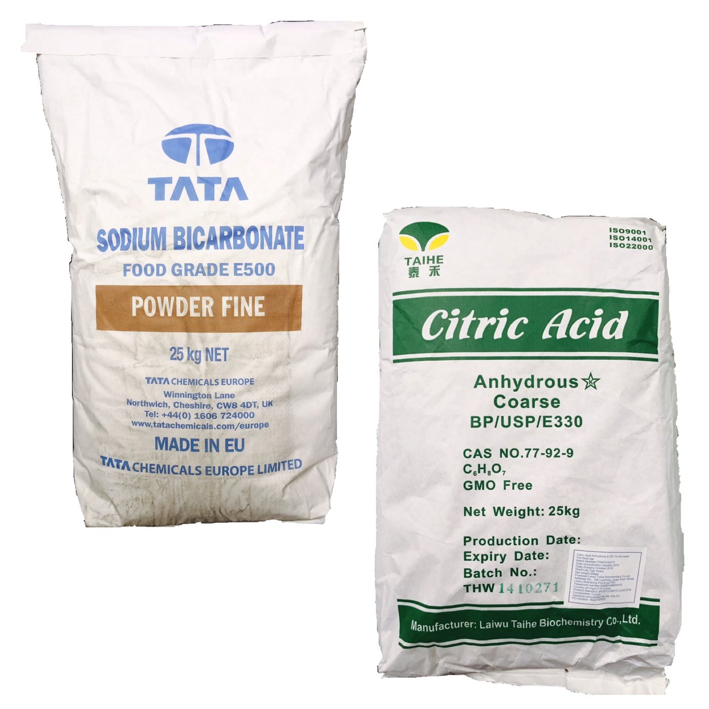

Matty Posted May 18, 2019 Posted May 18, 2019 On 2/1/2019 at 8:14 PM, Eddie Honda said: Just buy a sack of citric acid powder and a sack of sodium bicarbonate. Thousands of cleaning uses round the home (and garage). 10% citric acid mix for descaling. 5% sodium bicarbonate degreasing. ( https://cdn2.ms-motorservice.com/fileadmin/media/MAM/PDF_Assets/Cleaning-of-Engine-Cooling-System_51423.pdf ) hexchemonline.co.uk (or their Amazon / Ebay shops) (I must get some in sometime. I'm still working my way through 20L of Isopropyl alcohol) (small quantities are available) Fyi one of the places I do mechanical work for is this Tata chemicals plant in Cheshire. WHAT a shithole. All the gantry's and walkways are rotten cos it's permenantly damp which reacts with all the chemic floating in the air! So plus one with sorting cooling systems out!! Eddie Honda 1
