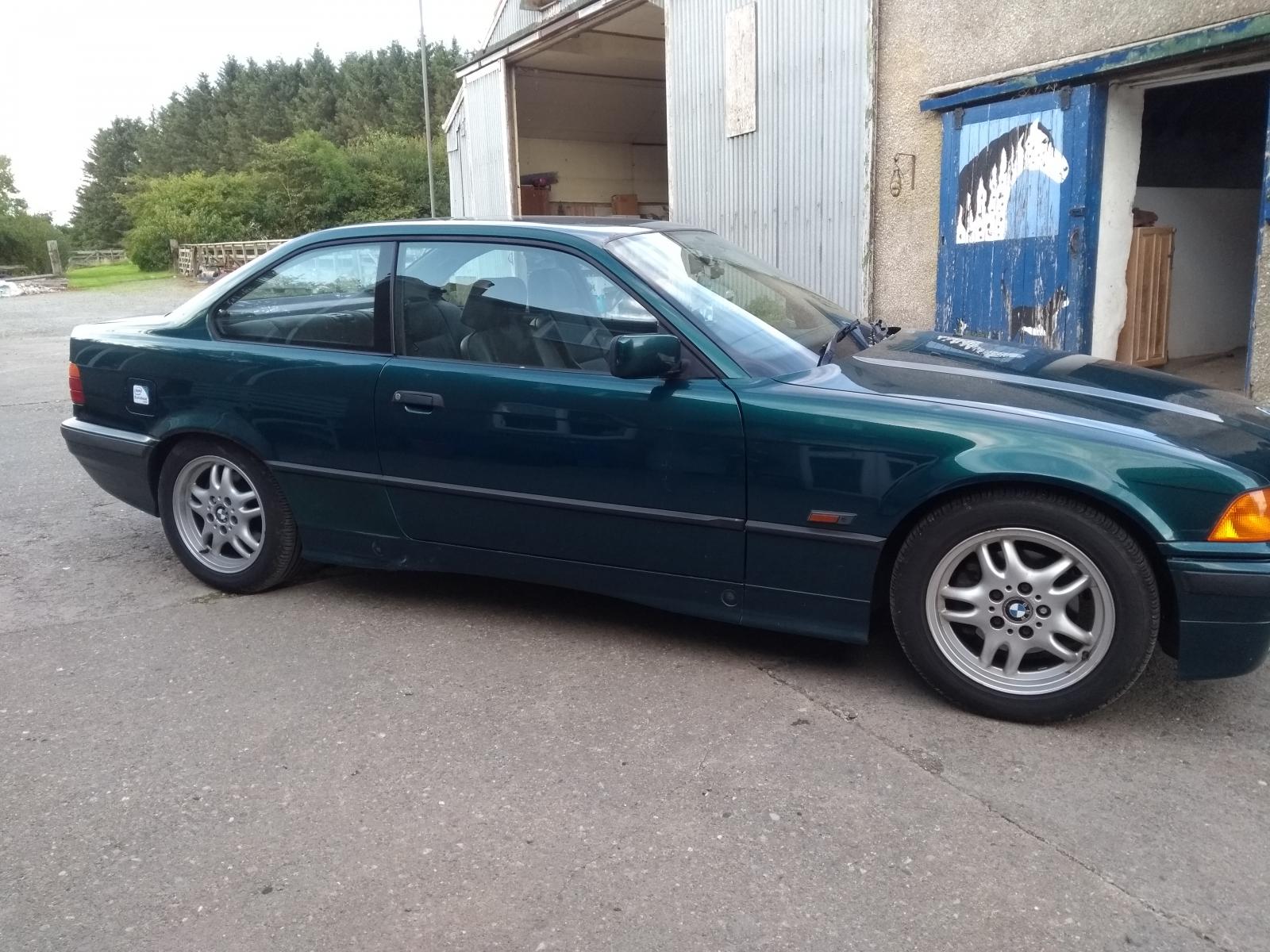

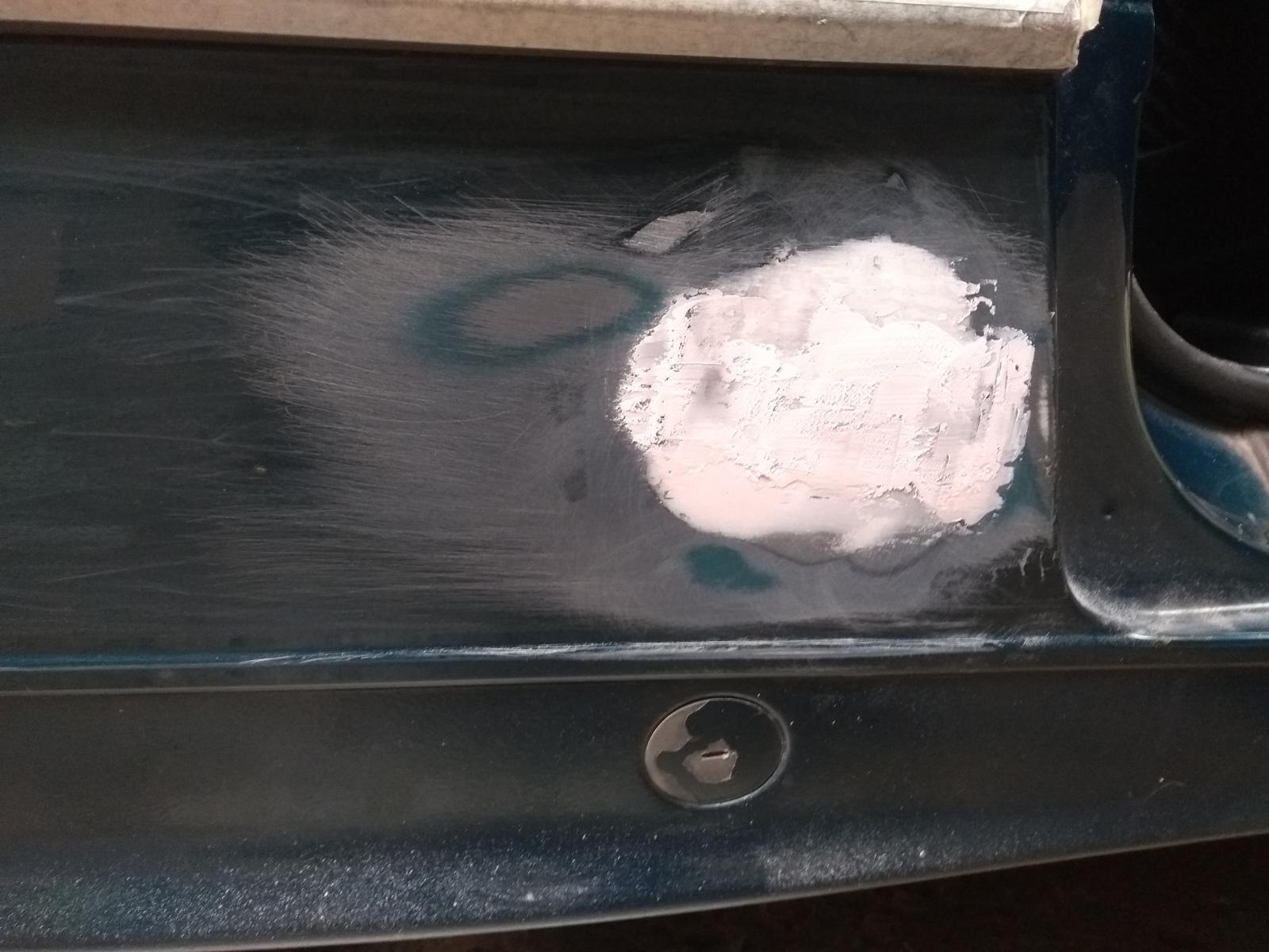

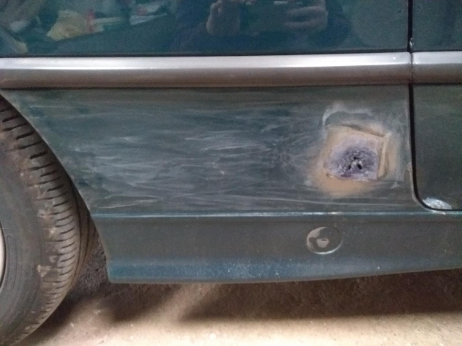

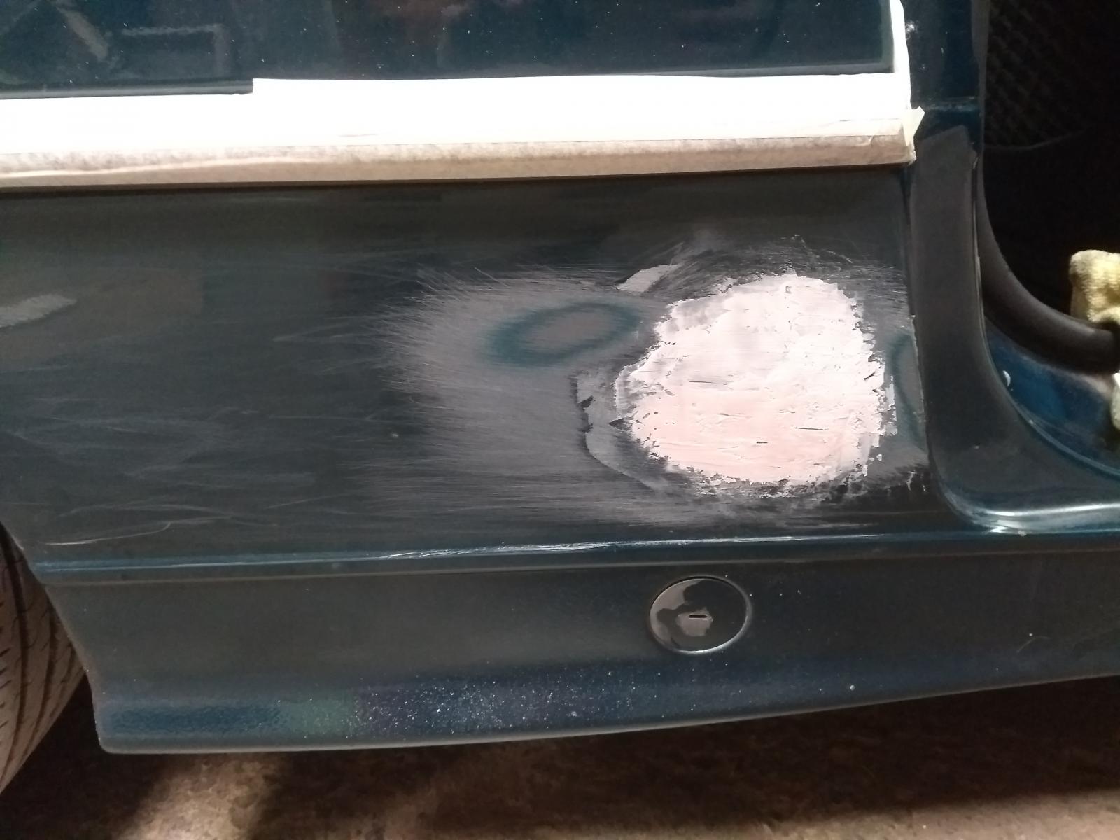

From the thread linked to in my signature, about my 320i.

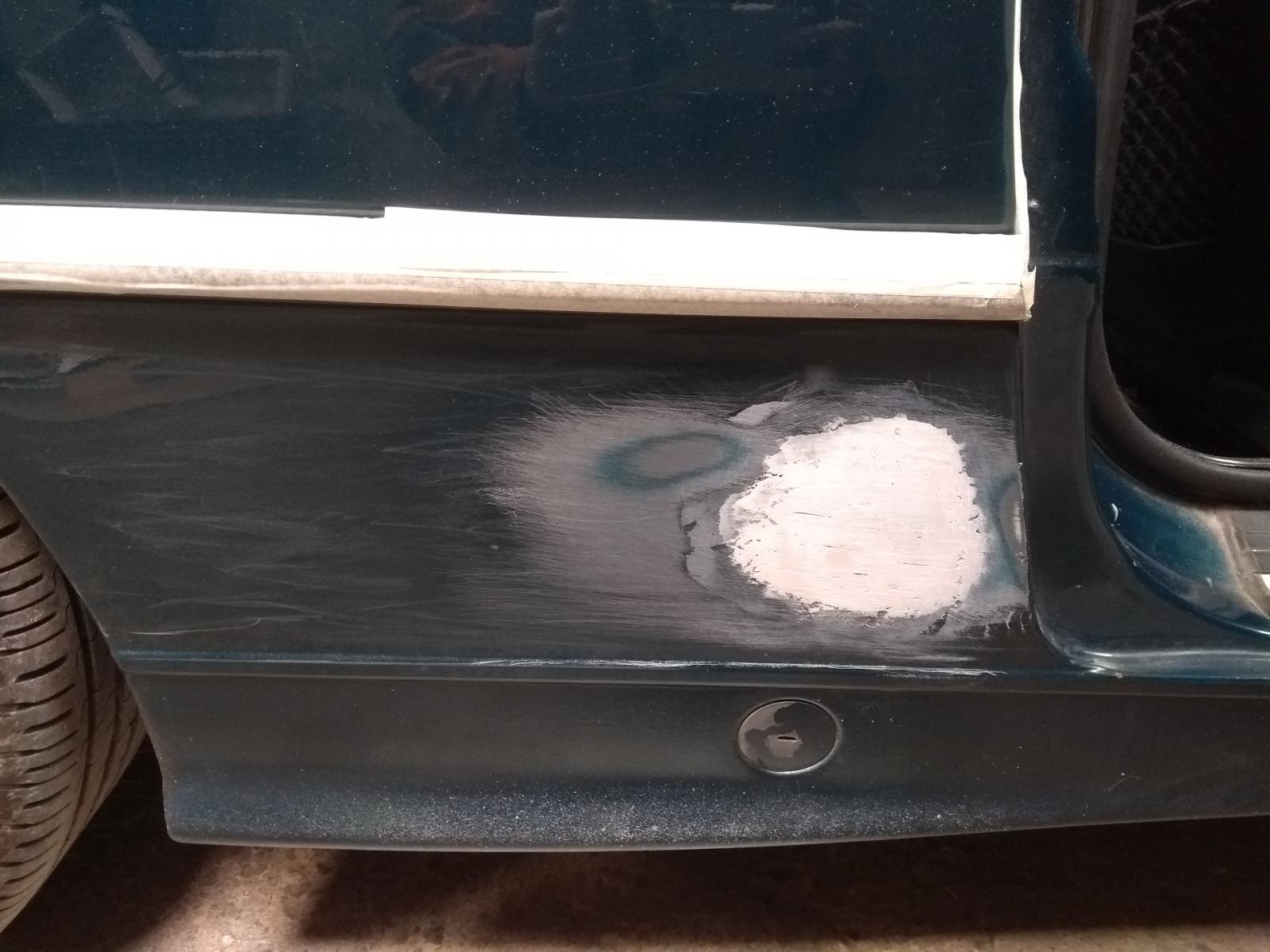

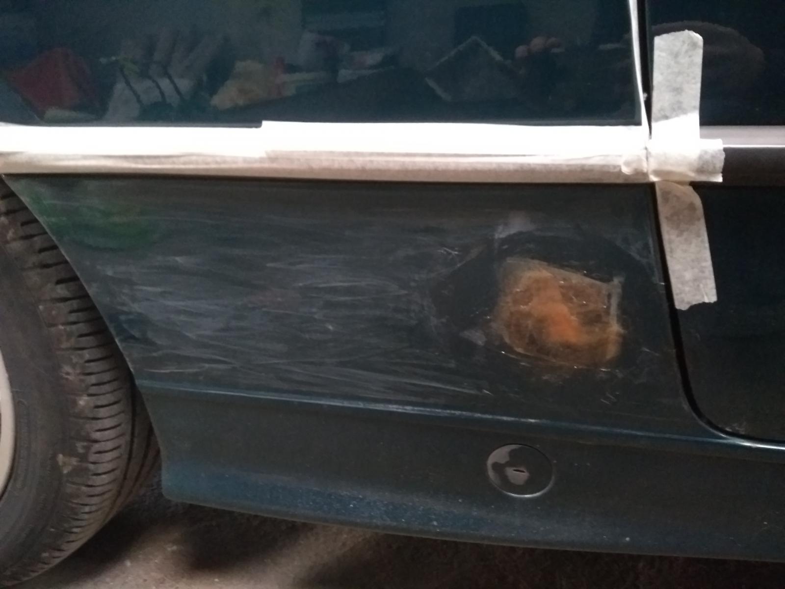

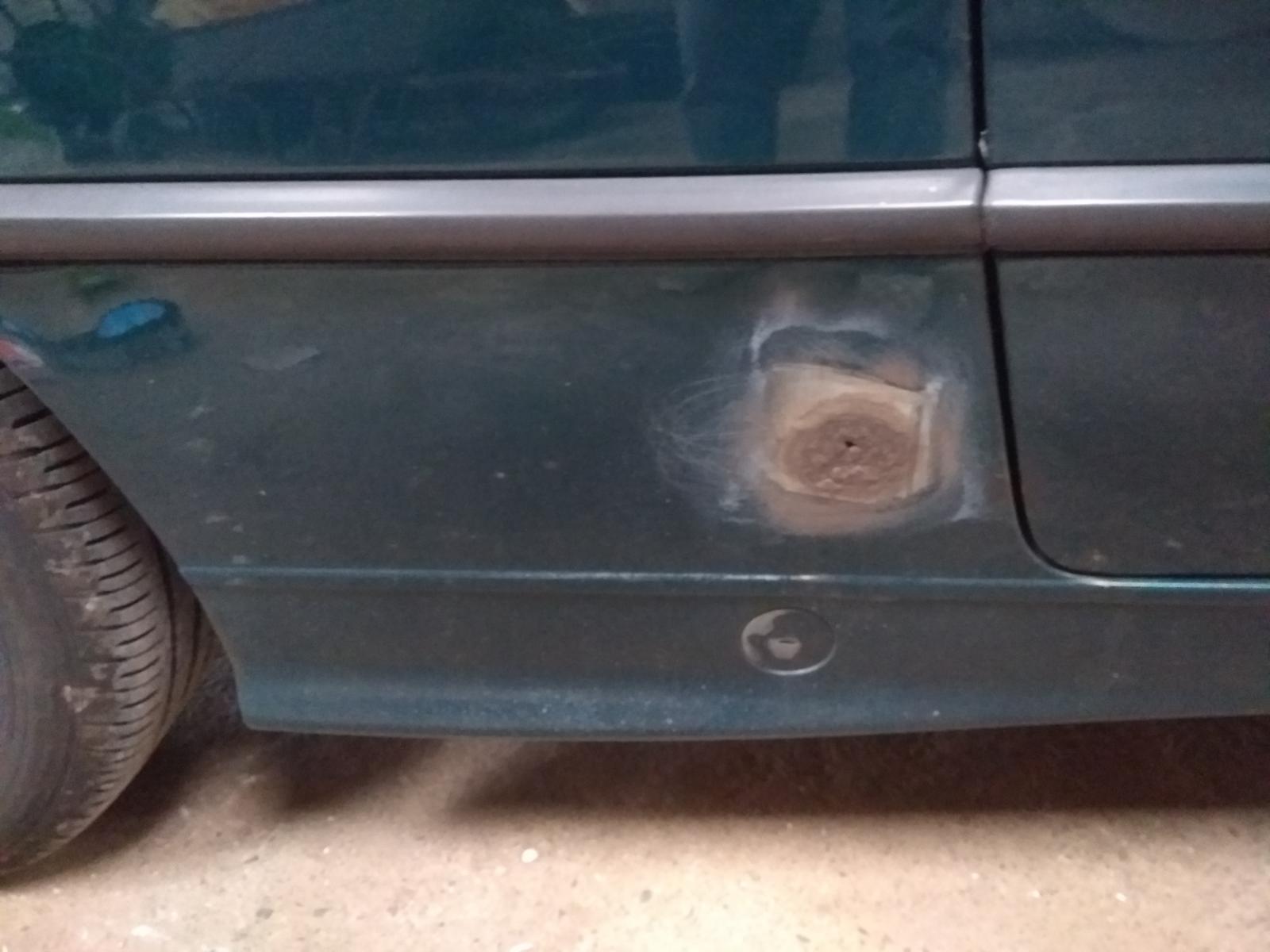

I repaired a weird rusty blister thing just behind the driver's door on it a couple of months back.
I started by sanding it, and applying some Kurust.

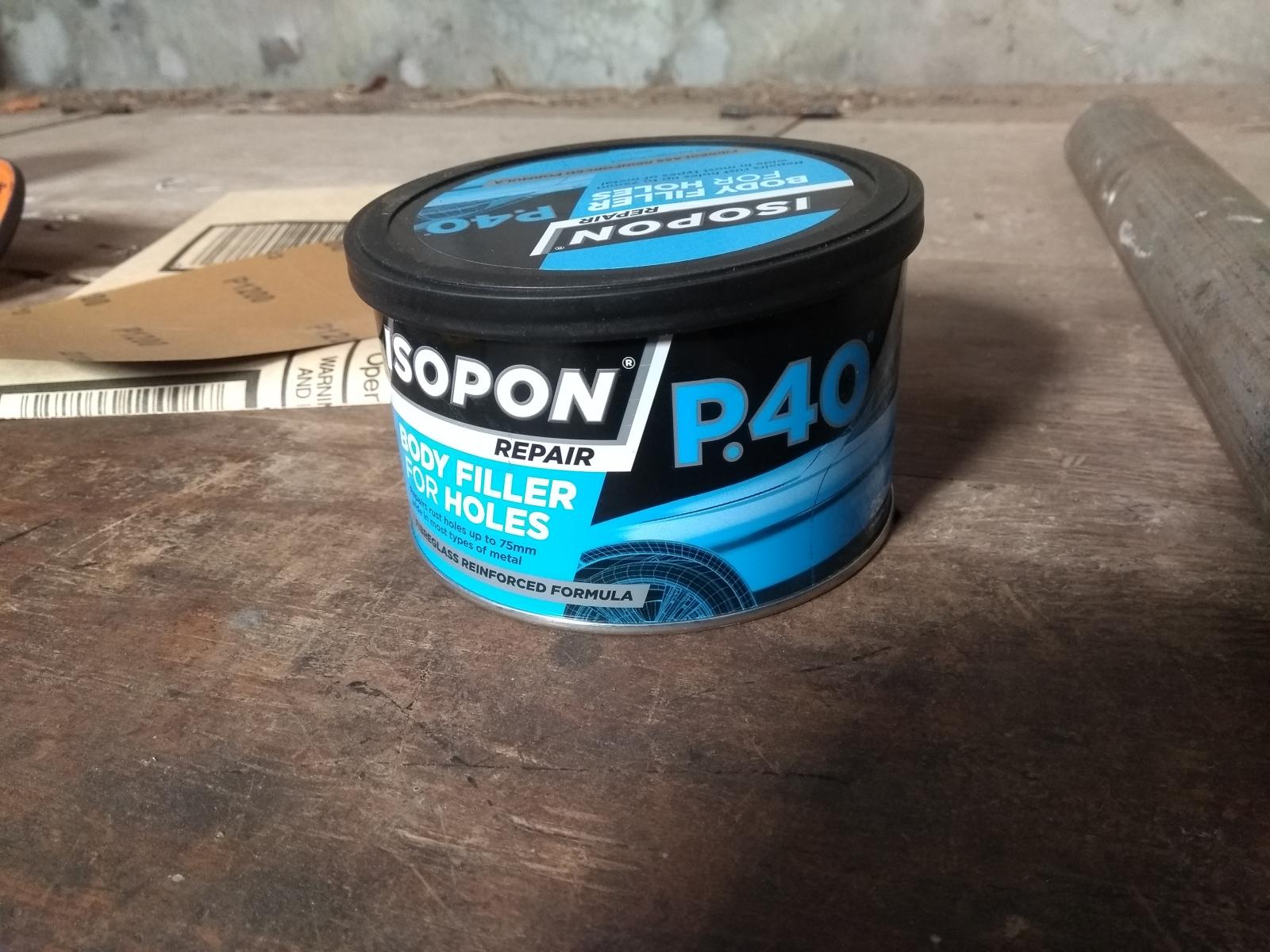

I then applied some filler.
I sanded the filler, then applied some knifing putty.
Lots of applying knifing putty, waiting for it to harden, then sanding it smooth. You want to be so smooth you can run your finger over it without feeling any imperfections at all.

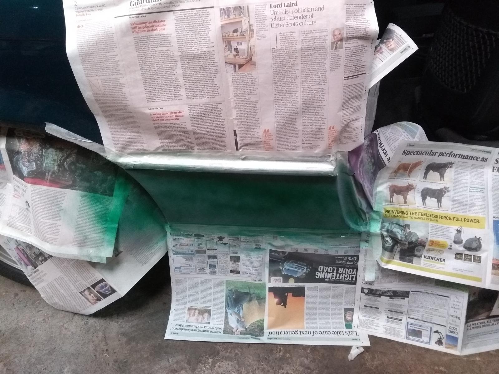

Eventually, I got it to a pretty smooth state then decided to paint. Luckily the area where the blistering happened was nicely sectioned off by the door, the trim piece above, and the wheel arch, so I was able to paint the whole area without needing to blend / colour match.
The usual procedure applied. A couple of coats of primer, sand them with a nice high grade of sandpaper, then apply colour, sanding with a high grade of sandpaper between each coat. Then once the last coat of colour is on, don't sand that one (obviously) then a few coats of lacquer.
The finished article.
During painting, I used some generic Halfords dark green as a base coat between primer and Boston Green, going by some advice from here. It didn't work too well and the Halfords green still showed through. I ended up sanding it back a bit and applying even more coats of Boston Green about a week later, which sorted it out properly.
I will admit, it's not a perfect finish. If you look really closely at that bit of the car now, you can tell it doesn't quite have the same quality of reflections on it as the rest of the car. It's a very good colour match though, and being that it's so low down and I hardly wash the car, you can't tell. :D
