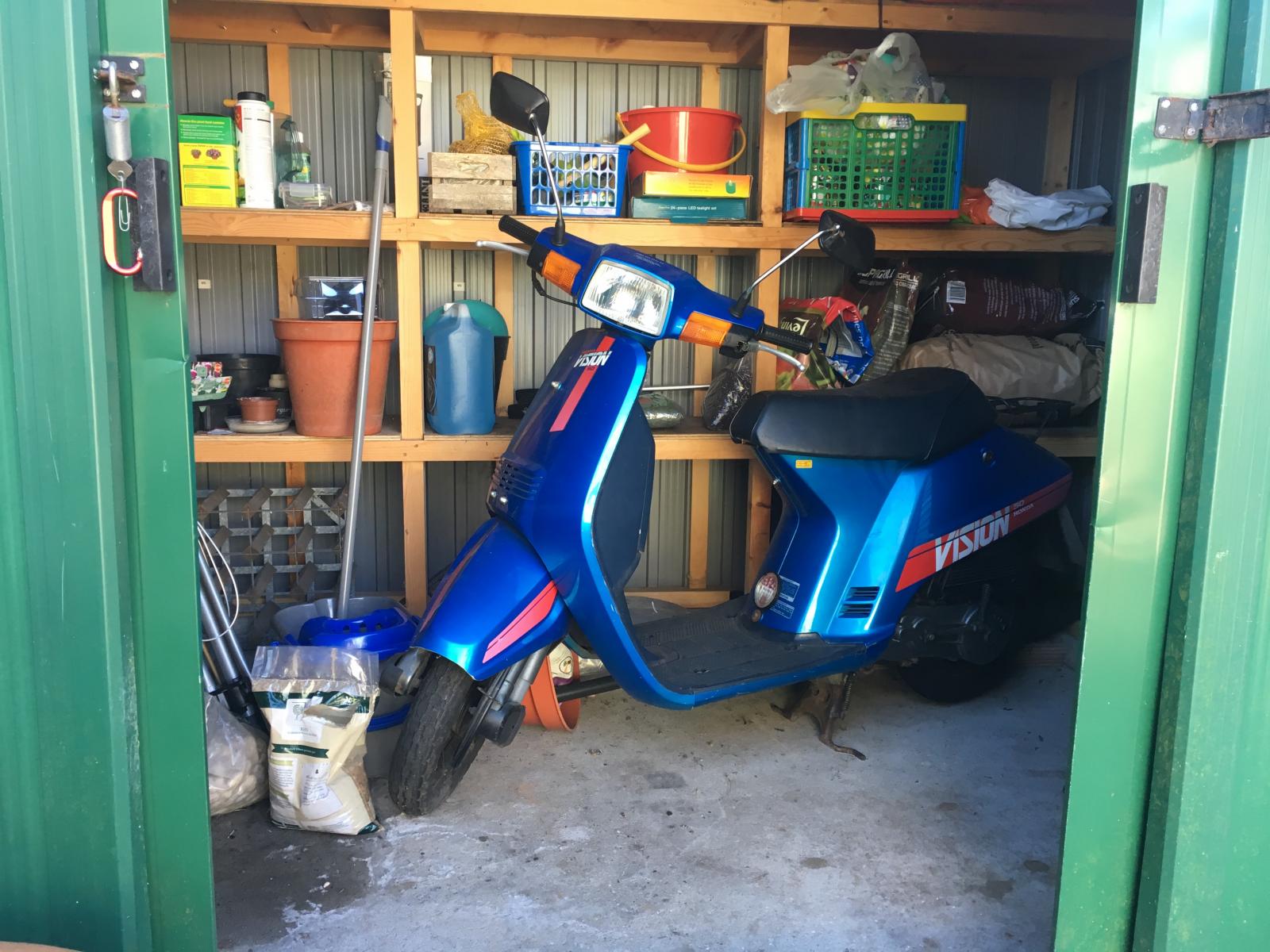

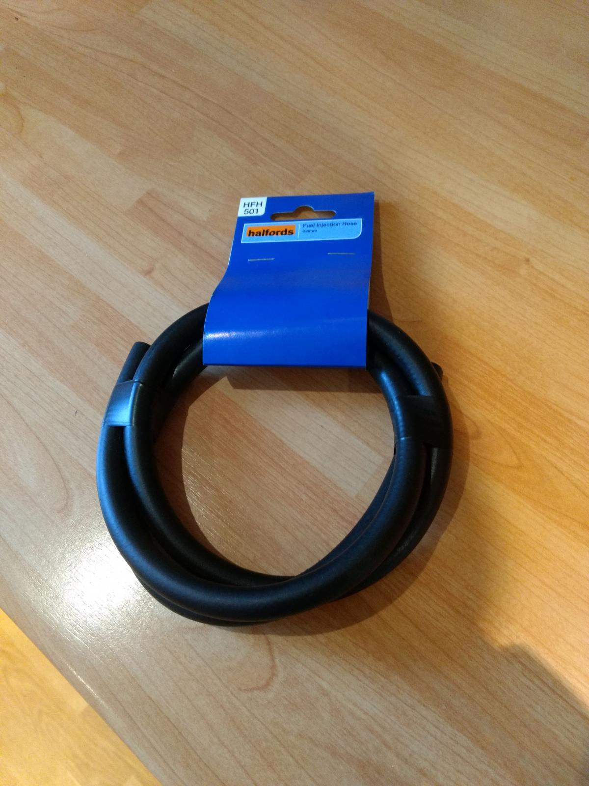

Sadly, I hadn’t even got out of the garden before a split and perished fuel hose stopped play.
With no local garage to call upon, and with SMH needing to get back to work, I’ve had to hang my head and admit defeat before the journey even started.. time to make use of that return train ticket I bought just in case..
SAD FACE. But on the plus side, at least I didn’t die.
Yes, I am more than a little embarrassed. It started and ran fine, we did paperwork, then started it up for FG to leave and this happened.

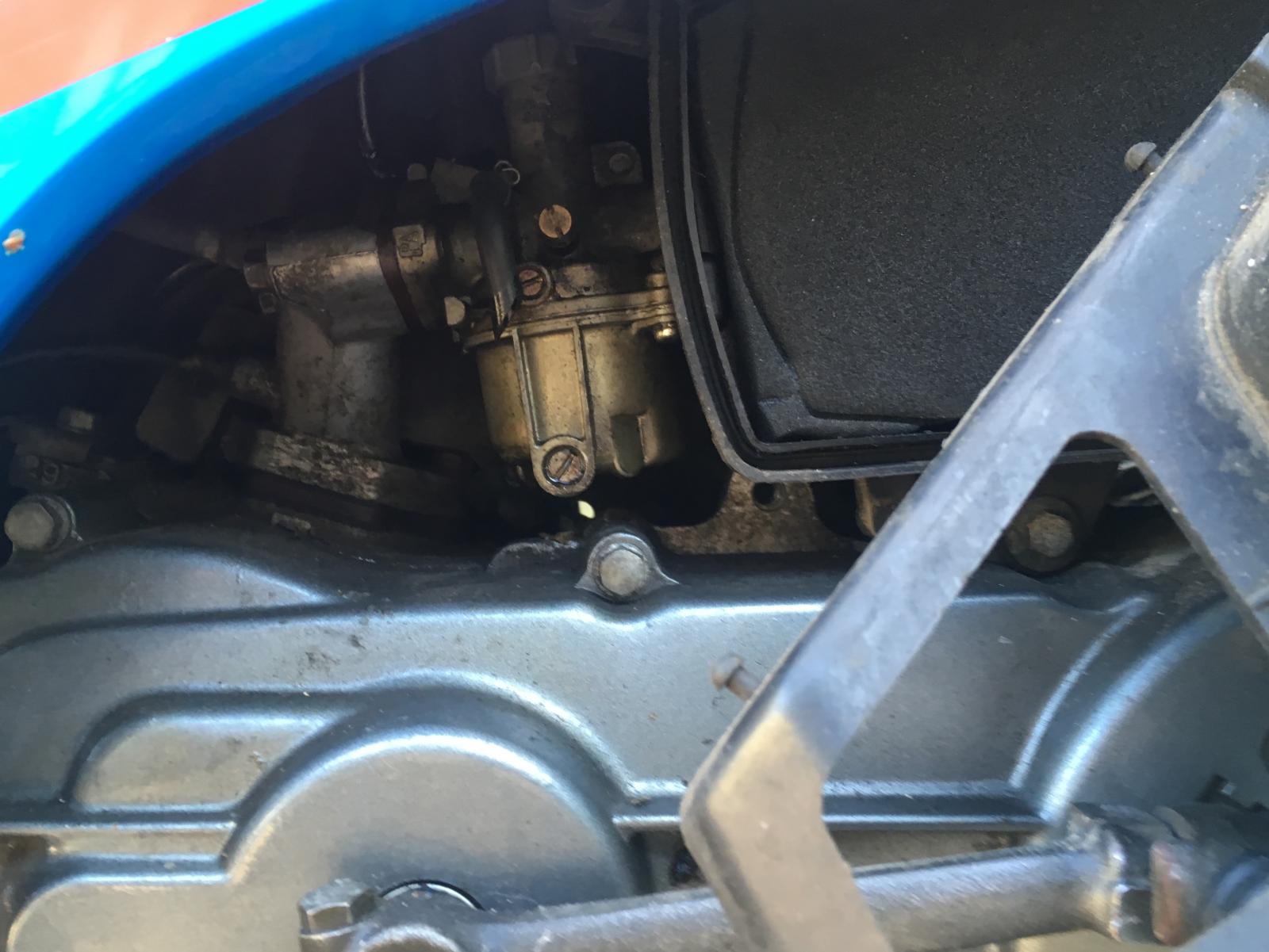

Like I said, I was more than a little embarrassed by this - although I think my garage can take some of the blame.
It sprung a fuel leak just before the MoT and because this was just before we'd moved into the house and I didn't fancy mucking about with petrol on the pavement outside our flat, I just let the garage sort it out.  So there's a short length of fuel line between the fuel tank and the carb, with an inline fuel filter fitted.  The garage had replaced the section of hose which split before but left the other bit alone - and of course it failed literally 10 miles later.
I had some free time today so went Halfords shopping.
Literally fifteen minutes of work, including finding my tools and figuring out how to bolt the body back on (FG had undone it) we have this.
I took it for a little spin around the town, filled the tank with fresh petrol and the tyres with air (they were low, so keep an eye on that) and unless there's another disaster it is ready for Take Two.
https://youtu.be/rhBlUFE0kiE

It's a happy little off-beat noise, isn't it?  It could only be an air-cooled 2-stroke.
It's not powerful but it is really willing - it really flies up to its 35mph top speed.  Reminds me of my first Citroën GS.

Not a problem, I felt really bad about you wasting your journey.  If you'd bought it off AutoTrader you'd have been really pissed off but I think shiters understand each other pretty well!  It's cost me approximately £7 and half an hour to prep it properly so it really is the least I can do to make up for your train ticket.
