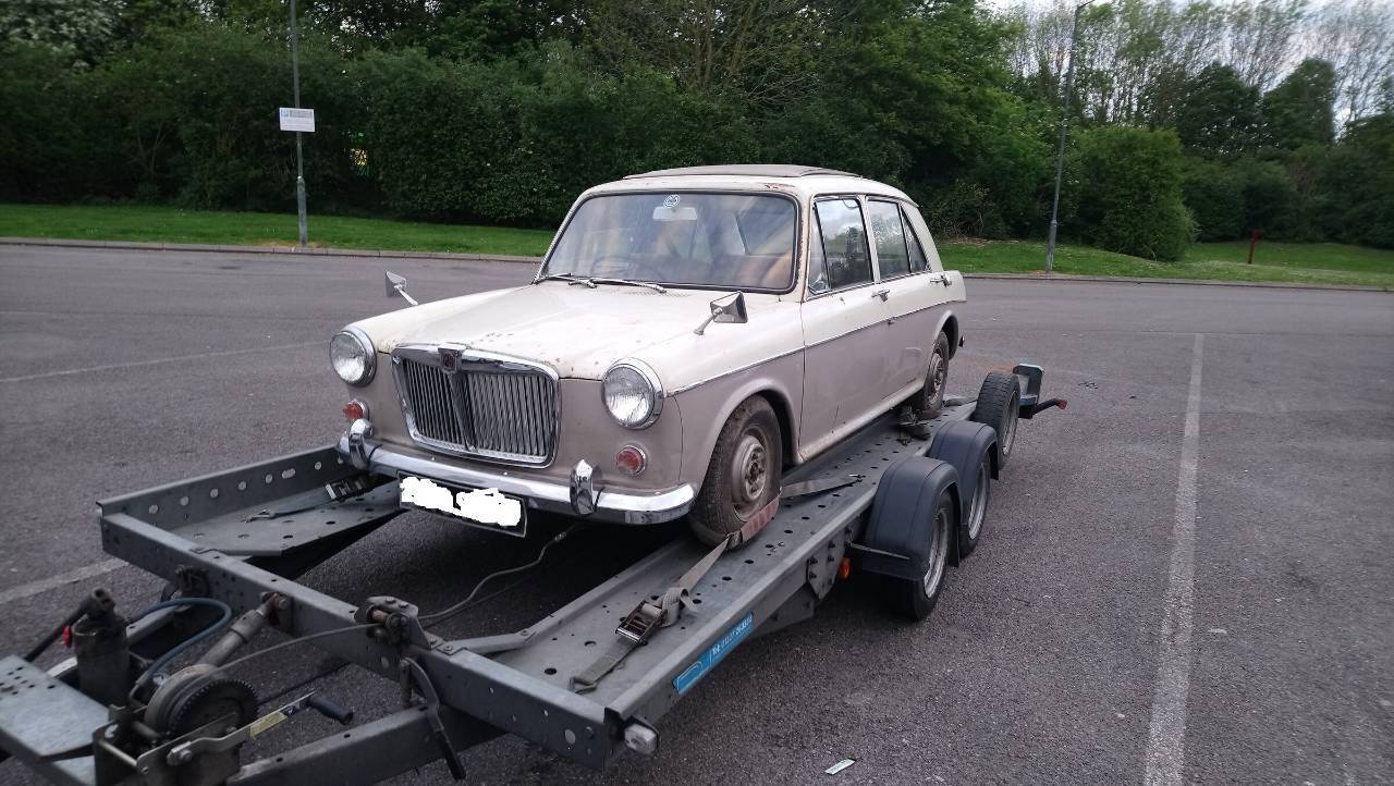

Weather was pretty shocking over the weekend so i finally got round to welding my mums MG 1100, its a bit of a slow burner project but i need to get it out of the way so i can get on with my own stuff, id quite like to repaint kermit if i can. I will introduce another finacial mistake later in the week but for now its cars you already know lol:
This was before it got shipped off to ADO Restorations, they did alot of work but my mum pulled the plug opting for me to complete the work as im well, cheaper. Not knocking Ed id sooner the car staying with him he was doing an awesome job.

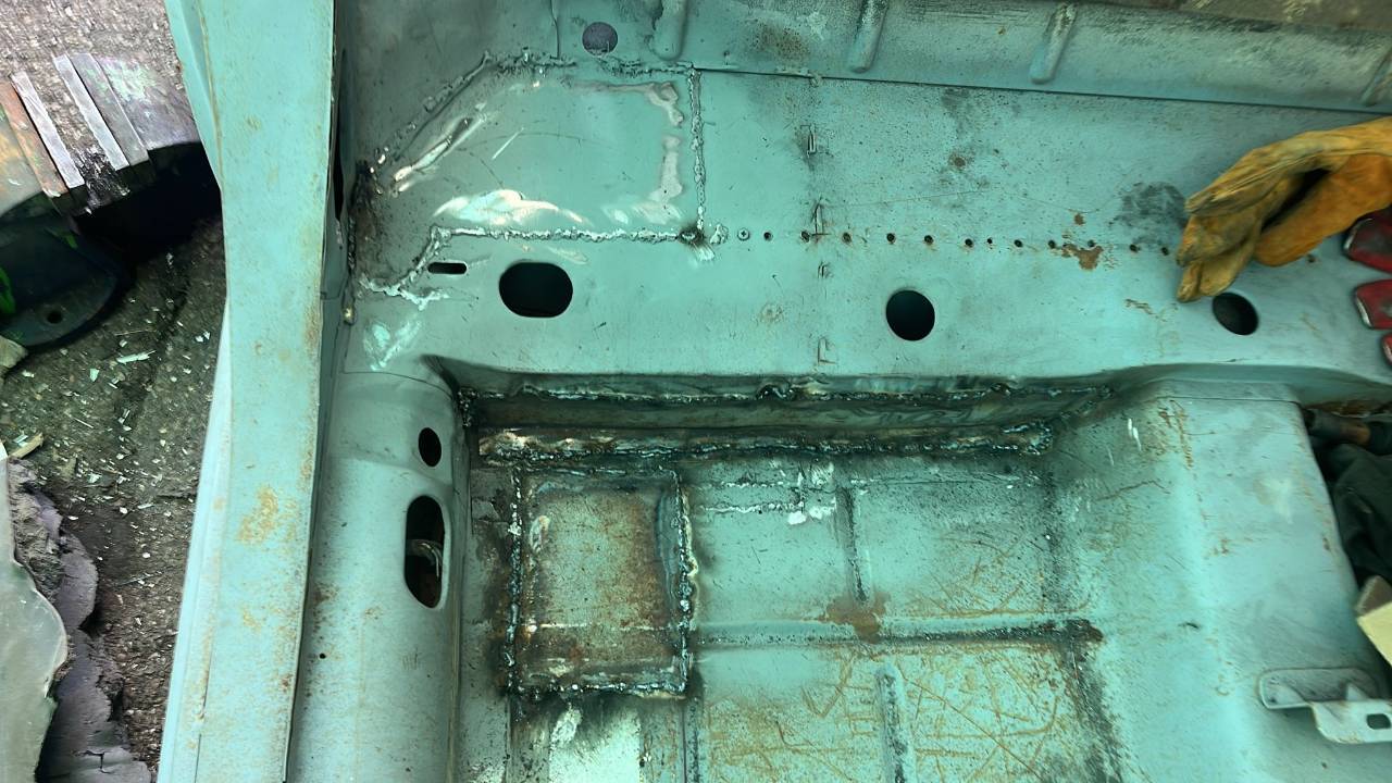

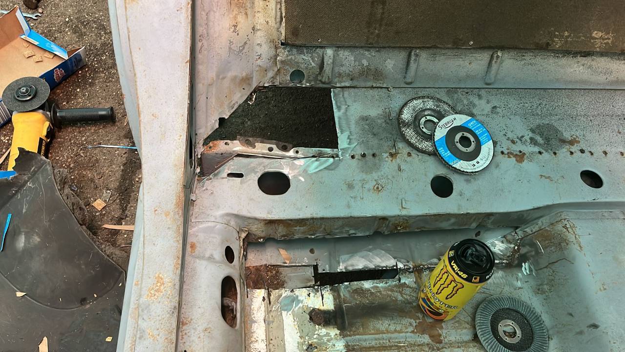

i cut the rusty metal out:
and welded in new:

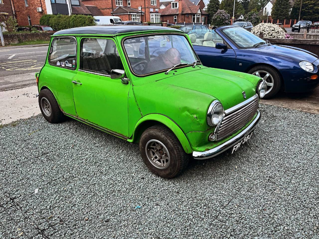

Think I'm long over due a Kermit post. This should be a really long post, sorry!
My tails of woe all started back with this picture and a really messy time, as you might or might not know i went through a particularly rough time when i lost my unit, one last push and the last car to come out of my unit was a revamped Kermit, he was cobbled together after the fire and dragged to Wales on the then annual Aug BH Welsh trip. Tasking it down onto black rock sands @Tommyboy12 got some cracking pictures and videos of the minis playing in the sea. This turned out to be both exciting and expensive:

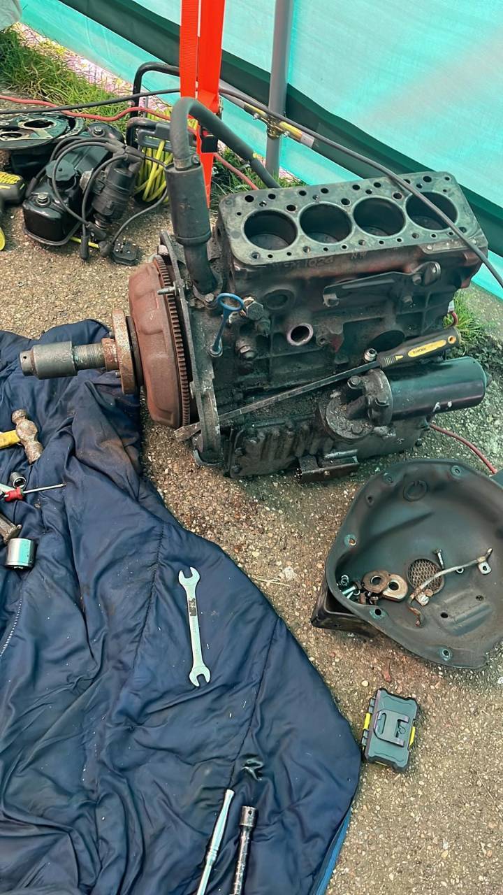

Engine seemed to run out, so i took it to work and the fly wheel dethatched from the crank running the crank. Annoyed by not deterred, i swapped the crank hastily for the one on the shelf using a mix and match of used bearings. Everything spun over ok but once in the car the engine locked solid. Annoyance set in and i just gave up, i ended up taking the escort which was super fun but i missed the mini adventure. Maybe not changing a h/g in a carpark but....you know

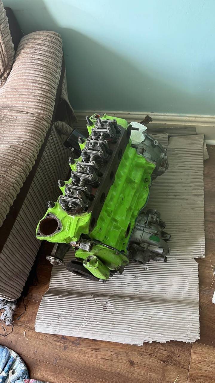

Fast forward to the back end of last year and Kermit has been out for nearly 3 years, Tom persuaded me that i realllly wanted to take Kermit to IMM Germany, i knew i needed a new engine and i'd an idea on the back burner for a few years ago. The Maestro block is basically a mini block and the auto minis use the same crank as a manual mini, so i decided to transplant the insides from the auto engine into a maestro block, fitting a manual mini gearbox. For those in the mini know that 1300 engines are insanely expensive but using my method above i could theoretically build a 1300 engine for peanuts.
At the time Ian Mackenzie just happened to list an auto engine...
So taking the two i started to make an engine in my living room:
Spec was simple but should be effective.
I couldn't get it to run right so Tom helped

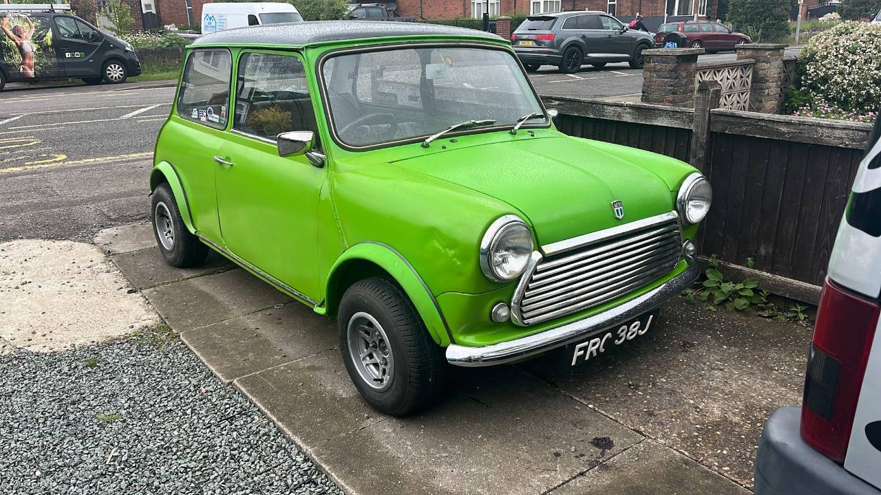

Its rear arch had been missing since it fell off on the aforementioned Welsh trip, but i think you agree its looking much better!

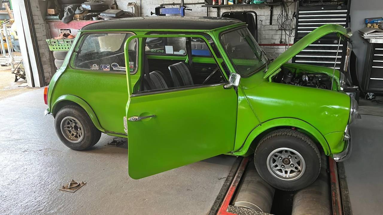

Today was a major milestone, i had it rolling roaded at Sleaford Mini Centre and it made a healthy 76hp.
And thats the story of how i got to where i am now and the next steps will be to drive to Germany!

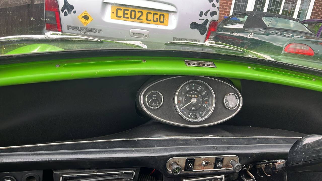

oooo i missed I revamped the dash..simple but effective.

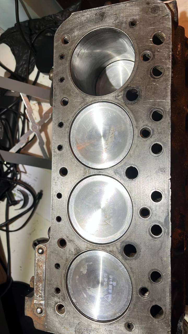

I finally got into the autoshite bike of choice, @Tommyboy12 raffle win r25gti, turns out he burnt a lovely hole in number 4 pistons. Kudos to him on that one!
lucky I pre ordered a new replacement bottom end…hoping it have it running again this week
In my defence. I wasn't banging it off the limiter *that* much 😅
Well you put a hole in the piston....

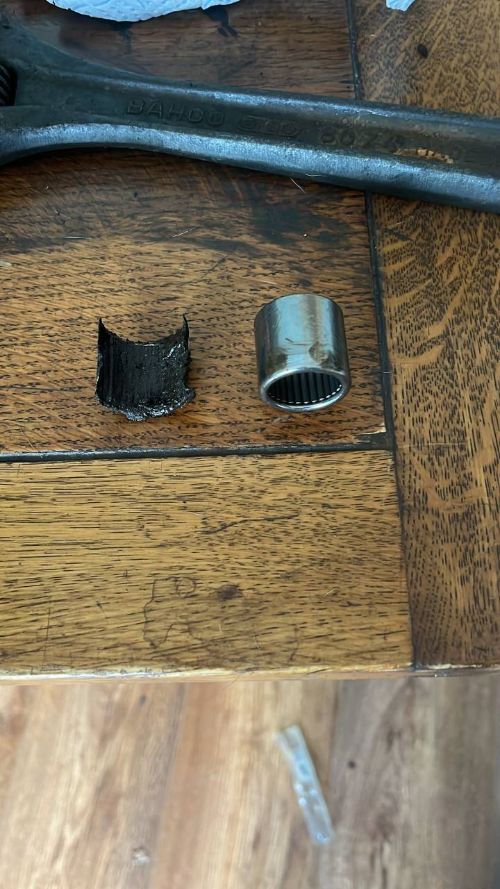

I also put my metro in for an mot the other week and it failed on a couple of really minor items and 1 major, the minor items were things like Headlight aim and rear fog not working. The Major issue was play in the rear radius arm. I thought i could just fit a new bush kit but turned out the arm was mullered:
nice and oval
I managed to find a metro in a local scrappy and purchase the rear subframe.
Rather than swap the full subframe i decided to just the fit the arm.
I did have a minor issue with the new arm as the rear brakes were shot, but i managed to salvage the brakes off the old arm which have already been to an mot, here is the cylinder I removed:

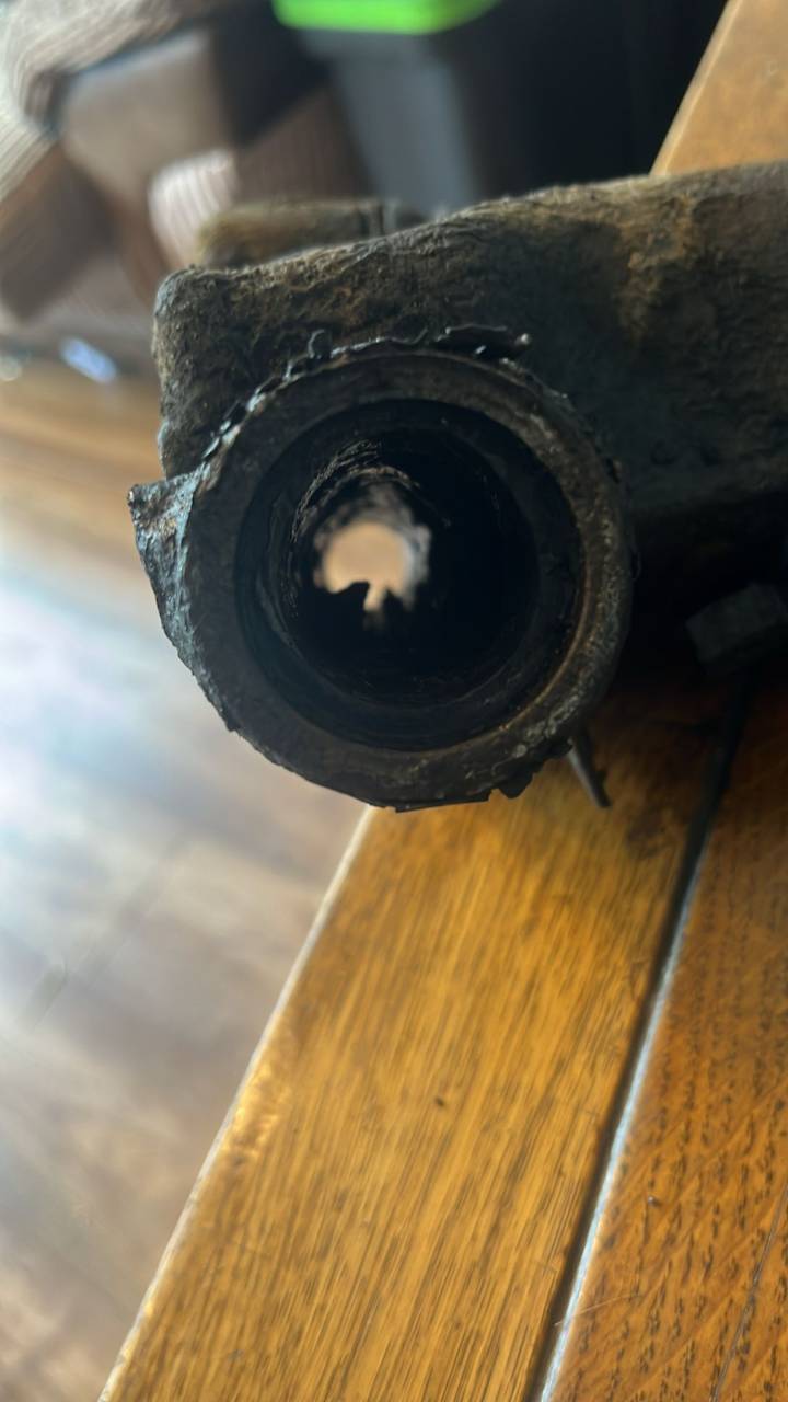

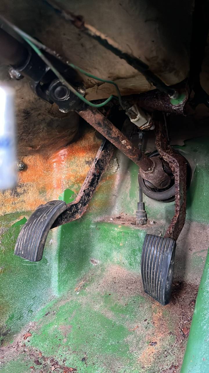

So now its onto the robin....first issue the pedal is stuck to the floor:
2nd issue i have no rear brakes at all....

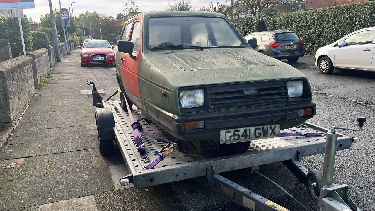

You ridiculed me for finding no rear shoes on my Reliant! How the turns have tabled!
Expand
reliant 2.0 has them so i'm still 50% up.
