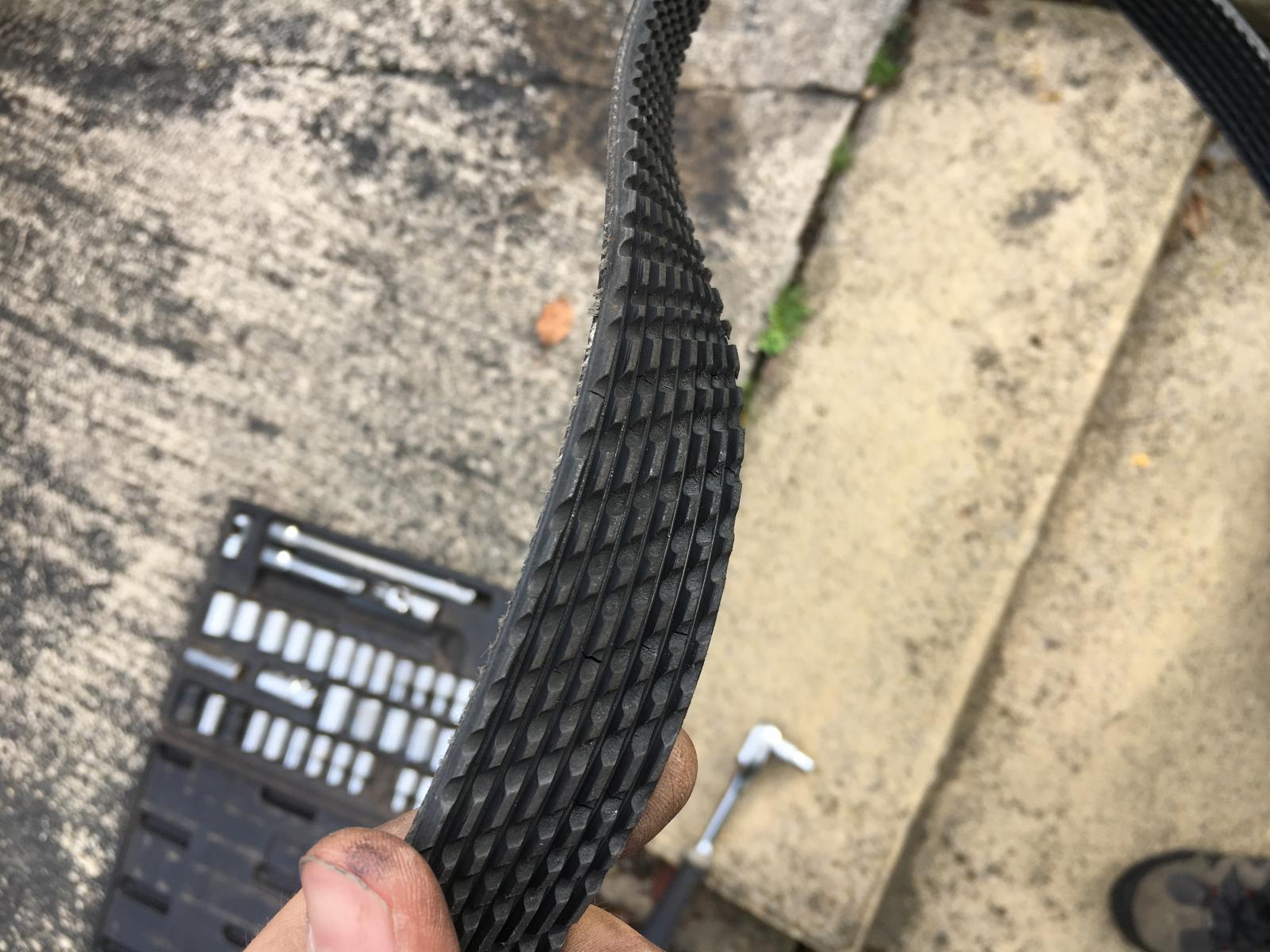

New supercharger belt arrived today. Got it fitted within a few minutes. Cleaned away more talcum powder so that the new belt wouldn't get ruined. The new belt is different as in it doesn't have the diamond cut pattern, but fits perfect. Test drive revealed no more belt squealing, which is nice. There is still quite a nasty sounding noise, exhaust leak aside. I know there is a small leak at the flexi pipe. I had as good a look as possible at the exhaust manifolds. They look quite tidy including the EGR bit. After all this I decided to disconnect the blower entirely by removing the belt, then listening to the engine once more. Still this nasty noise seemingly from the Vee is there. Video attached. Not quite sure what it is. It has plenty of get up and go and isn't smoking. Videos attached.

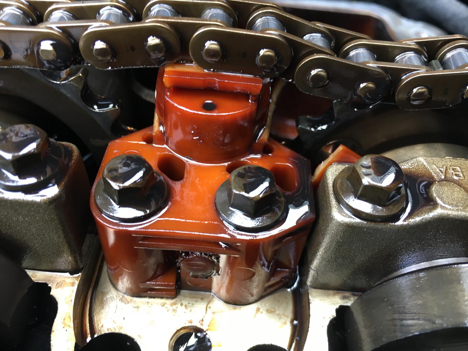

Thanks for the wheel suggestions. I will come back to that business once the engine has been sorted out. Speaking of which, I believe I have probably found the source of the rattle. I decided to take the cam cover (left bank) off today. There is an excellent video on Youtube telling you exactly how to do the job (both sides). It was a bit of a chore getting the cam cover off (right bank is very easy by comparison), but it went ok.
Immediately I noticed there was no tension on the secondary timing chain. Also there was no plastic on the tensioner. It has disappeared and the chain has been rubbing on bare metal (note the groove in there). This is a worry. Where the hell did the plastic bit go? The site is not letting me upload images at the moment, but the video should suffice.
Time to take the other side off & check too I'd say. Looks like a good time to fit the mk3 tensioners as you obviously can't trust the ones fitted & the earlier versions are known to fail.

I'm glad I checked the tensioner on the right bank. Turns out it was much worse than the left side, and I was fishing bits of plastic out of the timing cover. Note the tensioner on the right bank is upside down so we are looking at the bottom here. It is really rather broken. So what is needed then are both tensioners and new cam cover gaskets. Should be interesting to see how the engine runs after the new tensioners are fitted. The overall design is really rubbish, AJ16 is a much better unit in this respect.
A LOT better news than worn cams or tappet messing...... excellent news. Best of luck it sorts it all and leads to a quieter monster under control of your right foot.

Lucky you found it as I think the chains slip & lunch the engine if they get bad enough.
Ordered the new secondary timing chain tensioners today from Britishparts. The two tensioners plus new bolts to attach them came in at £99. Not bad. Jaguar direct wanted about twice that and couldn't even find the parts in their own catalogue in the first instance! I'm leaning towards doing this the risky way, which involves lifting the exhaust cam up enough to slide the old tensioner out and new one in. I will cable tie up the sprocket to the chain in several places to avoid movement of the timing. The workshop manual specifies very low torque for the cam shaft cap bolts (10 Nm). Does anyone with experience of taking engines to part have any advice on the sequence of doing up cam shaft caps?
Today I changed the secondary timing chain tensioners on both cylinder banks. This is probably the most ambitious automotive repair I have tacked given that I was messing with the engine. All in the job took 4 hours and 3 cups of tea, and went surprisingly smoothly, working swiftly but with style. It helped a lot having the experience of taking the cam covers off. Other than that the trick was to cable tie up the timing chain to the sprocket, make lost of marks to ensure I tightened up the cam cap bolts exactly as they came off, then it was off with all the exhaust cam caps and lever the cam itself up. The tensioner held with just two bolts and the new one has revised bolts. All in all a doable job on a good day. Pictures below show the extent of the damage on the old tensioners and you also see the revised new parts.
