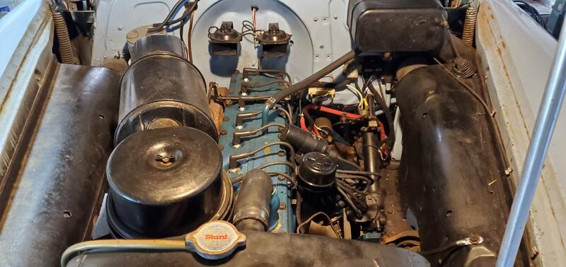

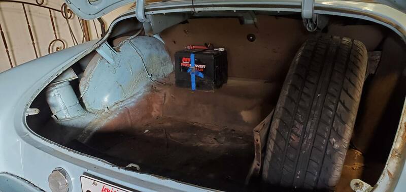

PhilA Posted September 23, 2020 Author Posted September 23, 2020 Moved the battery to the boot. That's tidied up the engine compartment nicely. Under the back, hard lines complete, shoes adjusted and handbrake set. Had noticed the brake flexi was a bit taut, find and fixed the reason. Left hand side of the axle wasn't properly mounted to the spring. 3 nuts, no lockwashers and it wasn't located on the centering dowel. Phil Asimo, Yoss, puddlethumper and 4 others 7

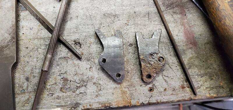

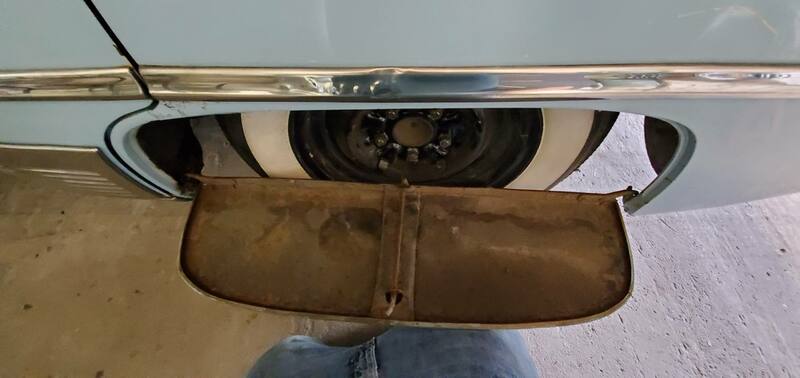

PhilA Posted September 23, 2020 Author Posted September 23, 2020 Some metalwork this morning. I pulled the passenger side spat bracket off, copied it for the driver's side, which was missing. Didn't fancy losing the spat on the highway. Fitted up to the wheelarch. The spat now locates correctly on both ends, folds up and locks securely in place. Added bonus, it doesn't rattle when I shut the door now either. Found one bad fitting on the brakes, replaced that after remaking the flare twice. That'll be why the old one was leaking then. Got the brakes bled up, just need to clip the new battery wire up properly, attach the front grille securely and do a final adjustment on the front brakes then it's set for MoT. Phil somewhatfoolish, lesapandre, Tepper and 11 others 12 2
