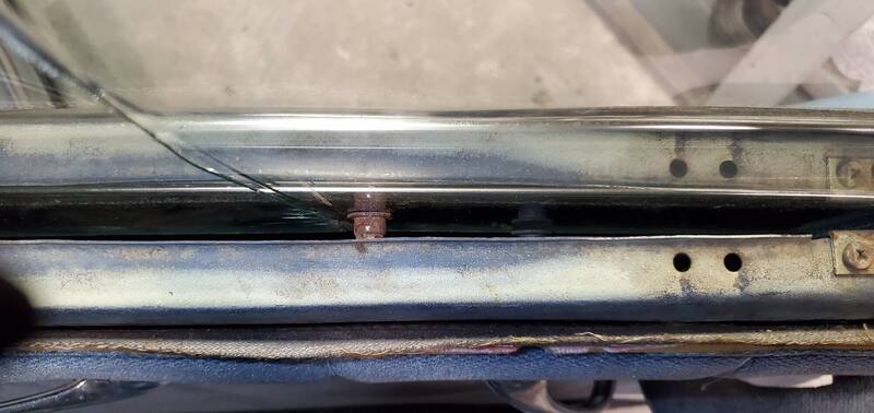

PhilA Posted August 14, 2020 Author Posted August 14, 2020 Tonight, I pulled the passenger side rear window surround off and took a look down the window aperture. Didn't want to see that. That there is the primary lift arm roller, the secondary is almost out of shot to the right. They should be nowhere near the glass, instead should be in the roller bar, which the sash channel attaches to, which holds the glass. I'm missing some critical window pieces. If nothing else came from this, I did get the lock working in the door. Phil paulplom 1
