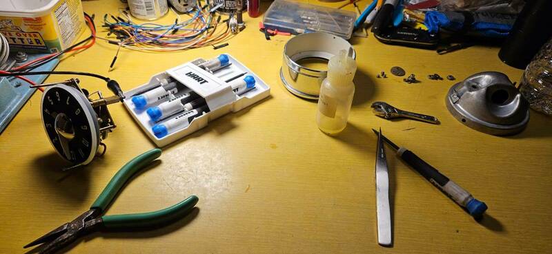

PhilA Posted December 20, 2023 Author Posted December 20, 2023 Clock was losing time and sounding a little rough, so it arrived on my bench. Oiled the pinions up, that helped a lot. Then I set about adjusting the hairspring balance. Yup, I set my clocks up with an oscilloscope. Don't you? Nice even pulses now, means the balance wheel is moving evenly. So, back into the dash it goes with a note in pencil on the case that it was serviced today. Phil djim, Dyslexic Viking, Dan_ZTT and 22 others 25

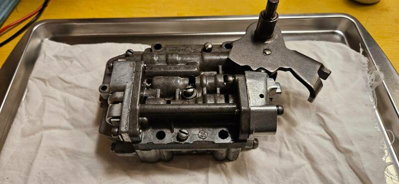

PhilA Posted December 21, 2023 Author Posted December 21, 2023 Brand new valve block. Gummed up solid with solidified storage oil so apart it comes while I figure how best to free it up. Phil Matty, Dyslexic Viking, GrumpiusMaximus and 5 others 8

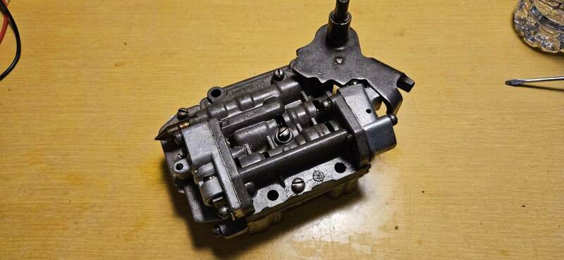

PhilA Posted December 22, 2023 Author Posted December 22, 2023 Turns out this valve block isn't NOS. But, it's close. It's a factory rebuild. I had to use fire in order to heat the old oil up and soften it enough to get the moving parts free. The bores are beautiful though. All the wear parts are new. Took it all to bits, cleaned it all up. It all moves very nicely. Had to fix the 4-3 kick-down shuttle blocking rod as it was too long and had bent the center divider plate. Ground it down to fit and hammered the plate flat. Much better. Finally, all back together again. Ready to go into the car. Phil cort1977, Jenson Velcro, LightBulbFun and 15 others 18
2flags Posted December 22, 2023 Posted December 22, 2023 Hopefully this will solve the issues you have been having with it. It will probably be the best one out there soon, if not already. Looking so cool. LightBulbFun, Rust Collector and PhilA 3
PhilA Posted December 22, 2023 Author Posted December 22, 2023 2 hours ago, 2flags said: Hopefully this will solve the issues you have been having with it. It will probably be the best one out there soon, if not already. Looking so cool. I hope so. If it does, it'll make driving it more fun, and letting others drive it a more enjoyable experience. Phil hairnet, Momentary Lapse Of Reason and Rust Collector 2 1

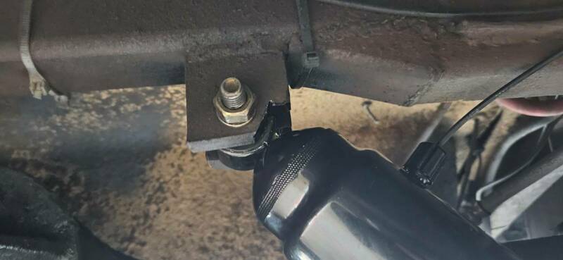

PhilA Posted December 26, 2023 Author Posted December 26, 2023 Gearbox is getting better now it's got a few miles on. However, tonight was interesting. Hit a bump* in our lovely* road and BANG SCRAPE Top shock mount sheared off, leaving the shock to bounce along the road attached only to the axle. Not overly impressed by that... Rust Collector, Tickman, adw1977 and 6 others 9

PhilA Posted December 26, 2023 Author Posted December 26, 2023 Ordered a new pair of shocks. Woo. Car currently has a case of lowered. Phil. mk2_craig, ProgRocker and Mrs6C 3
hairnet Posted December 26, 2023 Posted December 26, 2023 ahh the shock died not the metal in the car 50s grade
PhilA Posted December 28, 2023 Author Posted December 28, 2023 These ones, despite being the same p/n as the old ones are dumpier by the wrist. Clearanced the mount. That'll work. Phil Mrs6C, RayMK, captain_70s and 2 others 5

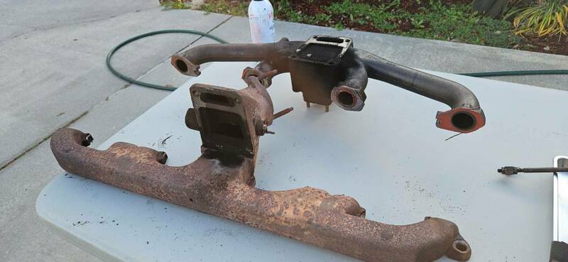

PhilA Posted January 5, 2024 Author Posted January 5, 2024 Question: Can this car do a burnout? Yes To show its displeasure, it blew the exhaust manifold gasket. Tickman, Rust Collector and Coprolalia 1 2

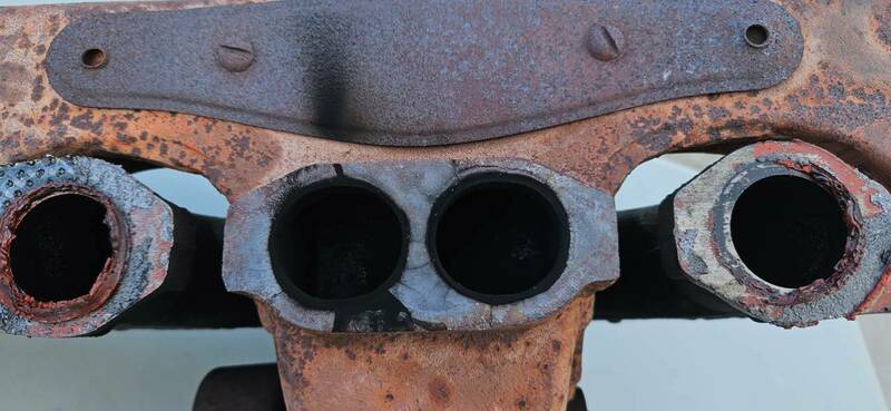

PhilA Posted January 7, 2024 Author Posted January 7, 2024 Weather was pleasant today (read sunny, not raining or blowing a gale like the last few days). So I set about doing something useful. Pulled the manifolds off. The exhaust had become chattery. Sure enough, that's been leaking. Split it all down, cleaned up and made some new gaskets. Went down the RTV route with it this time. Reassembled it all. Nice and quiet again, with no exhaust coming into the cabin. Great improvement. Phil Coprolalia, Dyslexic Viking, mk2_craig and 11 others 14

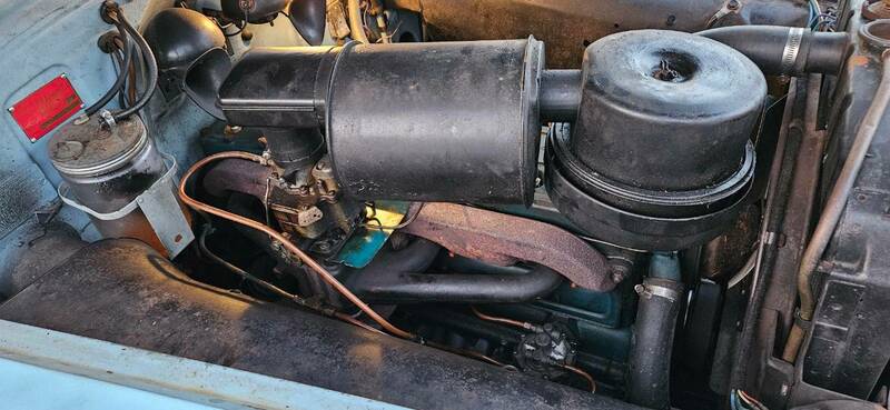

PhilA Posted January 17, 2024 Author Posted January 17, 2024 Another cold morning. -5 today. Car started on first push of the button. Not bad, though the electric fuel pump has apparently given up. Phil GrumpiusMaximus, Coprolalia, Asimo and 7 others 10
