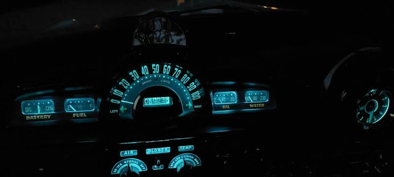

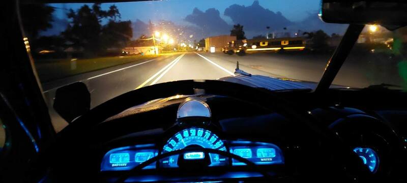

PhilA Posted June 15, 2022 Author Posted June 15, 2022 Couple boxes arrived. New alternator, same as the last but not worn out. Also with much smaller pulley, so now it charges at idle. It went where the old one went. New dash bulbs. Not totally sold. Was aiming for turquoise/EL green but got something closer to Cherenkov. A little bit blue. Still, goes with the car. Phil Low Horatio gearbox, Dick Cheeseburger, BlankFrank and 13 others 14 2

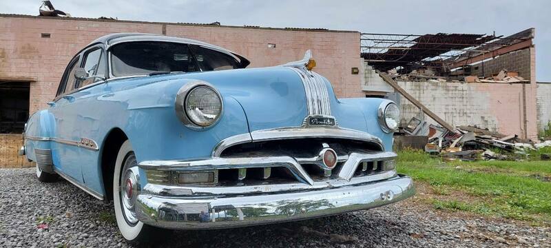

PhilA Posted July 6, 2022 Author Posted July 6, 2022 Out and about again. Got that post-apocalyptic feeling going on. Had to go change a failed card last night. Bought some Meguiar's wax, which is of the wash car/spray wax/dry car type. Initial results are interesting, it's a bit difficult to dry it off without getting it a little streaky. It did however dry off very nicely this morning after the dew so that's something. Phil RayMK, Low Horatio gearbox, LightBulbFun and 1 other 4
