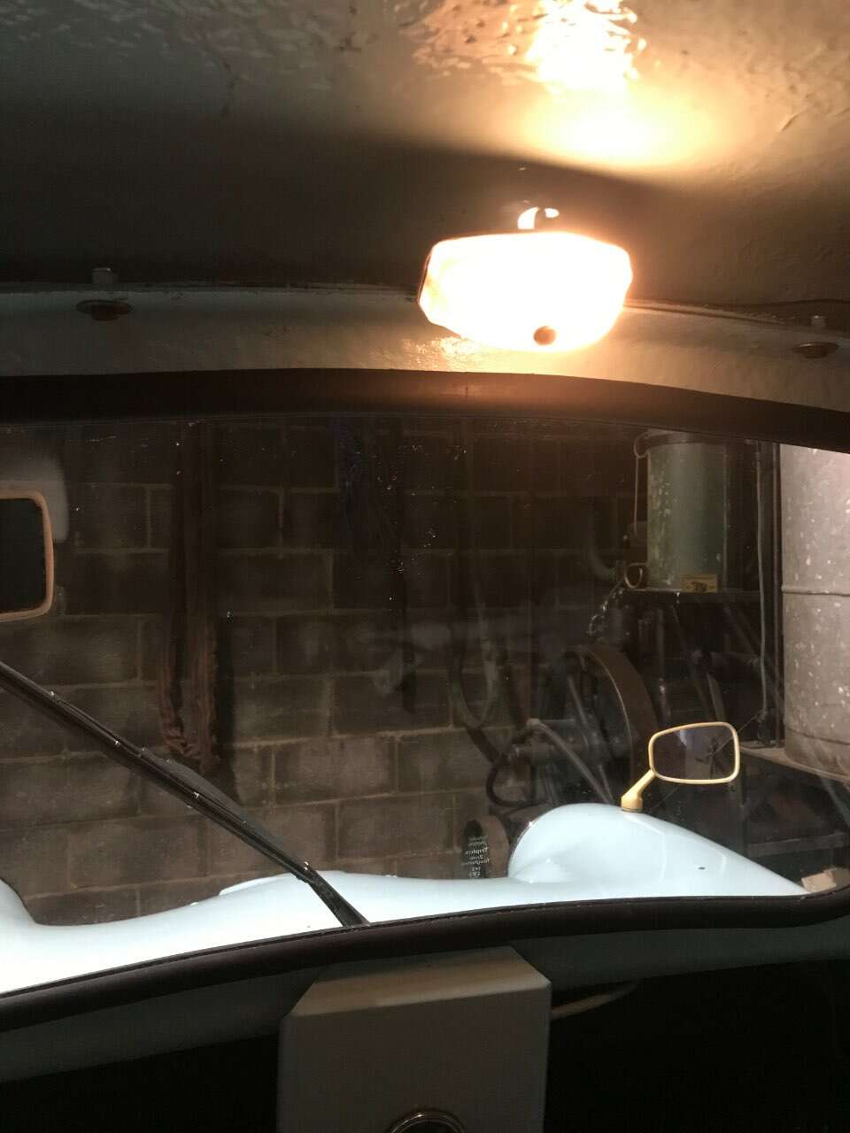

AdgeCutler Posted February 9, 2023 Posted February 9, 2023 Let there be light! egg, 500tops, Dick Cheeseburger and 5 others 8

brummiejon Posted February 9, 2023 Posted February 9, 2023 4 hours ago, AdgeCutler said: Let there be light! It’s the little things…… AdgeCutler, egg and LightBulbFun 3
brummiejon Posted February 9, 2023 Posted February 9, 2023 3 hours ago, brummiejon said: It’s the little things…… At some point I’m going to need a big bank of batteries for the Argson, likely to cost me as much as the beauty herself…. 6 x 6v deep cycle batteries do not come cheap…. So I’ve been relishing in the little things before I have the big hitter….. I’ve hit on a little snag with my brake light upgrade….. the lights, horn and brake lights are all wired from one battery, 12v via a live fuse and both circuits share an earth…. When I put on the brake lights I’ve got a residual current bleeding through brake light switch and into the lighting system. The headlight comes on very dimly when I put the brake lights on…. Not a big deal but I’d like to figure out how to isolate the two 12v circuits….. all good fun

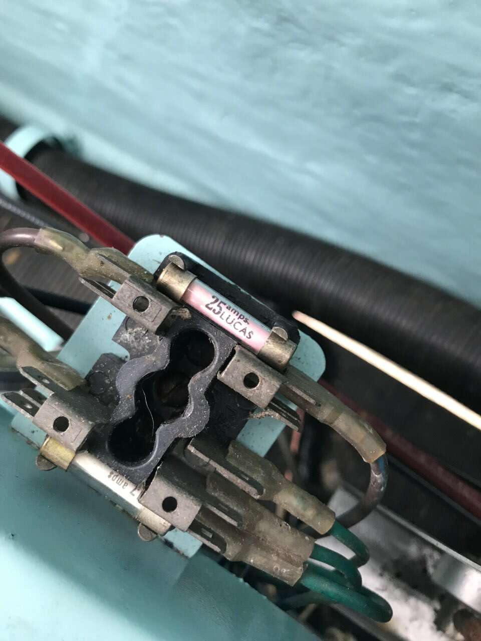

AdgeCutler Posted February 10, 2023 Posted February 10, 2023 18 hours ago, brummiejon said: It’s the little things…… They eat up a good chunk of time and it all adds up! It's quite embarrassing how much time this little lamp has eaten, then even worse the time taken to install. Firstly power was not making it through switch contacts so that was taken apart, given a good going through, new rivets made to put the switch back together as original. Soldering new appropriate connectors onto the wires which were ordered to match the wiring diagram and then just a case of fitting? No. No light so meter back out, 12.6V all the way through the circuit. Take bulb out, test, fine. Replace bulb, flick switch, no light, voltage lost. Repeat all of the above until feeling like I'd lost the plot, over and over. Eventually discover the fuse is shonky, it was allowing voltage through but as soon as a load was applied it would lose contact. I'm need to try to get hold of some Lucas 17, 25 continuous but they seem fair scarce these days. At present it's behaving itself but I'll not be venturing out after dark until I have found replacements. brummiejon, LightBulbFun, Mrs6C and 1 other 3 1
LightBulbFun Posted February 10, 2023 Author Posted February 10, 2023 7 hours ago, AdgeCutler said: I'm need to try to get hold of some Lucas 17, 25 continuous but they seem fair scarce these days. not sure if your looking for 25A or 35A lucas fuses? since 17.5A is the continuous rating of a 35A fuse, but you give a 25A blow rating so heres links to both https://www.gsparkplug.com/durite-fuse-25-amp-blow-32mm-glass-pk10-0-374-25.html https://www.gsparkplug.com/durite-fuse-35-amp-blow-32mm-glass-pk10-0-374-35.html and if eBay is what you prefer https://www.ebay.co.uk/itm/291022081317 https://www.ebay.co.uk/itm/291022081411 helps that I have looked into these for Model 70's already LOL lesapandre and AdgeCutler 2
chadders Posted February 10, 2023 Posted February 10, 2023 He may mean 25A continuous, I've got some somewhere along with some 17A continuous.

AdgeCutler Posted February 15, 2023 Posted February 15, 2023 On 2/10/2023 at 2:22 PM, LightBulbFun said: not sure if your looking for 25A or 35A lucas fuses? since 17.5A is the continuous rating of a 35A fuse, but you give a 25A blow rating so heres links to both https://www.gsparkplug.com/durite-fuse-25-amp-blow-32mm-glass-pk10-0-374-25.html https://www.gsparkplug.com/durite-fuse-35-amp-blow-32mm-glass-pk10-0-374-35.html and if eBay is what you prefer https://www.ebay.co.uk/itm/291022081317 https://www.ebay.co.uk/itm/291022081411 helps that I have looked into these for Model 70's already LOL Of course you are correct Dez. I got thrown off the scent as the wiring diagram shows 2x25Amp fuses in the fuse box and an inline 35Amp, when I glanced down at the fuse box I saw this. I am actually on the trail of some genuine period Lucas fuses and a lid for the fuse box but thanks for the links. LightBulbFun and Mrs6C 2
Zelandeth Posted February 15, 2023 Posted February 15, 2023 4 hours ago, AdgeCutler said: Of course you are correct Dez. I got thrown off the scent as the wiring diagram shows 2x25Amp fuses in the fuse box and an inline 35Amp, when I glanced down at the fuse box I saw this. I am actually on the trail of some genuine period Lucas fuses and a lid for the fuse box but thanks for the links. In case you wind up looking for a fuse box replacement that doesn't have horribly tarnished terminals, they're not horrifically expensive. Link. LightBulbFun, brummiejon and Mrs6C 3
