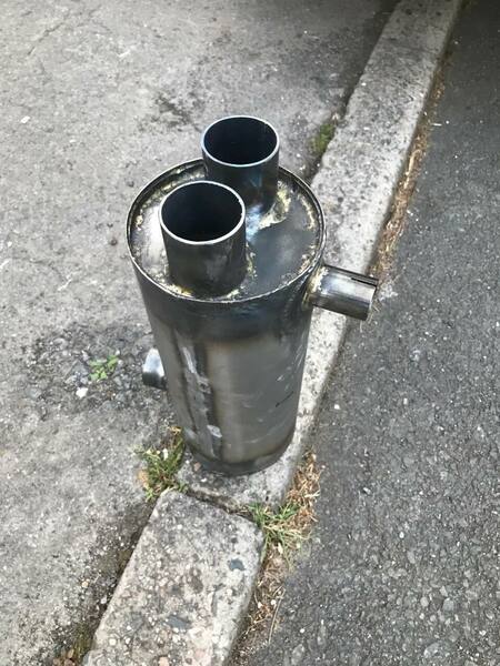

AdgeCutler Posted May 5, 2022 Posted May 5, 2022 Can you guess what it is yet? Mrs6C, LightBulbFun and 500tops 3

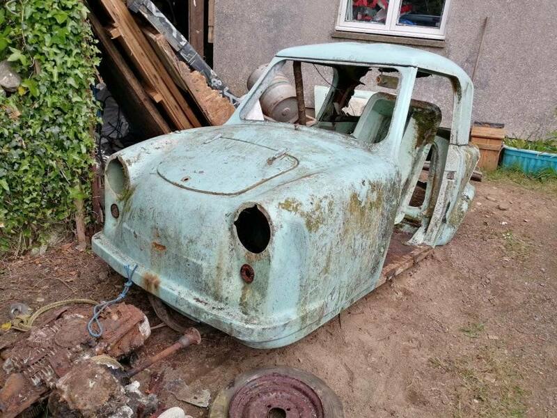

quicksilver Posted May 8, 2022 Posted May 8, 2022 On 4/30/2022 at 8:30 PM, LightBulbFun said: indeed! I very much appreciate the literal blood sweat and tears you went through just so I could oggle at its chassis plate! its interesting to see how much more buried it is since whenever the bellow photo was taken its still one I find very interesting, given how its on its own, normally where you find 1 Invacar you would find many more, since they where usually disposed off in lots to a contracted yard It is a bit of an odd one. The combination of only being nine years old, having its controls removed and being on its own suggests this was not a routine planned withdrawal. Looks like it caught fire, the local repairer deemed it beyond repair, transplanted its controls into another and then got this chap to take away the remains. I wonder what controls it had. LightBulbFun 1
LightBulbFun Posted May 8, 2022 Author Posted May 8, 2022 36 minutes ago, quicksilver said: It is a bit of an odd one. The combination of only being nine years old, having its controls removed and being on its own suggests this was not a routine planned withdrawal. Looks like it caught fire, the local repairer deemed it beyond repair, transplanted its controls into another and then got this chap to take away the remains. I wonder what controls it had. yeah thats exactly what my thought is, as to what happened to it, but even an Approved repairer would have a normally setup disposal system, so you would have expected even an unplanned withdrawal to still go to that yard with all the other cars, much like how @Mrs6C's Mk12 came to survive (where the scrap yard was disposing of Invacars for a time and then XWC came in a while later after the "main batch" and so was just stashed to one side rather then broken up) I almost wonder if, this Model 70 never made it back to the Approved repairs yard, in that it caught fire and it was just taken straight from the roadside to this dumping ground of cars, back then the Ministry was a lot more lose over their grip on things, so the approved repairer could of said "yeah it caught fire so I just had the roadside recovery man dispose of it as he saw fit" hence it ending up in a non contracted yard, I also did wonder if perhaps it was stolen and joy ridden and then an attempt made to burn it out? but neither of these would explain the missing controls (unless the approved repair went out of their way, to the dumping ground to salvage them after the fact) and as mentioned previously its notable in that it does not have a scrapped marker against it, so as you say most odd! I sadly dont have any inside pictures to look for clues as to what it may of been fitted with often times even with controls removed or reconfigured, there will be witness marks, of what was once there, to give us some clues, like the screw holes and missing sections of floor rubber in REV from when she was some sort of foot control machine (of which Im still curious about, since said witness marks dont line up with any normal foot pedal brackets so I do wonder if by foot control, they meant it in the most literal sense that she had no hand controls at all, but sadly other than who all her keepers where, I have little in the way of history for REV, for example I dont have any period photos sadly) or the remaining foot pedal brackets in one of the Handle bar cars found in the TWC/TPA Field (which I wonder was converted because of a change in user, or if because the user had a disability that got worse over time so went from being able to use their feet to being unable to so had the pedals removed?) AnnoyingPentium 1

dollywobbler Posted May 9, 2022 Posted May 9, 2022 The fire damage looks localised to the fuel pump side of the engine bay, where of course, the pipes were held on more by hope than anything. I reckon someone must have put the fire out before it really took hold though.
LightBulbFun Posted May 9, 2022 Author Posted May 9, 2022 4 hours ago, dollywobbler said: The fire damage looks localised to the fuel pump side of the engine bay, where of course, the pipes were held on more by hope than anything. I reckon someone must have put the fire out before it really took hold though. interesting! I figured it was a fuel related fire as their aint much else to catch fire in a Model 70!, guess the standard equipment fire extinguisher came in handy then! and I imagine once the engine was shut off, it would of stopped the fuel pump and literally run out of fuel to burn, what im surprised about is that the fibreglass itself did not just go up, I have seen a few Reliants burn completely to the ground, but from what I have seen, Model 70's are surprisingly fire resistant for what they are made of! (or the fire extinguisher they came with was very effective!) there are supposed to be fuel clips there, it even states so in the workshop manual, but it seems like they where lost over time by people working on the cars being lazy about it so thats no fault of the Model 70, in the same way that in any car, leaving off the fuel hose clips is asking for similar trouble!

AdgeCutler Posted May 12, 2022 Posted May 12, 2022 A lot of work involved in these bloomin things but it’s done now and tested for air tightness. Rust Collector, Dick Cheeseburger, 500tops and 9 others 12
Dick Cheeseburger Posted May 12, 2022 Posted May 12, 2022 23 minutes ago, AdgeCutler said: A lot of work involved in these bloomin things but it’s done now and tested for air tightness. I'm in awe of the level of detail you're going into with the fabrication of various NLA parts for your Invacar along with your general attitude towards making the resto top notch. Just brilliant 😎. timolloyd, Yoss, AnnoyingPentium and 5 others 7 1
High Jetter Posted May 12, 2022 Posted May 12, 2022 2 hours ago, AdgeCutler said: A lot of work involved in these bloomin things but it’s done now and tested for air tightness. Turn 90 degrees for Y Tho. beko1987 and AnnoyingPentium 1 1
