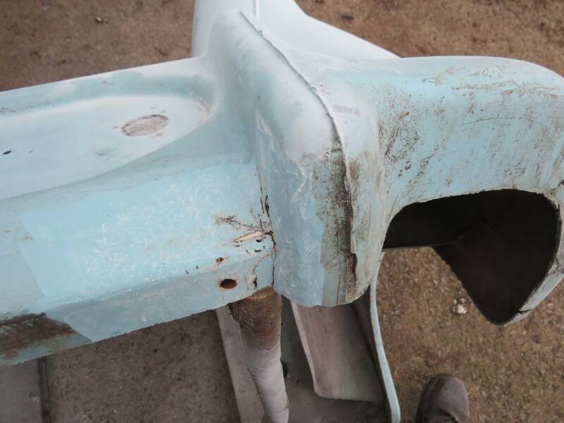

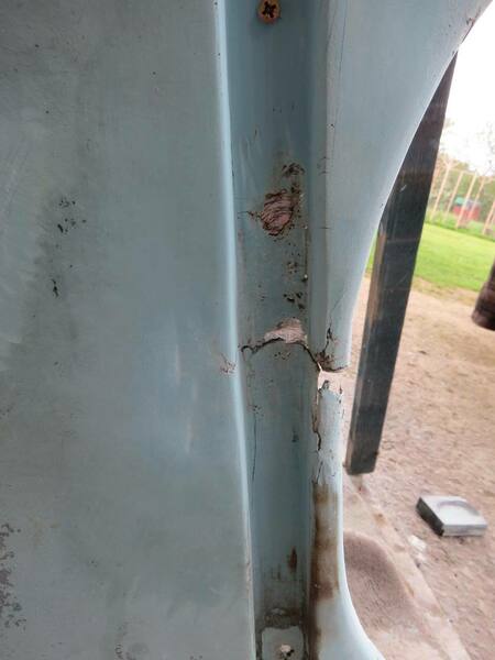

LightBulbFun Posted May 23, 2021 Author Posted May 23, 2021 7 hours ago, AdgeCutler said: I've now made a start on fibreglass repairs. Firstly I backed the area of damage (below engine compartment lid), this was done with random odment I found lying around including a piece of Perspex, wood and a piece of 3/4" steel conduit. These were all then screwed in place and then removed and I made my mistake of using a piece of plastic poultry feed bag to back it up and refitted the shuttering. Seems obvious now but the bag "pickled" and slightly raised the resin/fibres. It's not the end of the world and the area will be re-worked to achieve a better final finish and I had something to work against this morning with the shuttering removed and strengthened up the backside. It was the first time I've had a go at fibreglass repair and it all went pretty well in general and I learn a couple of lessons including the fact that dawdlers will not be tolerated by the resin! Hopefully I'll have chance in the next few days to make good the job. Very awesome its looking very good already! I am looking forward to seeing how you get on with the rest of the bodywork etc

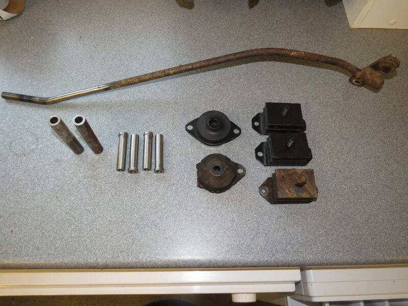

AdgeCutler Posted May 25, 2021 Posted May 25, 2021 I've now had a couple of requests for details on where I sourced the anti vibration mounts for Brians engine cradle and so thought I'd share it here in case it may be of use to others. The company I used are AV industrial products ( https://www.avindustrialproducts.co.uk/products) who supply a comprehensive range of mounts. Note, I measured up and found mounts that are identical in dimension to the originals but I did take a bit of a stab at the load ratings as I didn't have this information for the originals. The ones I ordered are CM379-HT60DC for the single cone mount and RSM406-50L for the sandwich mounts. A washer for the cone is W379-BF, if your original is good I would re-use it as the replacement isn't pressed as the original is (sadly mine was half rotten). Mrs6C, LightBulbFun and st185cs 2 1

LightBulbFun Posted May 25, 2021 Author Posted May 25, 2021 6 hours ago, AdgeCutler said: I've now had a couple of requests for details on where I sourced the anti vibration mounts for Brians engine cradle and so thought I'd share it here in case it may be of use to others. The company I used are AV industrial products ( https://www.avindustrialproducts.co.uk/products) who supply a comprehensive range of mounts. Note, I measured up and found mounts that are identical in dimension to the originals but I did take a bit of a stab at the load ratings as I didn't have this information for the originals. The ones I ordered are CM379-HT60DC for the single cone mount and RSM406-50L for the sandwich mounts. A washer for the cone is W379-BF, if your original is good I would re-use it as the replacement isn't pressed as the original is (sadly mine was half rotten). Oh cool I was wondering about that! the Model 70's uses some fairly similar looking rubber mounts in its engine/gearbox mounting arrangement as well so I wonder if they have anything suitable for the Model 70 as well, its good to know who does what 1 hour ago, MT606 said: with all this dealings with the DVLA, do you know if when sending things into them via royal mail , are the addresses free post ? no they are not free post I dont think (a quick google says they are not) MT606 1

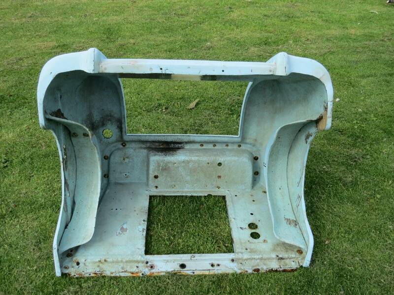

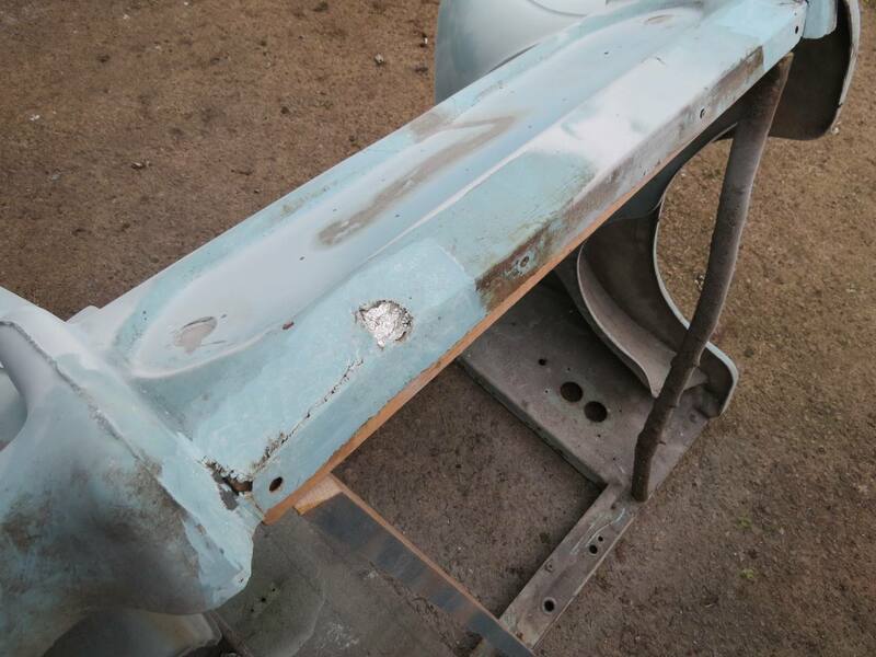

LightBulbFun Posted June 1, 2021 Author Posted June 1, 2021 On 29/05/2021 at 18:52, AdgeCutler said: Back to the subject of Brian the Invacar, I've now spent a couple of days Fibreglassing and preparing the rear body section and feel I'm nearing a point where it is acceptable. Another few hours should see it reinforced internally around the repairs and a few other stress points and then in primer. Here are a pictures taken along the way and up until I wound up for the day today. very awesome to see work on Brian continue, its looking very good already! its very interesting to see the underside of the rear bodywork its quite an intricate moulding all things considered (keeping in mind the design going back to 1960) I wonder how it was laid up and put together On 01/06/2021 at 14:50, eifion said: You're famous*, @LightBulbFun! At least to the extent of having a picture of REV in the new Citroen Car Club magazine. hah thats Awesome! although I bet all the shitters who got that magazine probably let out a collective sigh as they turned a page and was greeted with Invacars, given my reputation for managing to work them into everything LOL (am really wishing REV was cleaned now, before the photo was taken LOL) as a side note I cant help myself but just quickly mention that the Model 70 does not get its name from any year, the First Prototype Model 70's where on the Road by 1967 (Prototype 5) they just had a very long gestation and testing period, and only finally entered production in June 1971 (however there where 20 User trial cars in 1970, which did just become part of the main the fleet once production started, much like the how the 24 Prototype Routemaster RMLs just joined the 500 production Routemaster RMLs) the Model 69E for example is the Electric Tippen Delta, which was introduced in about 1965-1966 and you had the Model 66, the Invacar Mk12 which was introduced in 1960 its just a bit of a coincidence that the Model 57 (Metal AC Acedes) and Model 67 (Fibreglass AC Acedes) where introduced in 1957 and 1967 respectively, and that its mainly AC machines that are referred to by their Ministry name rather then manufacturing name so a lot of people think that the Model 70 gets its name from a year when it does not Mrs6C and bobdisk 2
