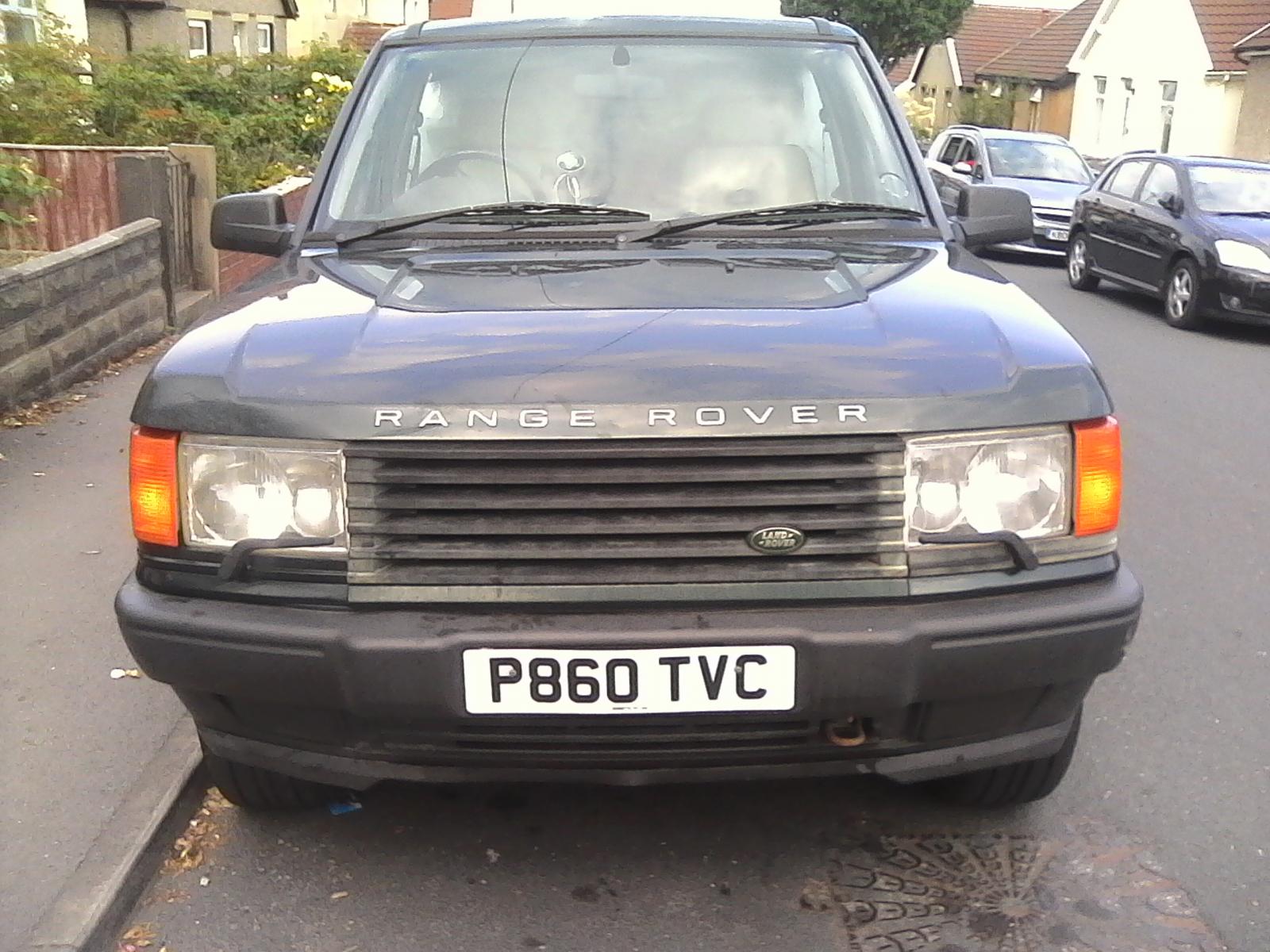

P38 Range Rover, provisionally claimed by *lucky shiter of much winning!
