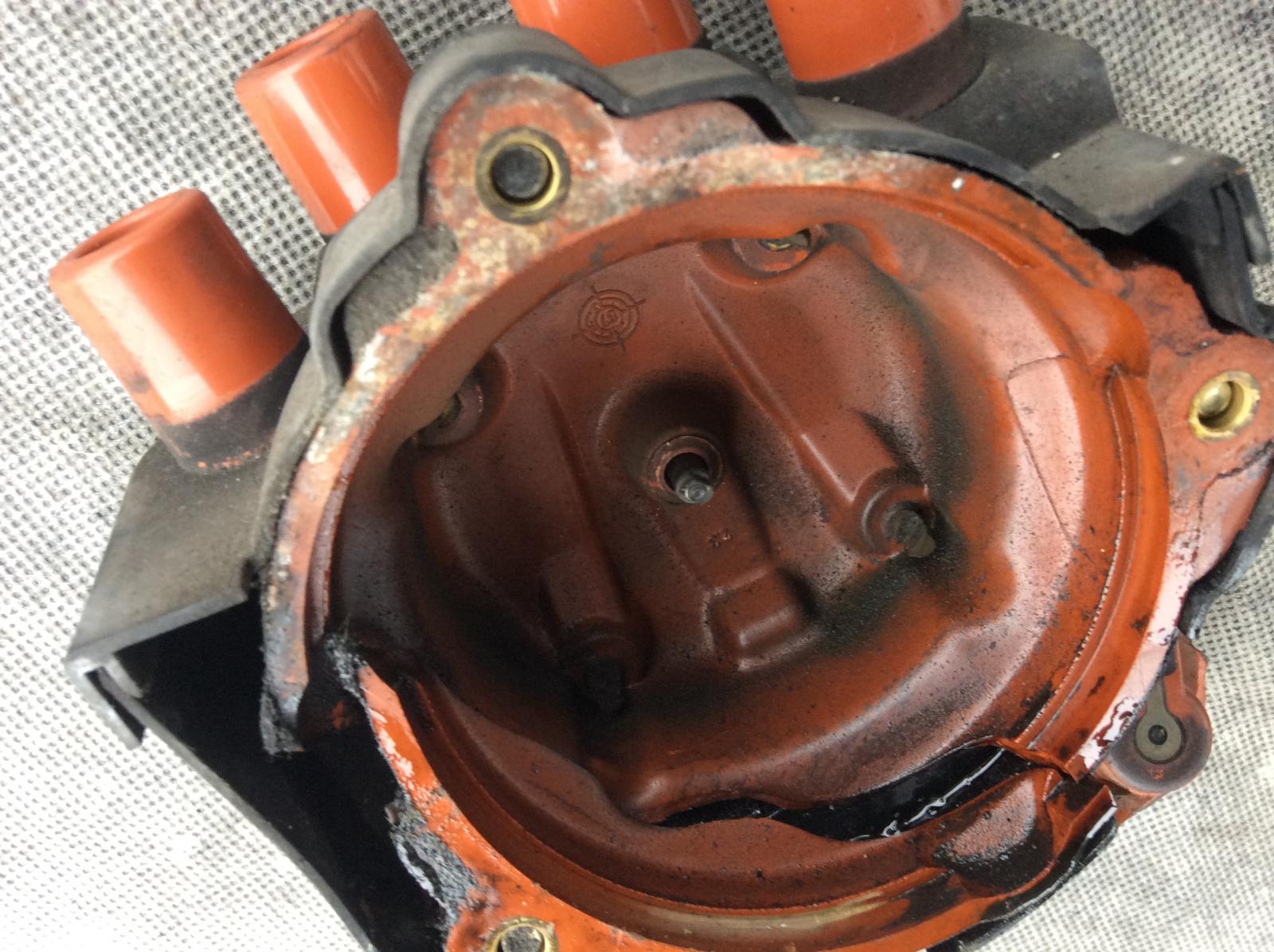

This is what a bad one looks like...
This is the one I removed from my 740 when I first got it.
The contact posts are burnt to buggery and actually worn well into the brass material. The cracked side was like that while on the car too! It was running still believe it or not, badly but running! The rotor arm was similarly past it.
The date stamp on that cap was 1987! Almost certainly the cars original part. It should have been changed years ago of course.
