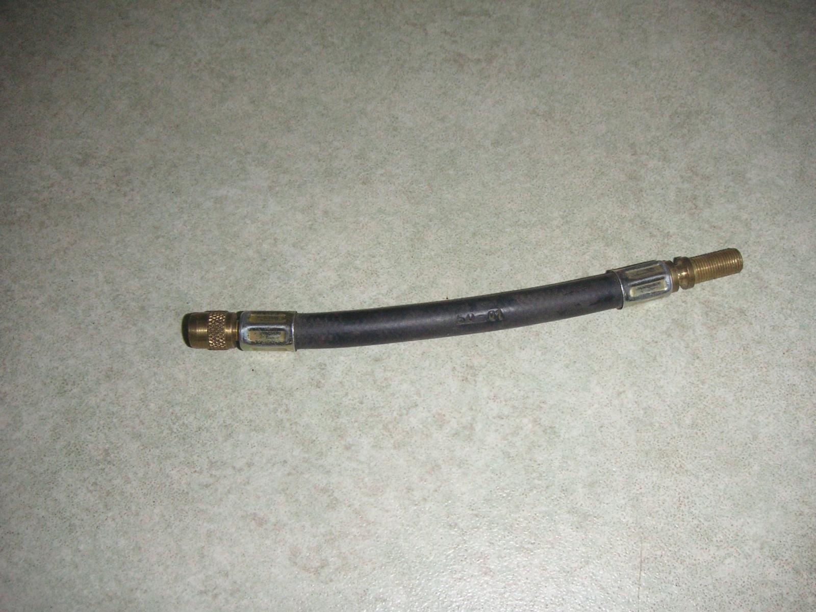

Mally Posted August 18, 2018 Posted August 18, 2018 This is a stupid suggestion, but you can get a metal extension as used on the inside wheel of some truck wheels.It may be possible to remove your valve core, locktite a valve extension on.Voila new valve seal. Something like this, but there are shorter, metal ones available, or were in 1980 CGSB and catsinthewelder 2
