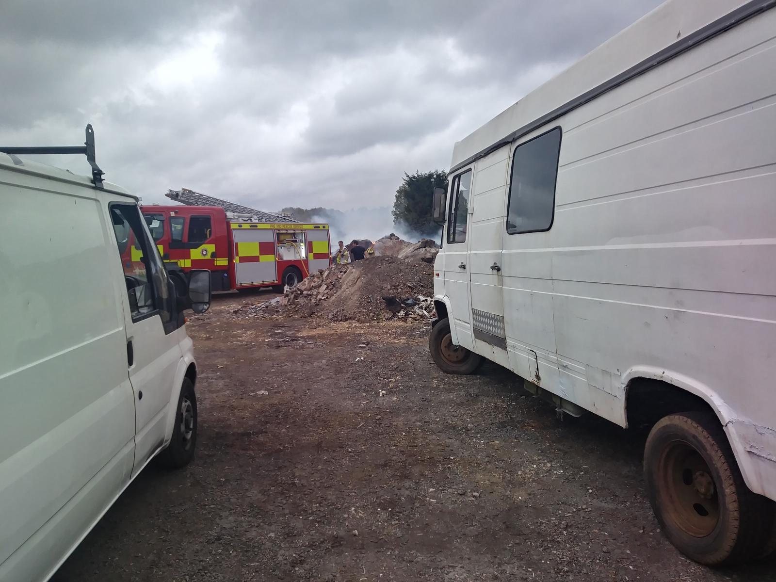

The bus is far enough away, big pile of wood chippings, no flames, just smoldering away but somebody reported it.
I didn't light the fire before you ask...
