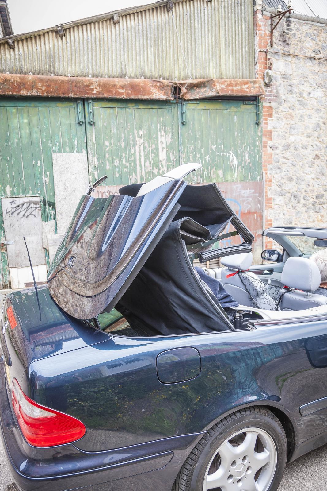

Then the learning starts. The roof handle fell off the first time I tried to close the roof, well latch it (roof is electric apart from the first or last operation). Bit of a sod to be honest as I do like the roof off if the sun even slightly shows its face so a problem there was a problem indeed! it took me the best part of half a day to work out how to repair the latch handles (drilling out rivets and replacing with self tappers - stainless ones at that!) and getting it all aligned and working properly.

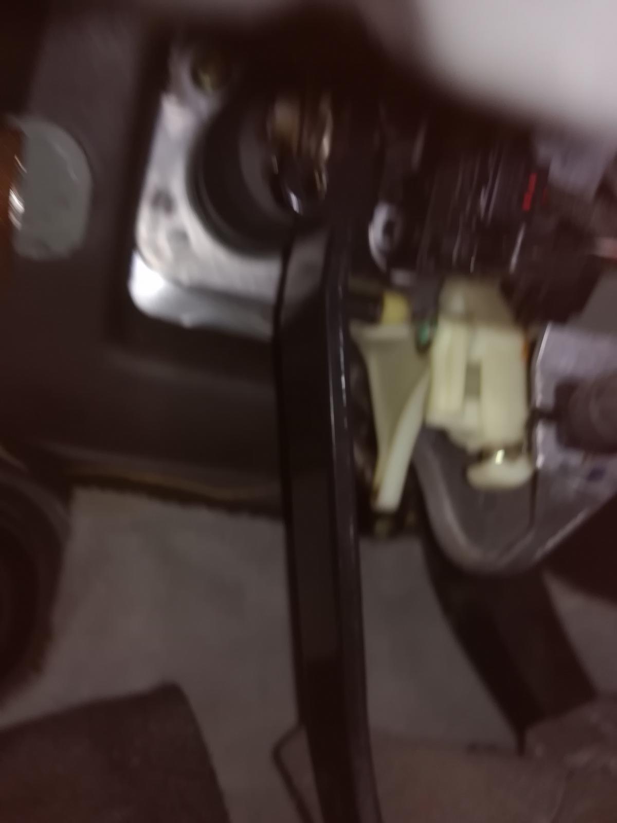

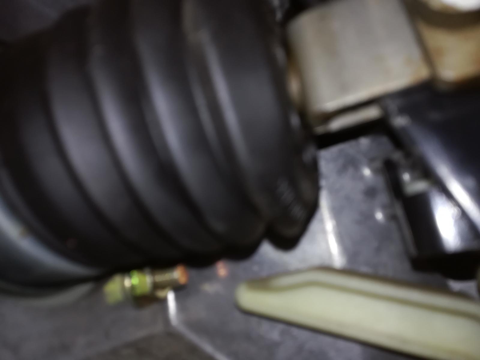

Then the fault I did know about: the ABS/BAS lights come on the dash intermittantly. The received wisdom is that this is a faulty brake light switch. Quite why a faulty brake light switch does this I have no idea... so a new one was ordered from Mercedes Benz - £15 so not worth getting anything else. It turned up a couple of days later so I raved all the under dash out, got to where the switch was, and... it was wrong. Totally different, MB couldn't believ or accept there was an alternative, fortunately, eBay disagreed and a Febi replacement for the switch fitted to my car was bought, £14 delivered. This finally turned up yesterday and was fitted (dead easy twist to the right to release, locate and twist to the left to fit new!) but I din't know that the switch needs to be adjusted, I had a second attempt later after the new switch had made zero diference. I had the codes read (£40!) which said it has a faulty solenoid in the ABS pump. I took all the connectors off and cleaned them knowing it would make no difference... but, it seems to have done just that, made a difference... we shall see.

This is the offending 'Brake Light Switch' or rather where it is if you can see it. All fine and well for all you able bodied sods, not so handy for us old cripples!
Anyway, it got done and after my second attempt were I actually adjusted it properly, it seems to be working... fingers. toes, eyes. all crossed :)

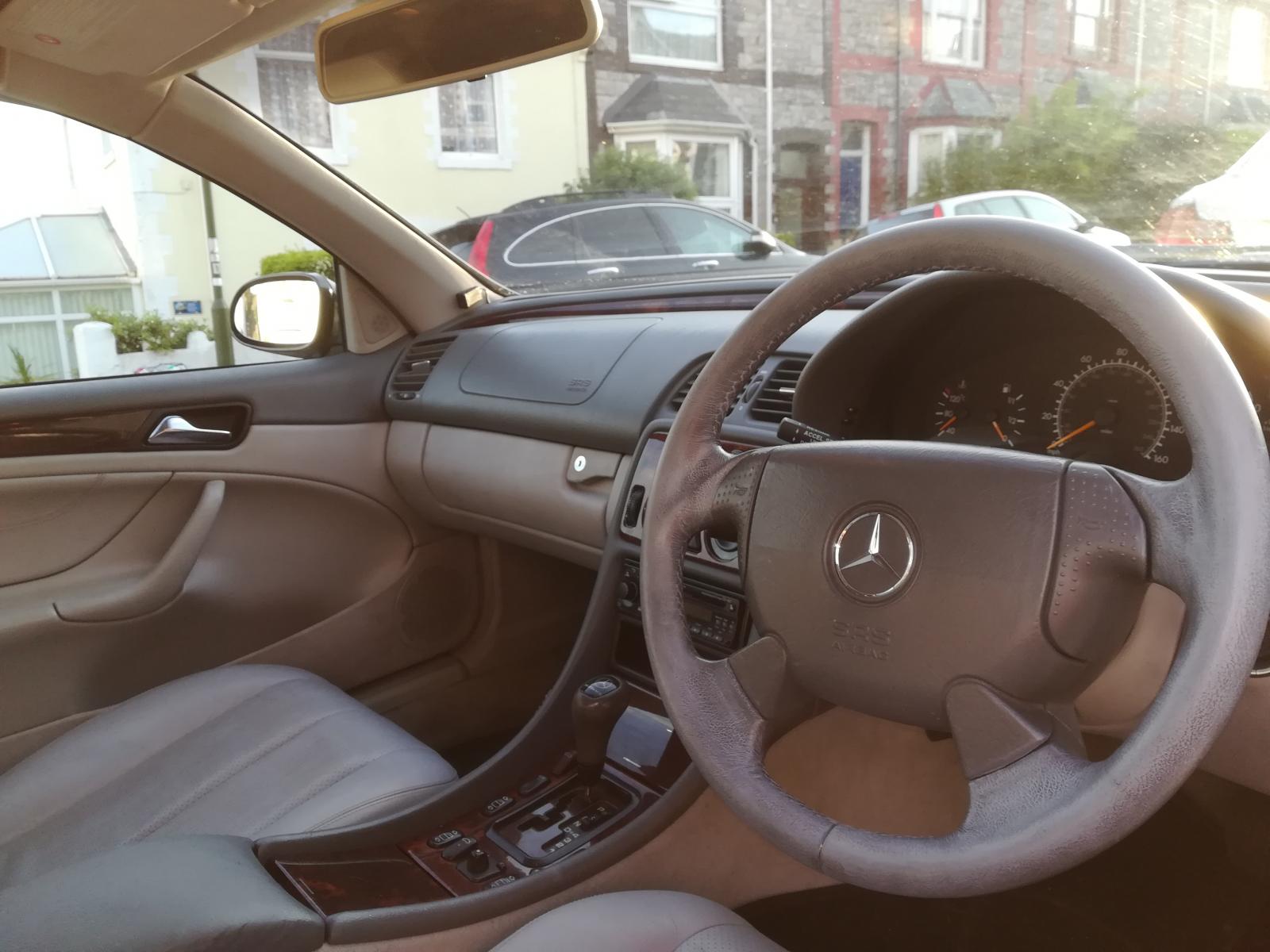

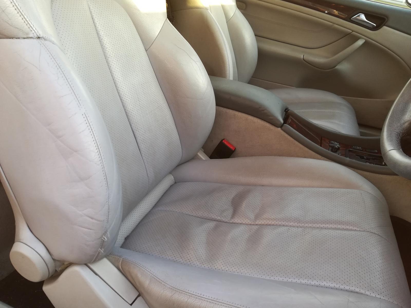

Been attacking the leather more or less once a day with the polish/dye stuff (£5 from eBay), the interior looks pretty good now...

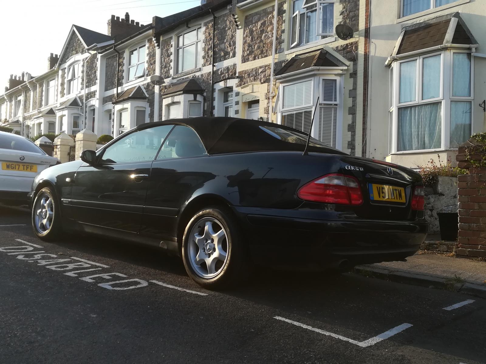

Having got everything mechanical (apart from the serp belt - must get that done!) sorted out, I polished the car...

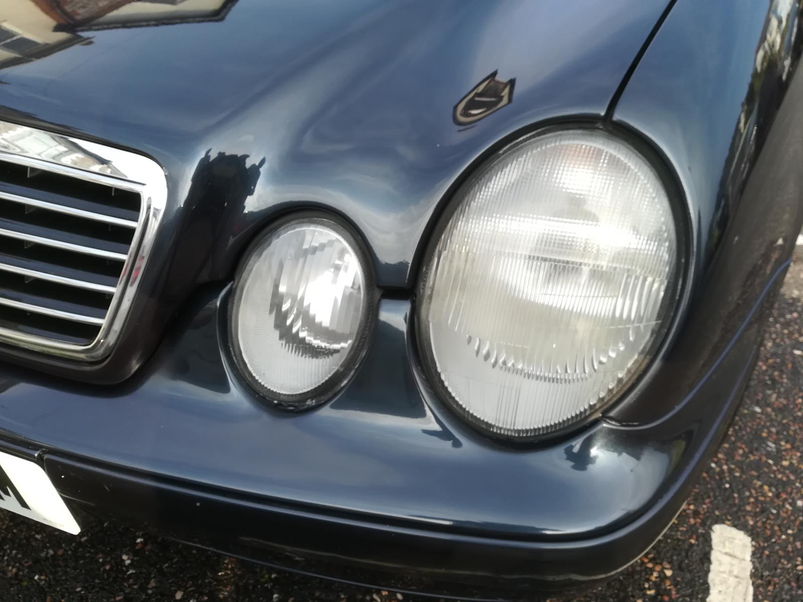

It really is a beautiful colour: I'm not normally bothered about colours but this is 'stunning' - Met Black Opal but most of te time it looks blue, or green, or possibly grey, rarely black! I have been round the bumpers and touched up the corners, just with a little brush and it looks okay. I will get it properly painted later in the year I reckon, possibly a full respray as it is a nice car, but it will definitely be the same colour! :)
