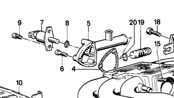

The idle speed is regulated by the water heated H valve under the inlet manifold. These just corrode inside and stop working leading to variable idle speed. There is an air speed screw  on the manifold (No.19 fits into No.5)  - DO NOT adjust the idle speed on the the throttle body.
New H valves are NLA so what I used to do is insert an old 3/8 socket into the rubber air hose to reduce the volume of idle air. A bodge but it works.
Started the car and let idle till the temperature gauge was halfway. Idle speed was reading around 1100rpm. So i took your advice and backed the air speed screw off a couple of turns until it was reading around 700rpm. Engine sounds a lot happier for this. Cheers for the tip :)
