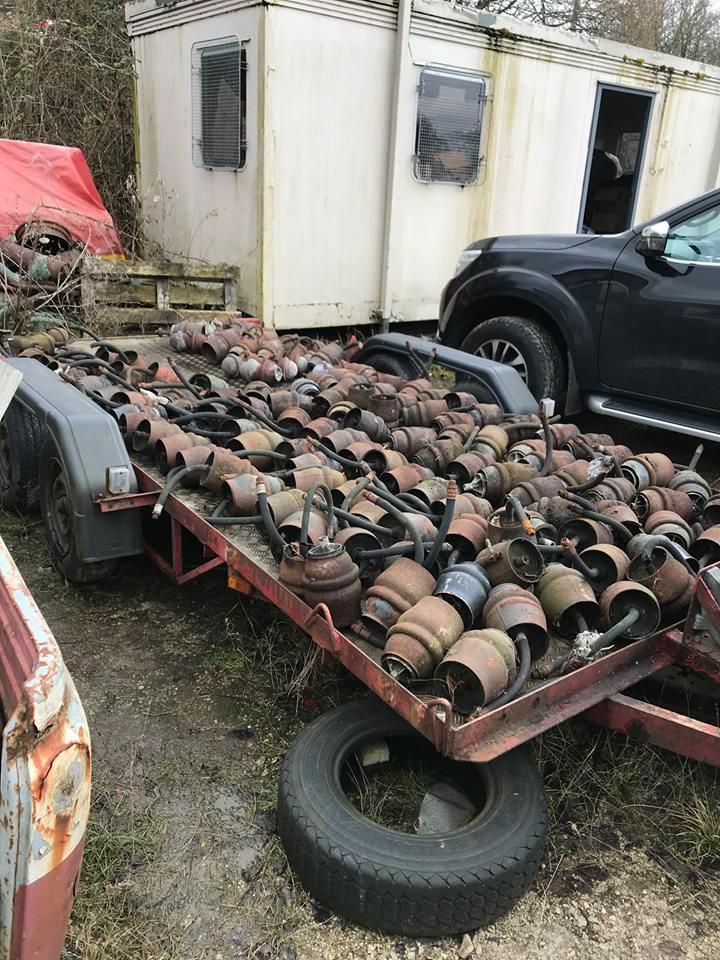

sierraman Posted May 1, 2018 Author Posted May 1, 2018 Imagine chancing on a shed full of displacers now!
SiC Posted May 1, 2018 Posted May 1, 2018 It wasn't far off that when Earlpart went into liquidation and their stock store was sold off. The Moog and Tamworthbay 2

somewhatfoolish Posted May 1, 2018 Posted May 1, 2018 It wasn't far off that when Earlpart went into liquidation and their stock store was sold off.29595064_10155461501250823_3997964563222618855_n.jpgBlimey, did someone buy them or did they get skipped?
SiC Posted May 1, 2018 Posted May 1, 2018 Blimey, did someone buy them or did they get skipped?Sold when the company was liquidated. More info here:http://mk1-forum.net/viewtopic.php?f=28&t=21997
trigger Posted May 1, 2018 Posted May 1, 2018 These guys bought them all, the same guys as linked above. https://www.facebook.com/groups/Hydrosuspension/ SiC 1
