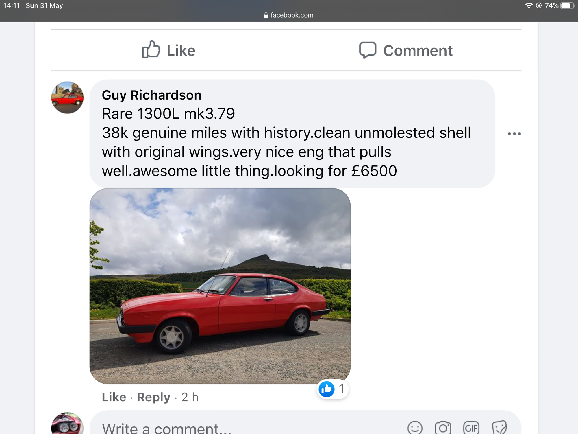

All this talk of the rarity of 1.3Ls and guess what turns up,on Facebook Capri page-
So much as I like lesser models this does not appeal - deffo not as £6k. Slower than a week on remand.
I think £6.5k is strong with the wrong wheels and possibly other mods as well, but any Capri with an MoT is £4K+ these days and I think that will easily make £5.5k, maybe 6 in a good day depending what it looks like in the flesh. They have just gone crazy in the last few years. Projects are £2.5k these days!!!!
