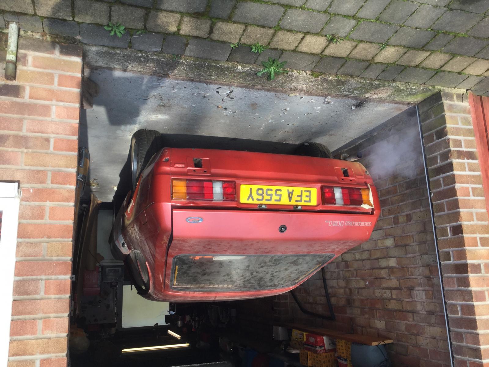

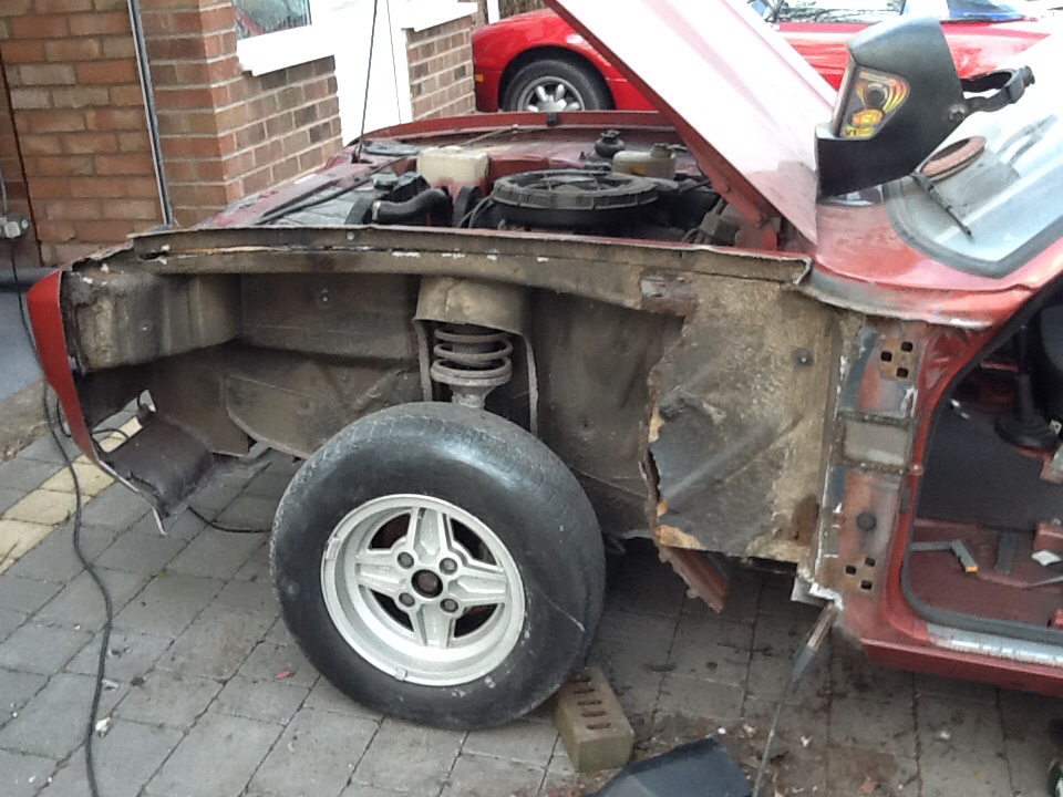

Just never got around to starting a thread on my Capper project, been at it for a couple of years. I will put some old pics up when I dig them out. It was MoTed when I bought it (just) but was a bloody death trap. It’s now mechanically and structurally solid but needs a fair bit of work to finish. Hardest part was sorting the passenger side rear arch which had been cut about badly by the previous owner. More info when I think about it. Bet the pics are upside down (good old apple)post-19712-0-79412200-1523711506_thumb.jpegpost-19712-0-96212700-1523711527_thumb.jpegpost-19712-0-94505200-1523711547_thumb.jpegpost-19712-0-83402000-1523711579_thumb.jpeg

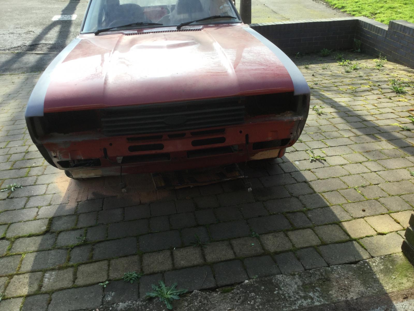

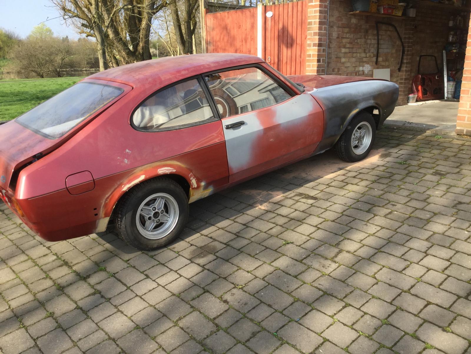

Mine had the side trims, still unsure whether to put them back or not. And I have to admit I love the rubber boot spoiler! The rust was in the usual places, front wings went (should have saved them with hindsight) and repairs done to the sill ends behind them and local repairs in the A pillars. Front panel needed a bit of work, couple of tiny patches in the headlamp bowls. Local repairs in the floor, only tiny ones and a couple near the spring hangers which were small but complicated as three panels come together there. Both rear arches needed work, drivers side had been bodged with fibreglass by the lads so that was easy to strip and sort properly. Passenger side has been the nightmare, the morons had drawn around the repair panel and cut to that then fitted it appallingly. It had to come out but left nothing to work to so I had to build the whole thing back up, it took a hell of a lot of time. Mechanically it has had a fair bit including a full brake rebuild front and rear. It still needs a clutch but I have a 2.0 so may drop that in.

I hate that stupid forward facing overlap that ford decided put in that area probably being the start of the rot, I repaired the same place on mine

Found some more pics, I had forgotten how much I had done!post-19712-0-84993600-1523725510_thumb.jpegpost-19712-0-01807300-1523725522_thumb.jpegpost-19712-0-50616600-1523725536_thumb.jpegpost-19712-0-57413800-1523725547_thumb.jpegpost-19712-0-79489800-1523725560_thumb.jpegpost-19712-0-24575100-1523725571_thumb.jpeg

Doesn’t look too bad in the first pic, shows what they can hide!
