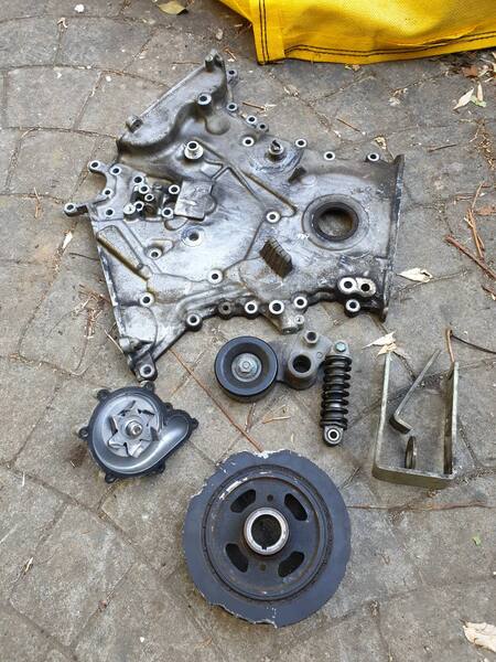

Slartibartfast Posted June 26, 2019 Author Share Posted June 26, 2019 Tame mechanic is fixing it today. The bearings in one of the idler pulleys (or the idler pulley? Not sure if it has more than one or indeed if any car has more than one. In fact I'm going to investigate now. It does in fact have more than one.) failed. This was ... less than ideal. The bearing failure munched the mounting thingo it sits on. This is part of the timing case which a single cast piece of aluminium. So the timing case and a whole bunch of other stuff needs replacing. Thankfully he's able to do it without pulling the engine out. He's managed to get most of it done but he's waiting on one part from Sweden which won't arrive until Friday. BlankFrank, FakeConcern, djim and 2 others 2 3 Link to comment Share on other sites More sharing options...

Slartibartfast Posted June 27, 2019 Author Share Posted June 27, 2019 Good grief, thats a bill and a half. Top marks for having it done. Is it much more effort to have the cambelt done at the same time? Or should I not ask?Chain drive thankfully Stanky 1 Link to comment Share on other sites More sharing options...
Slartibartfast Posted June 27, 2019 Author Share Posted June 27, 2019 Lesson learned. Don't play serpentine belt roulette, kids. mrbenn, BorniteIdentity and Jim Bell 2 1 Link to comment Share on other sites More sharing options...
mrbenn Posted June 27, 2019 Share Posted June 27, 2019 11 minutes ago, Slartibartfast said: Lesson learned. Don't play serpentine belt roulette, kids. Good advice! I've just changed a grumbly belt tensioner on my car, did the idler pulley at the same time as it seemed sensible but was initially undecided from the "if it ain't broke...." point of view. Reckon it was a good idea after all. Slartibartfast 1 Link to comment Share on other sites More sharing options...
Slartibartfast Posted July 1, 2019 Author Share Posted July 1, 2019 After all these bits were replaced, Wolvo lives again! djim, Lacquer Peel, Amishtat and 6 others 9 Link to comment Share on other sites More sharing options...
320touring Posted July 1, 2019 Share Posted July 1, 2019 That's done quite the job on that timing cover and pulley. Glad it lives again! Link to comment Share on other sites More sharing options...
Slartibartfast Posted July 1, 2019 Author Share Posted July 1, 2019 I think the pulley was ... recalcitrant and needed encouragement. The timing chain cover damage was all down to the failing pulley though. 320touring 1 Link to comment Share on other sites More sharing options...
Stanky Posted July 1, 2019 Share Posted July 1, 2019 If that cover is sold aluminium then there is about £25 of scrap there. Smoll offset for total cost of fixng, but offset nonetheless? Jim Bell 1 Link to comment Share on other sites More sharing options...
