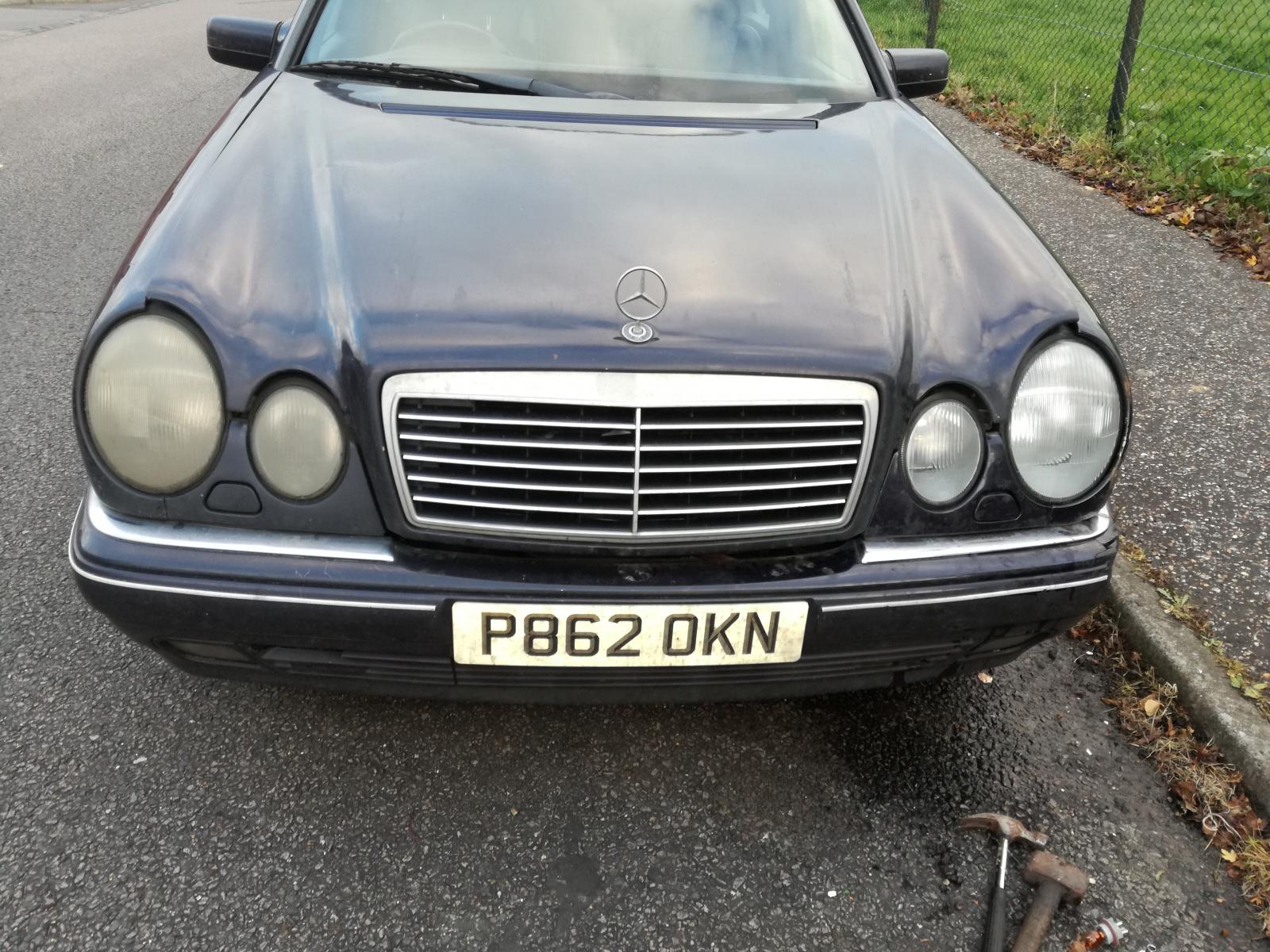

Talbot Posted March 28, 2018 Posted March 28, 2018 Had this issue on my W210. Cue much sanding with 2000grit wetndry (wet) and then a polish with T-cut. Worked really well and the MOT man even commented as to how much of an improvement it was. Spot the difference:
