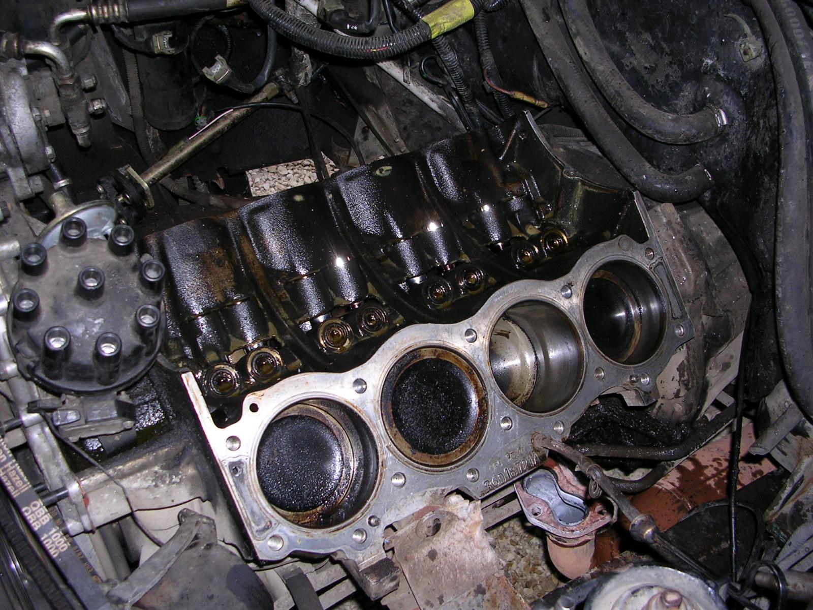

this is what liner slip looked like on my last 3.9
3rd cylinder back has been pressure washed
I closer look shows that the liner has dropped by a few thou.
the impact is that the fire ring on the head gasket is too close to its neighbour and therefore sits on the liner. when the liner drops the head gasket will fail.
liner replacement is the only solution, thou you can delay the inevitable with a dose of K-seal
